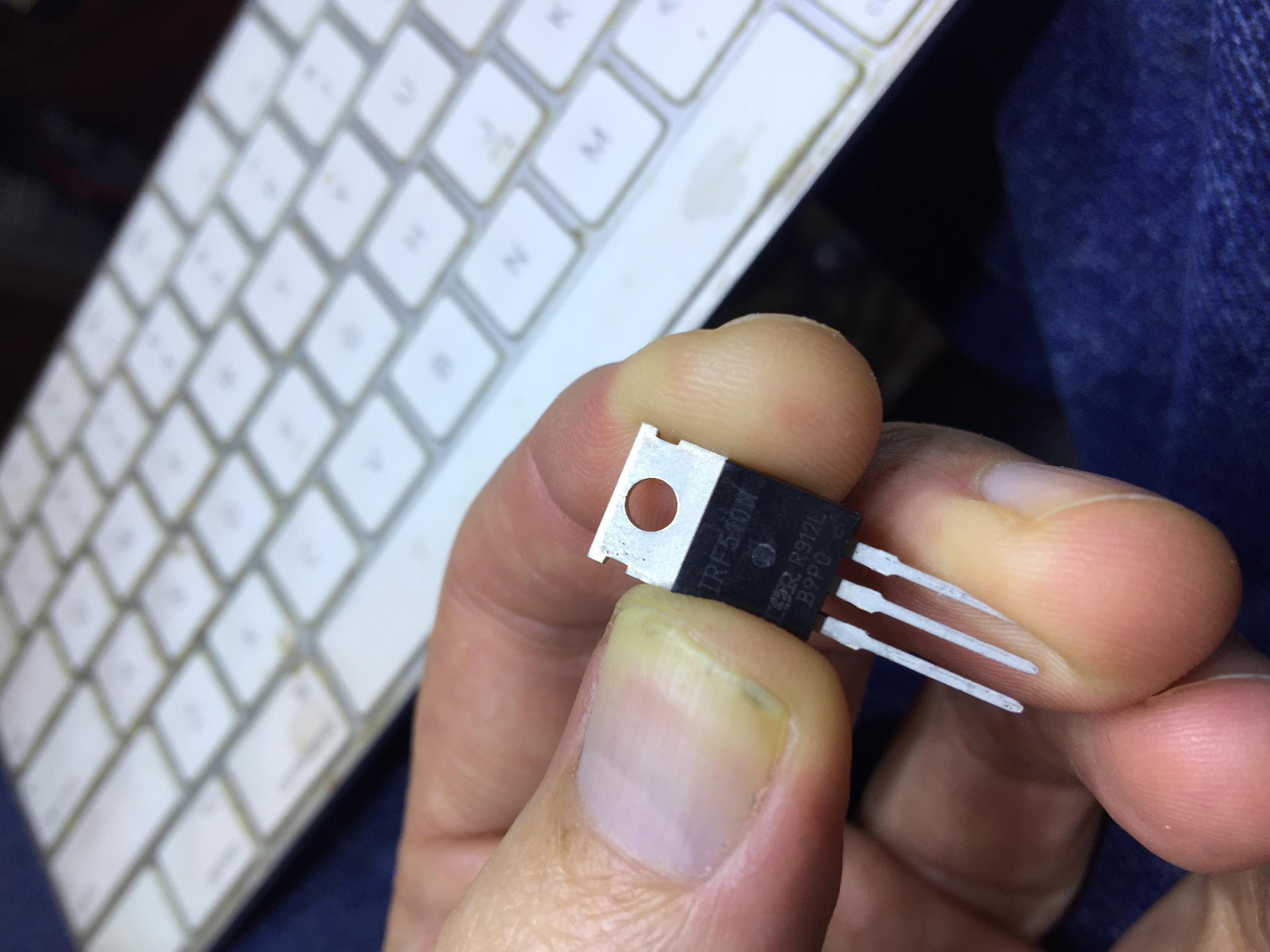

                        #31
                        Re: How could I find a FET with specific specs?
                        Originally posted by eccerr0r
                        In any case, proper drive needs to be figured out. OP apparently still hasn't figured out how to properly turn LEDs fully on and off - a requirement for PWM.
                        Remember, the goal in this application is to have three different states of brightness, low, medium, and high.
                        The circuit where I had three different output pins driving three different transistors (TIP-120 in this case) actually worked.
                        However, based on the feedback here, I decided to try this configuration:
                        And after playing around with the RC filter, I settled on the values in the schematic. I used an online calculator which told me to use a 68Ω resistor and a 4.7uF cap but when I tried that, there was still significant ripple in the output so I bumped up the values and as you see here, the results are pretty good:
                        (This is at the medium brightness PWM duty cycle before attaching the MOSFET)
                        Yellow is channel 1 on the scope attached to the output pin of the Arduino chip and green is channel 2 attached to the output of the RC filter. It's still kinda noisy, but I think that has more to do with the Hanetk USB scope that I'm using, and my final power source will be a battery and not this buck converter that I'm using now which may also be part of the noise.
                        By varying the duty cycle of the PWM output, I am able to get three states of brightness ... basically, in the low state, I drive them at 90mA then at 170mA then on the highest setting, I get 270mA and the LEDs are rated at 280. And that is all from a 3.3V source.
                        sigpic
                          • Jul 2011
                          • 6030
                          #32
                          This looks ok but I would have the one ohm resistor on each LED and remove the one the mosfet to negative side of the power supply
                          I might be wrong about this part it might not work correctly ——>
                          Or put the LEDs on the other side of the mosfet and have a resistor on each LEDs that goes to the negative side of the power supply
                          The reason why is so each led has the same current
                          Have you tried a raising value capacitor on the output pin to the negative rail of the controller and what results do you get ( or maybe put a 5 UF more before the resistor) with higher value ( just curious what the difference is with capacitors values I kind-a of know what might do but I only have experience doing it on the solenoid valve controller but have not tried this on LEDs before ) see if this makes a difference the only problem might be that response time for changing in brightness level will take longer ( this might be able to corrected this in the PWM code routine )
                          Can I ask you what are you making
                          I am glad you are making progress on this project
                          Is the mosfet getting warm or hot driving it at full brightness or at low brightness what happens then
                                  However one thing that we're being lied to about is that the IRF510. These are not "logic level" FETs and will barely turn on if at all at 3.3V gate drive, again maybe you can cherry pick a device that will turn on, but in a production environment you'll get a lot of failures. A BJT here will guarantee turn on in all cases but it will limit LED voltages to 3.1V or so due to saturation voltage drop.
                                  I take great offense to being called a liar. I don't lie, what would be the point? How could I possibly get the right help in here if I lie about what I'm doing?
                                  Here is a picture of the exact MOSFET that I used in the test. I also uploaded the pic file itself so you can check the date and time on it or whatever to confirm that I just took that picture.
                                  sigpic
                                  • eccerr0r
                                    Solder Sloth
                                    • Nov 2012
                                    • 8686
                                    #37
                                    Yeah you got lucky, the threshold voltage of these FETs are not cut out for 3.3V usage and if you mass produce, you'll find a lot that don't work as planned.
                                    And again you MUST COMPLETELY LOSE THAT CAPACITOR if you want to save energy from battery use. That sole capacitor is causing you to waste a lot of the energy stored in the battery.
