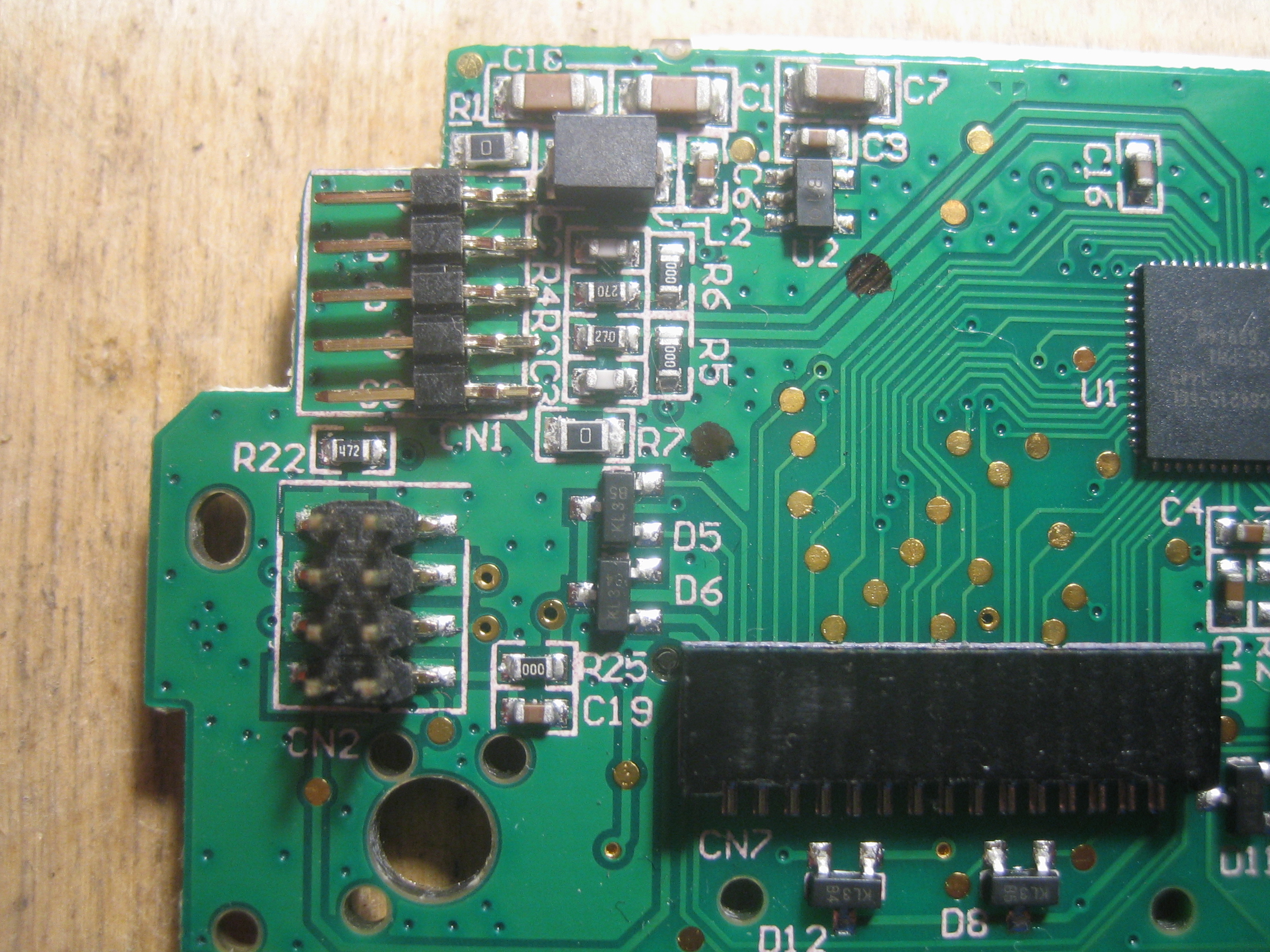

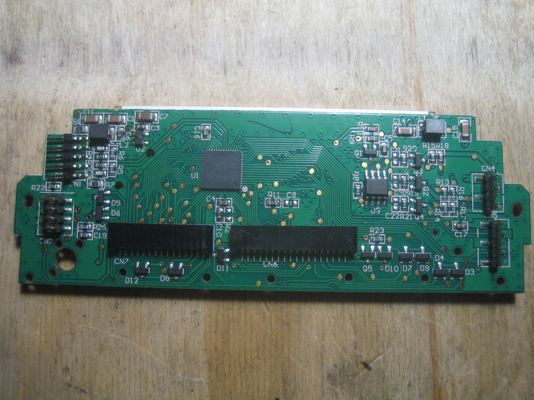

    please help id component

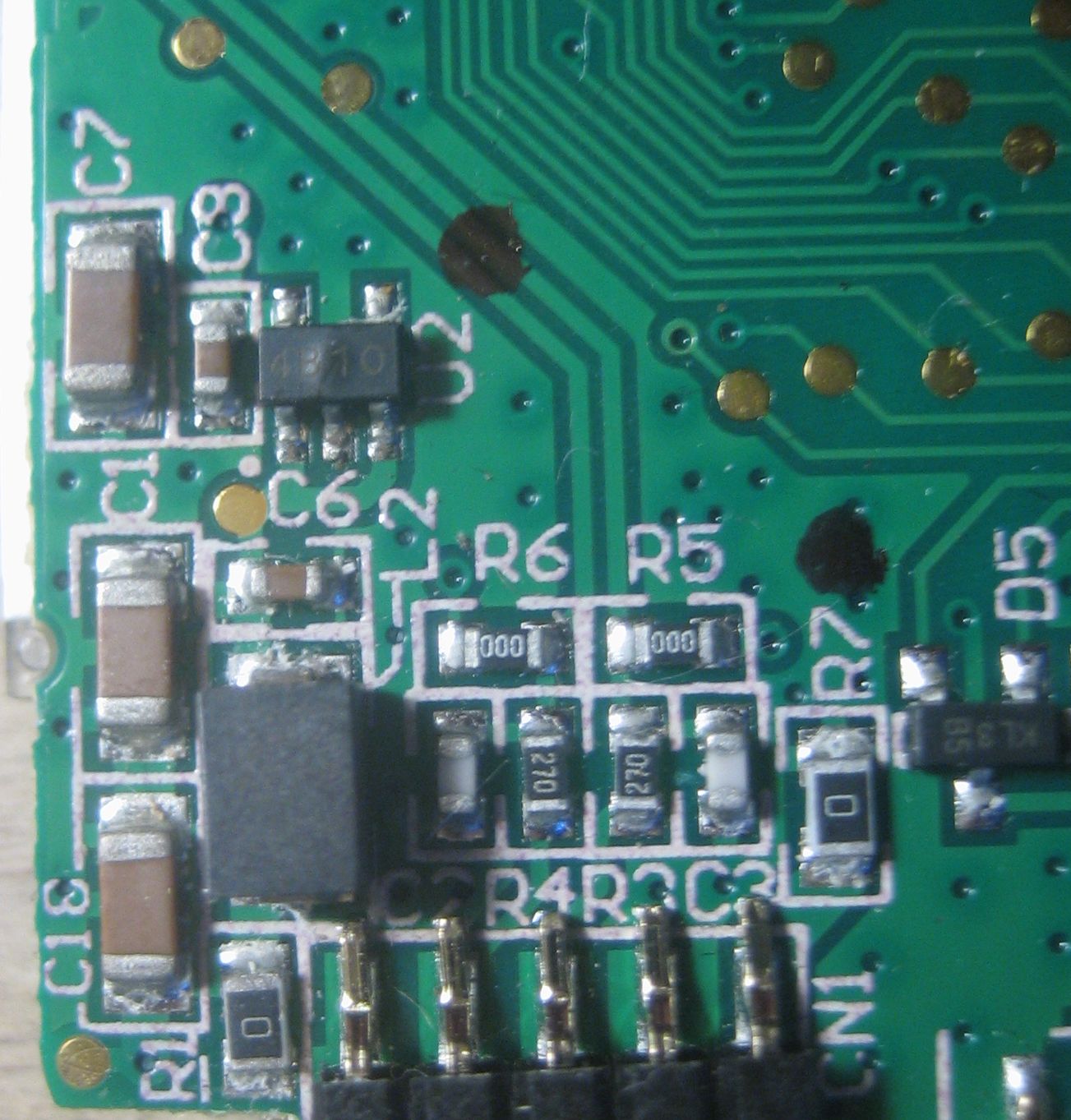

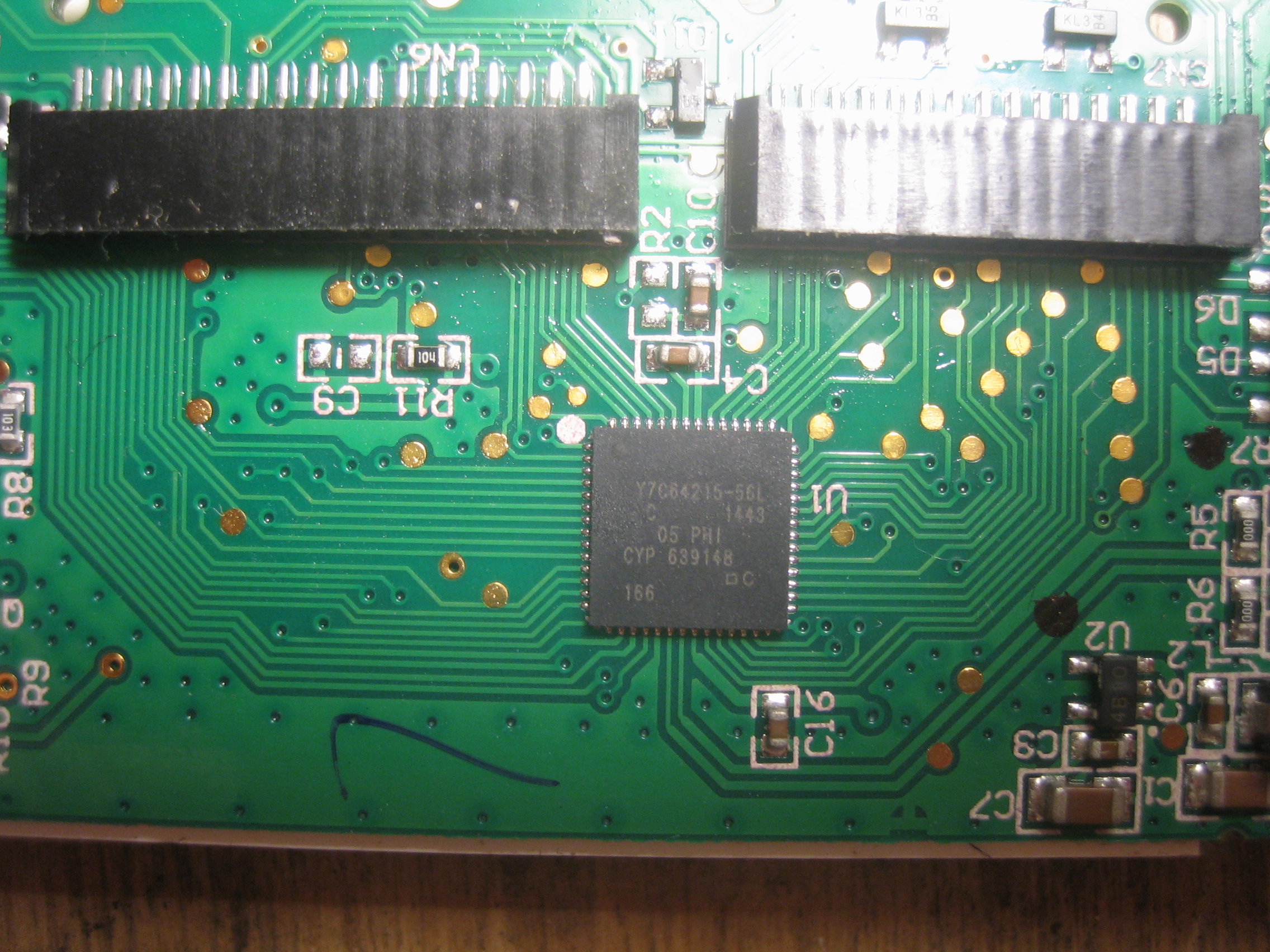

    Can't figure it myself - board is from Logitech G13 game controller which got reversed polarity supply, need to identify U2 which has marking "4810", CN1 is USB input, big chip is Y7C64215.
    • 31084
    Re: please help id component
    "4b80"
    LN1193B392MR
    or
    LN1234B09AMR
    are possible matches.
    • jons
      • Feb 2014
      • 59
      • Latvia
      Thanks, that's indeed B not 8, my mistake, but next to it definetely is 10. Will there work any LDO to specified controller operating voltage, say 4.35-4.9V?
        • 31084
        "4b10" in a sot23-5 package.
        LN1134B322MR
        LN1193B322MR
        • jons
          • Feb 2014
          • 59
          • Latvia
          I can't fnd even datasheets on those, how did you figured them out?
            • 31084
            i have a code book.
