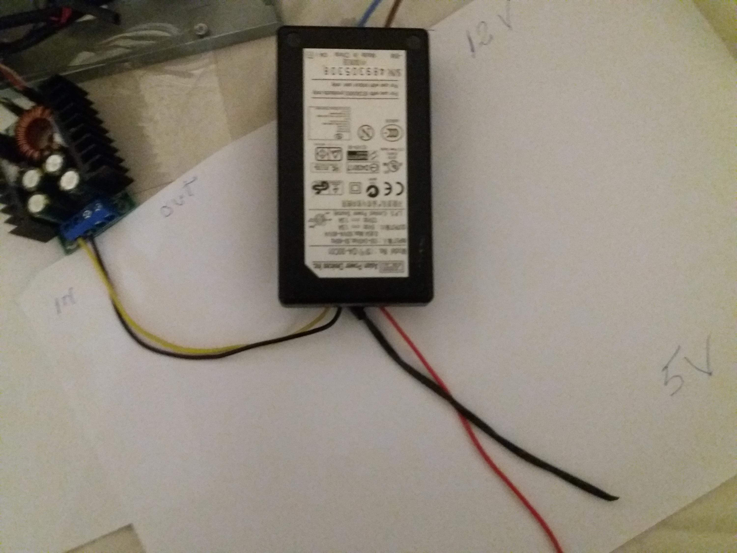

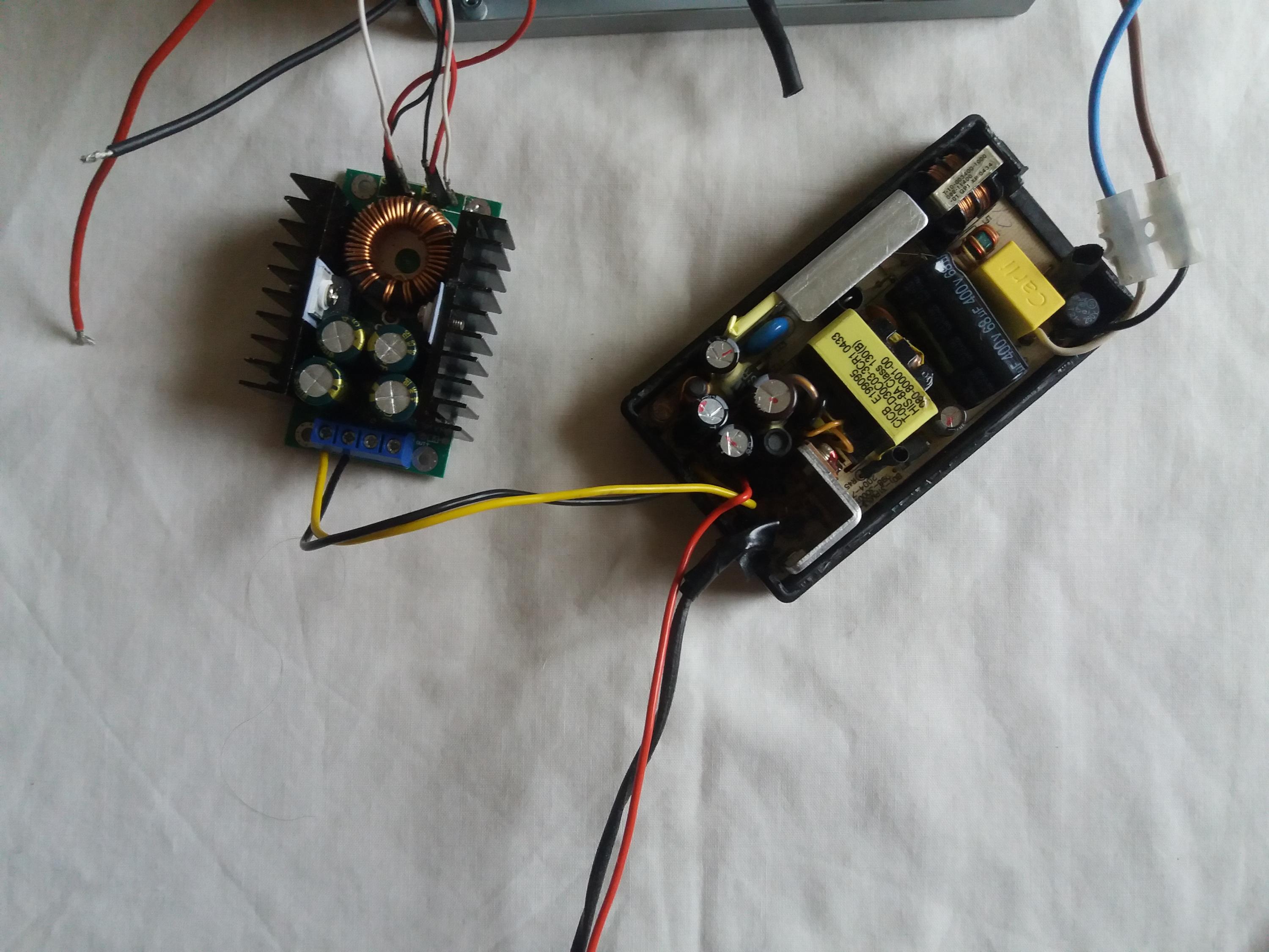

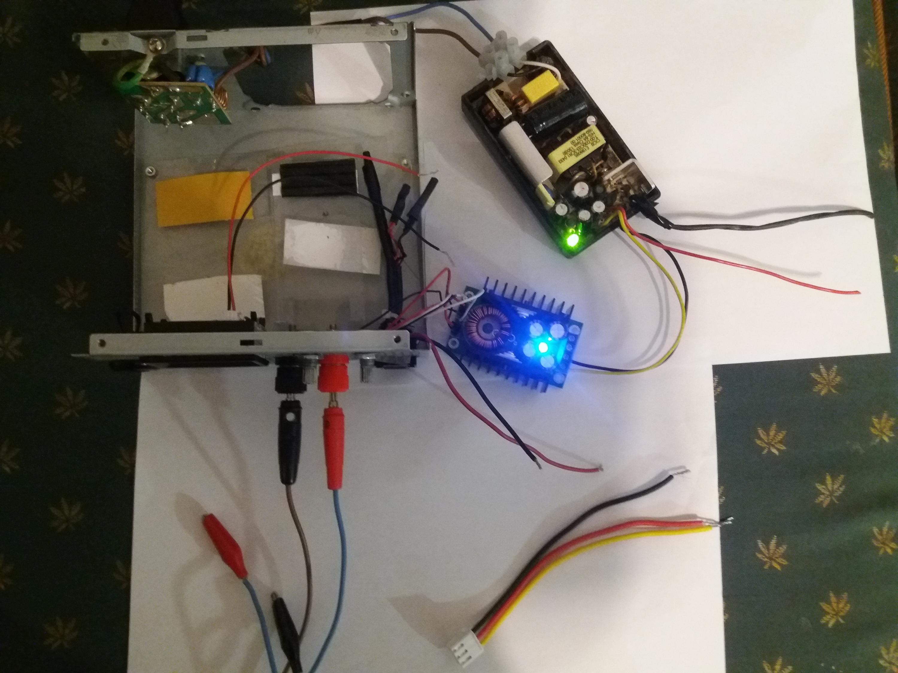

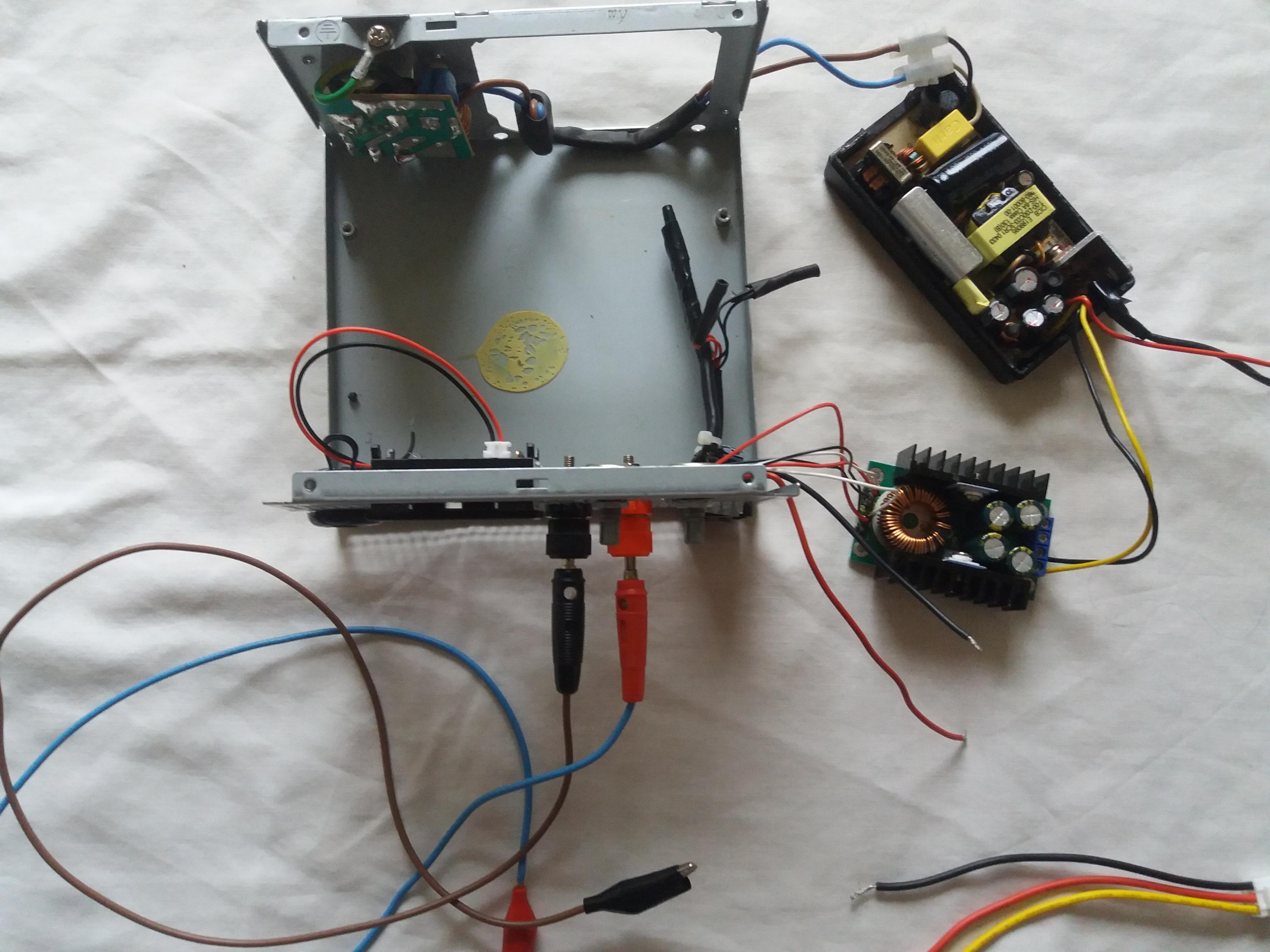

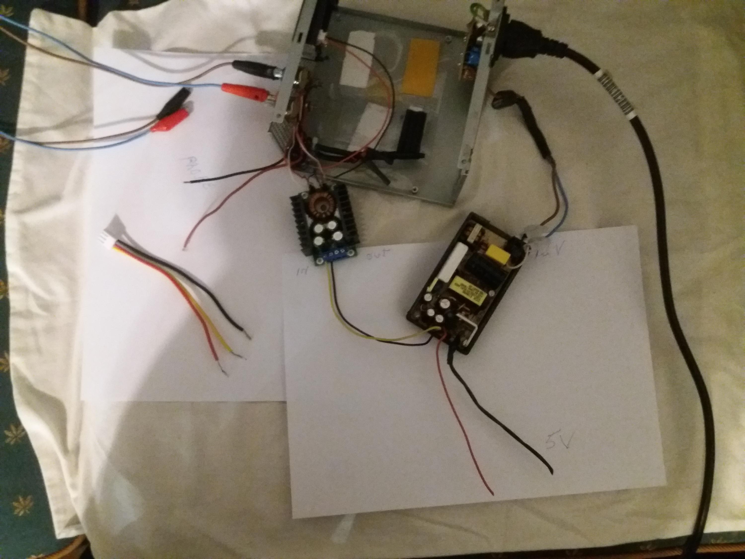

    Hi I'm building an adjustable Power Supply.
    But I have to be the dumbest person in the world and maybe I should not touch these things ya because I have seen several videos about it and even some
    schematic but have not figured out where the wires of the Voltmeter / Ampmeter should be.
    So please if you want to help me do not refer me to any video or any
    schematic please feel free to point to my pictures or give me a very clear
    picture showing where and how to connect them Very very Grateful
    I'm using a charger whith a dual output 12v and 5v with 1.5A for both output.
    and an XL4016 CC / CV 300W buck converter and finally a DC 100V 10A Voltmeter Ammeter Blue + Red LED Amp Dual Digital Volt Meter A meter

        Please post a picture of volt and amp meter module that you are going to use
        • bohaboha
          • Nov 2012
          • 1017
          • sweden
          Re: Help please:Stupid person Building Power Supply

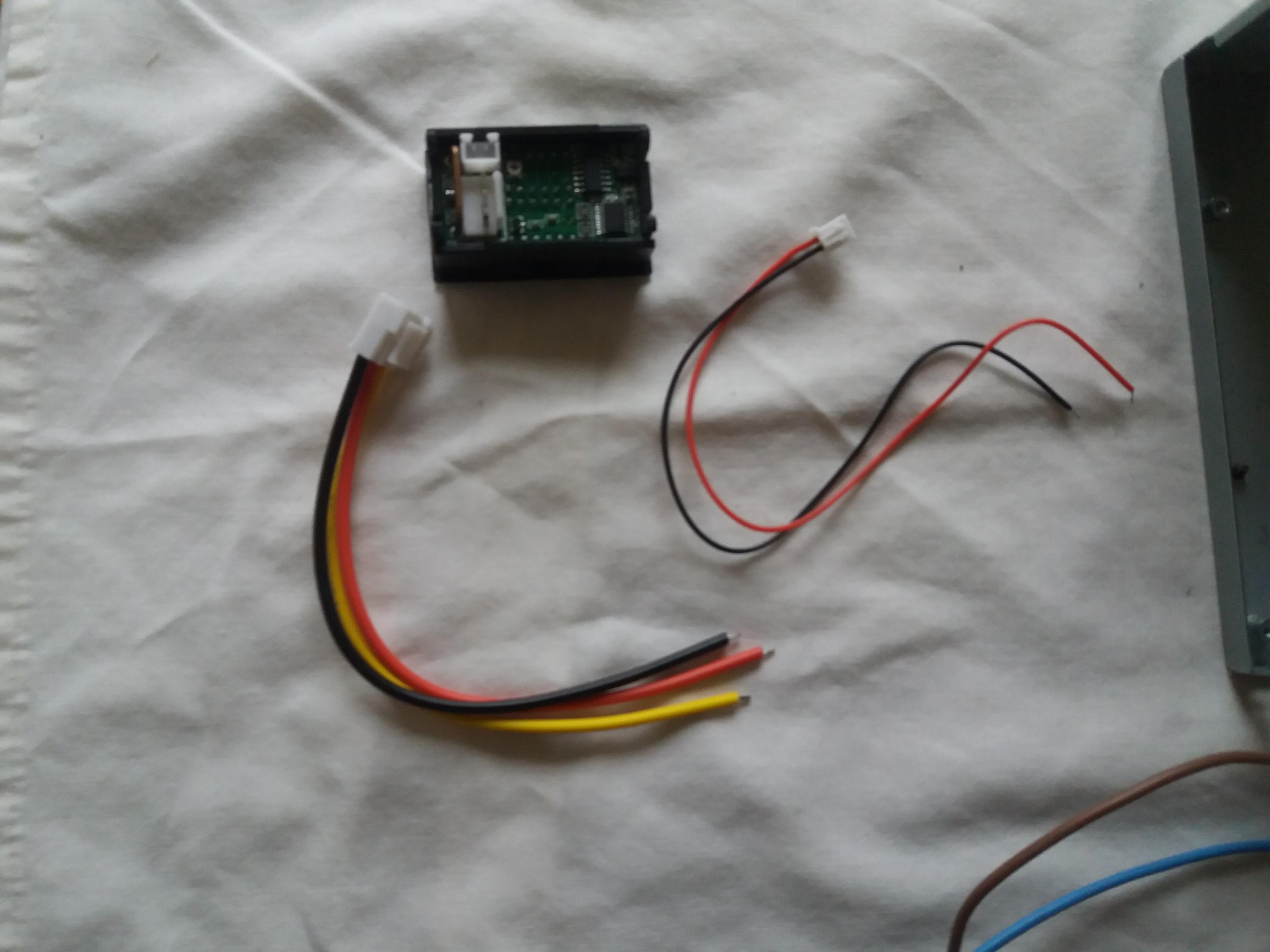

          Hej sam_sam_sam here some pics thank you
            • Jul 2011
            • 6057
            Ok

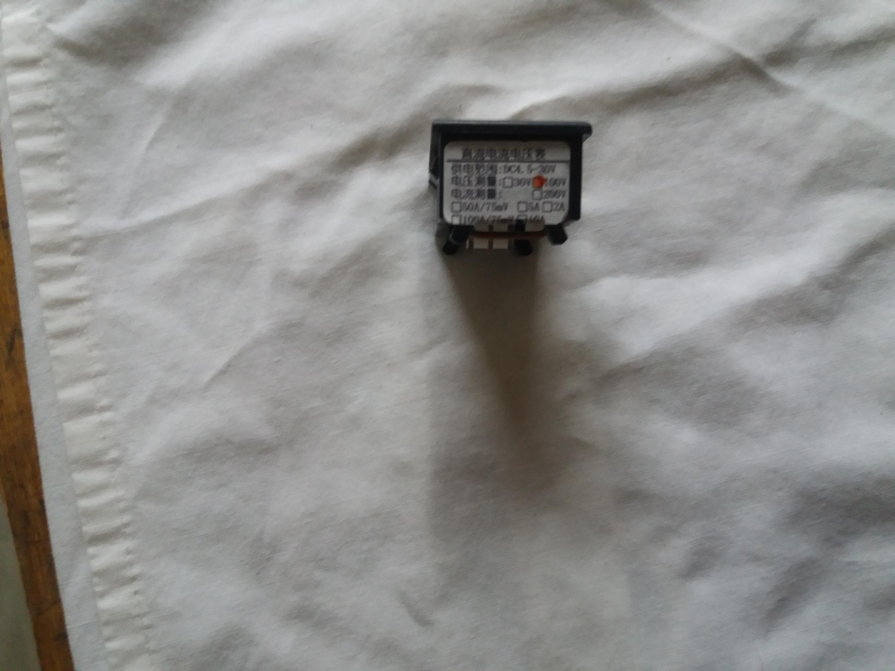

            This is fairly easy to do but you have known on the amp meter portion weather or not it negative side of the power supply that does the measurements or is it possible side
            Then if it has a ( - sign when pulling a load through the shunt ( wire or resistor inside the meter module ) you might have to change the direction of current flow some of these meter have this function but most of the meter that have three wires do not have this function
            These are the heavier wires that I reference earlier above
            The smaller red and black wire are your power for the meter module itself just make sure what voltage the meter module operates at and do not go over this voltage you will fry the meter module
            Most of the time the black wire and yellow wire is for current measurements and red and black is voltage measurement wires
            Can you please post a link to where you bought this meter module at I can more information in detail how to hook up this meter module

              Hi again and thank you for your help .my problem is where i hook those wieres for the best funkion as you sad the Red and Blak small wires are for the Volt/Amp meter power,the yellow is for the volt and the blak and red are for the curent but the Where to hook them ?here is the link:
              https://s.click.aliexpress.com/e/_AZpmMG
              https://s.click.aliexpress.com/e/_A44A7o

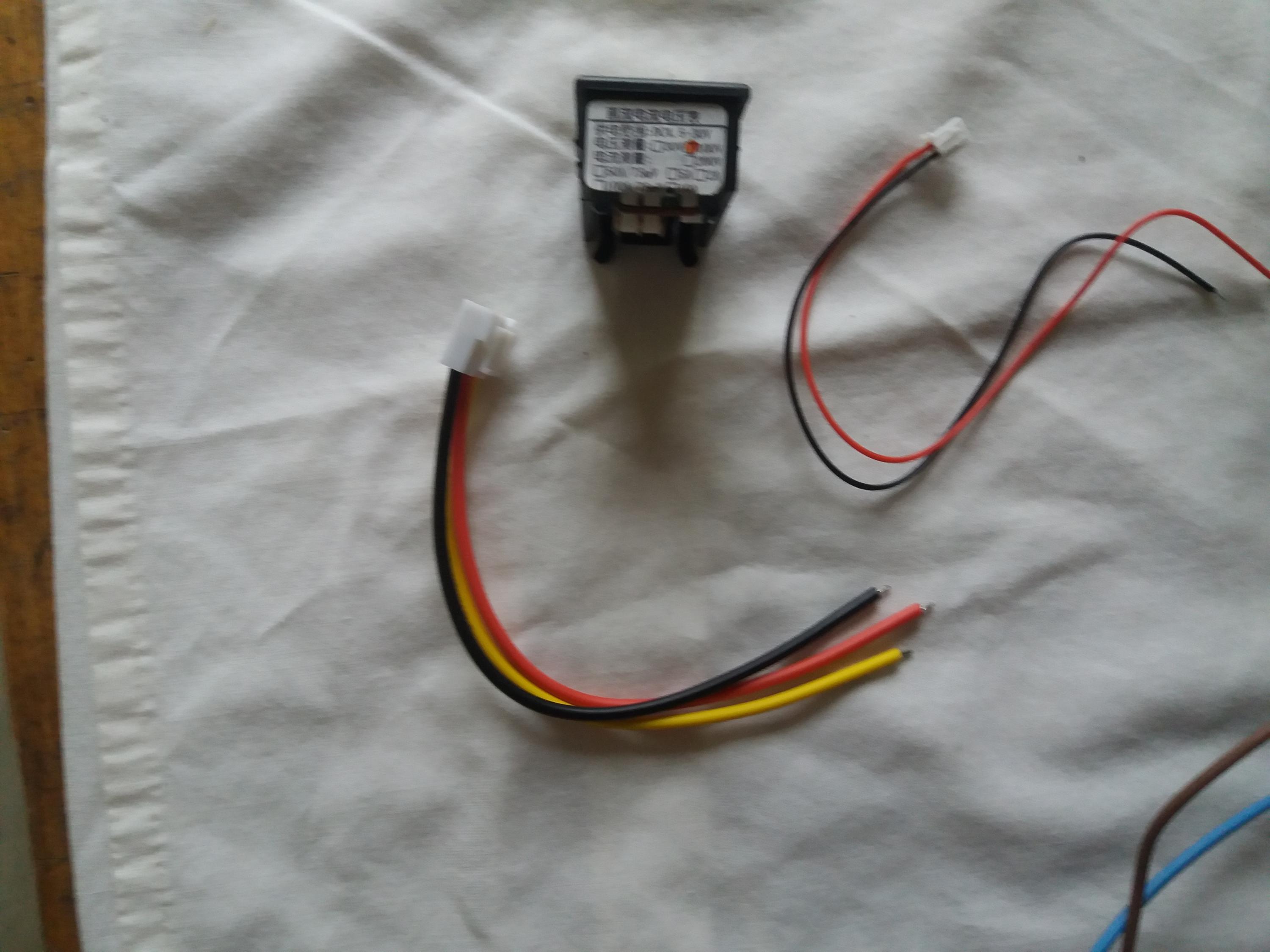

                    You to take a ohm meter and check and see if close to “0” ohms or maybe as 1 to 2 ohms resistance on the heavy red and black wires you are going to put this in series with the load on the negative side of your power supply output terminal
                    See if the thin red and black wires powers up the meter if so then you only have to deal with the current portion of this meter module
                    The yellow should be the voltage sense wire
                    If the power on with only the thin red and black wires then very quickly put it together with the red wire and you should see some voltage readings if you do then that is the voltage senes wire if sparks we start from the being
                    This information that I put in this post is based on the information in the meter module information provided by the seller that you posted here on this forum
                    The two pin connector in front shunt should be shunt pin connector that is the one that should have very low resistance between those two pins that I talked about earlier
                    I hope this helps you get the meter module working correctly
                    One note if you want to see the voltage at your terminals on your power supply output then the yellow wires need to hooked up to positive terminal ( power supply output side ) the two very thin red and black wires go to switching power supply output pins 5 volt side
                        Hi yes the thin red and black wires powers up the meter. and the others 3 wires :black,red and yellow are for the Curent and Volt
                        yellow for the volt.
                        Now how to connect them right to the probes and to the XL4016 CC / CV 300W buck converter? because apparently there are several ways to do it
                        The buck converter get his stable power from the charger
                        Last edited by bohaboha; 12-05-2020, 02:47 PM. Reason: fogot to give important info
                          Does the Digital Volt-Amp meter come with the wiring diagram/instruction?
                          According to the link to Aliexpress, you will use the Share power source wiring, the power source is the Buck converter module.
                                  Share power source diagram, the output of your buck converter is the source.
                                  But remember one thing, using share power source you cannot set the buck converter to less than 4V because the min operating Voltage for the meter is 4V, so if you want the meter to show output from 1.2V and up you will have to use the second diagram instead but we do not know if the thin black wire is internally connected to the thick wire or not to allow to use common negative wires of the two power sources and we also do not know if the current sensing resistor in on the high side or on the low side..
                                  So look and see if the thin black wire is directly connected to the thick black wire on the circuit board or not.
                                    • Jul 2011
                                    • 6057
                                    If you are going monitor the voltage from the output from the buck / boost converter and you want the meter to stayed powered on all the time no matter what your voltage is from the converter then hook the two wires to the 5 volts output of your switching power supply and not in the shared mode ( this is if you are going to adjusting the voltage all the time for different devices then you would want to use this setup )
                                    Now if you are going to set the converter to a certain voltage and leave it at that setting then yes you can use the shared mode
