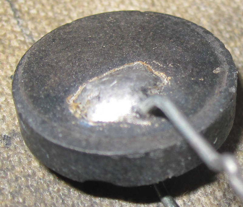

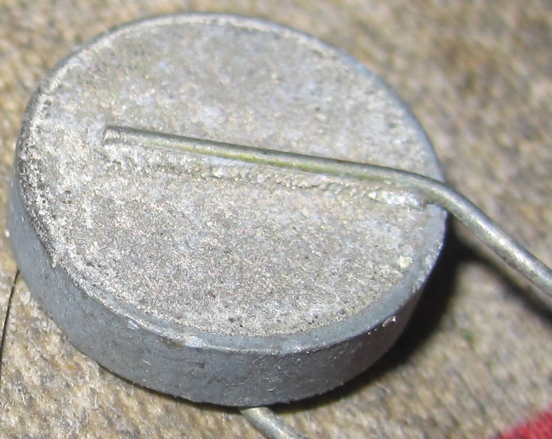

Is the thermistor NTC? PTC? just by looking?

    I suppose this can be deduced when in circuit, but if an out of circuit or questionable connectivity thermistor is handed to you, is it possible to tell whether or not the thermistor is PTC or NTC, if you're not allowed to touch it, never mind measure it with a heater or chill spray?
    I don't even have a picture of the questionable thermistor, but currently guessing it's PTC. But it's just a guess.

    Here are two samples, though there's another that a friend of mine was wondering, no pictures available...
    NTC? PTC?

      Check the resistance with your meter, then apply some heat and see which way the resistance changes. If they are inrush thermistors they are likely ntc, if they are for, example in a crt degausing circuit, they are likely ptc

          of these I do have in hand, intact, and OOC, left appears to be an ntc 25 ohm, other appears to be a ptc 20 ohm I think...

                The ones you have pictured do look like ptc's used in old crt degaussing circuits.

                    It's very possible the PTC on the right was indeed used from a degausser, but not the NTC on the left... I believe the NTC was from a SMPS.
                    Either way, I hate unmarked devices. And yes they apparently do still sell these without a coating, don't know if they were meant for temperature sensing versus inrush protection...
