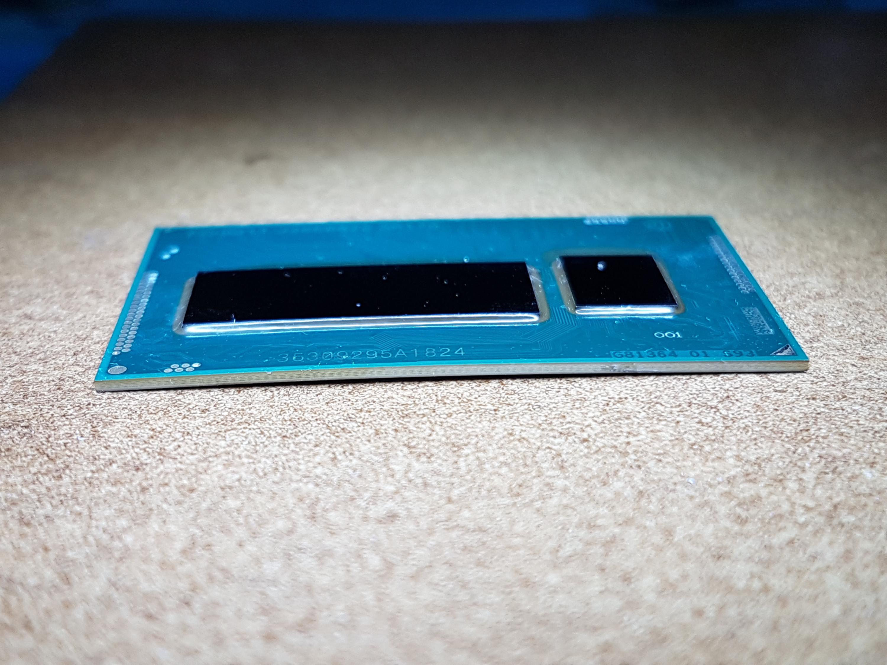

    Hey guys,
    I recently tried to remove an SOC (dead) from a donor board for practice. It's my first SOC removal and desoldering process was uneventful. Once lifted, I did a visual inspection of same and everything looked OK.

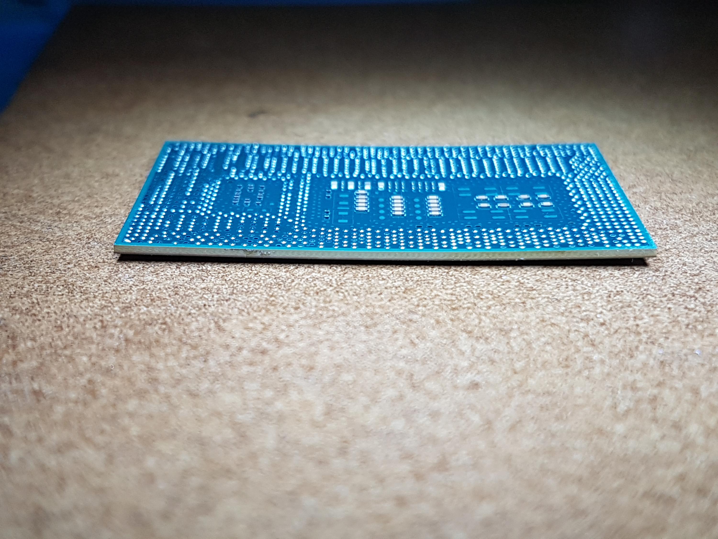

    I placed the SOC on a piece of ceramic to cool down (as I usually do when removing BGA) but when I went to clean it later, I noticed it was warped (please see attached picture). I never had this issue before with other BGA and thought it might be because of uneven cooling due to the shape of the SOC.
    Initial 'solution' I thought of (assuming it is due to uneven cooling) is to place the SOC on a piece of Aluminium foil near the hot/bottom plate and let it cooldown slowly alongside the hot plate.
    Note:
    The deflection at maximum is around 0.6mm
    Anyone ever had similar issue? If yes, what was your solution?
    • 30978
    Re: Warped SOC
    that is why nobody replaces the intel cpu's in the latest macbooks.
    you should - as you thought, control the rate of cooldown.
