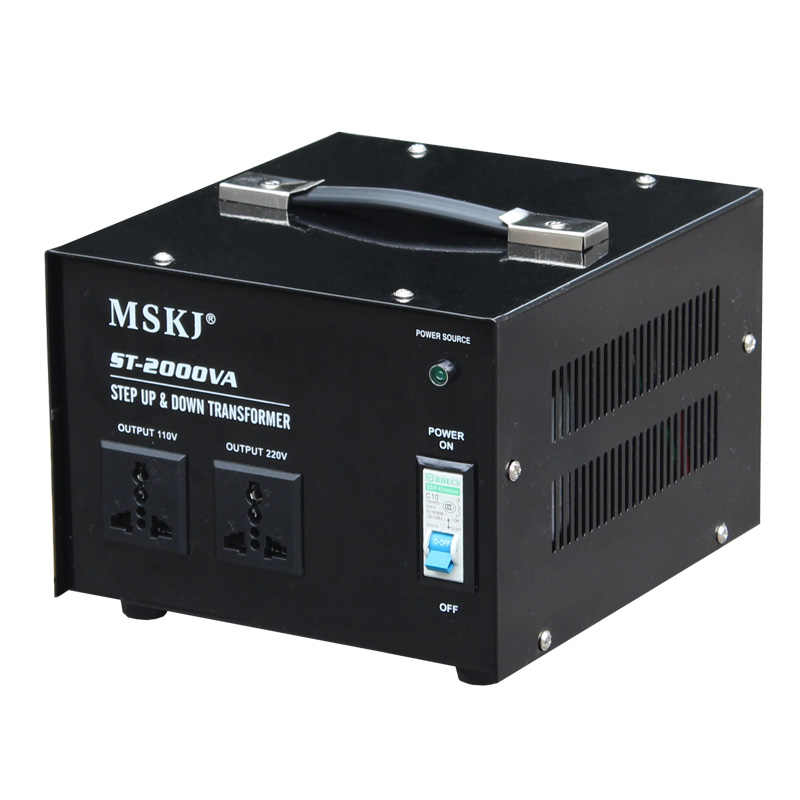

                            Now these seem to do it all
                            For cheap!!!
                            110V/220V in 110V/240V out 3000VA for the same sort of price I paid for my 2000VA some years ago around £50 - with free postage
                            https://www.ebay.co.uk/itm/220V-110V...a9ab448e2197d2
                            Or something like these for folks on 220V mains
                            220V in 110V out 3.3Kw
                            https://www.ebay.co.uk/itm/3-3-KVA-S...cAAOSwSXRc-nxJ
                            Buy two of these, connect the secondaries in series (make sure you have the secondary phase the correct way round!) and you have 220V in and 110V/220V out at 3300W for like £80
                            As many SMPS will run on 80V-240V input that also makes them a lot safer to work on if you feed them 110V isolated.

                              Is this isolation or just step? Autotransformers change voltage but do not provide isolation.
                              BTW a UPS powered by an isolated power supply is isolating. Another way to get an "isolation transformer" ...
                                Good question! I don't see the word isolation anywhere in the eBay add. I think that would be mentioned if it was a feature.
                                • clearchris
                                  • Dec 2013
                                  • 687
                                  Re: Isolation Transformer Build - Technical Questions
                                  dicky: Nice, is that in an oil bath?
                                  In regards to the ebay chinese transformer, that's far too cheap to be a real isolation transformer. You probably couldn't buy the copper (or even aluminum) wire for a 30a transformer for that price. If something like that were real, it would be a no-brainer.
                                  • R_J
                                    • Jun 2012
                                    • 9594

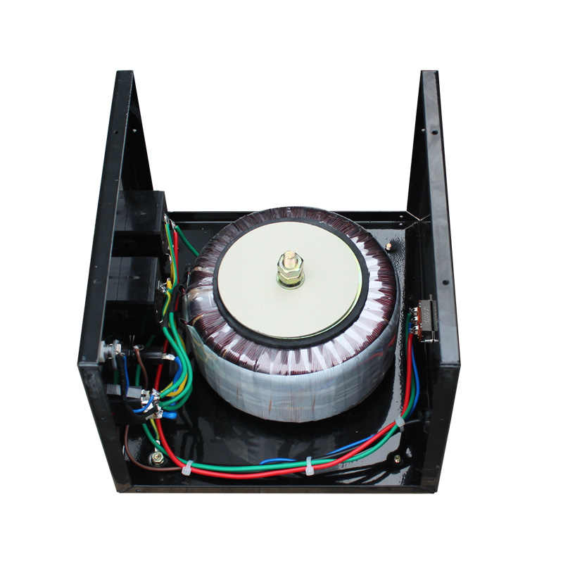

                                    There is a single toroid transformer inside but it is likely to be an autotransformer
                                    • eccerr0r
                                      Solder Sloth
                                      • Nov 2012
                                      • 8701
                                      That's really fancy having a toroid transformer inside! Or does it?
                                      Having a huge toroid transformer would cost a pretty penny due to the costs of winding such with a really heavy core...

                                        I was referring to this one dicky96 posted https://www.ebay.co.uk/itm/220V-110V...a9ab448e2197d2
                                        This looks very similar (different name) but has an internal picture https://www.aliexpress.com/i/32858021991.html
