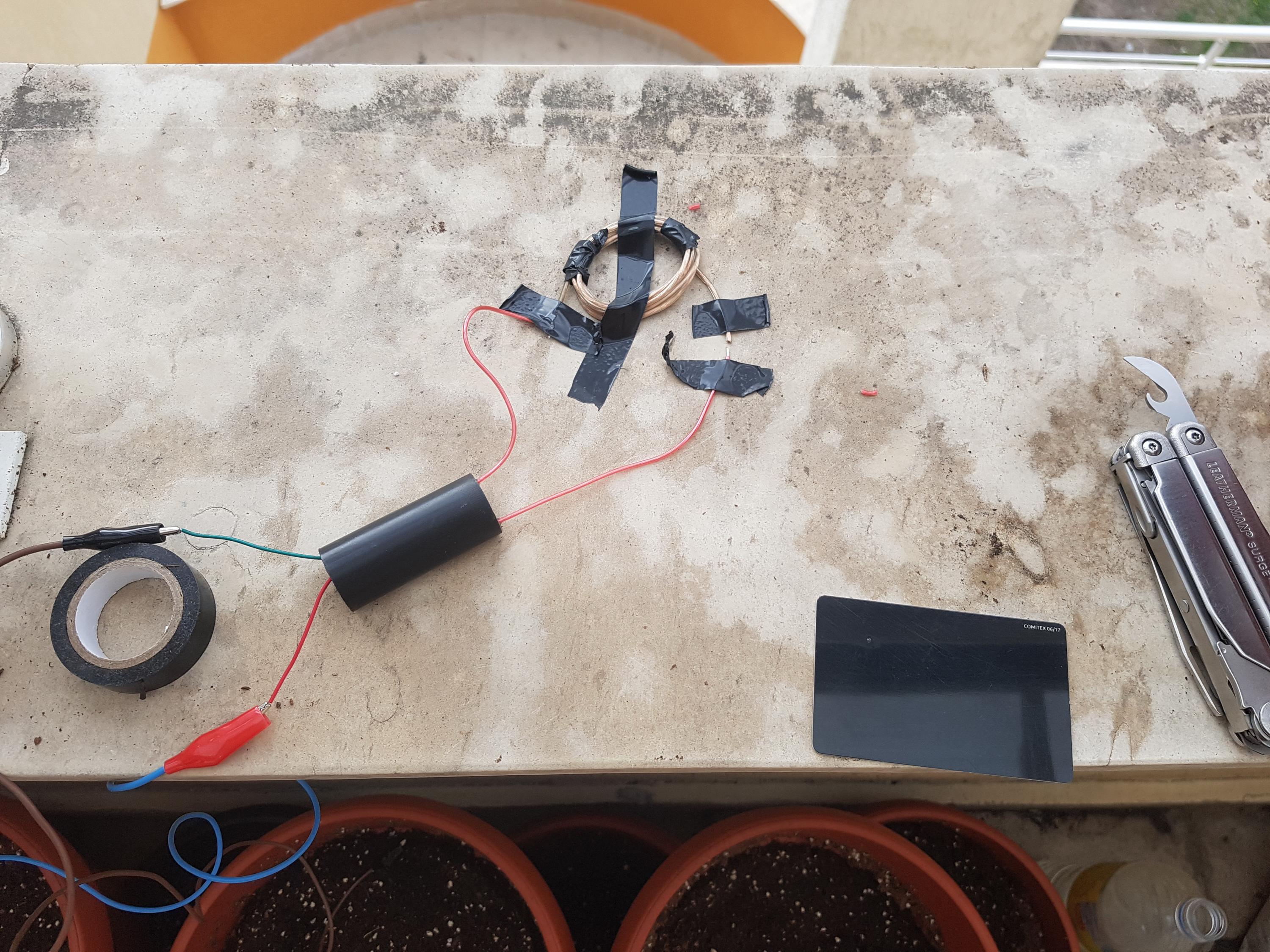

    Howdy everyone.
    Some background - I'm bored AF.. you know.. lockdowns.. closed gyms, pubs, bars... stay home.. etc.. and just got my new passport. This time it contains RFID with some biometrics.. and I'm not comfortable with that.
    Yes, yes, I know it is illegal to temper with official documents and stuff.. but I also like my privacy.
    So I was thinking about how to kill the rfid without leaving any traces.. and I remembered that I have one of those taser modules ( only the high-voltage module ).
    Here is what I'm thinking:
    -get a very strong light and see what antenna is embedded in the passport ( by the way it can be read with a phone )
    -find a similar antenna from rfid sticker or make one from few coils of copper wire
    -connect the antenna to one of the taser module outputs
    -let the spark jump between the antenna and the other taser output
    -put the passport close to the taser antenna
    -let the mo**erfocker burn! Burn, mo**erfocker, burn!
    So, do you think this will work?

    Re: RFID zapper
    no,
    it works by using a coil to receive energy that charges a cap to power the chip(s)
    if you want to wreck one you overload the coil with a big alternating magnetic field.
    maybe with a bulk tape eraser or a degausing wand/gun
    you see supermarkets use them to disable the stickers with a coil in them at the checkout.
    actually a spark discharge may corrupt the memory though. - but you have no way to know.

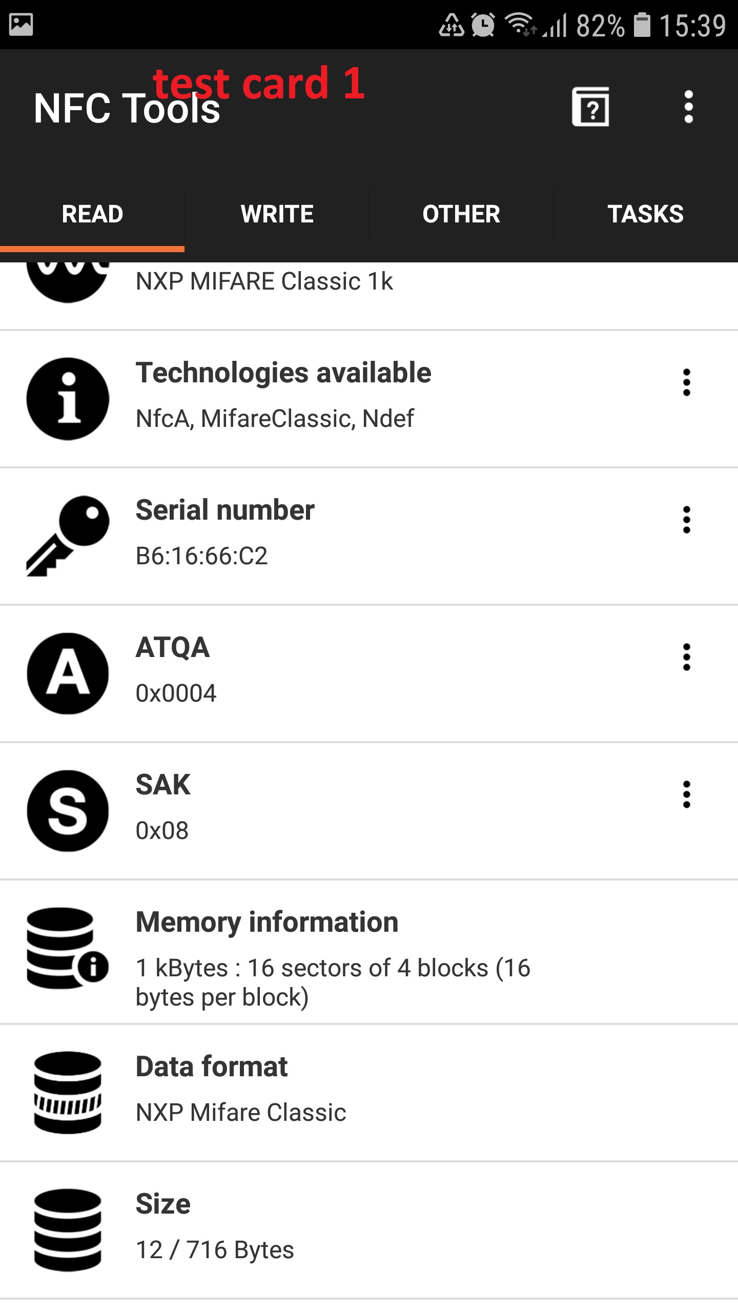

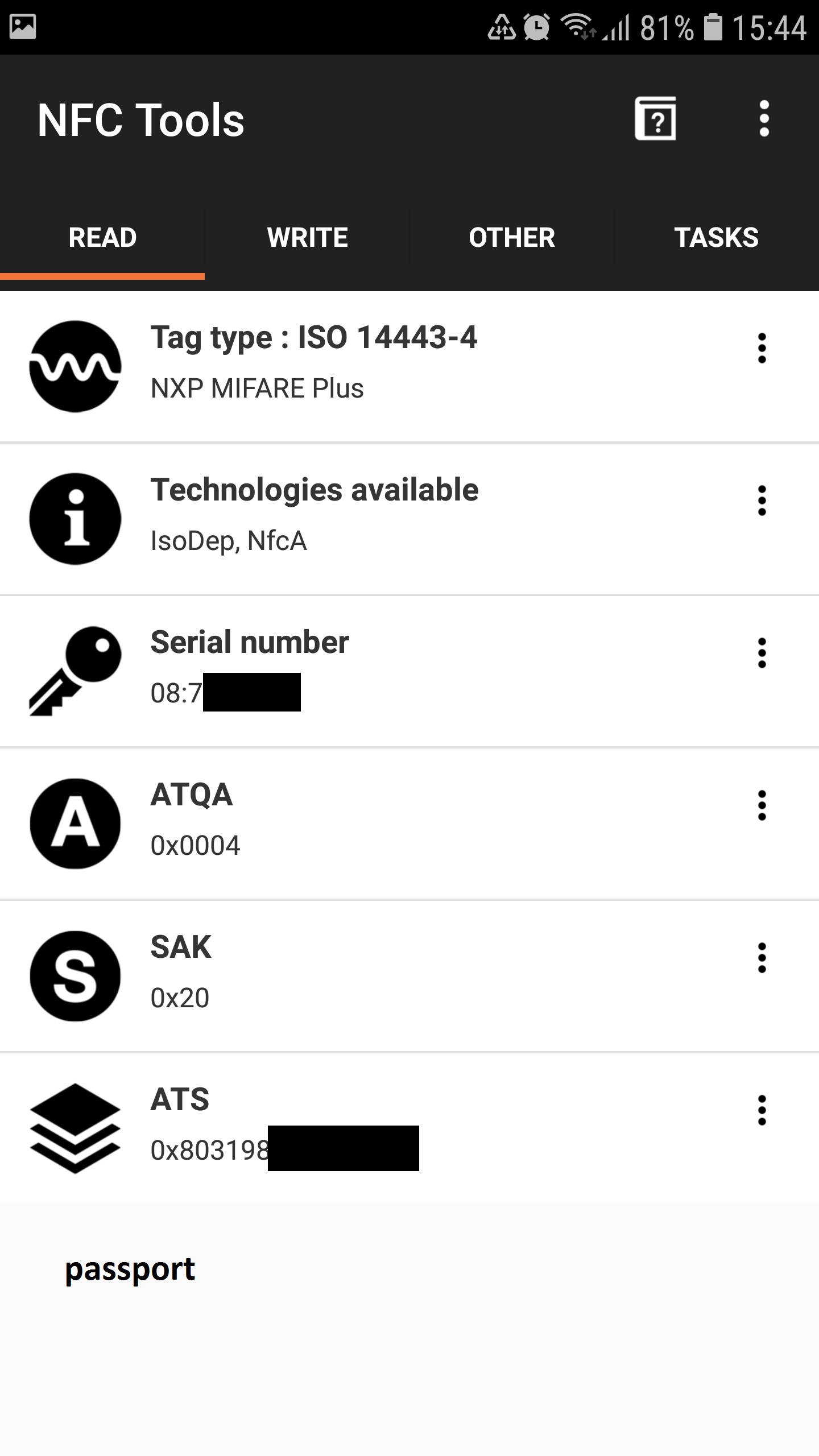

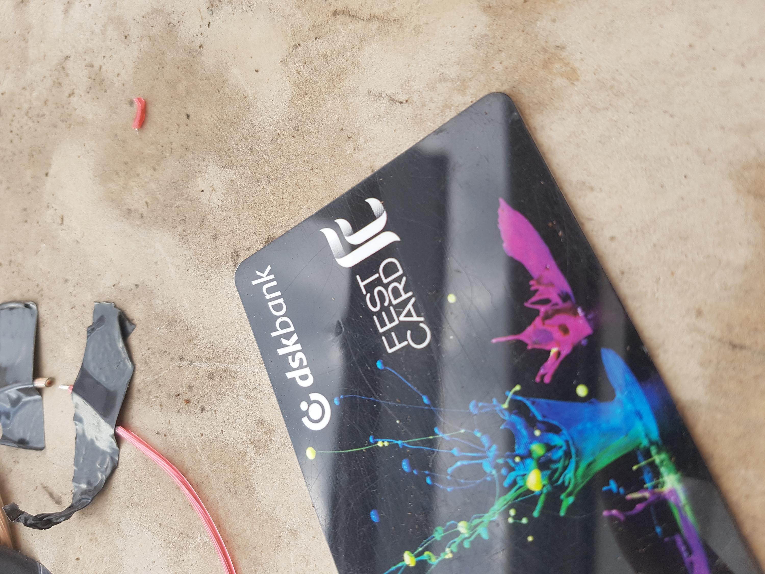

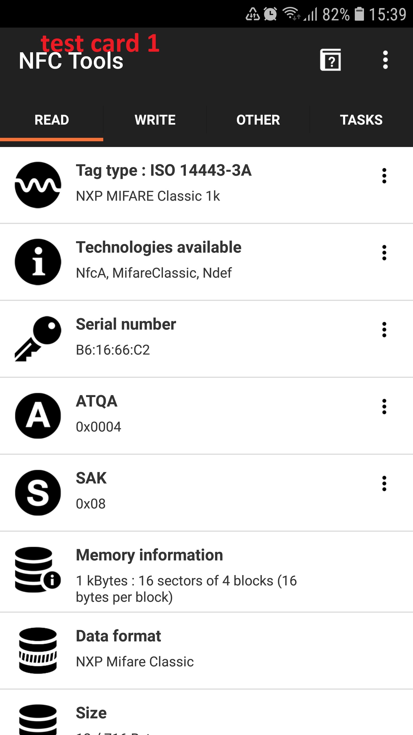

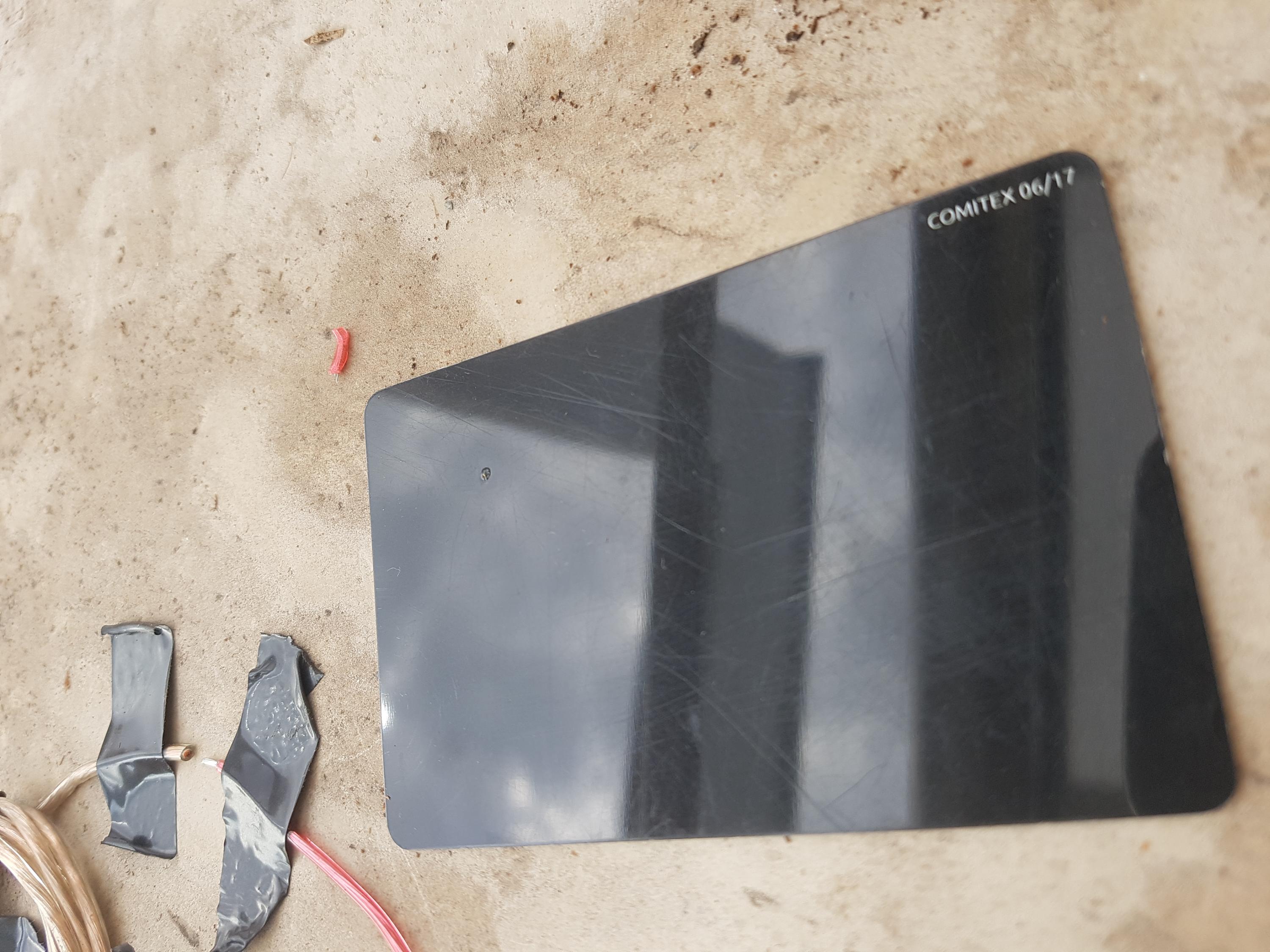

      Well, today was the day .
      See the photos for the setup and some result images.
      So first I tried it on a RFID fest card and I must admit, I overcooked it.. I left the taser on for about 5 seconds and now there is a visible melt dot on one side of the card and a bulge on the other.
      Test 2 - similar RFID fest card, but this time I just touched the battery with the wire.. so I guess just few milliseconds. Nothing visible on the card, but no more readable on the phone.
      The real deal - the passport. First confirmed that the phone can detect it.
      A little zap as in test 2 and the phone no more detects it. No visible marks.
      So I guess mission accomplished. Due to the current viral situation I guess I'll not be able to test the passport on any border soon, but I will post if any issues appear .

                  Re: RFID zapper
                  The victim's antenna is placed right over the coil.
                  I used this wire gauge, because this was the first copper wire I saw ... but I guess anything that can handle few hundreds of kV pulses without melting will do the work.
                  The windings are 7 .. that's how many I counted on an RFID sticker.
                  The idea ( at least in my head ) is that the coil charge/discharge will induce similar in the victim's antenna which will kill the chip.
                  I guess if you shorten all pins of the chip you want to protect and then ground/earth them you might be able to save it and meanwhile kill the RFID. Still, if you do not have at least one extra card for tests, it will better just to puncture the RFID chip.
                  By the way, just tried to cook an old ipod mp3 player... no luck.. I guess due to the massive metal back cover.
