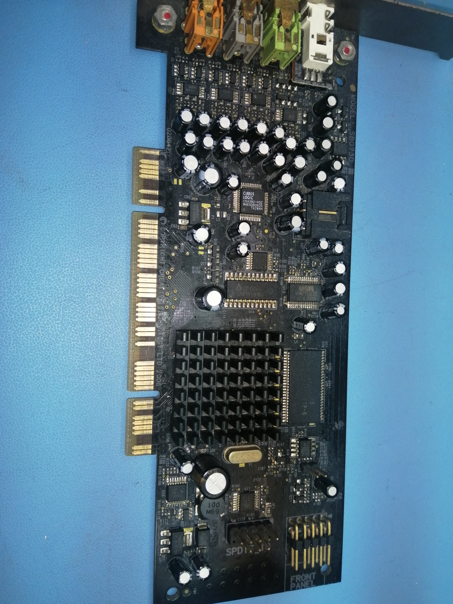

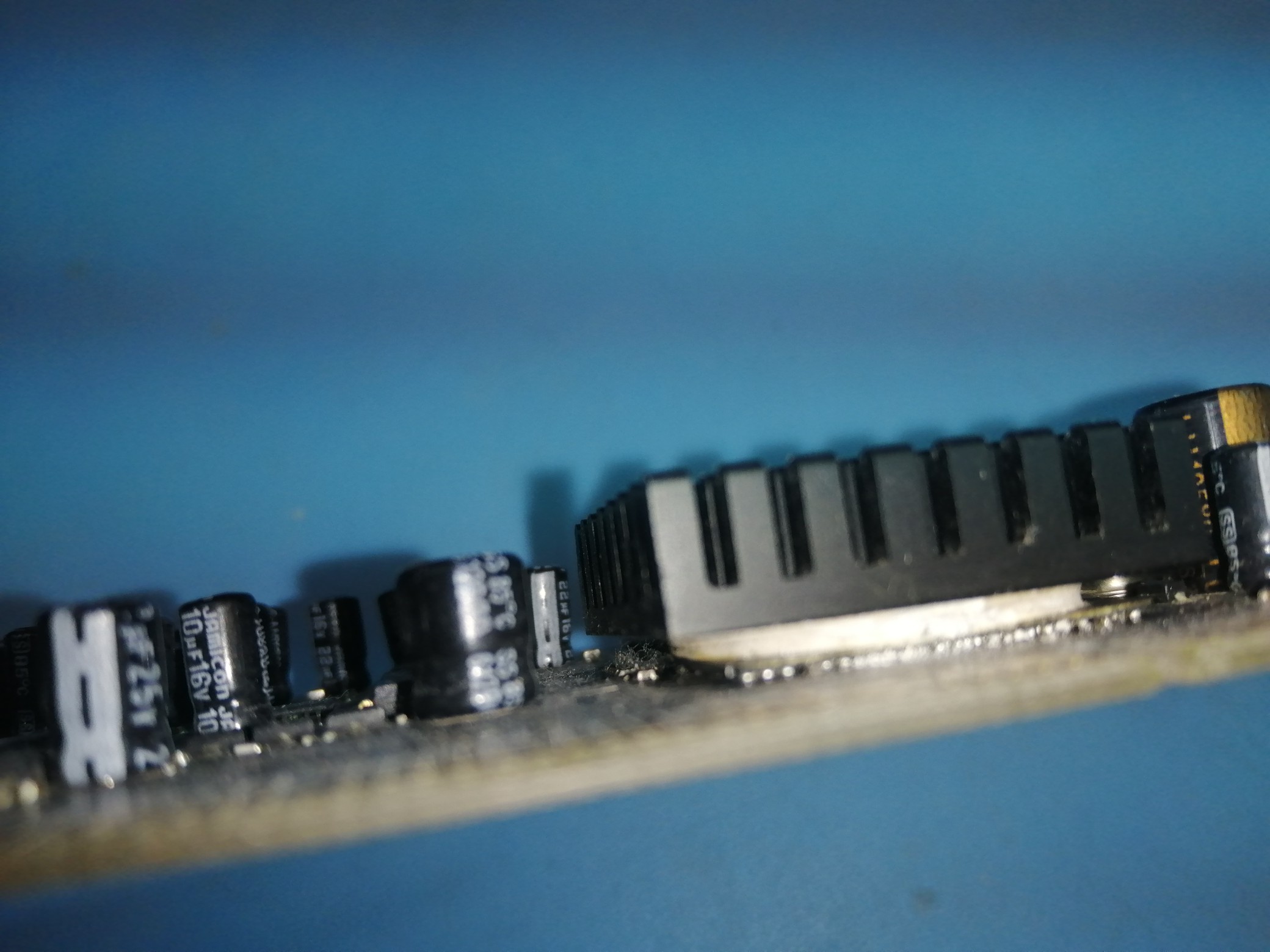

          Here are a couple examples
          The first is a Soundblaster X-Fi ExtremeGamer PCI card that is not detected by the PC and installing the drivers says the hardware is not present
          However if I press down hard on the heatsink it will detect though it generally 'disappears' before the driver has completely installed causing the PC to crash
          So I thought that would be a good one to practice on

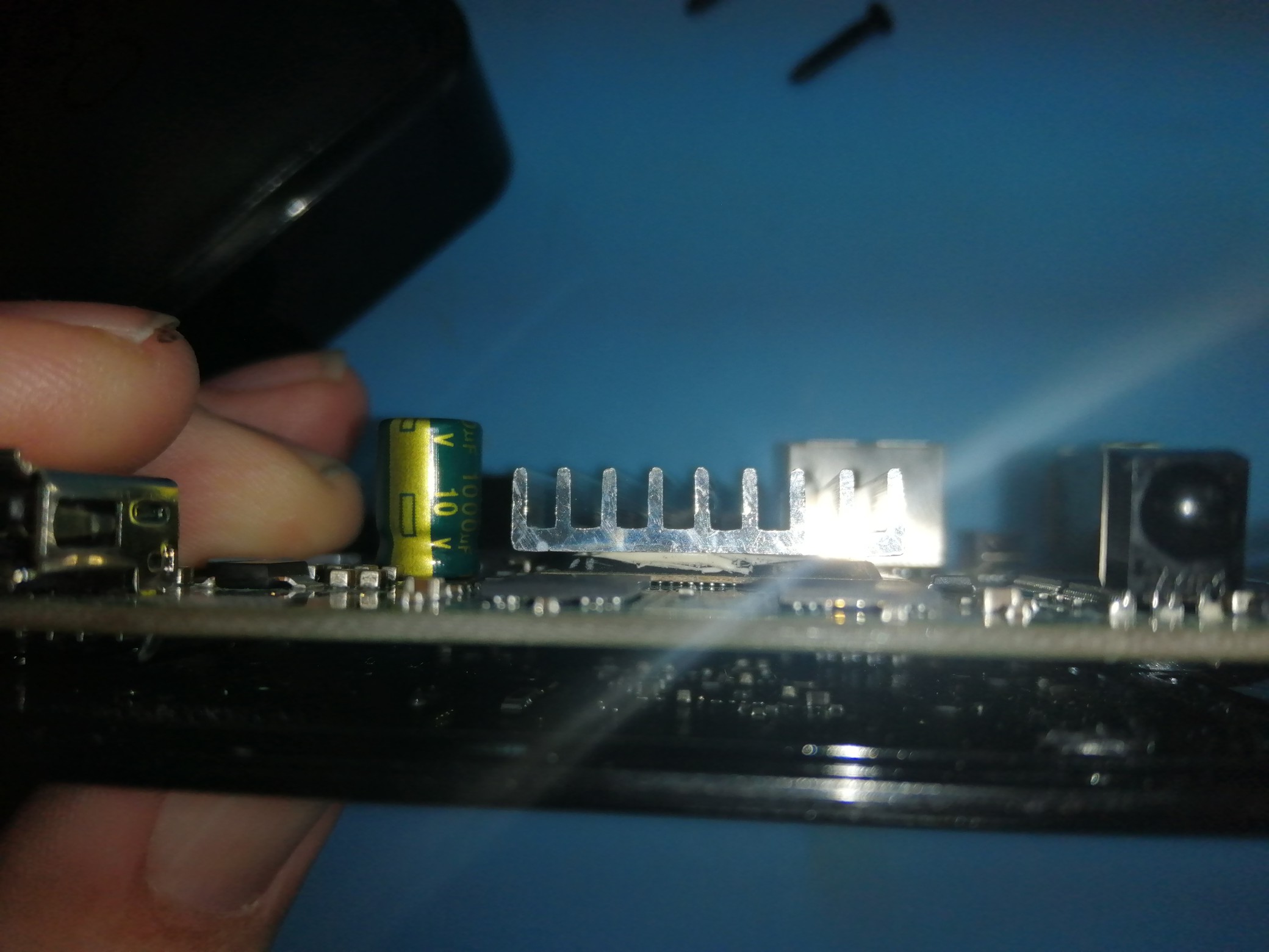

          The last pic is a MAG 250 - I have a box full of these faulty, sometimes it is the buck regulator chips fail and I fix them easily but the ones I have on one side have all the correct voltage rails but don't boot. I thought I would have a play with those as they don't owe me anythng. I can get replacement BGA chips cheap and they are not a programmable device according to the datasheet so it seems another good one to play with. Of course the fault could be something else.
          Problem is I can't get the heatsinks off.

              Re: How to remove heatsinks from BGA chips?
              It isn't rubbery it is rock hard. If I scratch at it as hard as I can with a Stanley knife I can chip little bits off. Maybe I could get a small hack saw blade down there

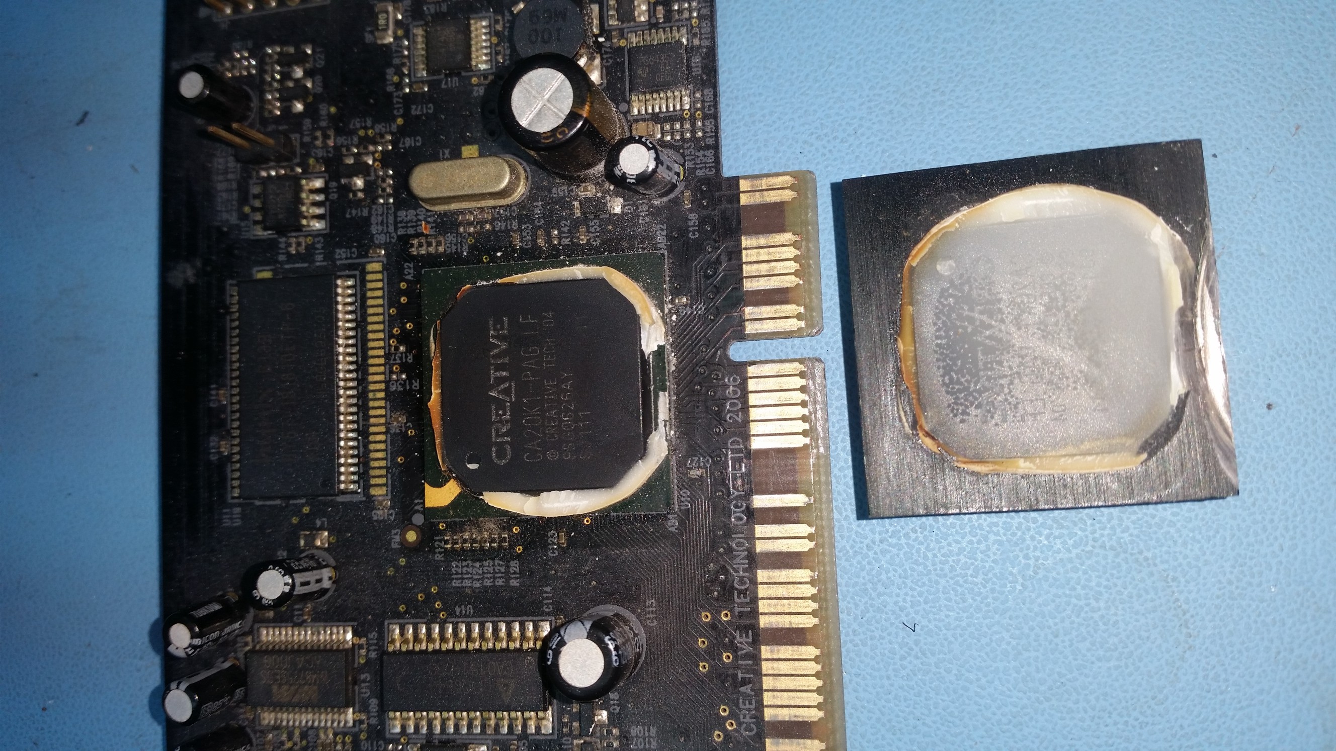

                          OK so I got the heat sink off
                          I managed to gt the cutting disk far enough into the cement to insert a flat blad screwdriver between the heatsink and the top of the BGA chip
                          Then I twisted the screwdriver with some fair amount of pressure and the heat sink popped off
                          So that technique definitely works. You can clearly see where the cutting wheel has rubbed on the heatsink but not on the BGA chip
                          The cement stuff, whatever it is, is rock hard
