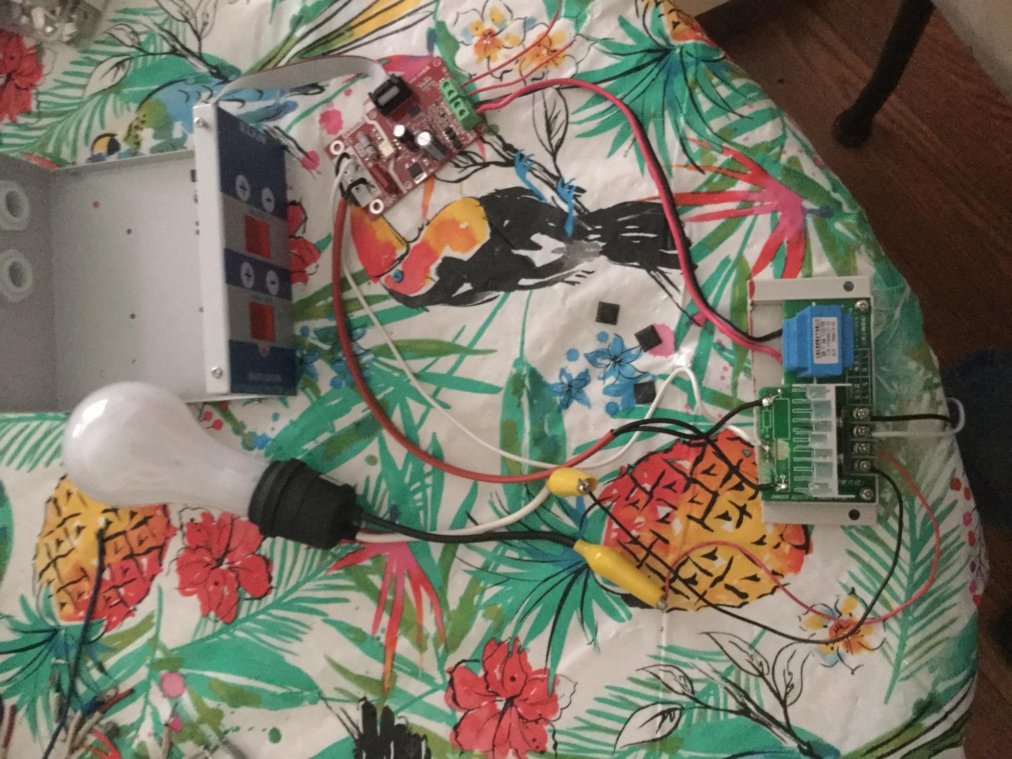

    The parts came in and I will see if I have time over weekend and see if I get something working

      Well I had time to work on this battery spot welder exterior controller
      The test results went well and the concept will work now I have mount everything in the controller case and fix the transformer and welder fixture and hook up amp meter and volt meter
        • Jul 2011
        • 6065
        Re: Modifing a Battery Spot Welder because of Controller Issues
        Update
        Well things did not go very well not everything would fit in this case so I had to go with plan “B” which is to cut down the the heat sink and put the triac back on the controller board again —>
        this actually went better than I thought it would in that I cut the heat sink the width as the triac and a piece of non conducive paper that is used for making battery packs and put it on the circuit board so it would not short out
        Now I have figure out how I am going to mount the small controller transformer and where
        I also have to figure out how to mount the amp and volt meters on the face plate of the welder which will be a challenge because of how the welder arms are
        There is also another challenge with welder arms because I change the configuration of the transformer secondary winding wires and where they go so I have to buy some welding wire that fit the welding arms
        I will post some pictures when I get done with this project
