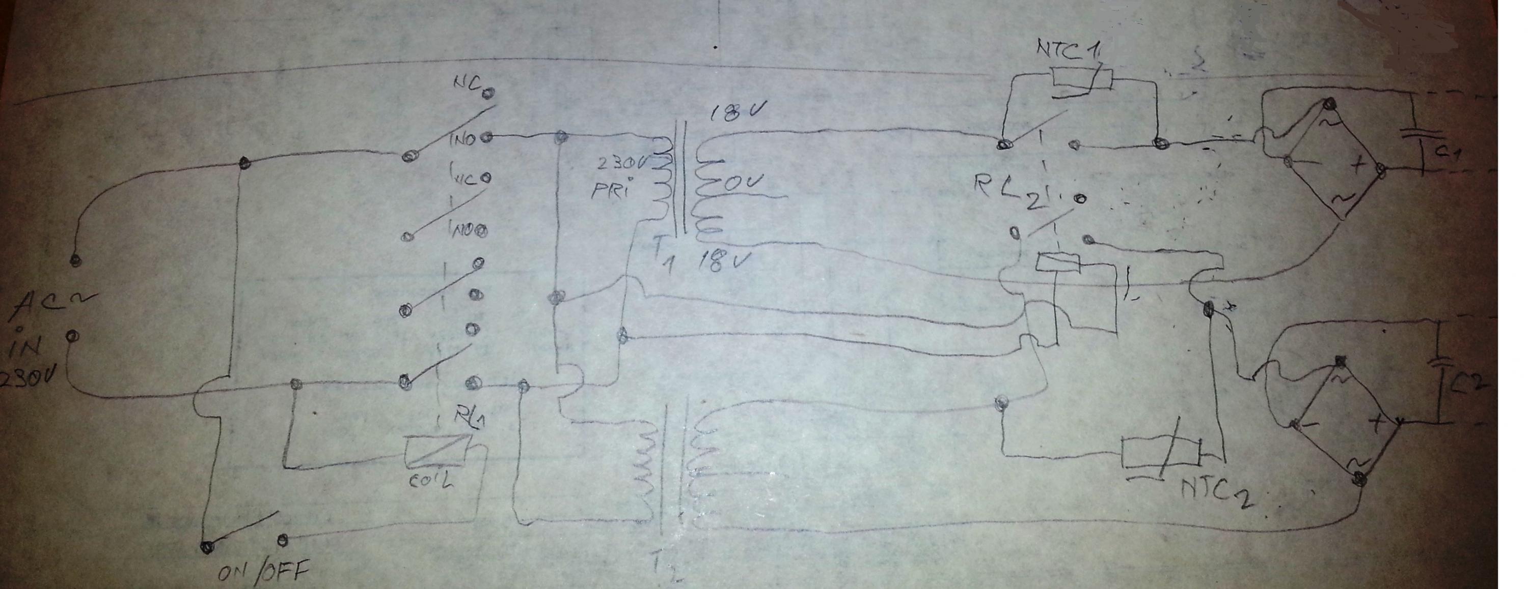

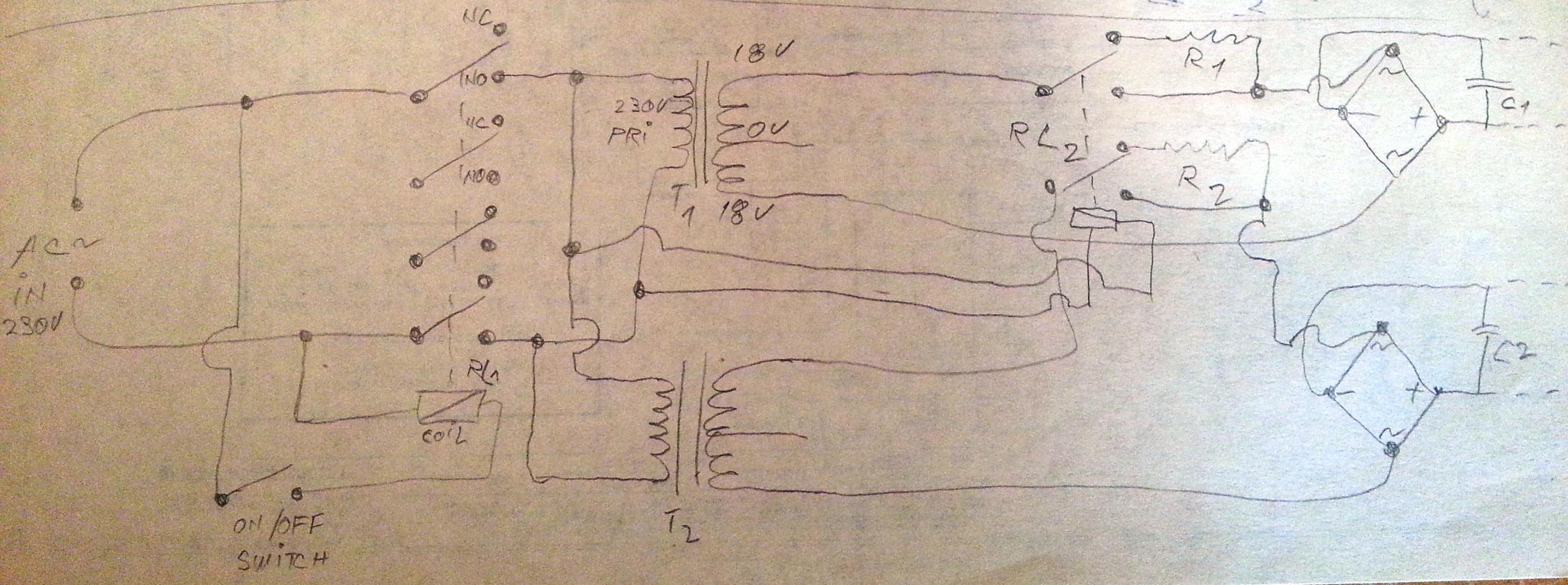

                  Here's what I concocted using the relays I was mentioning: RL1 closes immediately after the On/OFF switch is turned, thus sending power to the primaries of T1 and T2. RL2 is a time-delay relay which turns on after a few seconds, thus allowing C1 and C2 to charge slowly through R1 and R2. After a while, RL1 flips over, connecting the secondaries directly to the bridge rectifiers. This is the slightly more complicated version, since I could just omit RL1 entirely and have the primaries of the two transformers controlled directly by the switch, but unless it's a particularly beefy one, I wouldn't quite trust it for this application. Not sure if this design would pass any safety standards with 230v for RL1 straight on the power switch the user comes in contact with, but hey

                    the relay contacts are wrong,
                    the resistor / NTC(much better) should be inline at all times, and the relay should short across it.
                    the way you have it the relay will disconnect from the resistor allowing the cap to discharge before it connects again to the transformer.
                    the first relay will have to be a huge octal base job - you would be better just using a 20A 2pole rocker switch.

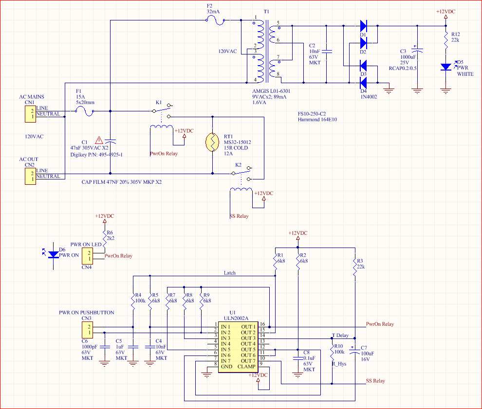

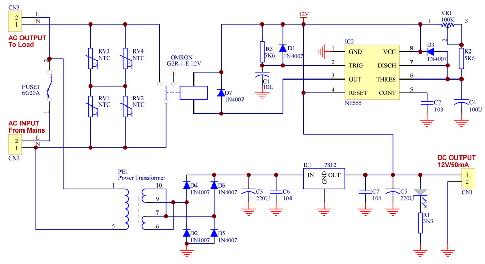

                      Inrush or soft-start circuits are usually two relays, one to turn on power and another to short out a NTC thermistor or resistor after a few seconds. They always have a small aux power transformer to provide relay power say 12V.
                      I made this one using a ULN2002 Darlington array but I forgot if it is a push-on/push-off power switch (flip flop) I had made. I eventually went MCU and used an ATtiny85.
                      There are 555 timer ones from china I can dig for the schematic - wait -found it and here is pcb pic. It sorta works, kinda cheap though.
                      You could add a NTC inrush limiter from a scrap power supply and something to switch on a relay when raw DC comes up close to your target voltage, and short out the NTC. Like a transistor and zener would work.

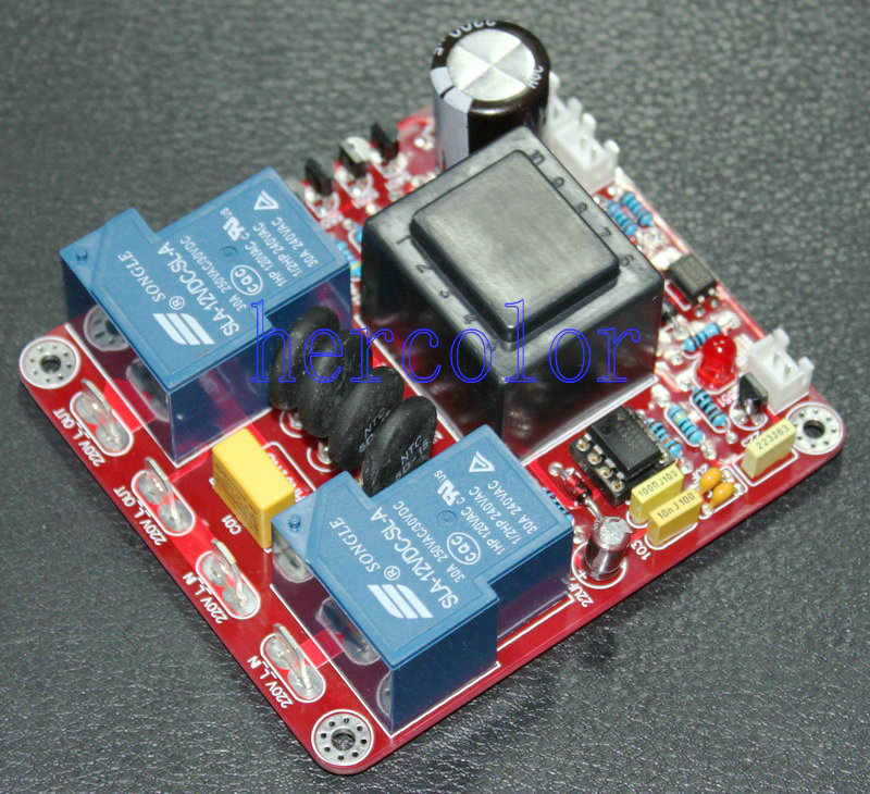

                        or just buy one, they sell units in some EU country's for use on stuff like tumble dryers.
                          Agreed, and I was aware of that to be honest, though I imagine the time it takes for the contacts to flip over is very short and with such large capacitance, it wouldn't lose much voltage.
                          I redid the schematic though like you suggested, with the timed relay shunting the NTCs. BTW, what value NTC should I use for such a setup ?

                            NTC value would have to be calculated based on the load current so it operates at a reasonable speed and doesnt just sit there not heating up, or worse yet - go nuclear on you!
                            as for switch and relay contacts, overrate them by atleast 2x because it's an inductive load.

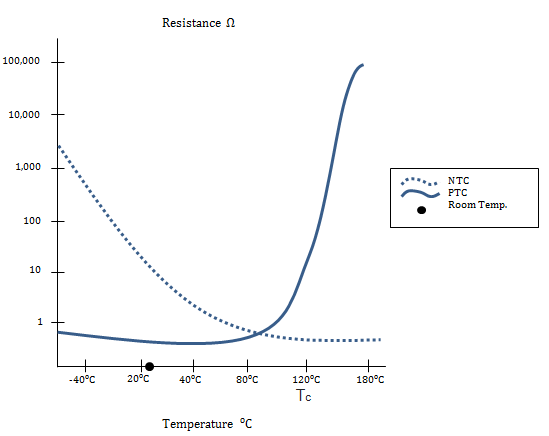

                                          Yes that calculator works, energy in a capacitor is 1/2*C*V^2 so I got 2x 10,000uF to 48V for 23J. The NTC inrush limiters need to be rated for the energy they might have to limit. Too little and they don't warm up much and too much and they get hot and take forever.
                                          You can use a light bulb to limit inrush a bit, I was saying 10 ohms is what I see all the time plus wiring and transformer resistance but that might be too low for 230V systems. Look in your junkbox and see what you have.
                                          I get mixed up NTC or PTC and that website I gave somehow uses either to limit inrush current.
