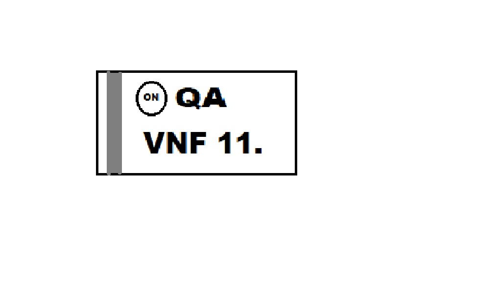

    Smd Diode?
    Hello There
    I have a semiconductor Spare Parts.
    smd diode
    clear example of tag indicate
    i don't know what is a Value of this Diode V(Volt)=? A(Ampere)=?
    i need a Datasheet.
    TIA

    i think it's a TVS, a fast zener - probably 11v
    what's it from?

      I believe it is a ON Semi NSA5.0AT3G

        2TB Seagate MOBO (pcb logic Board)
          Thanks Bro
          But We need the Complete Info

            What info do you want??? I posted the datasheet
            It's for protection on the +5 volt line of your drive.

              lol, you dont get more complete than a datasheet!
                . i forgot the supplied @ 5V...
