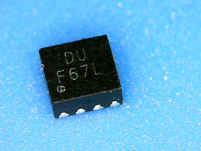

    hi friends
    I have the following marketing id on the chip as in pics> DU F67L...

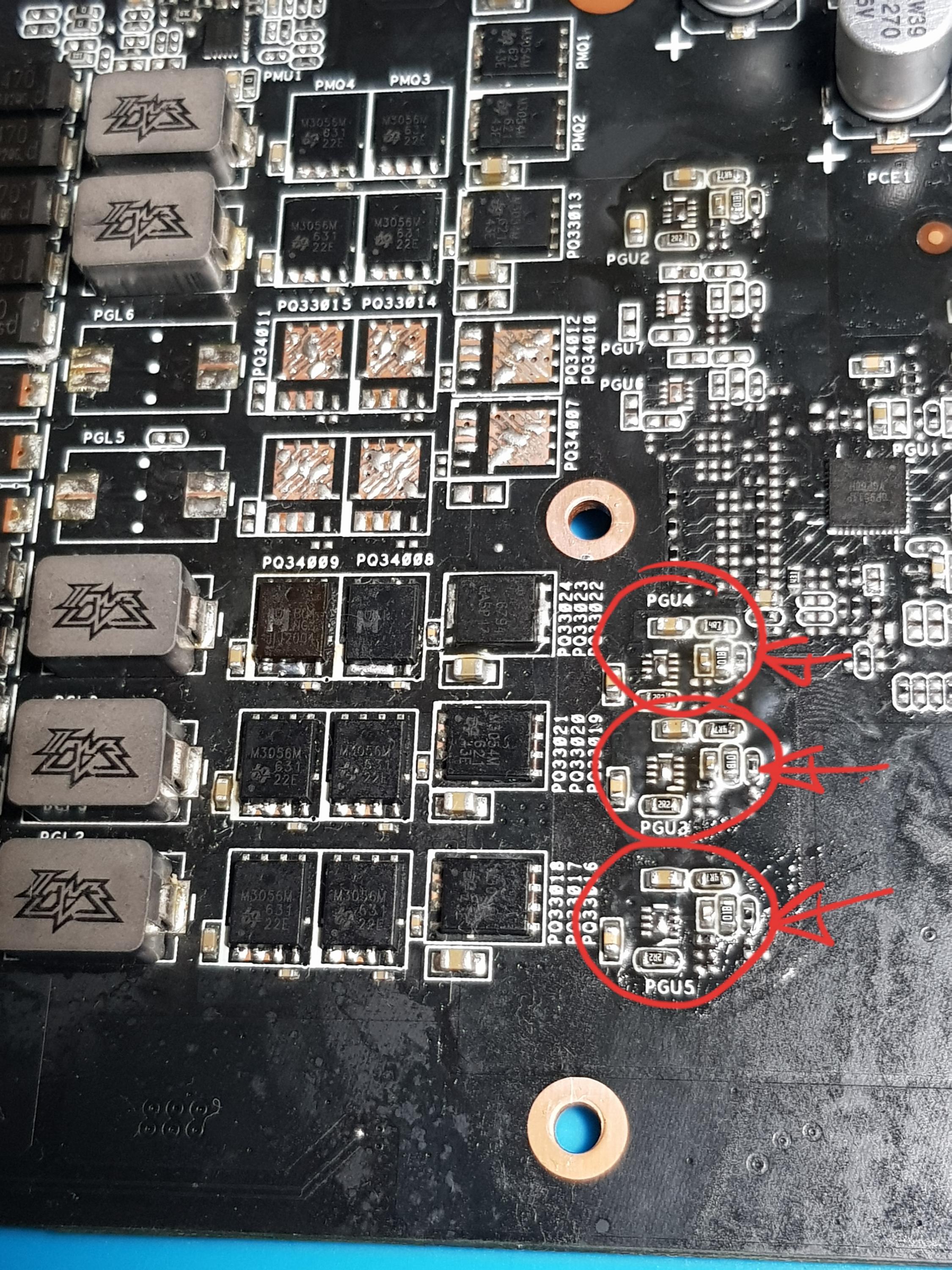

    it belongs to nvidia 1060 graphic card... these 4 ics were shorted to ground after one of the mosfets failed. but I don't have any idea to what are they to order them online. and would really appreciate any help with this matter...

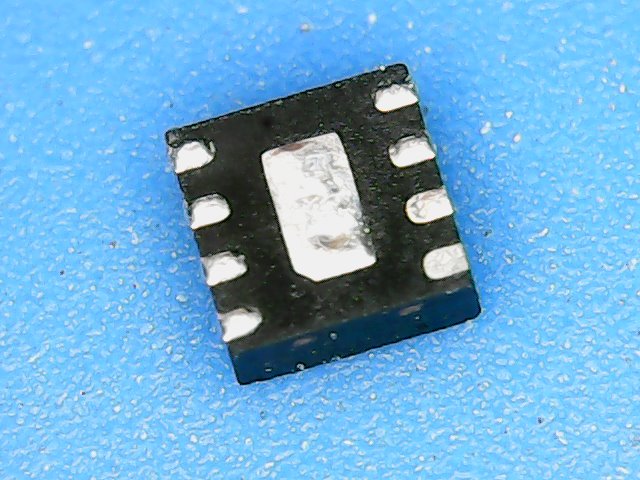

    I really am not turning up anything either. It looks like an 8 lead dfn package.. if that helps at all. lol I'm pretty bad with manufacture marks so I'm not sure who made the chip either. :/ You might be better off finding a parts card off of ebay and taking them from that. Though, it's possible the parts card will have the same dead parts on it..

      You're probably gonna have a hard time discovering the actual chips.
      They're gate drivers or phase drivers, whatever it's called - it's chips between the vrm controller and the two mosfets for each phase (or in your case 1 hi-side mosfet and 2 lo-side mosfets in parallel for lower losses)
      Maybe search reviews for gtx1060 cards and see if review is detailed enough to list them but i doubt it.

          Hi
          thanks for the reply. and my apologies for the late reply.
          yes it seems to me that they are gate or phase drivers too. and yes they are connected to 2xmosfet per phase.
          however, in my case they seems to work as fuses! because one of the mosfets was shorted. not to ground but to 12v feed line. therefore, I was assuming that the mosfet output damaged the GPU. but I am feeding the GPU though the same line with 0.9v and it seems to take under 1amp which does seems a good news.
          now with those drivers attached to the board the card is not working at. and the driver are shorted to ground. all of the 3 drivers. apparently, one of the GPU feeding mosfets has failed but these drivers protected the gpu from possible frying even.

            Hi, it should be a uP1959 from upi semi (https://www.upi-semi.com/), the top marking is DU, https://html.alldatasheet.com/html-p.../1/UP1959.html
