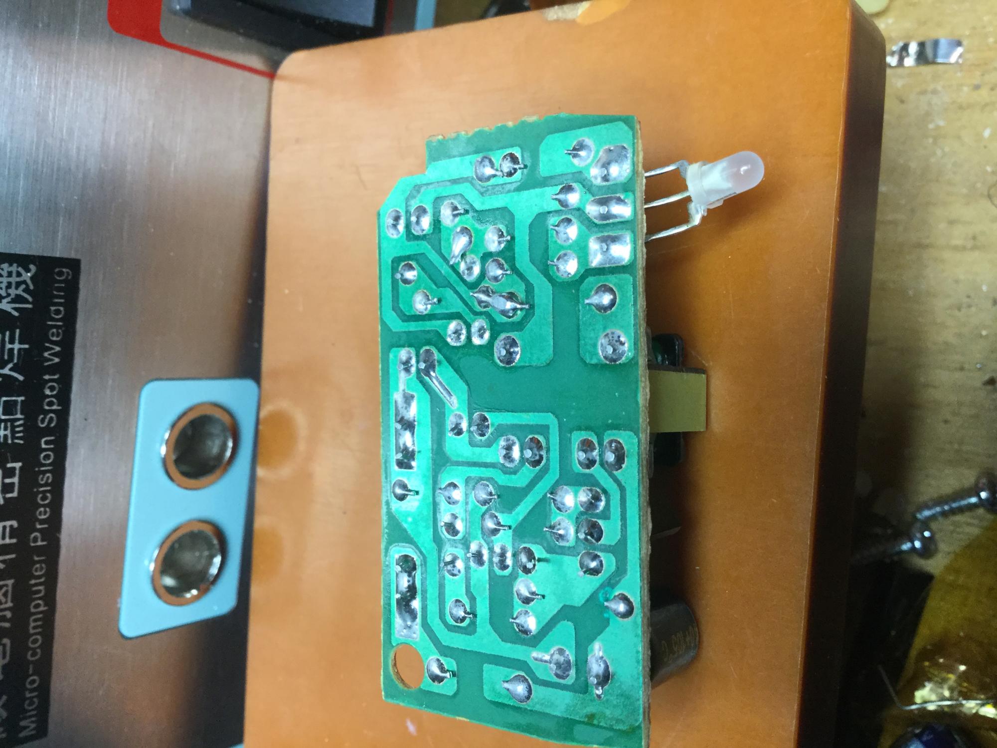

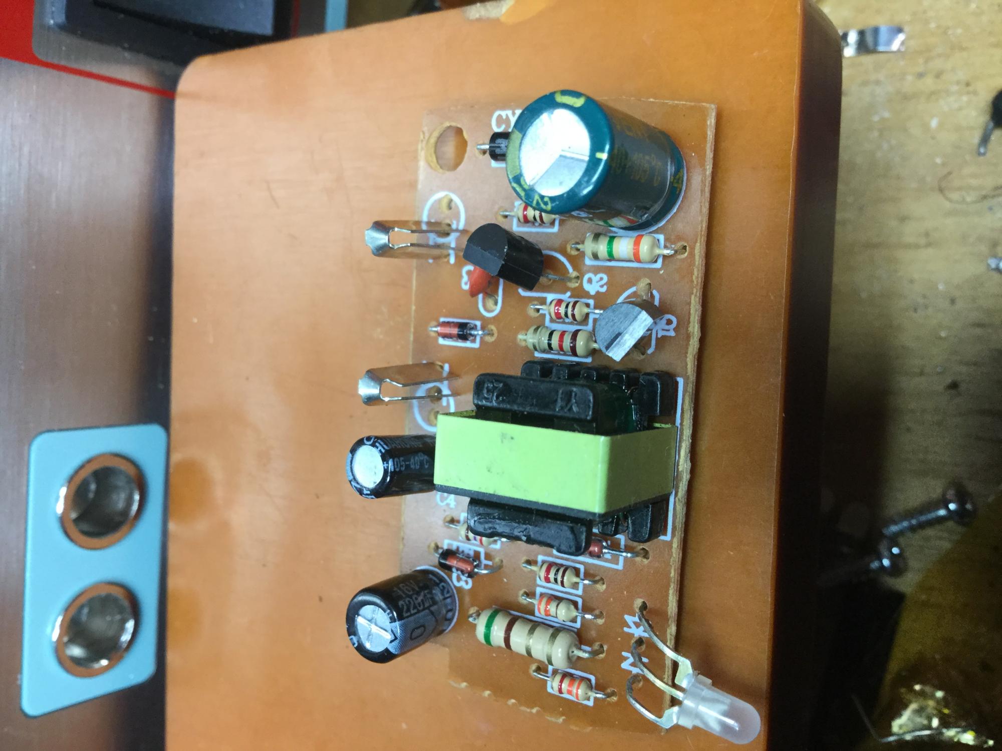

    Here are some pictures of the switching power supply for this flashlight
    I have a use for this switching power supply I going to run some LED lights off it it says 4.2 volts @ 500 milliamperes

      i doubt that will pass a hipot test.
      not enough separation.
      no opto either.
      no cc/cv charge control.
      it just floats the cell at 4.2v
      thats a nono for li-ion.
      kill it with fire before it kills you with fire!

          This is why it going to get a 0.500 milliamperes in-line fuse on the input
          on these two switching power supply and use some real cheap LEDs so I do not care what happens to them I want to see some carnage some smoke and maybe some fire but I do not think I going to get that lucky
