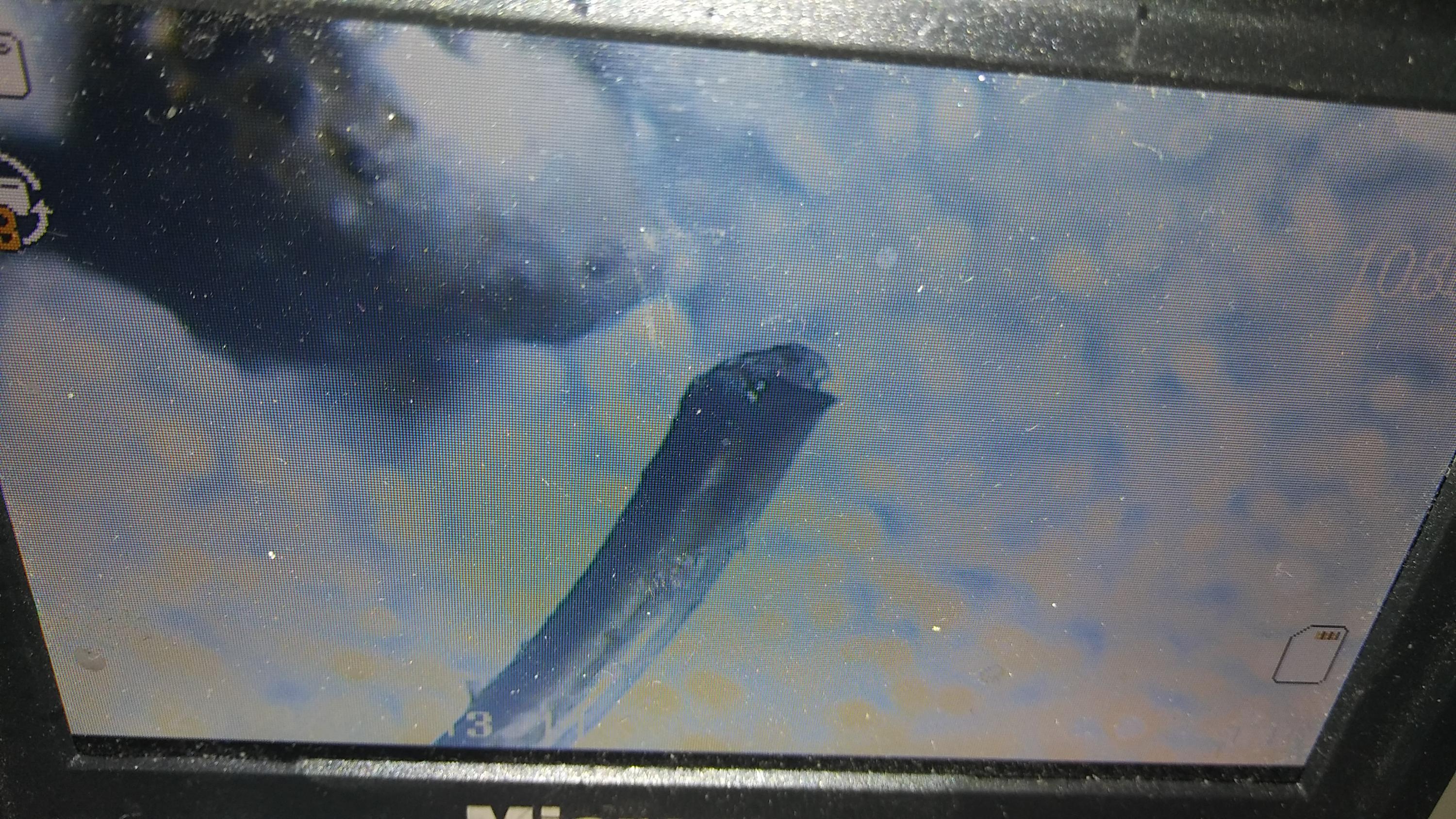

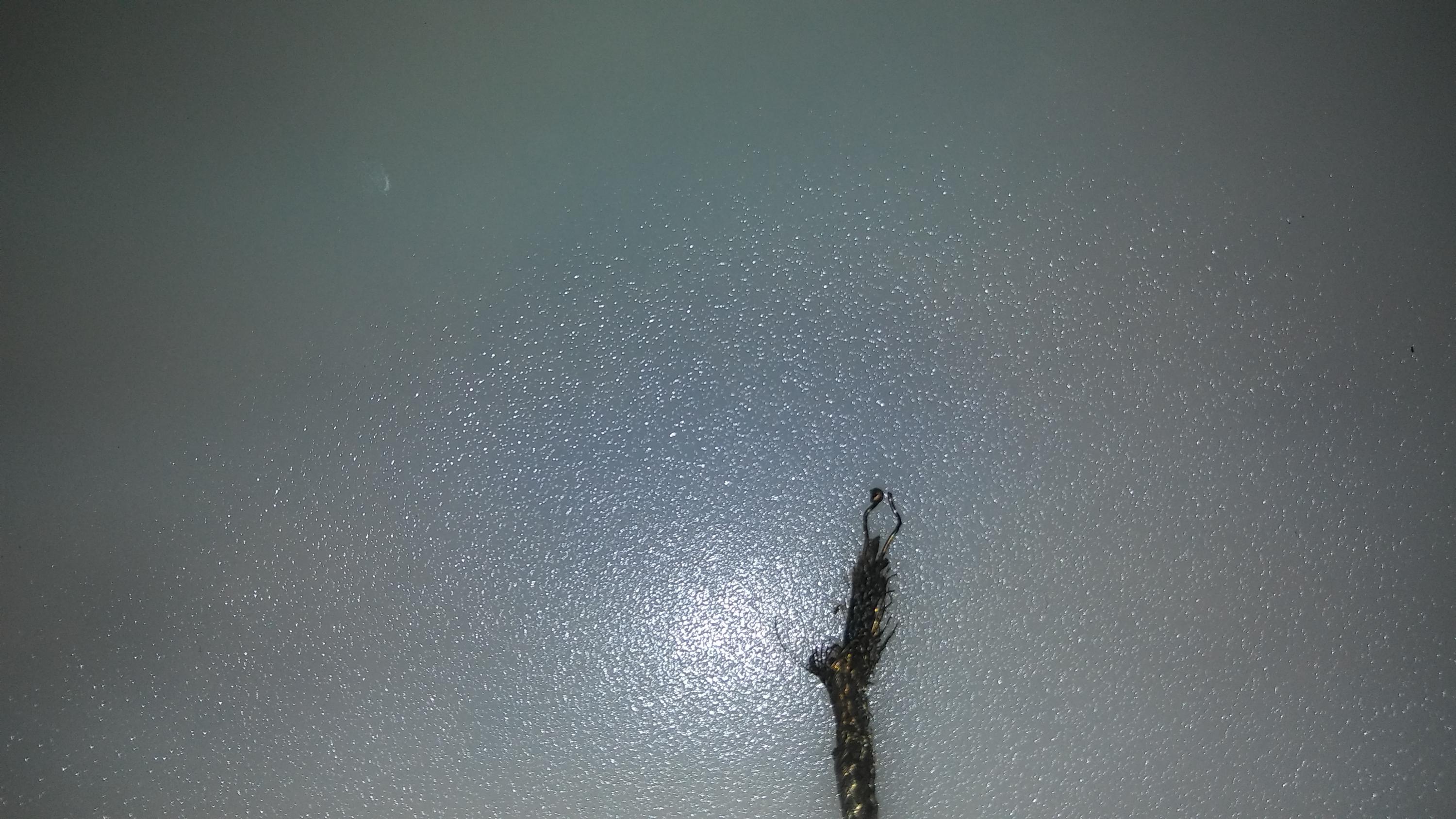

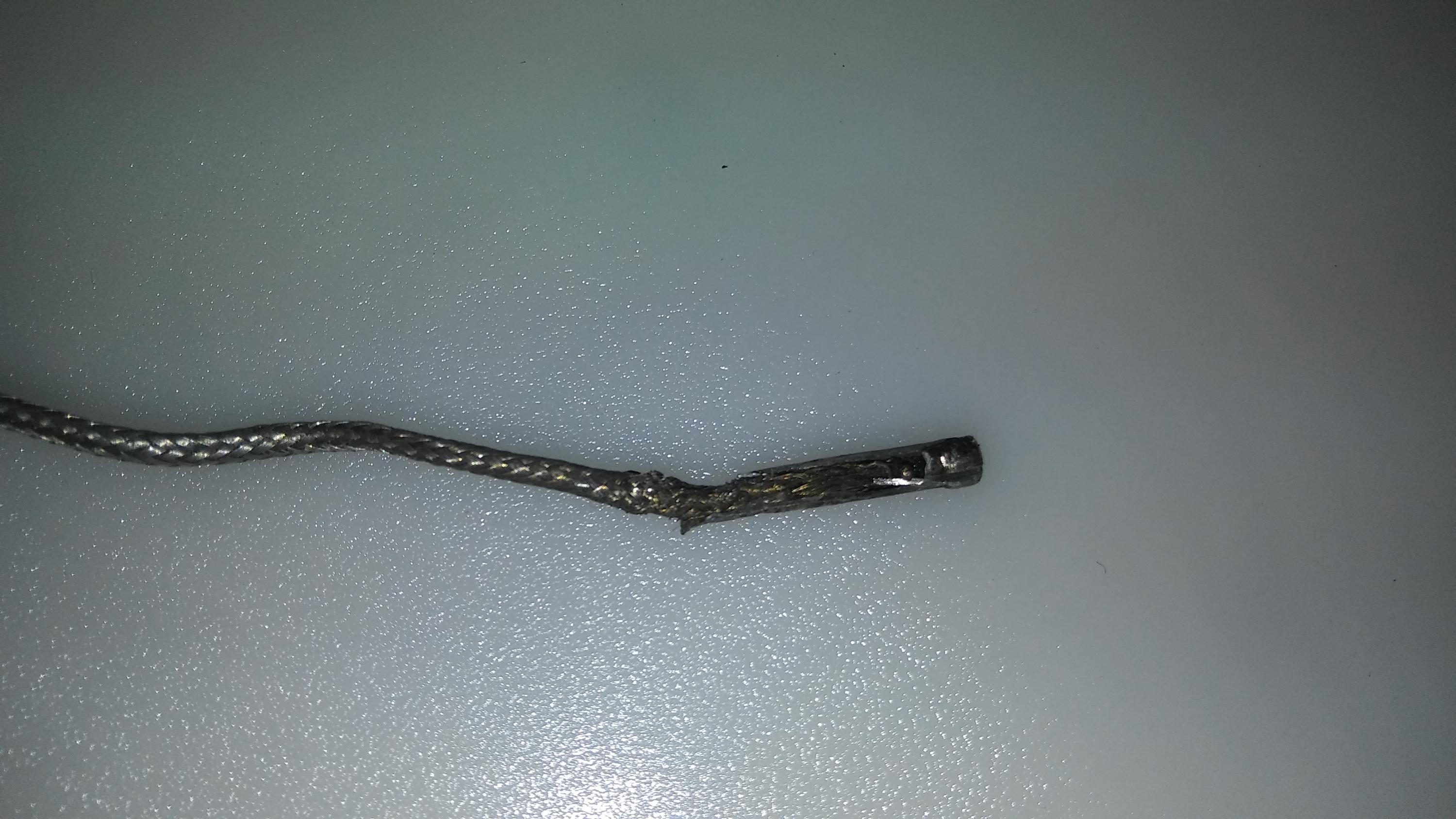

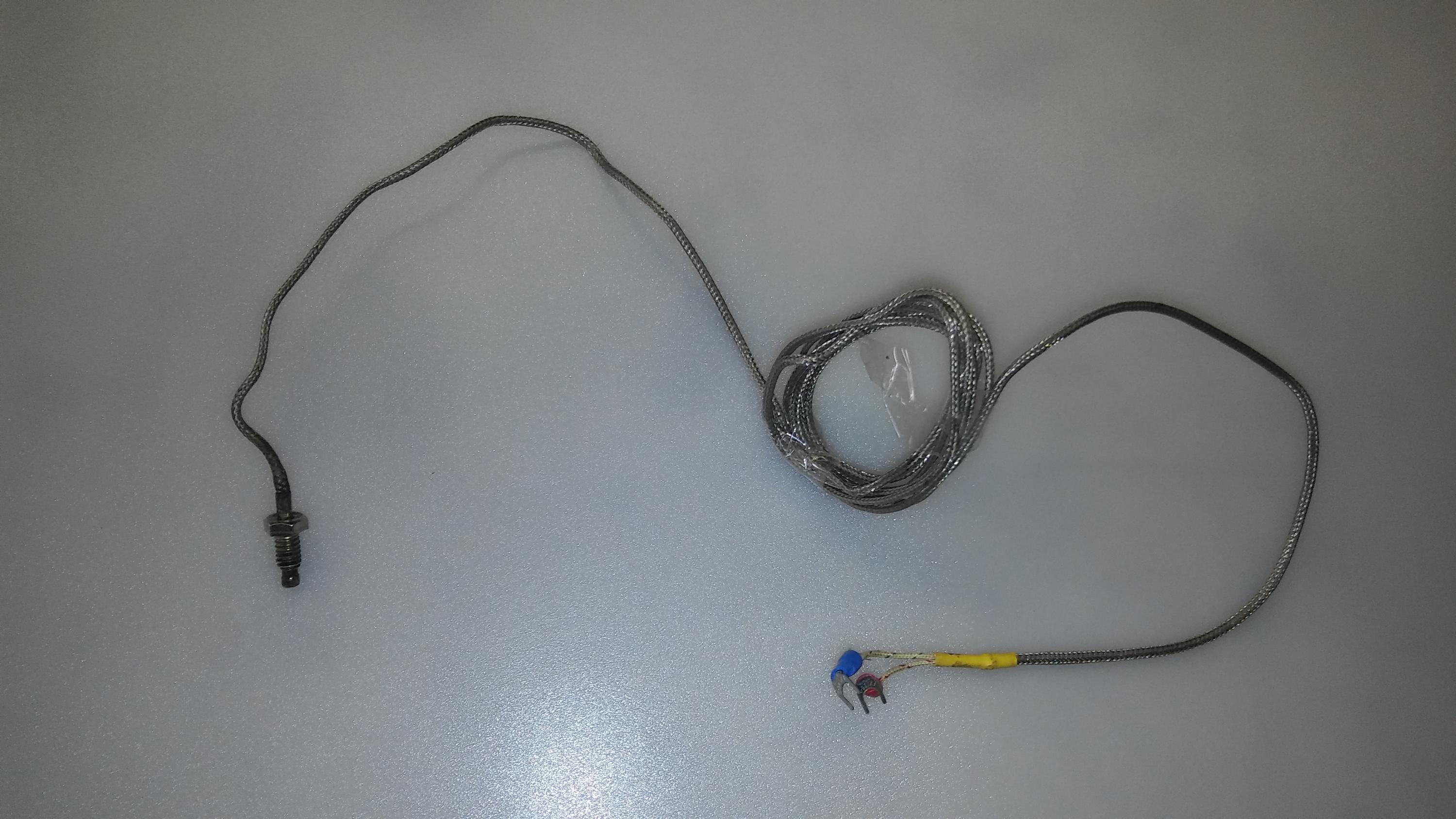

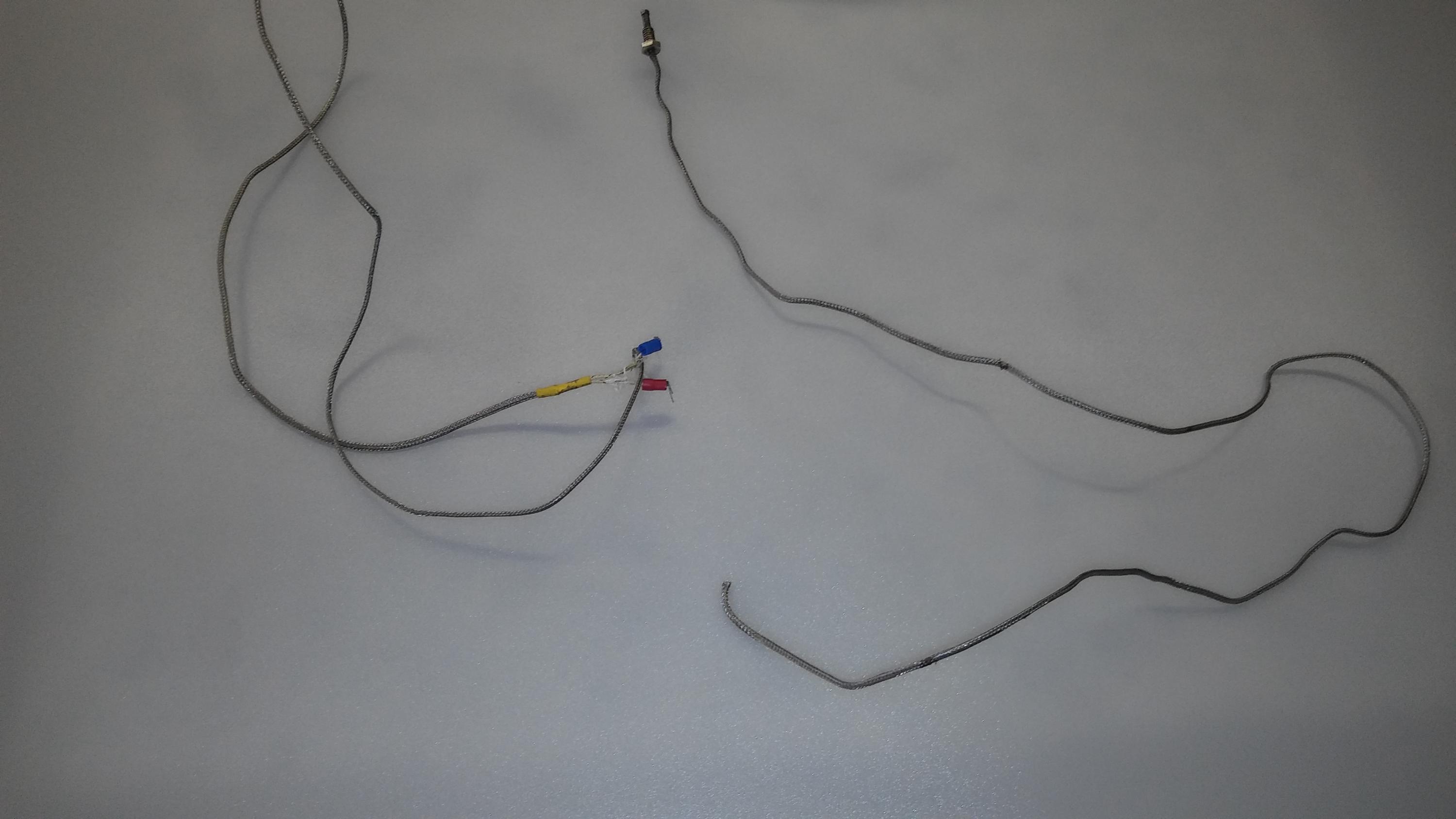

    I have 3 thermocouples which I bought from Aliexpress has 2 meters long, very inconvenience to use. my question is thermocouple is two metal welded together. can I cut it then weld to make multi thermocouple?
    I cut open the one is not working, the wires are separated can I weld it and fix it?

    Does it work when you put them together if so then yes if you can welded if you can do it with out distorting the two wires
    Or you can twist the two wires together and use a wire crimp and cut the end off of it
    I have done this on “ K “ type before and work very well
