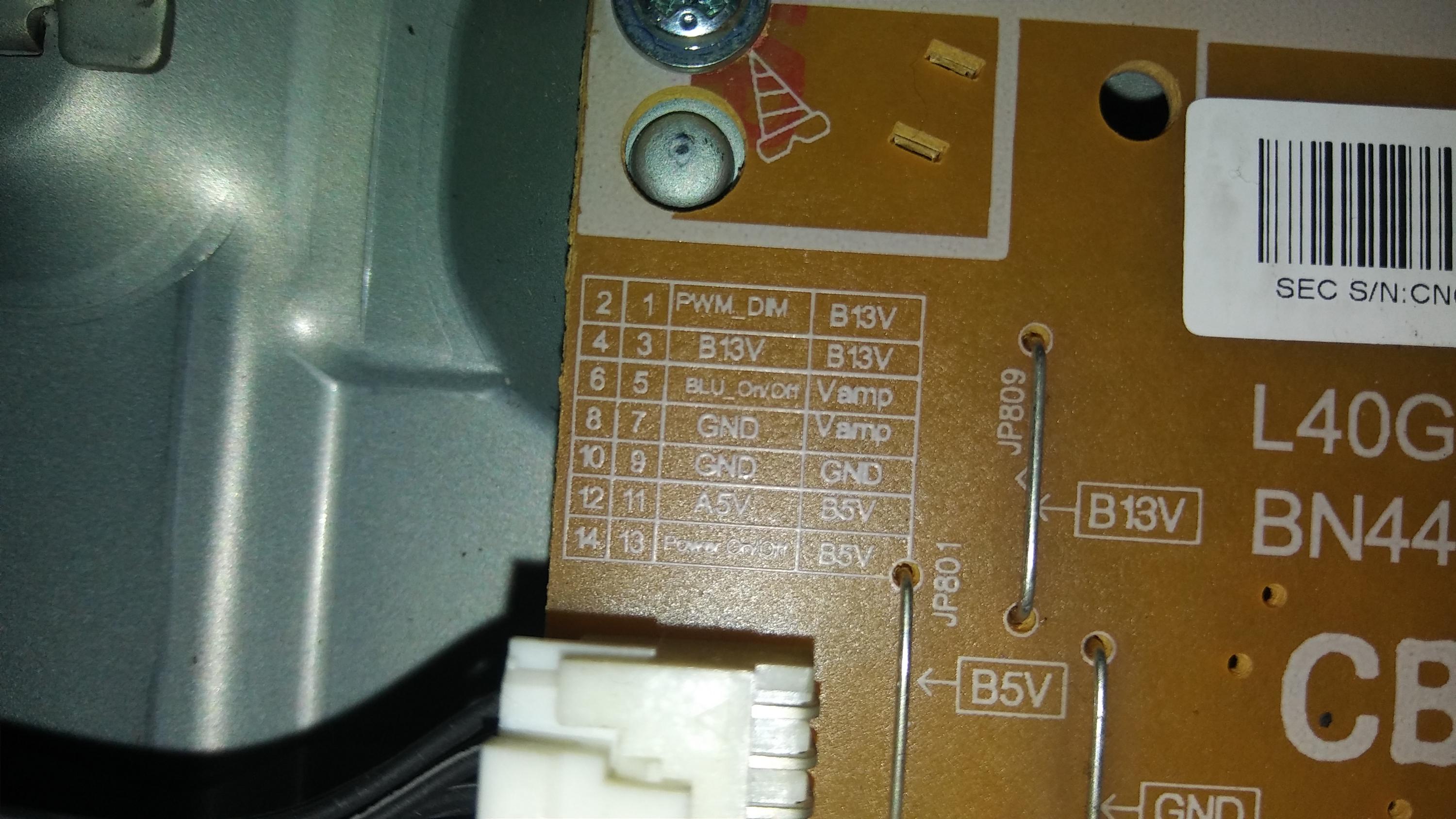

    Originally posted by capwizard
    1) I was there praying with analog input so, I crank It Up to almost 18 volts.
    2) yes, 4I always use DC input.
    So you were using the 555 on the Analog Dimming instead of the PWM.
    • capwizard
      • Jun 2016
      • 1991
      Re: 555 pwm
      1) I used the same power supply for 555 pwm to do analog Input because this power supply doesn't have a voltage display, and the 10 turns potentiometer is really hard to turn.
      2) Pwm - DIM, I think if the voltage drops down to 2 volts will be active.
      • eccerr0r
        Solder Sloth
        • Nov 2012
        • 8706
        Re: 555 pwm
        But I thought the output waveforms are 90-degree reverse
        I guess that's right if one is 90 degrees before basis and the other is 90 degrees after basis, but if you look at the block diagram, it necessarily needs to be nonoverlapping, 180 degrees apart from each other, specifically for the half bridge off-line PSUs.
