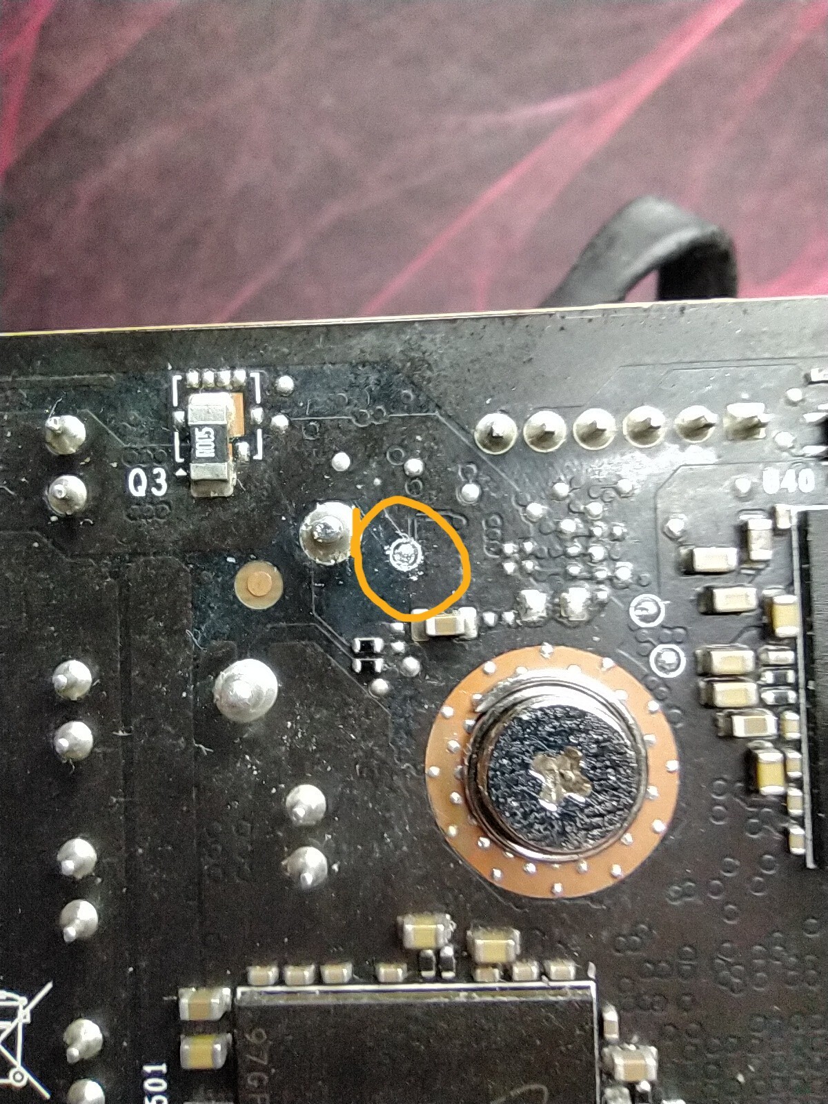

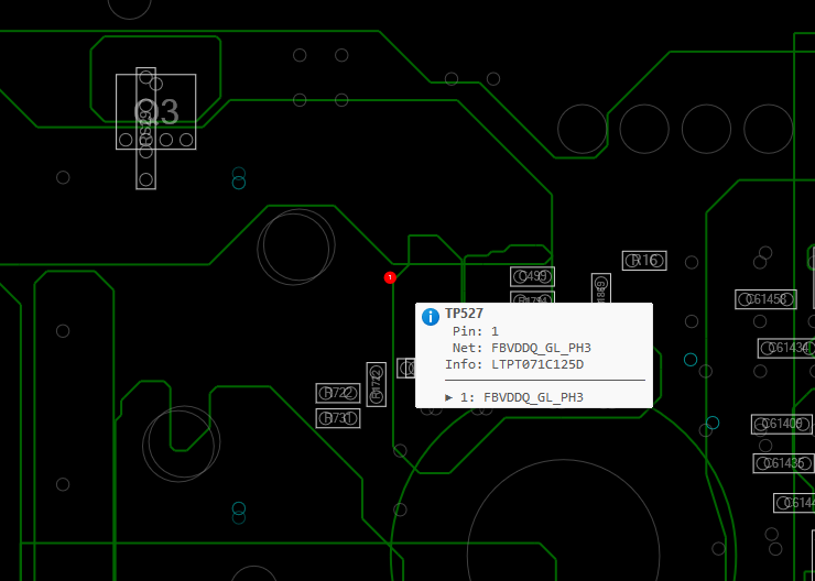

                    Something came through my mind: Maybe, some other mem phase got shorted while running the card with one less phase.
                    I've tried the short finder method dicky96 teached in his youtube channel. (https://www.youtube.com/watch?v=P_2GGNr4q1s)
                    There's these test points for the DRMOS:
                    Click image for larger version  Name:	Screenshot (3).png Views:	0 Size:	59.8 KB ID:	3560841Click image for larger version  Name:	2025-01-31-03-04-34-131.jpg Views:	0 Size:	638.1 KB ID:	3560843 Click image for larger version  Name:	2025-01-31-03-10-30-794.jpg Views:	0 Size:	711.6 KB ID:	3560842
                    Measuring the U17 DRMOS gate test point to the inductor showed 1.13V drop while the three others 1.33v drop. I'll be replacing this DRMOS in hope this may solve my problem!
                    I supose the other mem phase that received 12V from the psu got overwhelmed and got shorted or damaged. (there's 4 phases, 2 get power from pci and two from psu)
                    I'll be back for updates.
