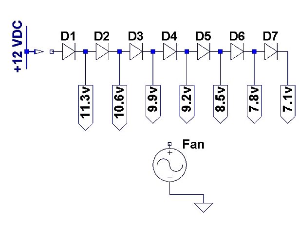

                              @eguevarae -
                              Use diodes in series rated at 2x - 3x the fan current. Each one will drop 0.7v. Just keep adding until you're happy with the noise level. You can also add a switch to bypass them and run at full power when needed. Easy and CHEAP!
                              Toast

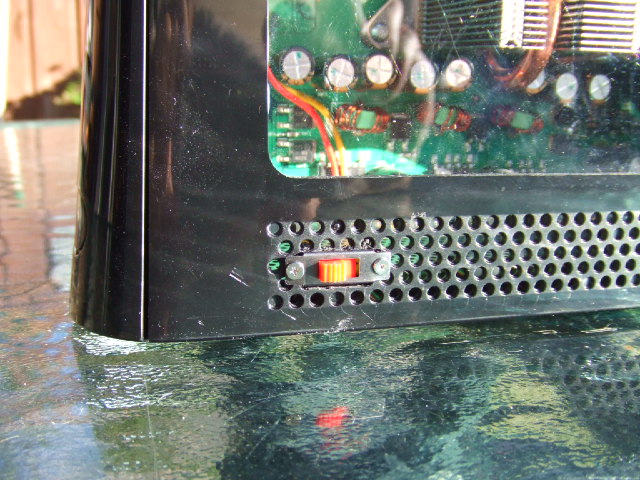

                                I just did that to another unit brought to me yesterday - I don't know why I am now the "It's broken, please fix it" guy from the apartments complex I live. Anyway, I took this and your suggestion as a model. This is not the console but the switch looks the same, but no window on our 360.
                                The switch was taken from a ThermalTake fan kit. It has three speeds, but it does not use diodes. It has three resistors inside. I guess they limit voltage, right?
                                It was a cheaper (we had it already), cleaner and better looking solution.
                                I will give the diodes a try on the other system, or one of the others that I'll come across
                                Thanks, Toasty.

                                  Re: Which Rheostat to get
                                  Just make sure those resistors don't overheat. Resistors are okay when used to vary the voltage on the 3 wire fans, yellow wire. The full 12 volts is applied (black & red wires) and circuitry in the fan follows the applied voltage on the yellow lead to vary the speed. It is very low current on the yellow lead, hence the tiny resistors, 1/8 or 1/4 watt.
                                  Using resistors on a 2 lead fan requires much higher wattage resistors, typically several watts or more. They also need to be located in an area with enough airflow to permit them to dissipate the heat they generate. A stalled or dirty/clogged fan will burn them out.
                                  A 12 volt fan rated at 0.25 amp will need a 2-3 watt resistor. A 5 watt allows a good safety margin. Ceramic or film type only, no carbon resistors due to the potential fire hazard. Approximately 24 ohms would give you around 8 volts. 33 ohms for about 7 volts.
                                  Here's the diode voltage divider schematic.
                                  Toast
                                    Toast
                                    They were not carbon type. The three resistors were white squares (ceramic, right). The thing was rated for a huge fan which ran off from 12v for an AMD CPU. I didn't check the wattage on those, but as they were for 12v I tought they will be fine. I didn't take into consideration the (great amount of ) heat inside the 360 once closed.
                                    I will recheck on this.
