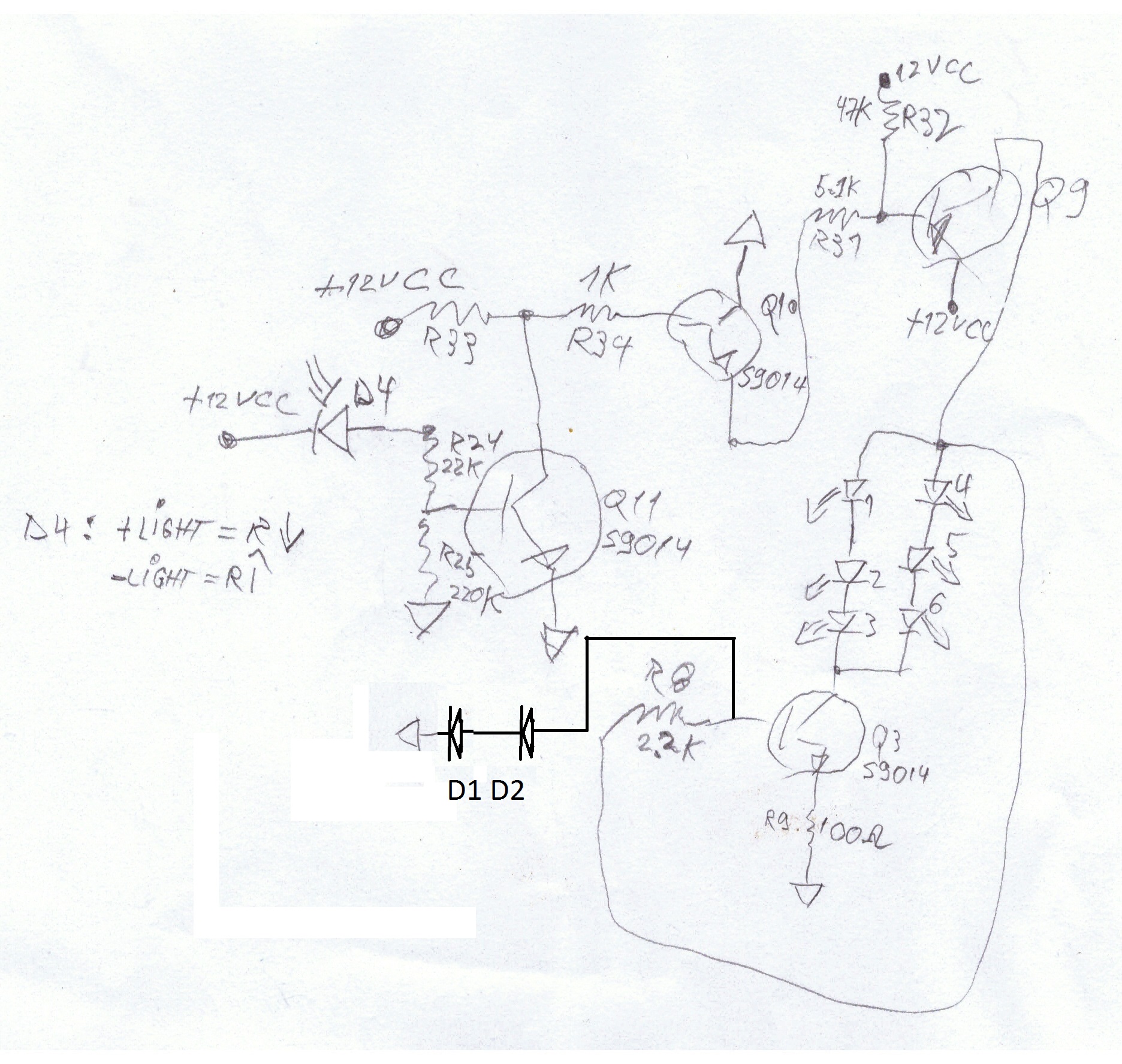

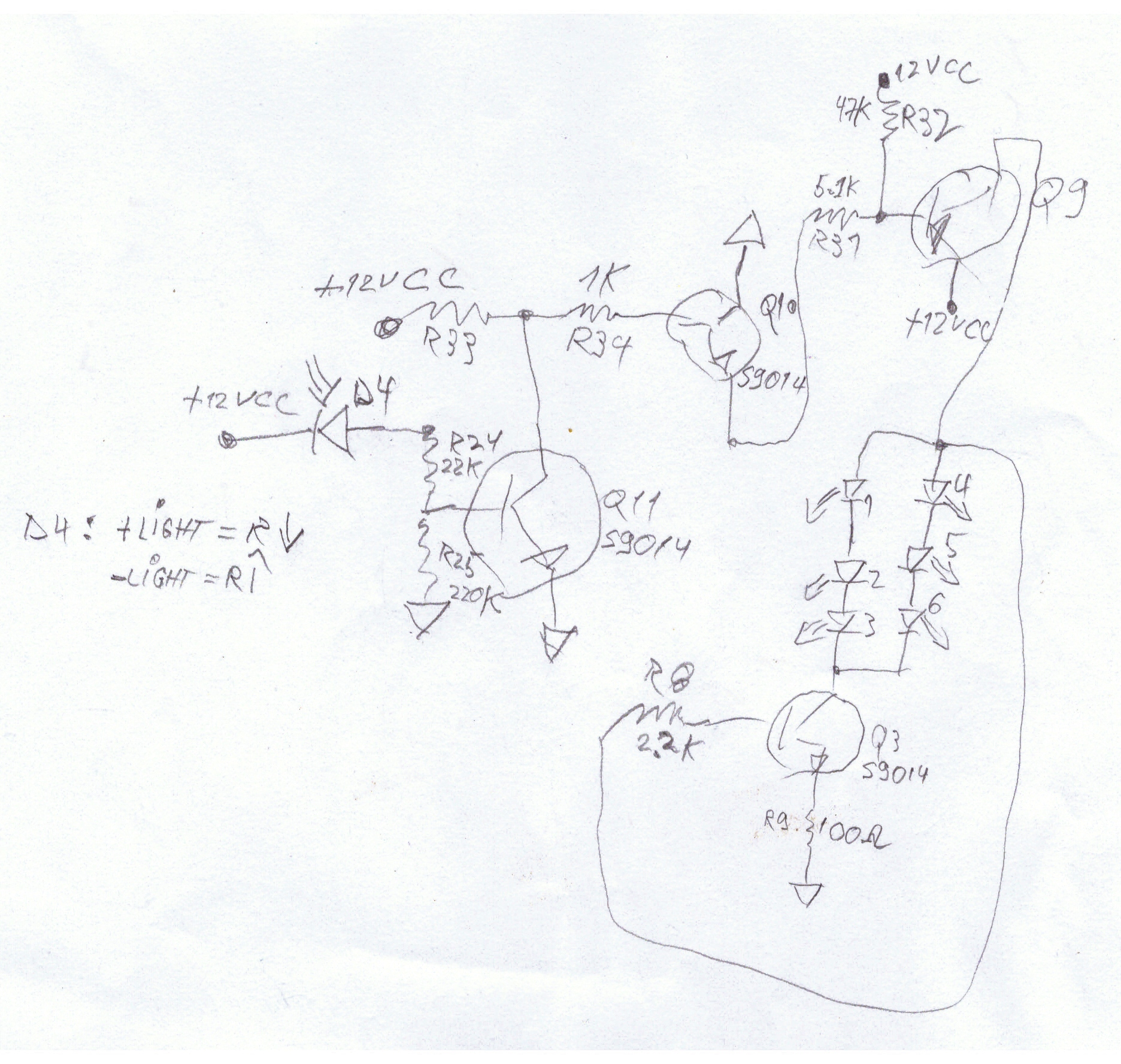

    Good day folks. I'm going to install a camera for my door and to make it less obtrusive and prone to vandalism, I got myself an intercom outdoor unit which already had a camera in it and 6 white LEDs. I replaced the camera module with a better one and now I wanted to replace those highly obvious white LEDs with some IR ones. I salvaged some from some old CCTV cameras and installed them. They DO come on, but they're very dim and not useful at all. I drew the schematic of the LED section hoping to somehow be able to give them more oomph without frying them of course.
    One thing I find strange is that the original white LEDs when tested individually with my bench supply came on at 3v. Anything lower and they wouldn't light up at all. These IR ones come on VERY brightly at 3v and draw a not inconsiderable 50mA (from what I could briefly spot on my supply's display), so I was afraid they'd actually burn out, but on the contrary: they're dim.
    I was thinking of dropping the value of either R9 or R8. What do you guys think ? Have you seen a similar circuit before ?

        Q3 is supposed to be constant-current source- but missing a zener (constant voltage) from the base to gnd, so Q3 ends up being a switch like Q9. Unless R8 goes to +5V instead, that would make more sense.
        Right now R9 ends up limiting current to the LED strings, about 60mA total or 30mA per string by my guess. Lowering R3 to 47R 1W would give double current ~120mA or 60mA per string.
        I don't think 5mm IR LED's can take 50mA or more without getting damaged? They also have a very low forward voltage 1.25-1.6VDC compared to red, blue etc.

          First order of business is to figure out if the camera can work with IR light, otherwise it's all for nothing. I'll check the circuit again, but I believe it's correct.
          Can you explain some of your calculations ? I'd like to know how you got those numbers.

            https://www.radio-electronics.com/in...ent-source.php
            Q3 is the low side CI source.

              Oops, I missed something indeed: there's two diodes on the base of Q3 arranged in series like so. 1n4148 judging by their looks, as I can just about make out 1n on there, since they're flat on the board and can't really see them.
              Are they using the Vf of the diodes as a "zener" reference voltage ? The Vf of a 1n4148 is around 1v from what I remember, so would this mean the "zener voltage" is 2v ?
