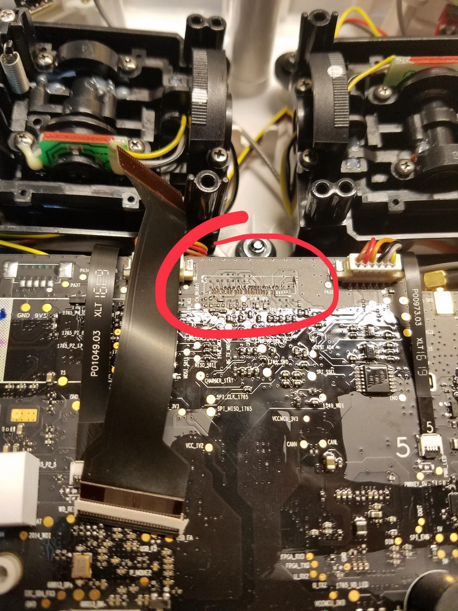

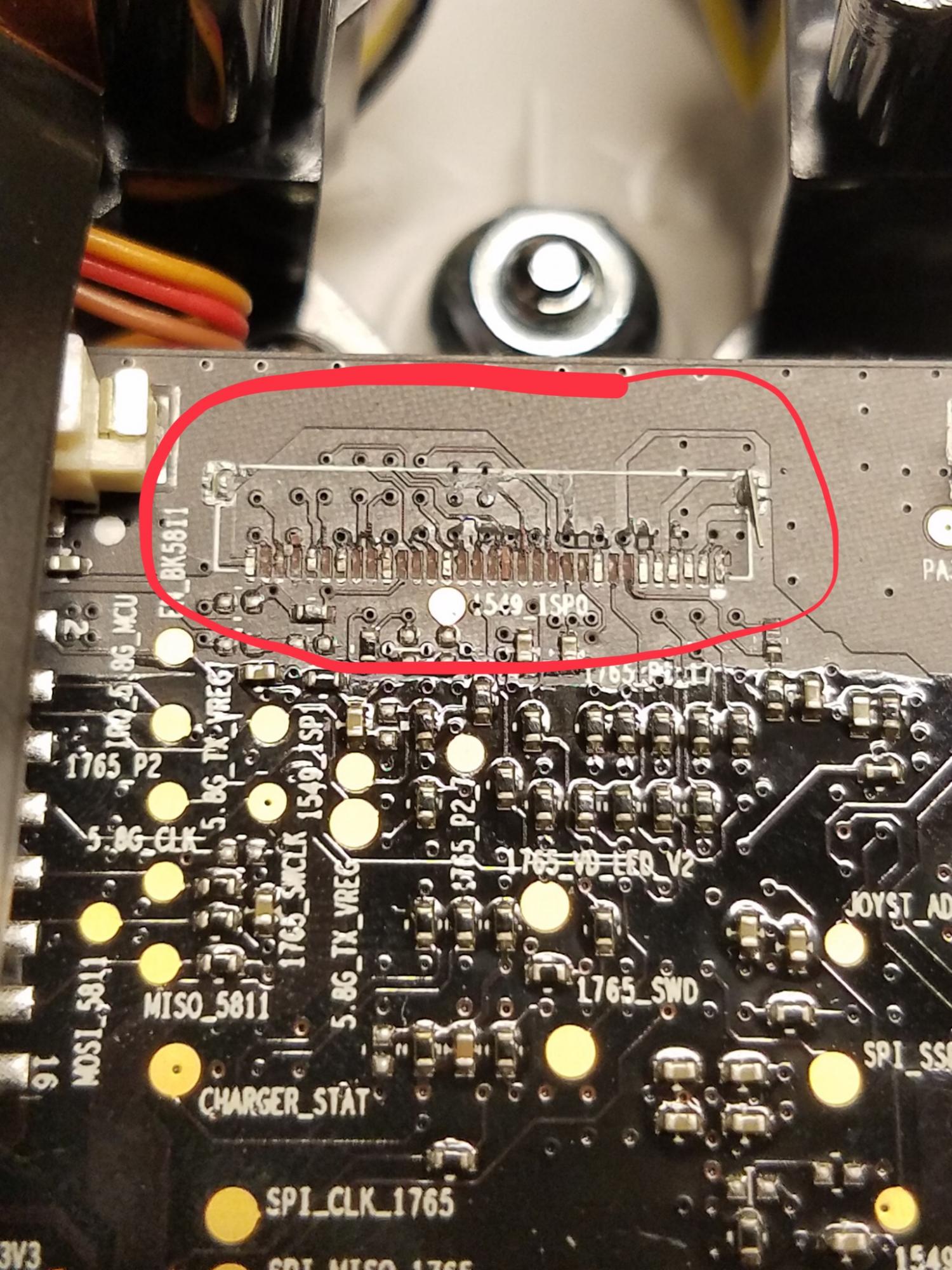

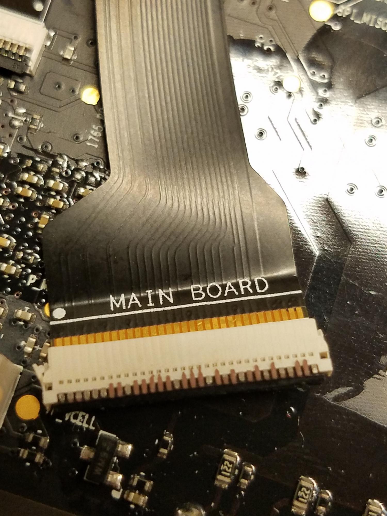

    How do i repair this?
    Please see attached photos. Ribbon cable and holder/socket was ripped off the board. Is there a way to repair this? How would I attempt this?
    Despite the size of the image, the connector and pins are quite small which may present a challenge.
    THanks in advance

    Re: How do i repair this?
    ... Very carefully.
    I'd seriously consider replacement if the device is cheap enough to replace, else you're going to be in for a lot of pain to reconnect all those pins. Luckily it's all on one side and you can access vias.
      microscope or good magnifying glas,thin wire for reconnecting all traces,uv curring solder mask,new connector or the old one is is usable and a bit of patience..
        the copper needs replacing on the board . or some ingenious way to solder underneath the connector
          Thanks for the advice. I think Im just going I’m going to cut my losses on this one.
          Seems like it may be far too time consuming and a bit of a headache.
