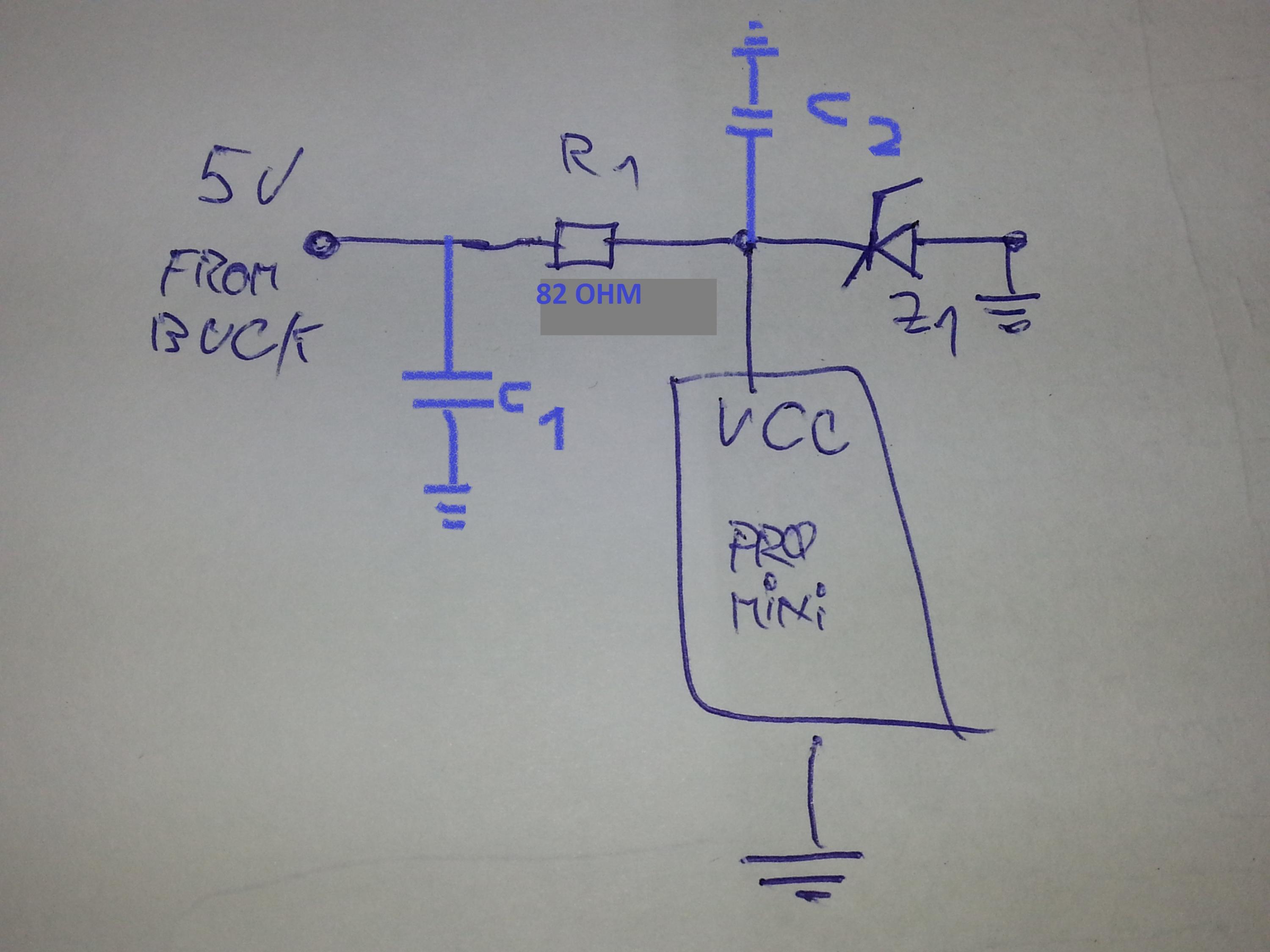

                  Re: I fried my Arduino Mini...
                  Back on topic, I did some experimenting and here's how I got it laid out at the moment.
                  Initially, I started off with R1 at 100 ohms, but that was a bit too high and the voltage at VCC pin was only around 3.8v. I then dropped it to a 82 ohm resistor (which is only because that was the closest value I had in my drawer of resistors). The buck already outputs 5v, so the zener's there for protection only since it doesn't regulate or conduct anything. I got the idea for this setup recently from an "AUX" winding of a Toshiba PSU (some of you guys probably know about that too) where the zener did not actually regulate, but simply "guard" against spikes.
                  At first I miscalculated: I thought 5v from the buck going across the 100ohm resistor would give me a maximum possible current of 0.05 amps (50 miliamps) to work with. V/R = I >>> 5/100 = 0.05 is what I thought, which I thought was plenty of current to power the board without "sagging", but the voltage dropped to 3.8v on that rail like I said. I then dropped to 82 ohms and it works. The rail is now around 4.1v, which is still a bit too low, but doable. C1 and C2 are 0.1 uf ceramic caps I just bothced on there...not sure if it's a good/bad/useless idea...

                    #29
                    c1 seems useless to me.
                    c2 would be better with some guts - maybe 10uf tantalum. the arduino already has ceramic decoupling.

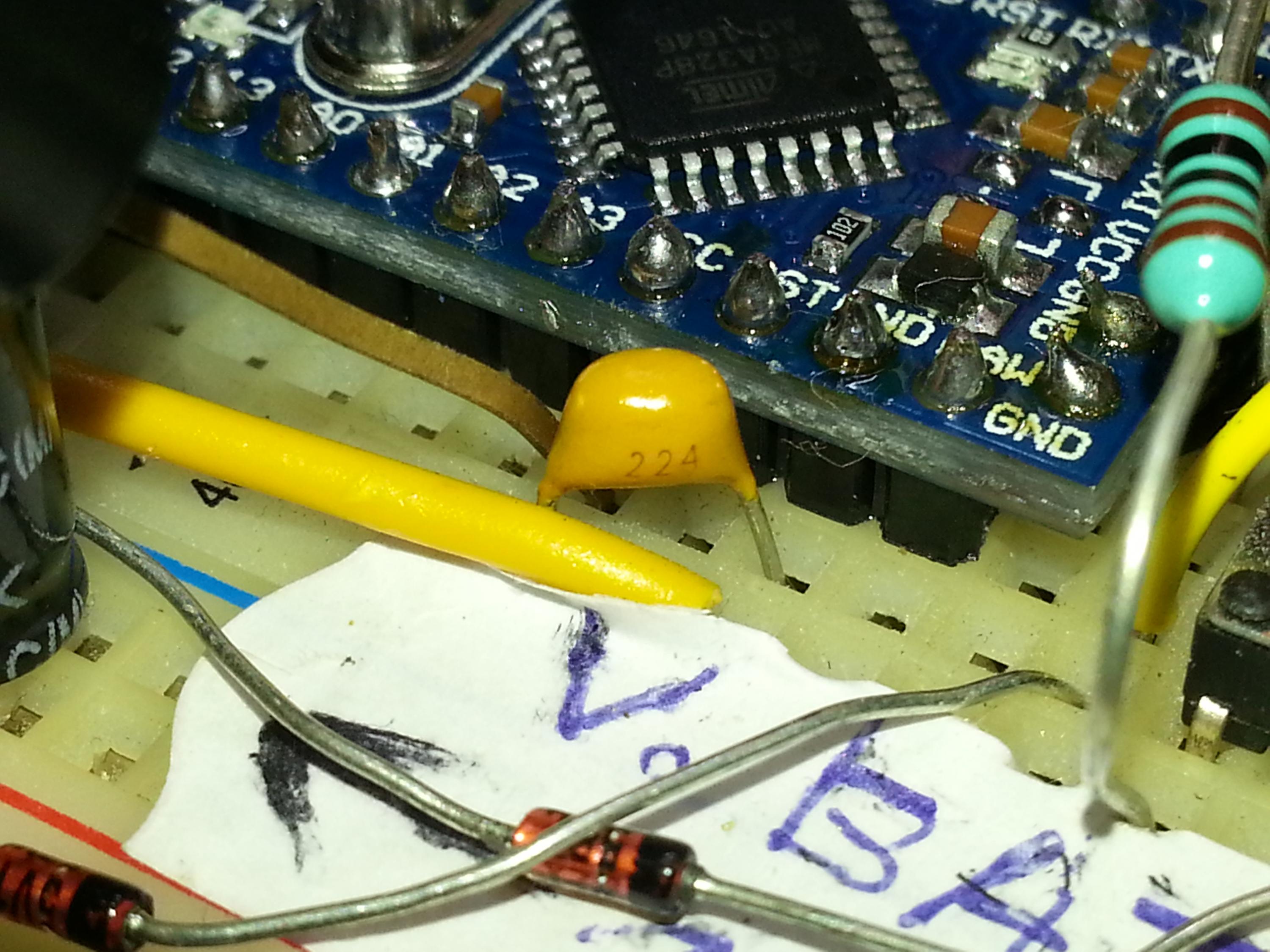

                      #30
                      Didn't have tantalums of such a value on hand, but I did have some 220 nF ones, three of them to be exact, so I stuck those in the breadboard one after another for now
                      Idiot question: are tantalums polarized ? I think they are very much so.... I see no markings on these ones, but I recall a while back I sent my buddy to pick some up and those HAD a plus sign on them, so I think these are not tantalums, but poly films....is this true ? I don't know my basics apparently

                        • 31256
                        #31
                        yes they are polarised - and burst into flames if you get them backwards!!
                        stripe = positive end.
                        the thing in your photo is a multi-layer ceramic cap

                          #32
                          Why do you want a zener regulating the buck SMPS, would it not already be regulated? That is unless the SMPS is far away, in which IR drop would then be a problem too...

                            #33
                            It's not regulating. It ensures it doesn't go over....I know, it wouldn't happen, but just in case...just a theory
                              the word your looking for is "crowbar circuit"

                                #35
                                Yes, I'm familiar with that, now that you mention it. I calculated that the setup with the 5v zener and the 82 ohm resistor could take up to 20v "overhead", which shouldn't/can't possibly happen, but what the hey
                                1. 20v-5v (zener rating) = 15v dropped
                                2. 15v/82ohms = 0.18a approximately
                                3. 0.18a x 5v (zener rating ) = 0.9/1w for the zener with no load present
                                4. 0.18 x 15 = 2.7w for the resistor...would get hot, but it shouldn't come to this anyway.
                                Hope I got it right

                                  #36
                                  You should be protecting the SMPS not the downstream circuit. The trash power is on that side of the circuit.
