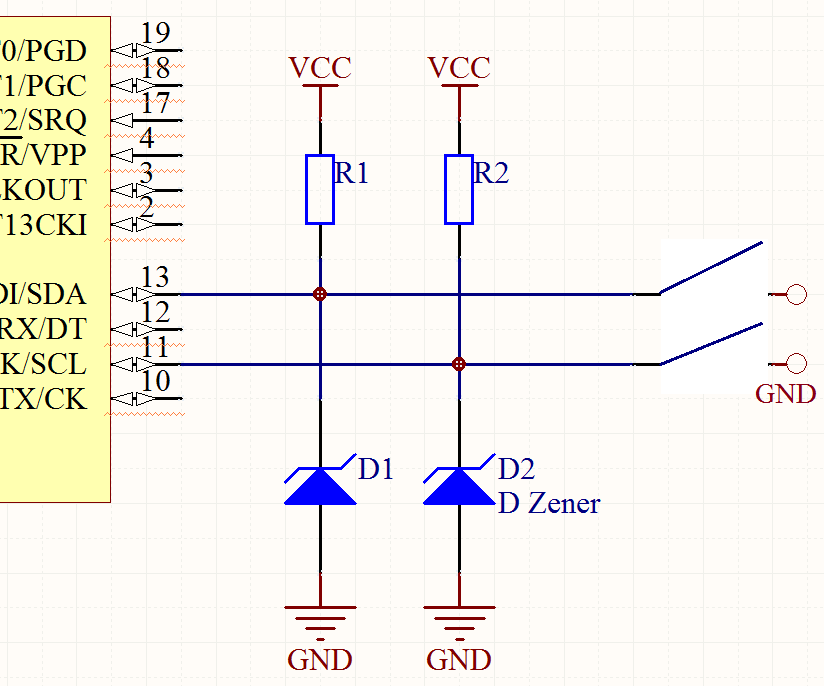

    Good day folks. As the title suggests, I managed to kill my Mini the other day. I did so by sending 12v into the digital pins. The digital pins are connected via 10k pull-up resistors to a rail which is supposed to be kept at 5v by an off-board buck converter (you know one of those silly ebay things, it's got a little trimmer on there to adjust it...anyway). The reason I screwed up is because I wanted to plug an LED into this 5v rail and its jumper wire had the same colour as the 12v wire coming from the wall-wart....plugged that into the 5v rail, the power LED on the board went slightly brighter than it ought to so for good measure, I plugged in the jumper again to ensure it's not some glitch and same behaviour....*that's when Danny realised he f***ed up*
    Now the board no longer responded to anything. Power LED is still on, no smoke or anything, but other than that, nothing: no response whatsoever to my otherwise working code (the one for the automatic car window roll-up some of you folks will be familiar with from another thread of mine). The buttons don't do anything, the reset button doesn't do anything, the programmer can't detect it (not in sync error)...D.E.D DEAD...
    Aside from ordering a new one, that also got me thinking how to prevent further such mess-ups (I obviously replaced the jumper wire with one of a different color too ). I was thinking of placing a 5v zener diode between the digital pins and GND, that way if it gets a "shock" like it just did, I EXPECT the damage to be less, as the zener goes into conduction and sheds away the extra voltage. I got the idea from the numerous TV power supplies I've worked with - they all seem to have a zener on the AUX winding for this purpose. If the overvoltage is sustained, I reckon the zener will short itself out, creating a short to GND, possibly shutting down the supply if it can't provide the current - I'll put a small fuse in line for this purpose. Sounds good ? Here you go...

    5v3 zeners will work, but choose r3,4 so the current wont trash the zeners while also not effecting your input signals.

        Re: I fried my Arduino Mini...
        In my setup, with respect to the diagram I picked up randomly off google images , R1 and R2 correspond be the 10k pull-up resistors I mentioned, while R3 and R4 don't exist at the moment at all, since I'm pulling those pins straight to GND to read a button being pressed - that's all this thing is supposed to do. The schematic would thus look like THIS.
        See, because I intend of putting this thing in a car, I thought I'd use both the external buck converter to first drop the 12-14v of the car down AND the on-board linear regulator of the arduino, instead of just feeding 5v from the buck converter straight into the VCC pin. Remember the mini (and probably other Arduinos too) have a "RAW" pin which goes through a 7805 regulator and a VCC pin which corresponds to the output of said regulator and goes straight to the VCC in of the IC itself, so if you push this VCC pin too wildly, you can kill the thing...I thought I'd be clever and utilize both the off-board buck converter AND the on-board regulator for maximum safety, though I'm not sure it's a good idea or offers any additional benefits than just going BUCK>IC VCC. Instead I'm going BUCK>RAW PIN>IC VCC. What I did was set the buck converter to output around 6v, to still allow the on-board regulator of the arduino to function (5v was too low and sometimes failed to register some of the buttons being pushed), so when "pulled-up" those pins have 6v on them. If I were to add the zeners, I'd drop them after R1 and R2 (like in the schematic - classic zener regulator setup), but those 10k resistors would be a tad too high for that I reckon. I'd thought I'd keep it as simple as possible and simply plop the zeners in there on the breadboard, but changing the value of R1/R2 might be necessary after all. Dropping 6v to 5v means 1v. 1v divided by 10000 ohms, equals 0.0001 A which I think is too low for the arduino to register as a "1" (HIGH) - the pin could oscillate.
          100ohm series resistors should be good.

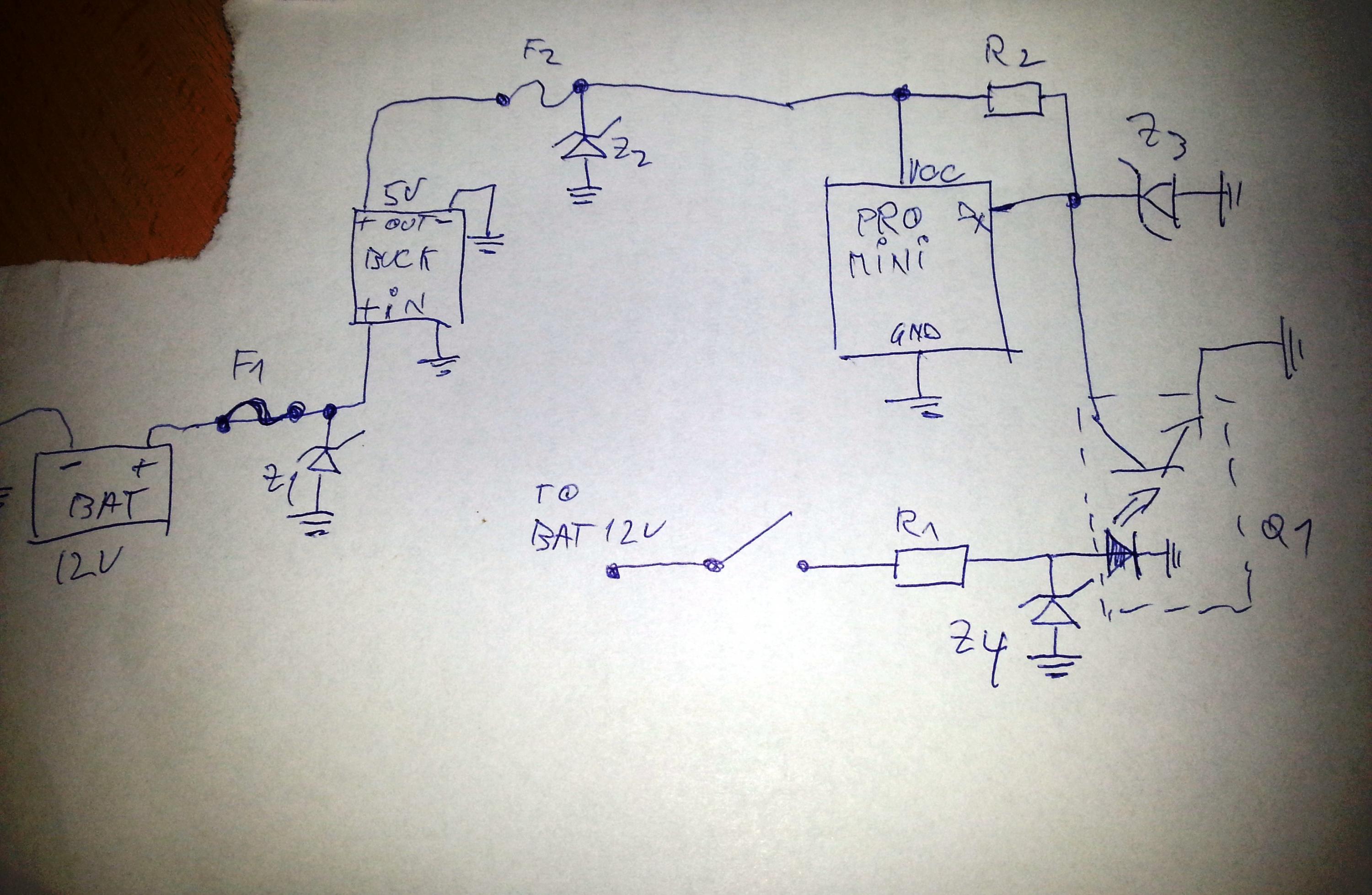

                                Here's what I've been up to: I cooked up something which might be a bit overkill. I drew up a rough schematic of how I see things. Since the thing is going to run in a car, I need maximum energy conservation as well as protection from spikes and what not.
                                The car's supply goes to a buck converter via F1. There's a maximum 35v rating on that thing I reckon, so the way I see it, and it's a work in progress so feel free to correct if necessary, Z1 should have a value immediately above 35v. If it exceeds this, the zener conducts (possibly shorts) and blows the fuse hopefully saving the buck.
                                Next step is the micro itself: the buck thing drops 12-14v to 5v. This is where I screwed up last time by applying incorrect voltage to that rail. I thought of this in the unlikely case the converter screws up or overshoots or becomes a piece of wire and allows 14v straight off the battery to get the the micro or simply Danny comes along a pokes a wire in the wrong spot. Same thing here: a 6v or thereabouts zener, Z2, is placed after F2. If VCC exceeds this, the fuse SHOULD blow...not sure it would do it in time though - could be slow and therefore useless as the micro would be dead by then.
                                The digital pins: there's a 10k pull-up resistor on all of them (R2 to Rn for each pin used) "by nature", since I need them to read a high. Conveniently enough, these resistors would allow me to build yet another regulator in conjunction with Z3 (to Zn for each pin used), which would ensure the voltage doesn't exceed 5v here either. Not sure whether this is still needed after the previous portion...this is just a theory...
                                Finally the controls: I'll be tapping into the window buttons on the car and can't alter them, so I' stuck with the 12v going through them. I took me a while to figure out how I'd get around it and I believe I found a solution by using optoisolators, since they require a very small current for the transistor in them to become conductive, therefore I could regulate 12v to 5v with zener Z4 and R1. I believe there's nothing else that can be done here - the zener's already there. When the switch closes, 12v goes through the resistor, Z4 regulates, lights the LED, the transistor becomes conductive pulling the digital pin to GND.
                                I breadboarded it and it works. In fact everything works, minus the zeners on VCC. I want to polish the design by incorporating some "safety" features that would be "industry standard" and present on all devices, automotive or not. Obviously an arduino is not designed to be used in a car, but I imagine the instrument clusters and the stereo and the gauges and stuff, I KNOW all those have some sort of regulation and protection in them, so I reckon it's the same thing I'm trying to achieve. What is overkill, what is good and standard and what is a no-no ?
                                  There's something about being careful and there's something about overdesign... If you're using an optoisolator there, there's no need for that zener Z3. Plus if you design it properly, Z4 is not needed either.
                                  Plus Z1 and Z2 would simply burn up, unless if you were simply using them for *very* short term spike mitigation (versus regulation).
                                    The idea for Z1 and Z2 came from something like this...it's a destructive use, I know.
                                    Z3 (on the digital pins) was the one I was mostly interested in because it's like the ones used in the very first diagram of this topic. The reason it may not be mandatory is because the "pull-up" rail is already at 5v, so another zener would not provide any additional benefit.
                                      Exactly... not even "may not be mandatory" but with the isolation capability of the optoisolator, more like superfluous...
                                      Question is too, are you going to allow for the window up and down while key is out of the ignition? The power draw of the motor is going to greatly overshadow that of the microcontroller.
                                        Yes, the windows will go up/down even without the engine running (which is what I believe you actually meant by "key out of ignition") since they need to be able to close/open from the outside of the car. They are allowed to run without the engine running even with the present unaltered setup, but only if the key is in the ACC position. They don't detect the car being locked to roll up though - this is what I'm trying to implement. They draw around 6A each when running freely and around 15a when fully closed/open and the motor is locked. I imagine you WOULD eventually kill the battery if you keep your finger on the button...unless it's got a thermal cutout or something. Ther's a current sensing IC which will go on each window to preempt this and also serve as an "end of travel" indication. It's an ACS...something if memory serves.
