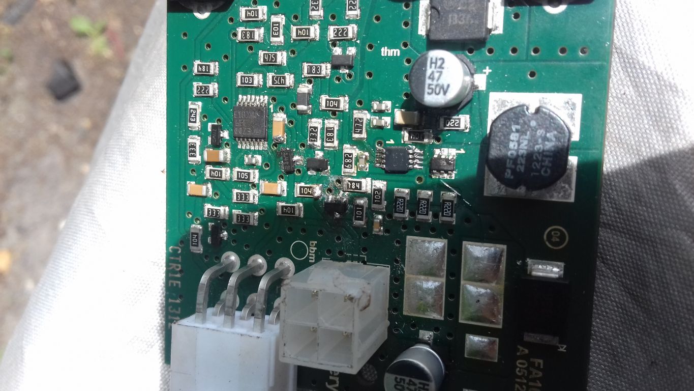

please help identify this component
    have been trying to work this out ..
    i am thinking its a LM339PT ?
    14 pin one ..zoom in to read it ..
    Re: please help identify this component
    looks like 339
    makes sense, isnt 339 a comparater?
      its marked ezdd 339 mrc013
        yes comparator .
        i thought pins 1 and 2 were shorted but looking closely at the board they are supposed to connect together .
        have no idea why they did that .

          Originally posted by petehall347 View Post
          yes comparator .
          https://cdn.badcaps-static.com/pdfs/...9d61bec5c8.pdf
          Are pins 4 and 6 or pins 5 and 7 tied together
            no other pins are tied together

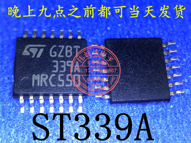

              I agree with above, here is a picture of one from https://es.aliexpress.com/item/ST339...818891290.html
                was trying for hours to find a pic of one with same writing on to confirm its correct part ..i cant find one picture
                  One of the lines may be the month and year of manufacturing, or batch number, it's unlikely you'll find a picture with exactly the same writing, with all rows of text the same.
                  With all the resistors around the chip, it's indeed most likely a comparator, and they're probably using resistors as some basic voltage dividers before the chip compares voltage thresholds or something and turns on or off those transistors (sot-223 or whatever the 3 pin footprint is)
