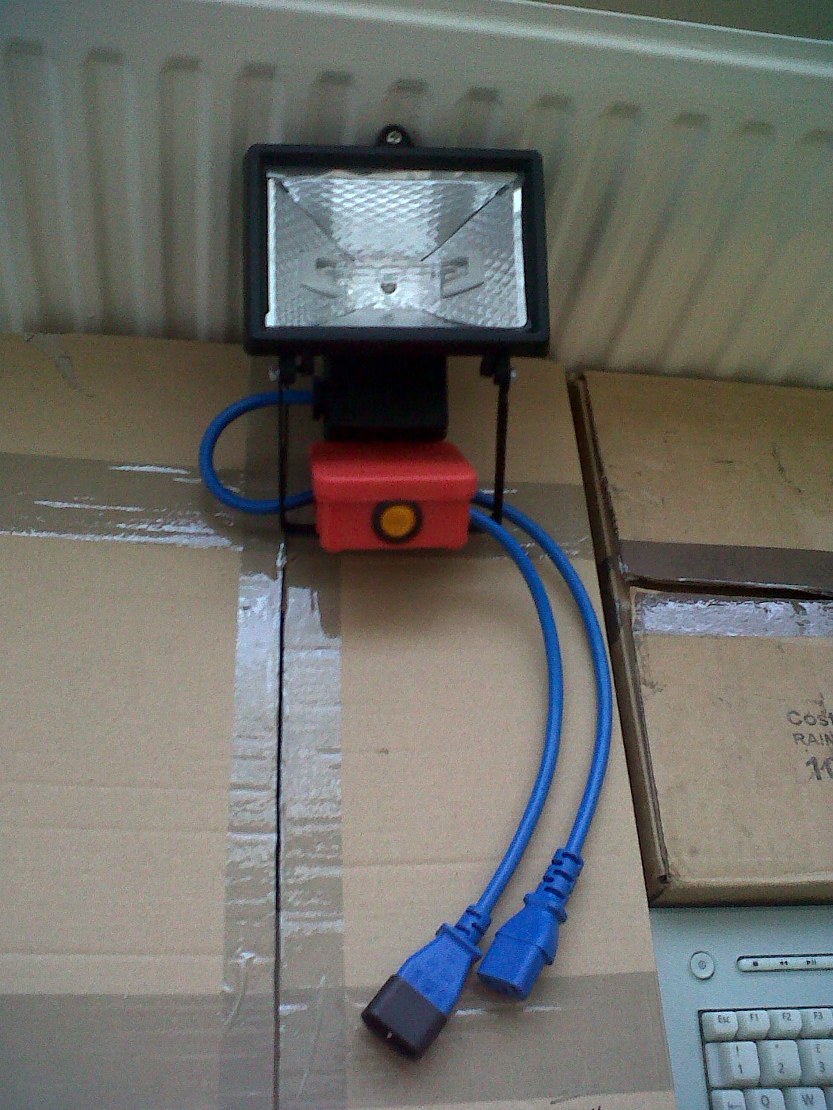

                      if you want a load, or a current limit, use a mains halogen flood light.
                      they are very cheap because most people want leds instead now.
                      very handy if you want 120w,300w,500w etc.
                      i use one as a current-limit for "first-time" testing.
                        #51
                        Re: Arduino current sensing (in car)
                        Check the cold resistance of the lamps first.
                          • 31247
                          #52
                          30ohms (120w)
                            #53
                            Is that hot or cold resistance? 30 Ohms 120W
                            30ohms (120w) = 60V @2A
                            https://www.rapidtables.com/calc/ele...alculator.html
                              #54
                                • 31247
                                #55
                                that;s cold.
                                so 2kw using that calculator.
                                but will increase fast once it glows.
                                so better than nothing.
                                  #56
                                  If 30 Ohms is cold resistance then hot resistance will be more than 10 times higher, that will not be 120W lamp for sure.
                                  So all Dan has to do is to measure the cold resistance to know what the surge current will be, it will last in mSec which hopefully will be shorter time the over current protection circuits to detect.
                                    • 31247
                                    #57
                                    sold as 120w!
                                    https://www.rapidonline.com/brennens...44-120w-533066
                                      #58
                                      OK, 30 Ohms cold then the inrush will be 230V/30 Ohms =7.67A
                                      120W at 230V = 440 Ohms, so the hot current = 0.52A.
                                      So 30 Ohms cold is about right then.
                                        #59
                                        BTW, so to use this 120W 230V LAMP as the load for 12V @30 Ohms cold resistance, the current will be <1/2A so he will need a lot of lamps.
                                          • 31247
                                          #60
                                          that one was an example, he could get them upto 2kw
