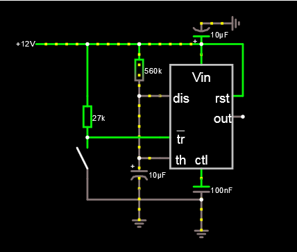

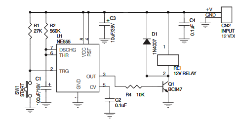

    Good day folks. I need to build a countdown timer for a light fixture, that is, when you activate it, it turns the light on for 60 seconds and then turns it back off. Browsing the interwebs revealed the best solution might be to use a 555 timer in the configuration shown in the schematic. I kinda understand how it works and even simulated it and works perfectly, but I have a few questions regarding some aspects about it that I can't quite comprehend, since although the 555 timer is probably the most standard and ubiquitous component out there, I can't grasp its principle in this situation.
    C1 and R2 set the time before the thing shuts down, in this case it's set at 60s. I imagine you can make it adjustable by using a pot - will look into that later.
    Now: how exactly does C1 charge up ? The simulator shows it doesn't charge until I pull the TRIG pin to GND...C1 is connected straight to the rail via R2, so shouldn't it be charged all the time, albeit slowly ? Even after the fact, how does pulling TRIG to GND cause it to suddenly charge ? TRIG is connected internally to an op-amp inside the 555 so it doesn't charge THROUGH it, that's for sure.
    Next, that discharge pin: when the 555's output goes high, the discharge pin pulls anything it's connected to to GND and in the schematic we see the positive of the cap is connected directly to the discharge pin, so shouldn't that drain the cap instantly since the transistor inside the 555 pulls it to GND ? How does it drain so slowly to count down the 60s ?
    That's about it, other than that, I understand how it works and I'll start building it, but I also want to understand how it works instead of just rolling with it

    1) If you intend connecting a pot to the timing circuit, it's best to use a fixed resistor in series with the pot. This will prevent pins 6 & 7 from being accidentally connected straight to the supply voltage. (e.g. a 100k fixed resistor in series with a 500k pre-set pot would give an approx range of 11s to 66s)
    2) Athough R2 & C1 are connected in series across the supply, the junction of R2/C1 also connects to the Discharge pin (7). Under stable condition (i.e. not triggered), this pin is held low, preventing the capacitor from charging.
    3) You've got that the wrong way round. When the output goes high, the internal transistor connected to the discharge pin is switched off, allowing C1 to charge up until it reaches approx 8V (with a 12V supply), at which point the output goes low & the discharge transistor is swithed on again, discharging C1.
    It's easier to see how a monostable works by looking at the internal block diagram of the 555 whilst designing your circuit around it as this site shows (note...the text incorrectly refers to the internal transistor as Q2 instead of Q1):-

      I did have a look at the internal diagram of a 555 - see it here. I modified it slightly, adding signs to the inputs of the op-amps to make it idiot-proof and also removed the CTRL and RST pins since I'm not interested in those just yet, although I believe that reset pin would be useful for cancelling a countdown that's already in progress (aka turning off the lamp BEFORE 60 seconds or whatever are up), which is something I'll require as well.
      The symbol in cyan is for an NPN transistor, so shouldn't that turn ON when the output of the SR flip-flop (and therefore its BASE) goes high ? THAT'S actually what caused this whole confusion, because otherwise I had it all figured out from the start. It makes a whole lot of sense when you understand that it turns OFF - I actually thought of that myself, but now it's clear

        The internal RSFF is active low (bubble on output), that's why the discharge transistor turns on once threshold reaches 2/3 VCC. Upon threshold, it forces the RSFF to reset, but the active low will invert the signal for the cyan transistor to start discharging the timing capacitor.
        I like op amps that have + and - without bubbles. It's more confusing this way - either don't mark the + and - and leave one input bubbled, or omit bubble and keep + and -...
        having both implies both inputs are noninverting.

          NEVER would've noticed those little circles on some of the pins, let alone think they actually denote something.....the more you learn So basically the output of the blue section to the pink and cyan is ON (high) when points R and S are low ? I also noticed the Reset pin also has a little circle next to R1...would that mean that pulling reset LOW resets the timer, given a circle means active low, aka grounded=on, VCC=off ? That would be in layman terms, how my brain processes electronic lingo

                        Ahh right. So your initial confusion was caused by the fact that you thought when the base of the transistor was high (causing the capacitor to discharge), then the output was also high, not realising that the output driver circuit was actually inverting.
                        Unfortunately there are some images on the internet that don't even show that the output driver is inverting, which can be confusing.
                        As you say, if you want to reset the timer before it's finished it's timing period, simply switch the RST pin from Vcc to GND.

                          I have another question: HOW exactly is the timing period calculated ? WHY does R2 affect the countdown time ? THIS article says the formula is 1.1*R2*C1 (it's R2 in my case - the original is R1), which I know is based around the RC time constant "TAU equals R*C", but what's 1.1 exactly ? Is it like a constant ? I'm working on making the thing adjustable, so that's what I'm asking Cheers.

                            R2 affects the countdown time because it's the resistor used to charge C1. The higher the value of R2, the longer it will take C1 to charge to 2/3 of the supply voltage.
                            The 1.1 factor can be calculated from the expression for the voltage on the capacitor at a certain instant in time. The maths is shown here:-
                            http://www.play-hookey.com/digital/555/timer_555.html
                            It's not going to be exact anyway if you use an electrolytic as the timing component, as electrolytics have a wide tolerance & leakage to consider. If you want the time to be exact, you would need to trim R2 or use a trimmer pot in series with R2 as mentioned earlier.

                                  Chances are you will need to use electrolytics for RC in the 1 minute range because if using a poly cap of even 1uF, your resistances will end up being 51M+ ohms, of which IC pin leakage may become an issue.
                                  For 1 minute RC constants I'd probably need to look into 100uF timing capacitors to pull the charge resistor down to something more reasonable. However I'd be a bit worried about going too big and the energy stored in the capacitor destroys the discharge pin...
