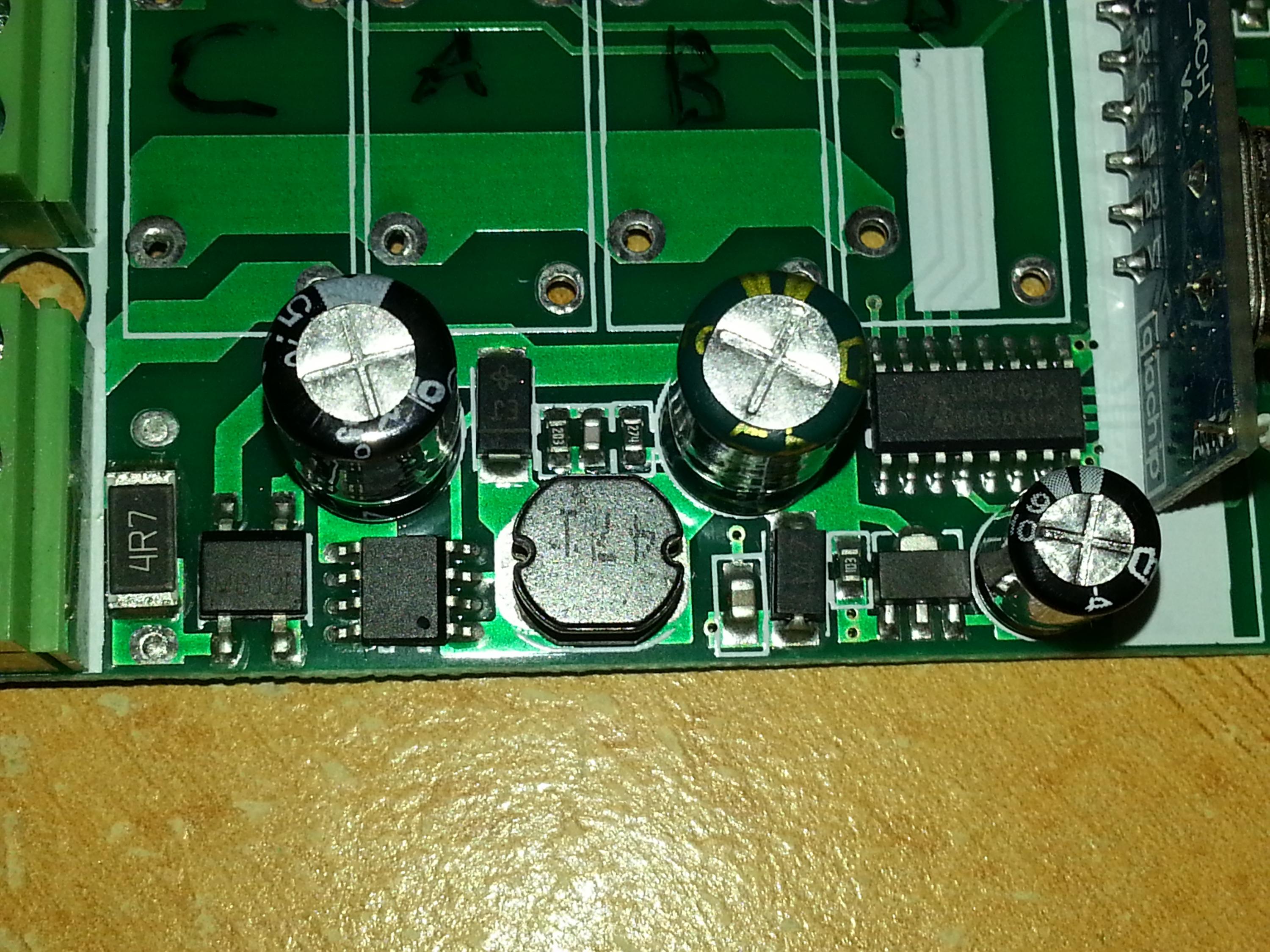

                      Quick look at how the power supply for this thing is gonna look I suppose: interestingly, I was expecting the remote module to have a capacitor dropper like most cheap and cheerful China products tend to have, but it's actually got a tasty little switch mode power supply, operating in what appears to be a buck configuration, though there's no isolation as far as I can tell (notice the GND trace is common between the primary cap and the green secondary cap).
                      There's an unmarked switching regulator, a coil, a diode, two feedback resistors and that takes care of the 12v section. It's a cascading supply, meaning there's an additional 5v supply derived from the 12v one via a small 7805 regulator. It's this 5v supply I'm interested in: trying to keep the project as small as possible (so I could preferably tuck inside the light itself, though it's not a requirement), I'm not too sure whether it's better/safer to stick with this PSU to also power my arduino or to use an off-the shelf power brick....I could lower the part count even further by dropping the primary voltage straight to 5v by messing with those feedback resistors so I can eliminate the 7805 entirely....I'd probably add a varistor because I'm not liking the idea of letting my arduino "ride the live wire" like that with no protection whatsoever.....

                        Since it is not isolated power supply I would be really careful when hooking up PC or what ever you will need. I would go with isolated power supply for safety concern.
                          Re: 555 countdown timer design question
                          True that. Power pack/wall wart, whatever you call it, seems to be the way to go.
