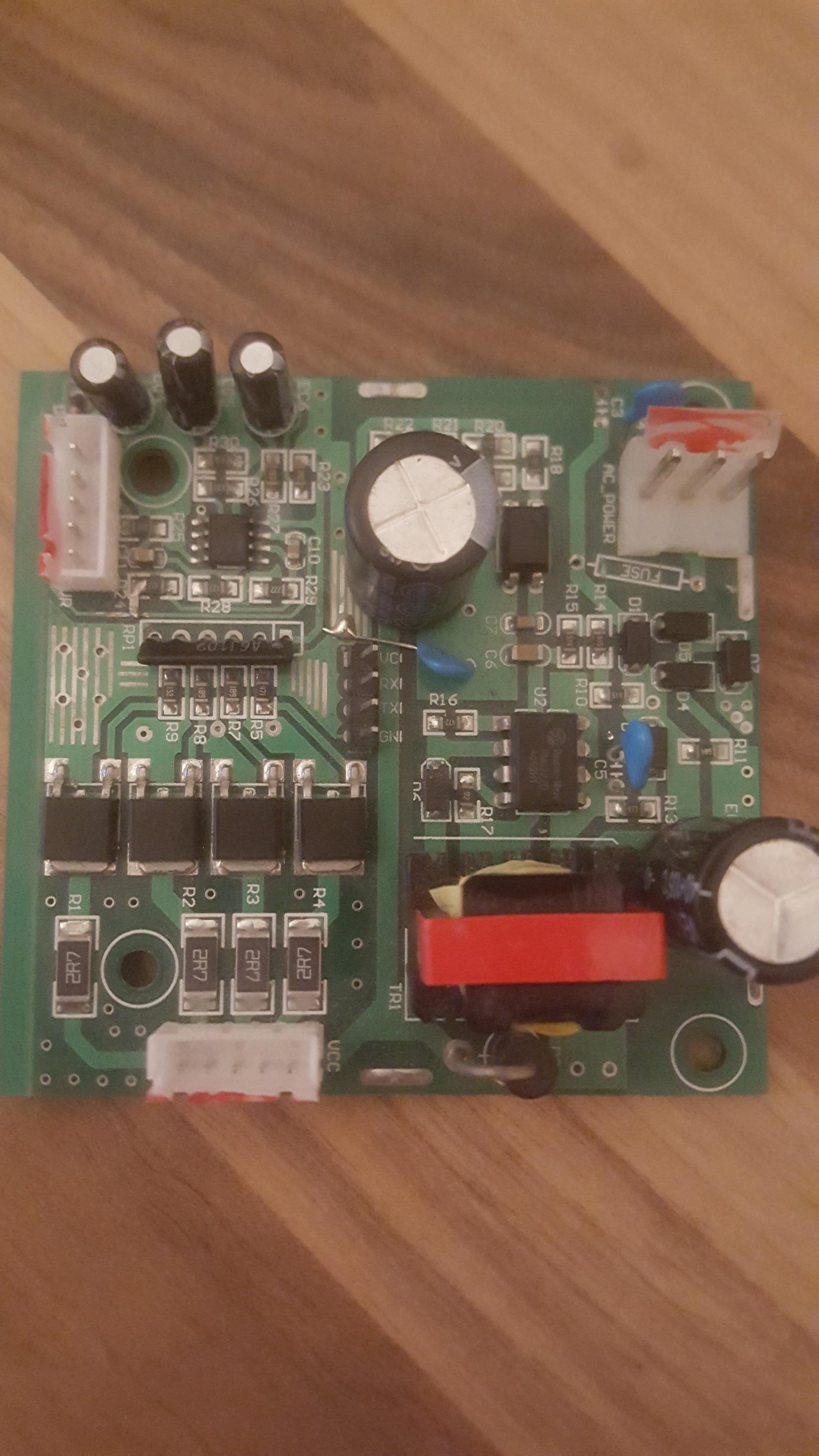

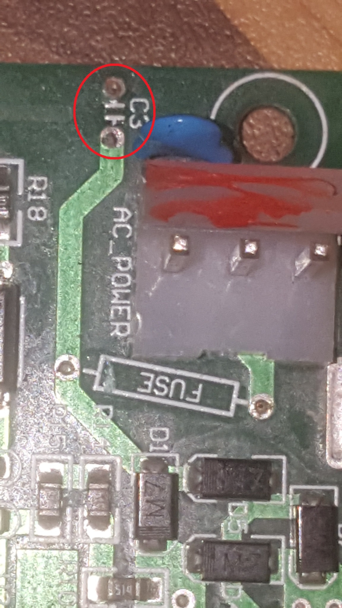

    Hi there i have received a disco light power board for repair but someone has been here before me and removed the fuse and a capacitor c3 ive got the fuse no problem but unsure what size or kind of cap it should be there any ideas
    thanks in advance

    It is most likely the same as the blue one (c4?) next to it. It should be fine to try without that cap. They are just the x & y capacitors, Looks like C4 goes across the line and C3 goes from line to ground

      +1, it is X/Y safety cap for EMI and it will not affect the operation of the unit.

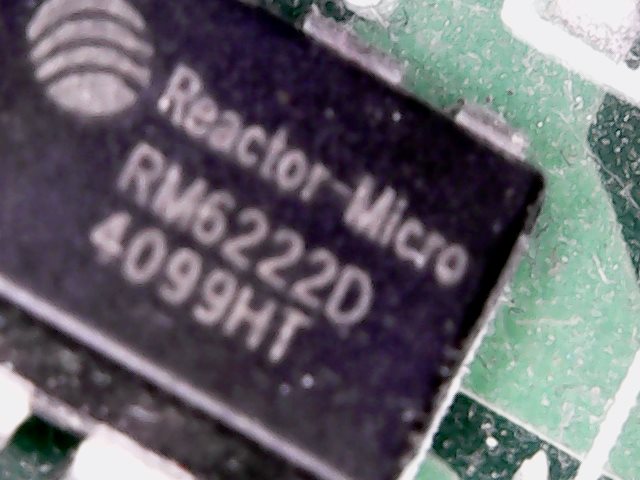

        My money is on bad U2 that blew the fuse

            Easiest way, put in a fuse, I cant make out the ic number

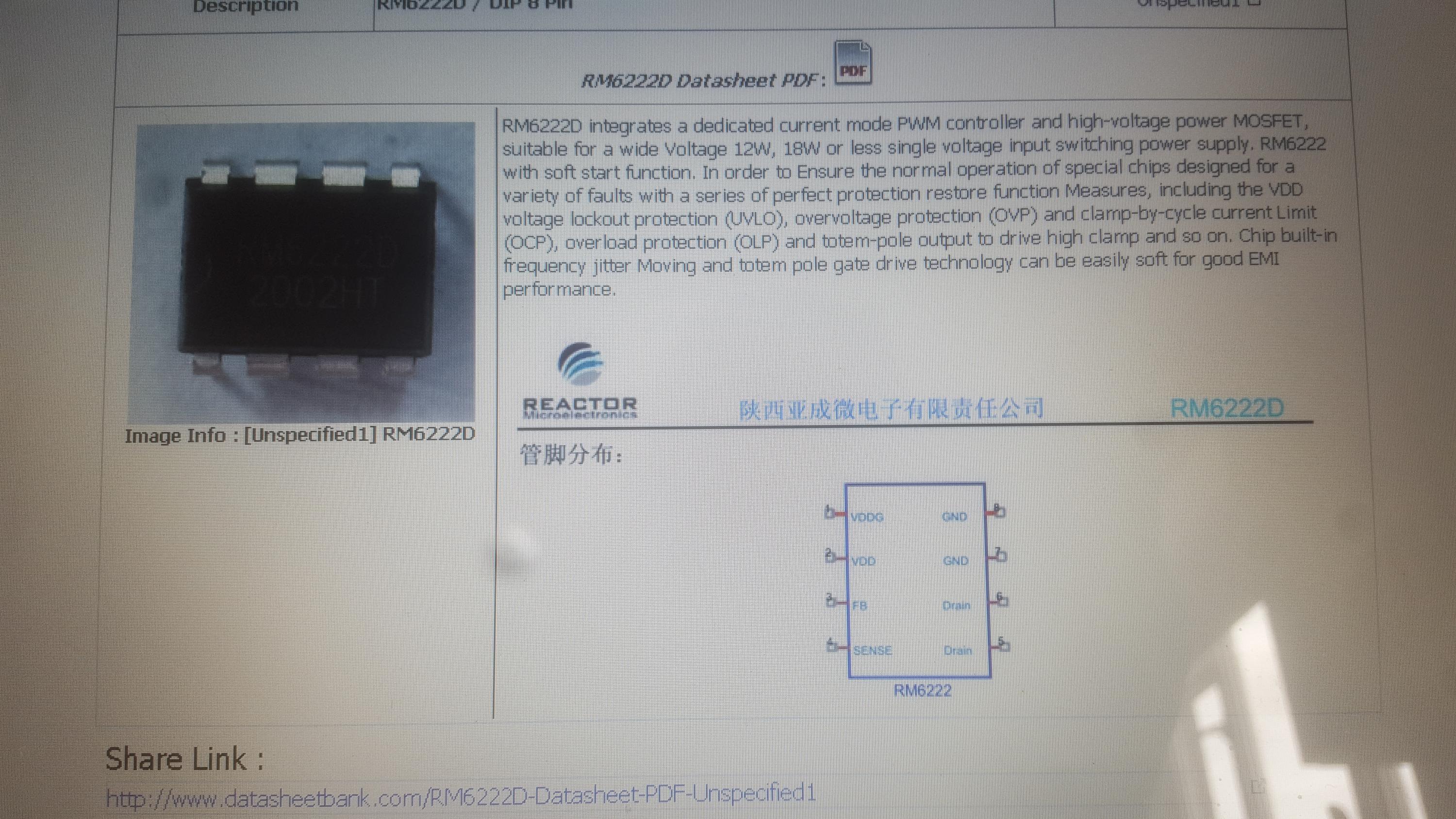

              Check R17 (1R2) Source pin resistor for that SMPS U2 IC to see if it is still show around 1.2 Ohms.
              Also check resistance between Pin 4 (S) and pin 5/6 (D) of U2 to see if it shows a shorted circuit.
              It is best to get the U2 spec to verify my pin out.
