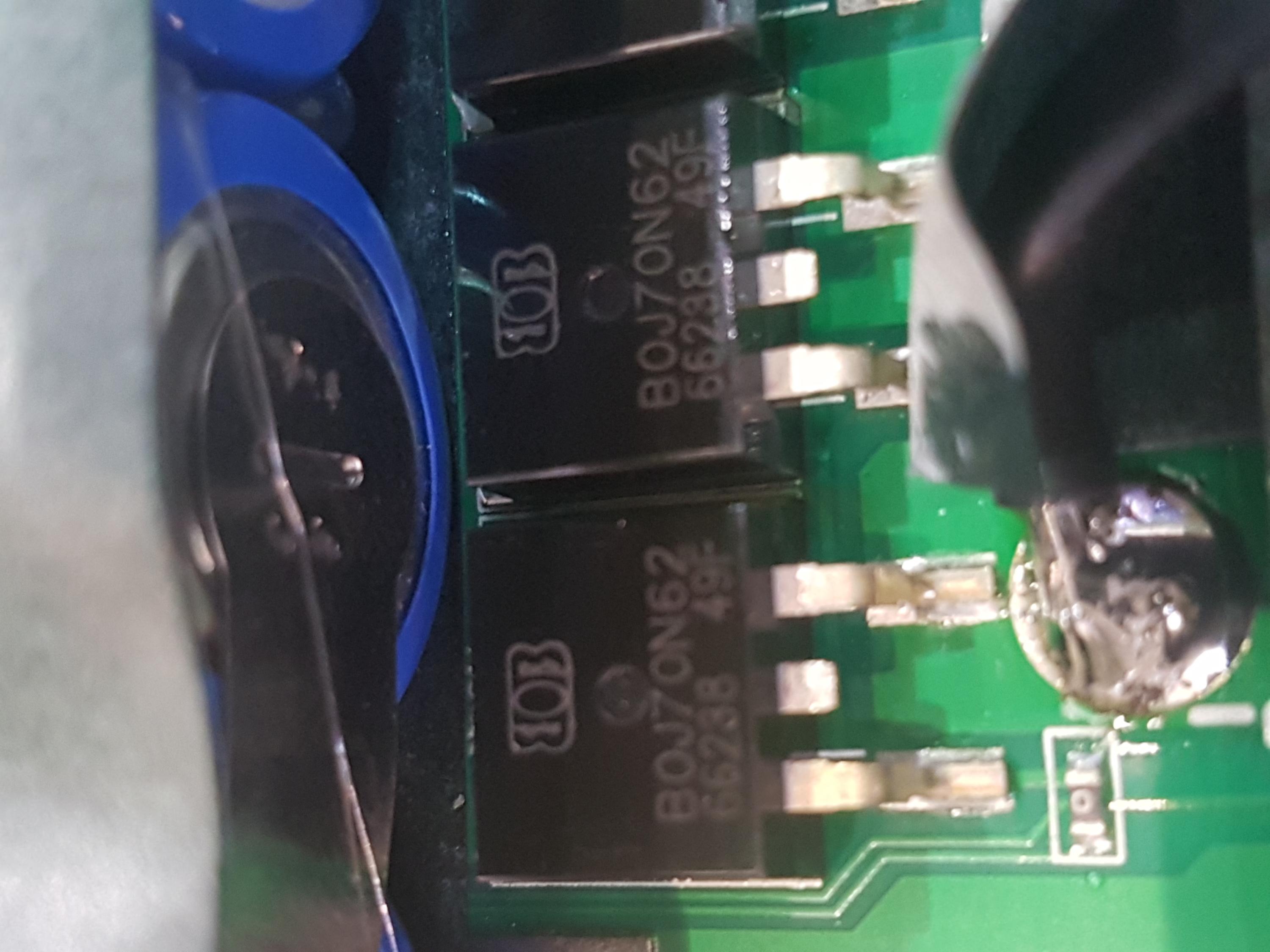

    Hi. Can anyone please help me find what this part is and where can I find it from. It's 2 of them on the pack that are shorting and other 2 exact same parts reading with no short. Thank you all
    Re: Help with this battery pack component
    MOSFET BOJ70N62.
    Did you test them off the board? What is the resistance are you seeing, <1 Ohm?

      Hi. Thanks very much. I did try to find them mosfet but no where I can find them. They shorting and very low ohm reading and short.not at home at moment but any similar mosfets anywhere I could find?

        Reading 0.1ohms out of circuit. Cheera
