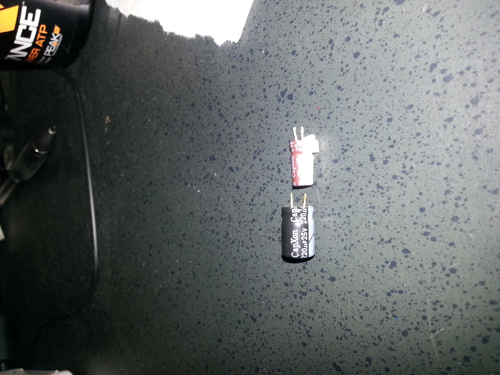

    I bought replacement nichicon capacitors but bought the 20uf 50V instead of the 22uf 50V and the 220uf 25V instead of the 222uf 25V.
    Am I going to have any issues with this?
    Edit- I got the 22uf equivalent but I still could not find the 222uf 25V equivalent.

    Can I see the 20uF and the 222uf caps? Those are odd value caps for today typical value. Typical lytics cap has +/-20% Tolerance.

      So here are the caps. Now that I found it out of the trash I realized I misread one of them.
      The smaller cap is the starter cap I believe, it's isolated by itself by the transformer.

        Here are some caps you could use
        This is what I would use
        22uf
        https://www.digikey.com/product-deta...1703-ND/756219
        220uf
        https://www.digikey.com/product-deta...1546-ND/756062
