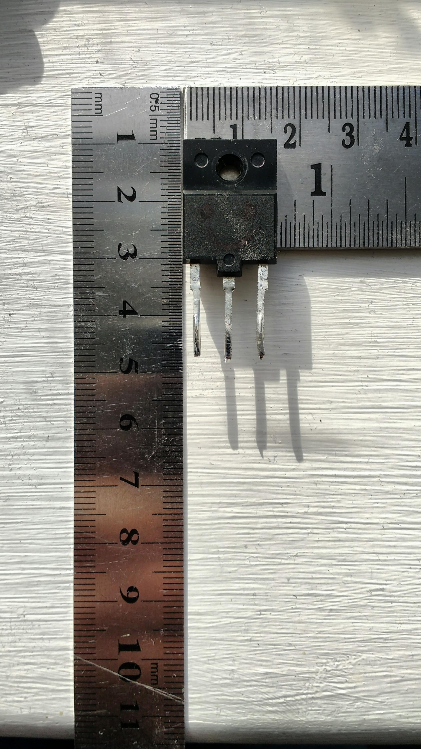

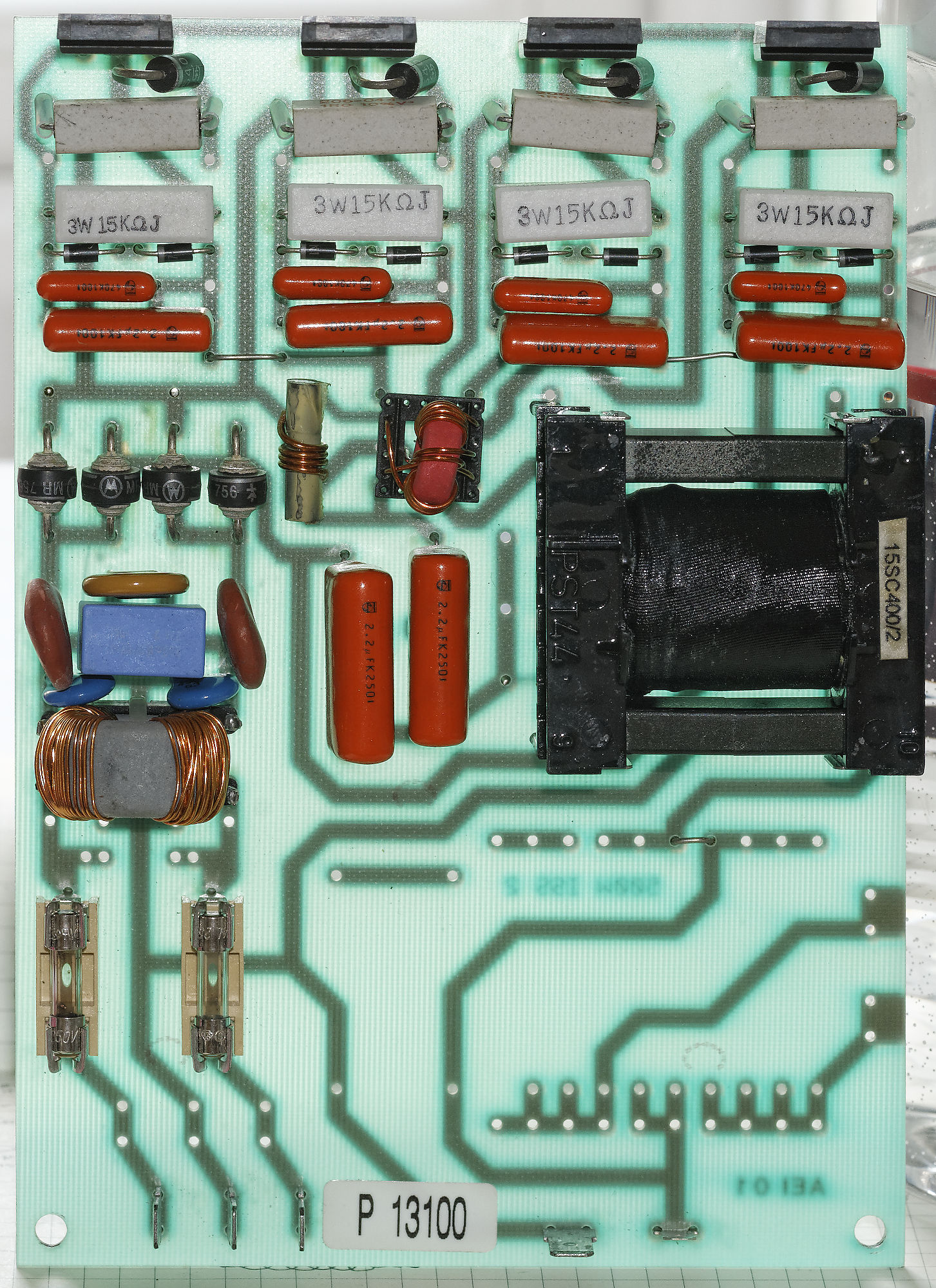

    I inherited an old, dead, Ultrasonic Cleaner. Inside was a loose live wire which seems to have likely shorted to ground and damaged some caps, diodes and two transistors, as well as popping the inline fuses.

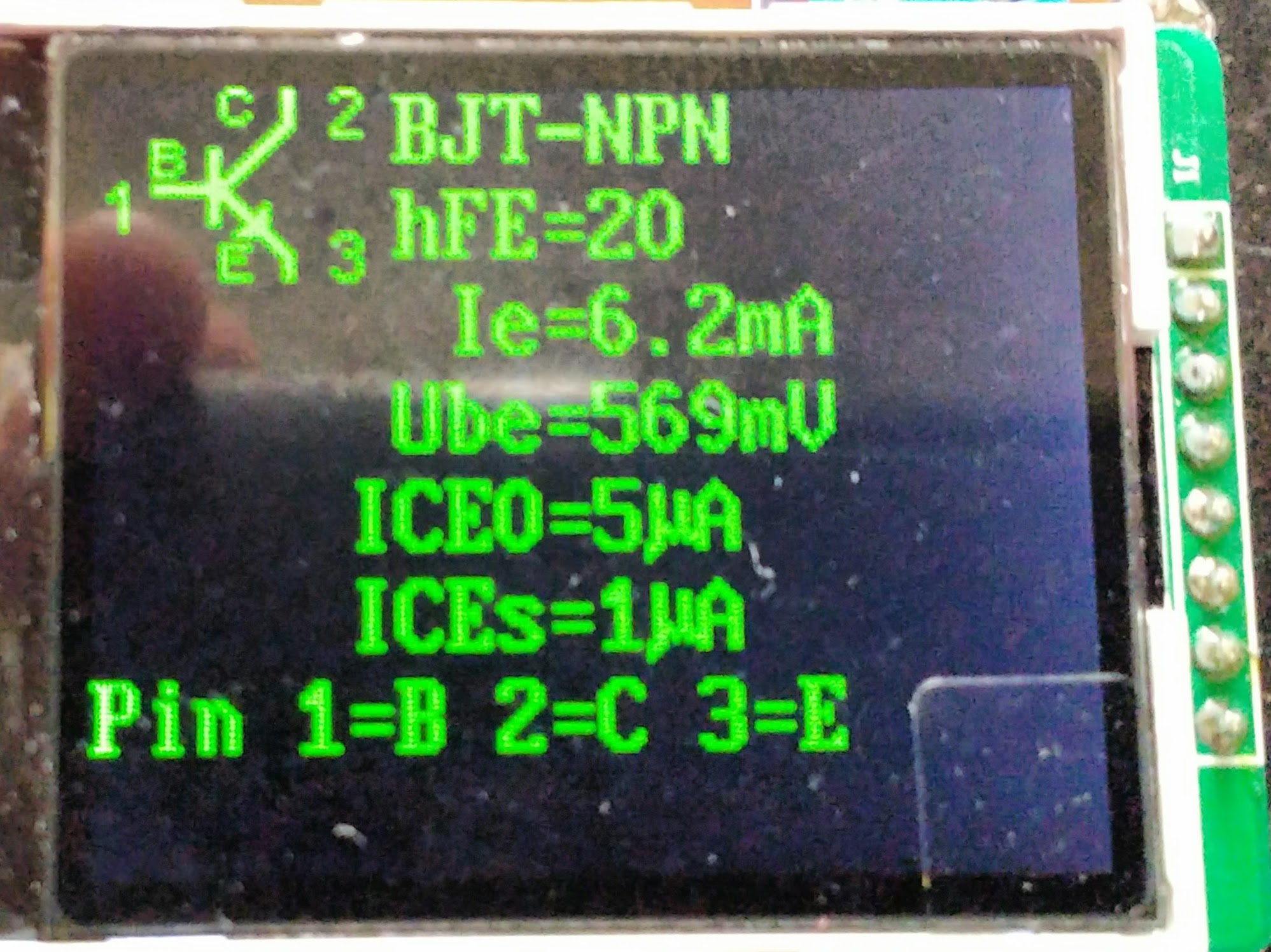

    Attached are images of the power board, a close-up of one of the good transistors, and the results when I put the latter in one of those transisitor-tester things (I've never used the latter for this type of component before so I don't know how accurate it is).
    As you can see there are no markings on the chip at all (other than a faint smiley face, so I don't get it mixed up with the duff one). Could anybody who's more experienced at this sort of thing have a quick look, and maybe offer some advice for a suitable replacement? Or point me in the right direction?

          i would desolder all 4, and meter the resistance between the pads on the board to see if all 4 positions are the same.
          incase something else is wrong.

                That looks like an insulated Isowatt218FDX or TO-3PF package that ST makes. The middle leg plastic is for high voltage.
                BUF420AW does not have insulated (tab) body, so big hassle getting HV insulators and mounting hardware?
                I would look at BU508AF, ST1510FX or MD2310FX 1.5kV 7A 62W hFE 6-28.
