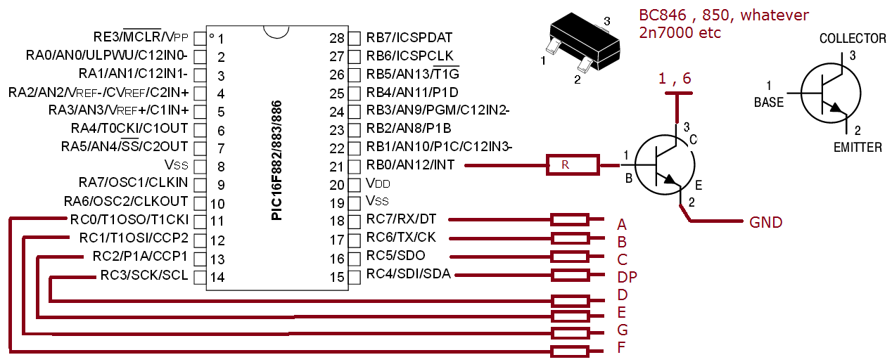

              A simple PIC would do.
              You don't even need binary to decimal converters or whatever you want.
              Think of it like this.. you receive a number between 0 and let's say 999 into the microcontroller and then you have 3 variables.
              nr = 123;
              digit1 = nr / 100; nr = nr - (digit1 * 100); // or nr = nr mod 100;
              digit2 = nr / 10 ; nr = nr - (digit2*10);
              digit3 = nr;

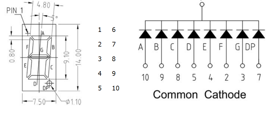

              Now no matter if your led digit is common annode or common cathode, the digits have 8 leds (the 7 segments and the dot).
              So you can just define an array of 10 elements each element being one char / byte that says which segments should be on for each digit from 0 to 9
              IO pins in the microcontroller are arranged in 8 bit ports, so you can simply say something like PORTAbits = mapping[digit1]; to set all i/o pins in PORT A to value from the array called mapping.
              For example, here's a common cathode led digit (meaning all the grounds of leds are tied together): http://uk.farnell.com/broadcom-limit...-cc/dp/1830006
              maybe pin 6 is at the bottom and 10 at the top.. anyway, it's something you can easily figure out with a multimeter in diode mode.
              And to keep things simple, get any PIC that has a full 8 bit port, the first one I found was PIC16F886 : http://uk.farnell.com/microchip/pic1...-28/dp/1439539
              So you have RC0 to RC7 on the micro, which you can set to 0 or 1 in one shot by setting a byte on the PORTC variable.
              So you connect the 8 segments to the RC0 to RC 7 pins in whatever way you want.. for example like this:
              RC0 : 2 (segment F)
              RC1 : 3 (segment G)
              RC2 : 4 (segment E)
              RC3 : 5 (segment D)
              RC4 : 7 (segment DP)
              RC5 : 8 (segment C)
              RC6 : 9 (segment B)
              RC7 : 10 (segment A)
              Whatever you put in the PORTC variable, it will then be like this [ RC7 | RC6 | RC5 ... | RC0 ] ... so basically with one byte you set all segments on or off [ A | B | C | DP | D | E | G | F ]

              Pins 1 and 6 are common cathode. What you do is find a npn transistor, connect the common cathode pins to the collector and the emitter goes to ground.. the npn transistor becomes a switch.. when you send power in the base through a resistor to prevent it from burning up, then the segments connect to ground and light up.
              Then in your code you just have a loop and set the segments for a digit, send 1 through the pin connected to the base of a digit's transistor to enable the digit, wait a few ms, turn off the transistor to disable the digit, set the segments for the next digit and enable the transistor for that digit and so on and then loop back to the first digit.
              You'll need 8 + 3 pins, one for each digit. Or 7 + 3 if you ignore the dot.

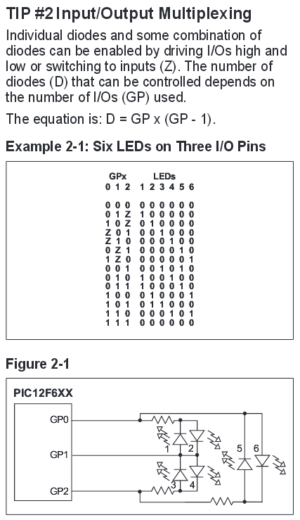

                You can also use some more advanced tricks when it comes to multiplexing leds. For example, here's a way to control 6 leds using 3 io pins.. and it can be extended to 12 leds using 4 io pins, and so on ... but it's more difficult as you can't light up more than 2 leds at a single time (and that's only by accident), so for a 8 digit number, you'd have to go through 8 "refreshes" of the digit in order to draw the digit.
                Here's a project where the guy uses 4 io pins to control 12 leds : https://catmacey.wordpress.com/2011/...ived/#more-511
                It's often not worth it, you have more source code and it's more difficult to multiplex the leds, unless you're really restricted by size it's easier to just go with a larger microcontroller with more io pins.

                        Thank you! I originally thought of driving the 7-segment displays (or 8) directly from the PIC, but thought I could save pins by using a bcd to decimal IC or something. I appreciate the information on multiplexing. I don't fully understand it though from what you've posted and have to research it a bit more. Maybe after checking out that link it'll make a bit more since.
                        Thanks!

                          That last image there, the mcu.png, did you create that yourself? If so, do you mind me asking what program you used? I only have Eagle 7.3.0 light now (the freeware version). I was thinking of saving up and buying a Pro copy, but they switched to a subscription based license. I'm trying to find a semi-easy to use schematic / board layout program now.
                          I tried KiCad but didn't like how I had to pick the package for every single component I added. I found that to be a real pain.

                            I tried to quickly make a schematic in DipTrace but I was lazy and opened up msPaint and then took out the picture of the PIC and the transistors from a couple of datasheets I opened from Digikey and pasted them on the canvas. Rest is just lines and rectangles and text tool.
                            Literally searched for the first cheap DIP package 28 pin PIC chip on Digikey because these usually have multiple full 8 bit ports. 20 pin or 16 pin or 14 pin parts usually have 2 x 4 pin ports, or they have 2 full 8 bit ports but one port may have an input only pin, and the other port may have more useful pins like the i2c/uart ones which you may want to use for other things.
                            I wanted to keep things as simple as possible.
                            You really can easily modify some code to use 4 pins from one port and 4 pins from another port (would be something as basic as shift left value by 4 or shift right value by 4 etc, but I wanted to explain as easy as possible.
                            The TIP2 picture is from an application note Microchip has something called Tips and Tricks .. i think they even include these pdfs on the PicKit 3 (programmer) CD:
                            1. Microchip Technology Inc. DS01146B Compiled Tips ‘N Tricks Guide https://cdn.badcaps-static.com/pdfs/...740bf3fe08.pdf
                            1.5. New Peripherals Tips ‘n Tricks : The Complementary Waveform Generator (CWG), Configurable Logic Cell (CLC), and the Numerically Controlled Oscillator (NCO) Peripherals https://cdn.badcaps-static.com/pdfs/...cd95914060.pdf

                                    2. https://cdn.badcaps-static.com/pdfs/...2b6b382e71.pdf
                                    3. https://cdn.badcaps-static.com/pdfs/...98cebbdeeb.pdf
                                    Originally, I was thinking of using the BCD to decimal ICs because then I could control two 7-segment displays from one port, instead of having a full port dedicated to one display...I gotta research a bit about the keypad as well. It's been a long time since I played with something like that. I figure I'd need at least 8 IO pins to interface with the keypad....
                                    So, without the BCD to decimal ICs, I'd need at least four 8-bit ports, unless I'm missing something.

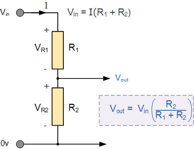

                                        Keypads are easy, and can be done in multiple ways.
                                        The easiest would be to connect every button to an input pin of your microcontroller but that uses a lot of pins.
                                        Another method would be to use the built in ADC (analogue to DC converter) to convert an analogue voltage to a value.
                                        Most PIC micros have 10bit ADC and some have built in voltage references or can use input voltage as maximum voltage. So for example, you can power the PIC with 5v and you can configure the voltage reference to 4.096v and then the ADC will return a number between 0 and 1023, basically 4 mV per step.
                                        If you use the 5v input voltage as "reference", you just divide 5v by 1024 and multiply with the value the ADC gives you, to get the voltage on the ADC pin.
                                        So now you can simply use resistors to create voltage dividers and whenever you push a button, you create a voltage divider which sends a voltage between 0v and 5v on that ADC pin and your microcontroller measures it.
                                        See TIP 7 in the first PDF I linked to :
                                        Whenever you press a button, there's always two resistors on the "top" side in series, and the fixed resistor on the bottom side. So the voltage the ADC pin sees is always (adapting the formula above)
                                        Vout = Vin x [ Rbottom / (Rbottom + Rtop1 + Rtop2) ]
                                        So just by using different resistors for each column and each line on that 4x4 matrix of buttons, you can make it so every time you press a button, you'll get a different voltage on the ADC pin (for example 16 buttons, 16 different levels, so you aim for 1024 / 16 = 64 steps or 64 x 4mV = 256 mv but you want some safety margin on both sides, like around 20mV ...
                                        First button should output something between 0v and 256mV, with safety margins anything between 20mV and 230mV ... let's say aim for 0.15v
                                        Second button should output something between 256mV and 512mV, with safety margins anything between 280mV and 490mV, let's say aim for 0.35v
                                        .. and so on..
                                        The problem with this scheme is obviously that you'd need a lot of 1% tolerance resistors and different values, which increases the cost of this.
                                        You can do a sort of hybrid of this by splitting the matrix in 2 (2x4) and use 2 adc pins and scan half the keyboard first and then scan the other half
                                        Or you can separate the columns at the top and power only one column at the top using a pin for each column (so for 4x4 matrix you'd have 4 output pins and one input pin used) and you'd need 4 consecutive adc conversions to determine if a button is pressed. You save money on resistors and you only need a few different resistors, but it takes more time to scan all the keys.
                                        Note that these schemes save pins but obviously when you press two buttons at the same time, you get garbage, can't detect two or more buttons at same time.
