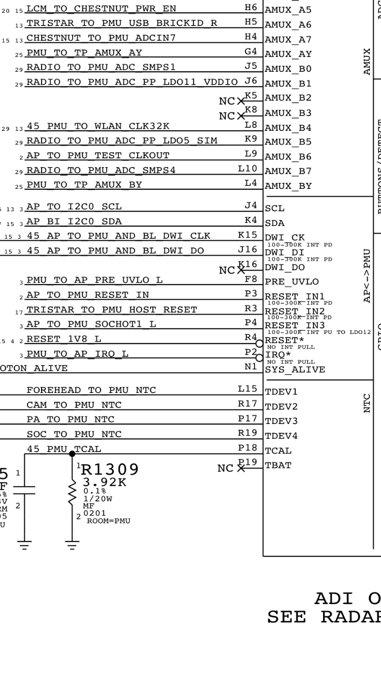

          It's actually a 6 and that schematic is for a 6s which is more complex with it's ready/request pins
          The 6 I'm referring to uses just one reset line that goes to a charge management chip (Tristar), display PMU, and to the CPU maybe for the soc I'm not sure.
          I tried removing both Tristar and display PMU, Reset was still low. The pmic provides the reset and it's a steady 1.8v at the pull up resistor so I assume it's fine.
          When I replaced the 100k pull up with a 10ohm the reset test point showed high of 1.8v like it should be but still phone didn't boot. So I was wondering if the CPU is dead or maybe bc I tried with a too low ohm resistor it didn't work?

                      So in the schematic I've attached do the 3 input resets cause the output reset of 1.8v to be present?
                      The reset test point is for the output reset of 1.8v and that's what's missing. There are two other ic's connected to that output reset which I've removed and the reset still holds low. In the past I've fixed this issue by removing either one of those two ic's.
                      This time it made no change. So does that leave the CPU as the culprit?

                        This is not a simple reset circuit. Same principle as iPhone 5C.
                        I think the PMIC master reset output looks at the three reset inputs, and uvlo, and watchdog heartbeat SYS_ALIVE.
                        The PMIC has three reset inputs and a master reset output and watchdog heartbeat. PRE_UVLO looks like it goes low for undervoltage lockout.
                        The schematic mentions the pullup resistor PU or pulldown PD on the pins.
                        Example RESET_IN3 "100-300k INT PU to LDO12" means the PMIC has an internal pullup resistor 100k-300k value to the LDO 12.
                        I would look at the 5 signals going into the PMIC reset circuit.
                        It could be a bad PMIC or one of the three parts is holding it low.
                        Again, this is just guess work without the PMIC datasheets.

                          That would not be my first guess. The micro might just be doing its job. Since you have 3 lines marked reset IN, I would want to scope all those pins and actually SEE if you get activity on all 3 at power up. If the RESET IN pin voltages just sit there, then the micro is waiting for something to happen.
                          The more general question you asked is whether you might change a pullup resistor to force the circuit into operation and the answer is definitely NO. If you are thinking about changing part values, you are really saying that one of the micro outputs is partially faulty and that you can help it along, by changing resistor values.
                          Since it is easy to compare with another unit, just take a resistance reading from the pin to ground. That will tell you 95% if there is pcb contamination, or an obvious fault at the micro output pin. Personally, I find it odd that the control micro waits for several resets and then issues one of its own. I wonder if things are just labeled incorrectly? It makes more sense that the micro would receive 1 power up reset, then issue 3 resets to supporting chips. Think about it. The control micro has to be up before anybody else.

                            I checked all the input resets and the soc line which is on a 1.8v rail was shorted. I relieved the short but it didn't solve the issue. It actually made the CPU extremely hot to touch afterwards.
                            The soc is part of the CPU so I chalked it up to faulty CPU

                              What type of short did you find, pcb contamination? It doesn't make sense that fixing a short would cause something to heat up, but anything is possible I guess. Remind me please what is soc? I know this as System on Chip, but you obviously have another meaning.

                                The short was a capacitor on the line. Not sure why didn't work after and CPU got hot. Phone had slight water damage.
                                Soc is system on chip, it's part of the CPU but doesn't make up entire CPU in the iPhone. Not sure exactly it's function
