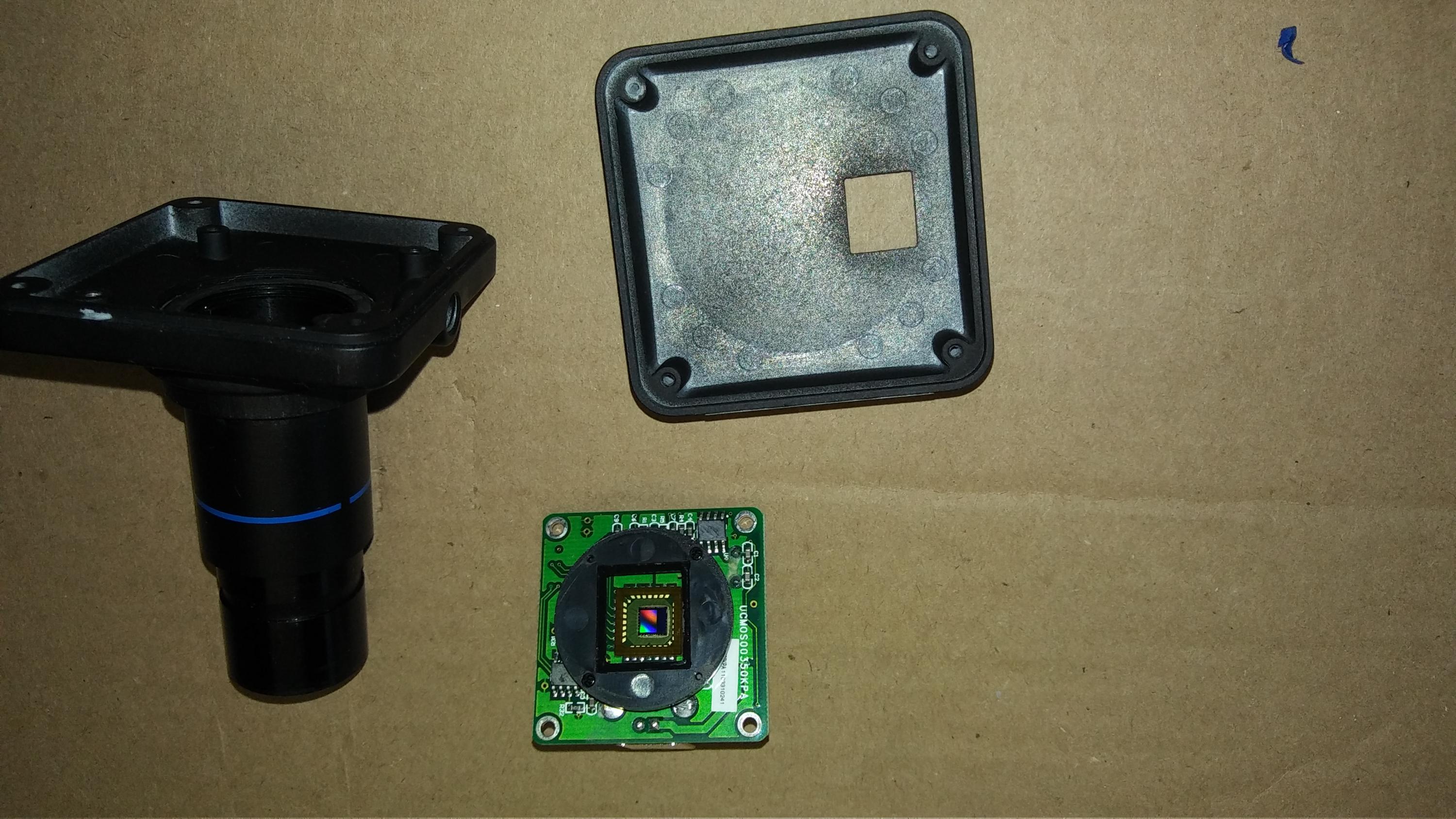

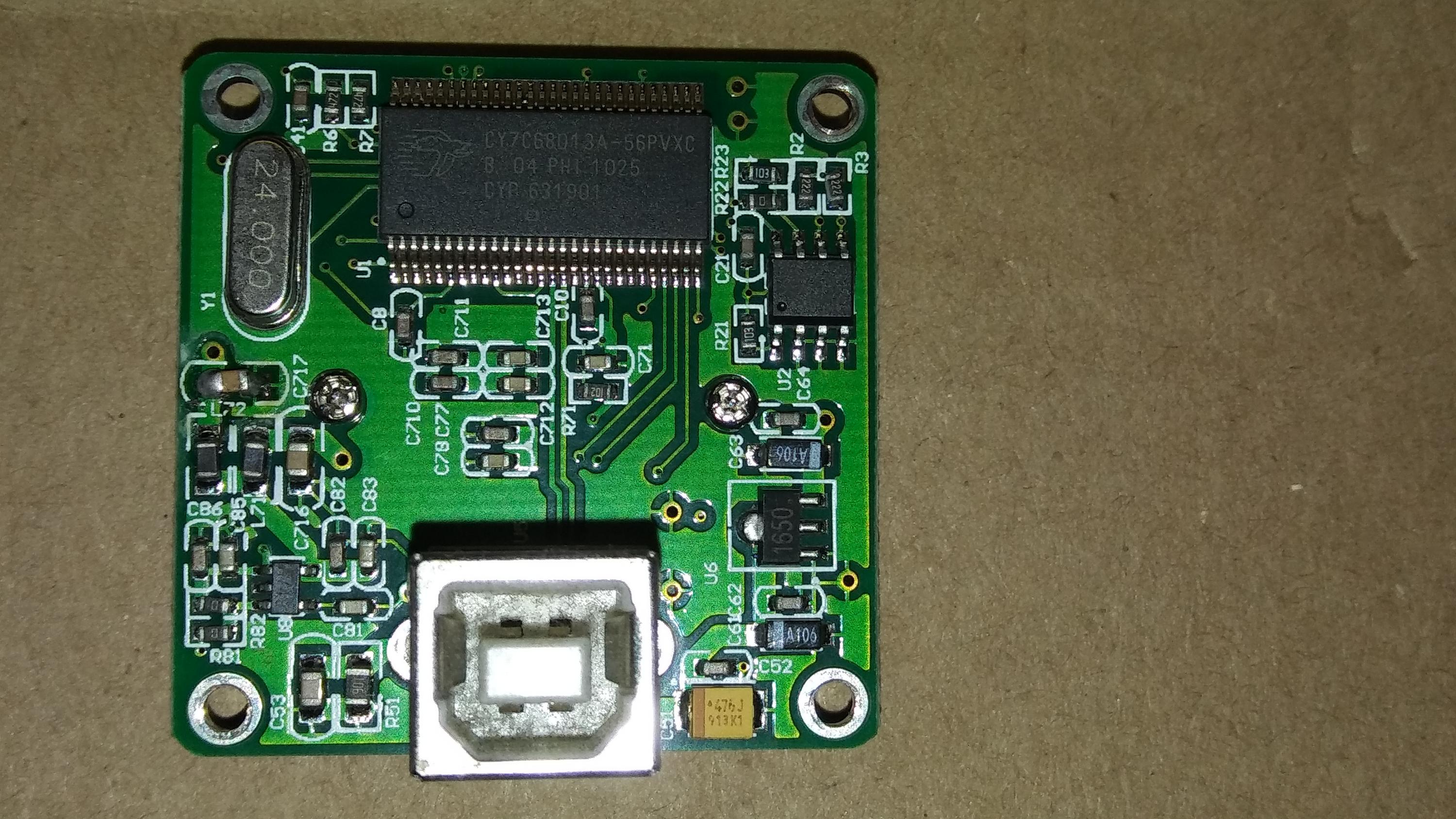

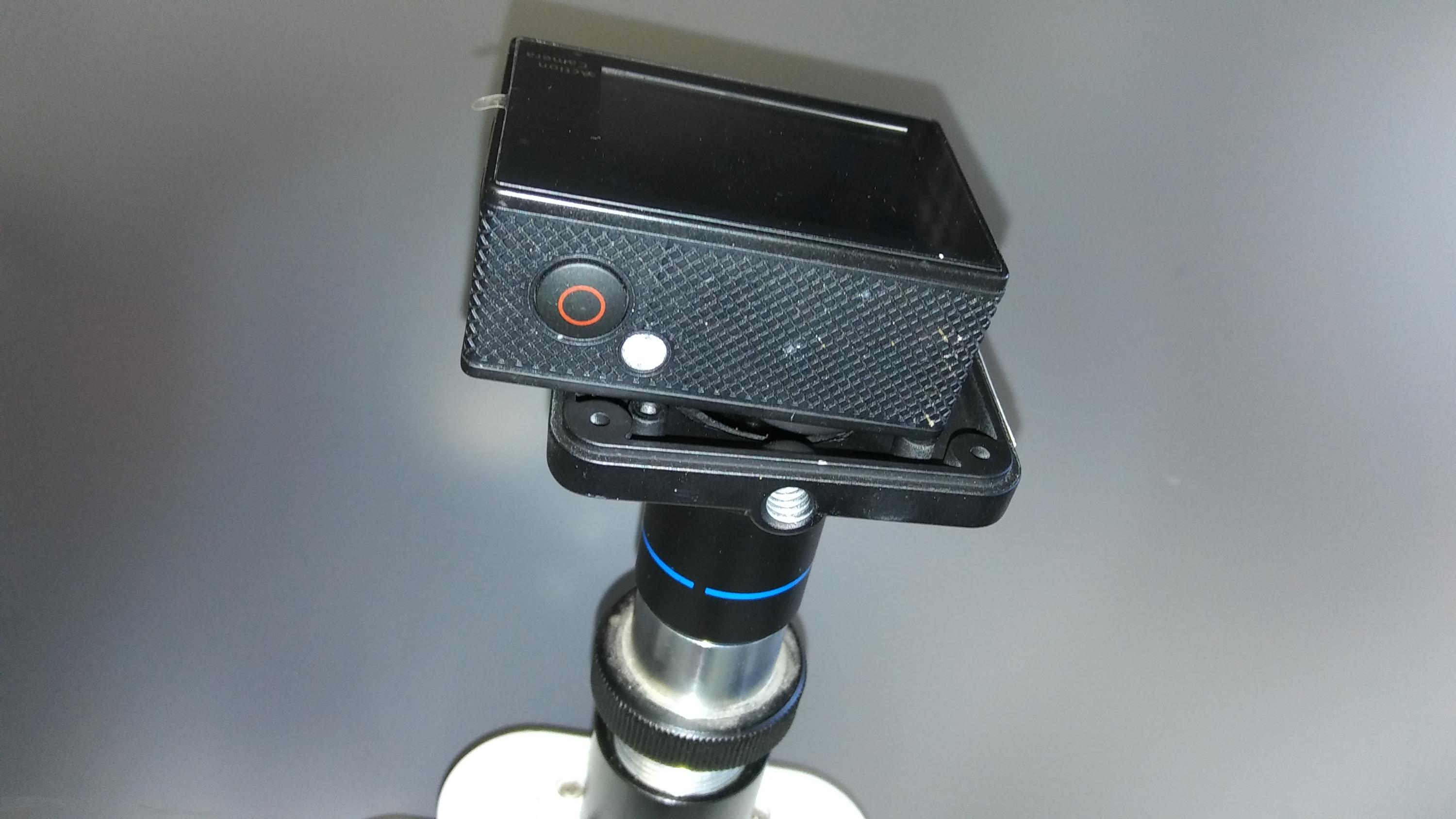

    Hola todas, First, I do not like this 0.3M USB camera(MU035), basically it is a Webcam, needs hook up a computer. An HDMI output is a must for live no delay movement, and I need video recording, for all that, budget is $10. This Amscope did not pay for itself, so I cut my budget down to $10.
    My hope is this (pic5: a 1080p Action Camera with SD recorder) which I paid $36 on Amazon............ .................

        Neewer® 1080P WIFI Sports Camera (Underwater 30m) with 2.0″ LCD Display 12MP 170 Degree Wide Angle Full HD Lens Micro USB 2.0 Micro Hdmi Support 32G Tf Card Micro SD Card + 900mah Battery $35.99
        http://digitalcameraboutique.com/nee...-batteryblack/
        But ..but ...pero..Vato...I look the LCD screen is bueno? yo pensé just necesitar to take out the fisheye lente.
        PS: Video Resolution: 1080p 30fps / 720p 60fps ¿Eso es bueno?

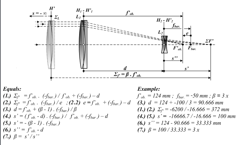

                The working distance secret is over Peter Barlow's Lens, I try to use lens from junk DLP TV to accomplish this task with my Live HDMI 1080p 30fps / 720p 60fps Action Camera without AMscope.............
                I ordered Micro HDMI cable to test this action camera. Will update.

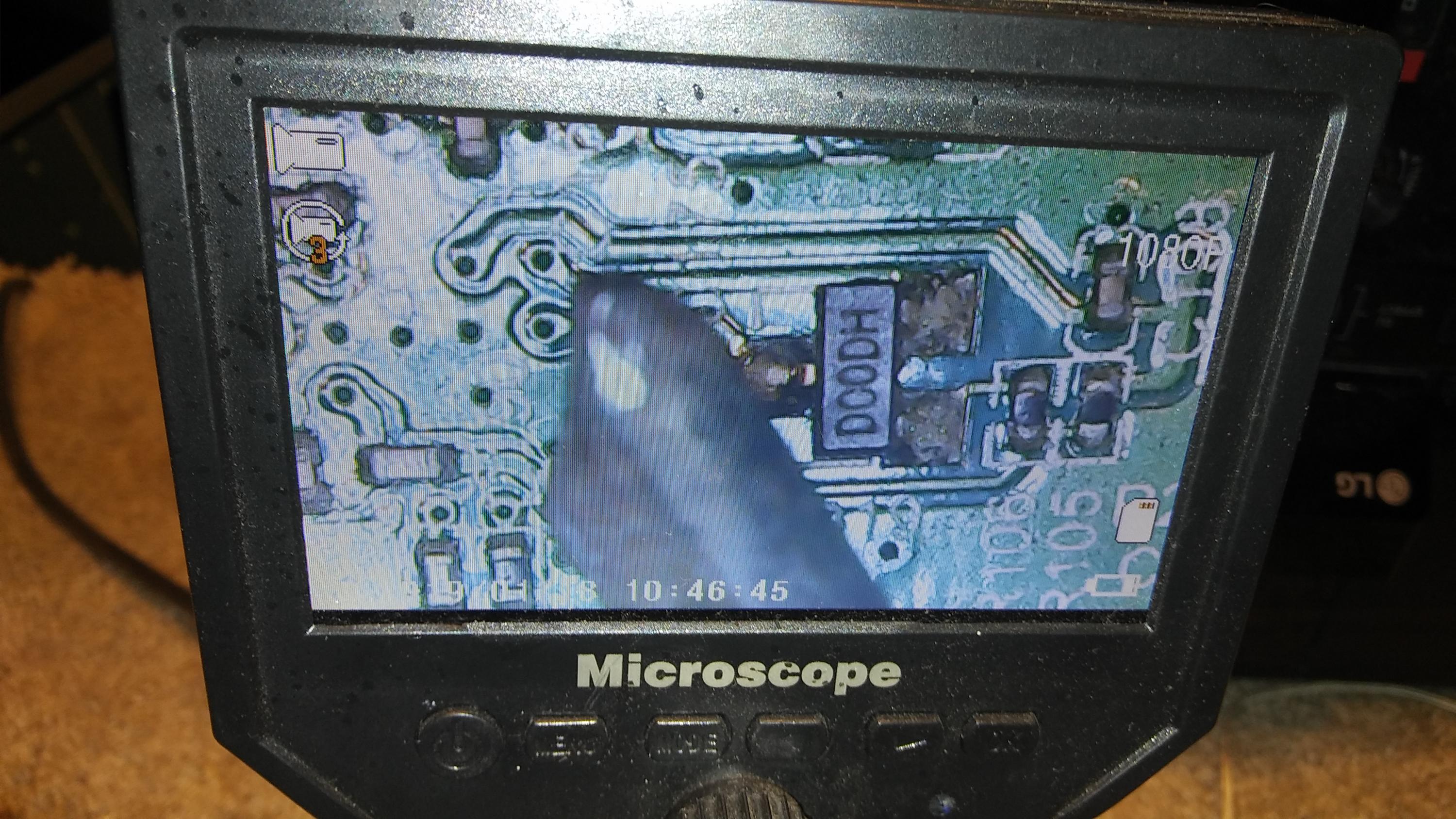

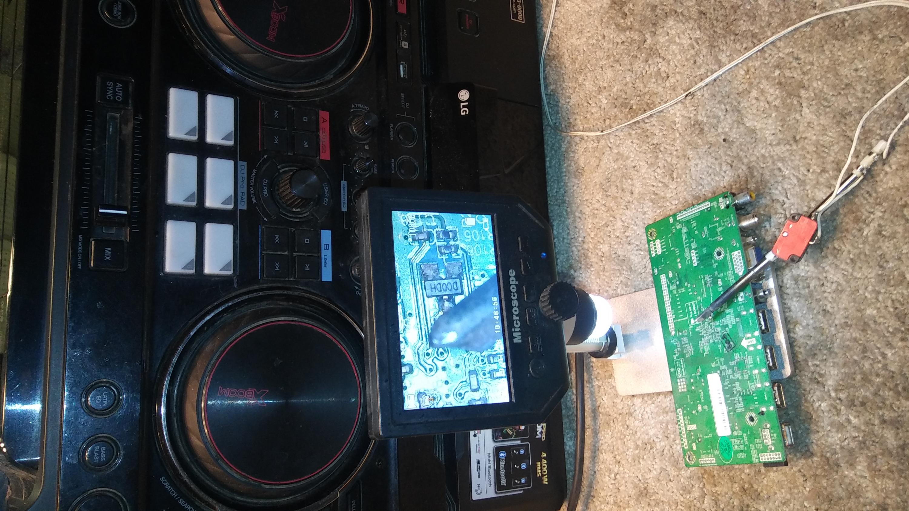

                      I have used this for 2 years the soldering distance is good and you can record 1080p videos and take snapshots.
                      The best part is I have used almost everyday for SMD Parts identification because of light weight, it is convenient to moving around.

                                  MUSTOOL G600 Digital 1-600X 3.6MP 4.3'' HD LCD Display Microscope Magnifier 64G
                                  ebay number 312197880807
                                    Re: Microscope Camera
                                    Please let us know how it performs.
                                      • Jul 2011
                                      • 6057
                                      Just got mine today I have to wait until I changes up fully to really try it out
                                      But I have turned it ON and it seems to work very well I magnified the shipping label and it is very clear on the screen
                                      So far I am very surprised at how well it seems to work the real test will be how long and how well it works in the long run
