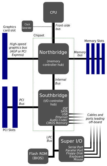

    Study MSD3393LUM
    MSD3393LUM is A microprocessor made by MStar Semiconductor, Inc. (晨星半導體股份有限公司) was a Taiwanese fabless semiconductor company. (WiKi)
    MStar was often referred as "Little-M" in Chinese community, as a contrary part of the bigger semiconductor company "Big-M", a.k.a. MediaTek.
    Question : is how can we programmer it? Is it based on Cortex-A17 Processor? Where we can get more informations?
    pic1 : It's the only information I can got on the Net!

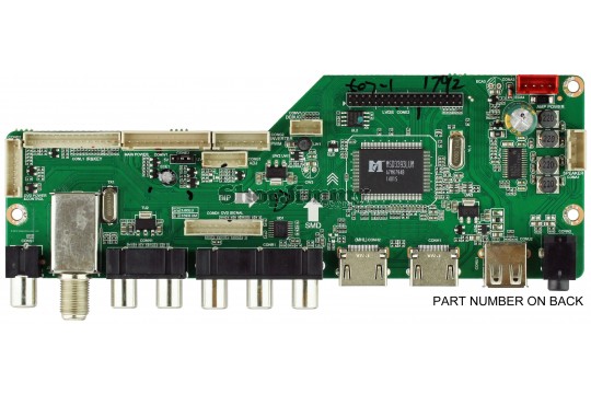

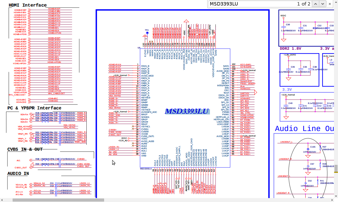

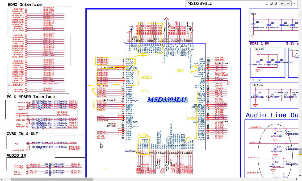

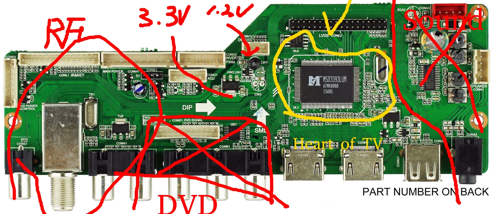

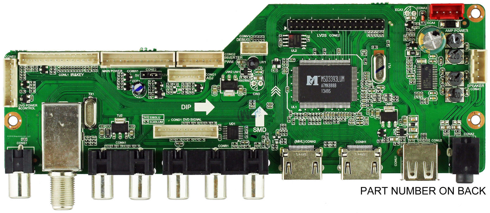

    Re: Study MSD3393LUM
    MSD3393 is the heart on all the Chinese TVs, but how come it can use on 19" - 55" TV , The genie(software) in the jar?
    PS: Don't they Evolved from computer graphics chip GPU?
    MSD3393 on Haier Model No. 55E3500
    MSD3393 on Haier Model No. LE19B13200
    PS: This TV board is RCA or MStar made it? (pic2,3) RCA RE01M3393LNA12-A1 Main Board for LED32B30RQD
    pic4 : Can we short the pin 131 and get test pattern? I ask Trump "We do not any informations! Do something. "
      You can't program the chip, you need to program the flash memmory next to the chip (UL2 chip in the photo you posted)

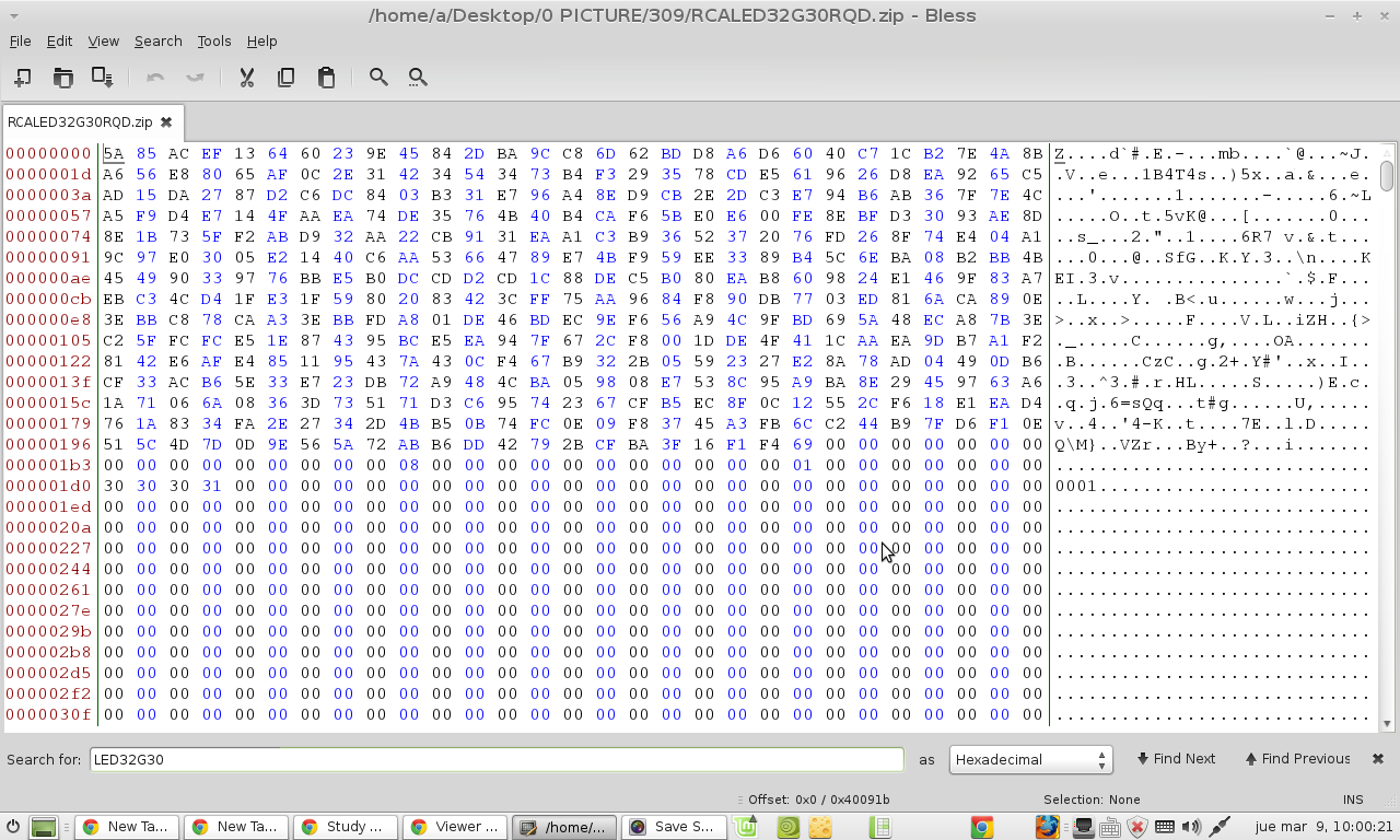

        RCA GE01M3393LNA12-A2 Main Board for LED32G30RQD
        This Bin file is the EEPROM dump from LED32G30RQD , I need to change to ZIP file to upload!
        Question : How can I read it, I cant open it to read ?

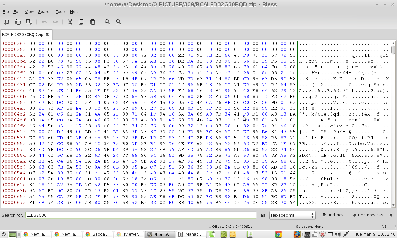

            Sorry it is a .bin file, Badcaps not allow too big file so I change filename to .zip
            sudo apt-get install bless .................... on LINUX mint 15
            pic1,2 : I can't see anything? try Find "RCA" still nothing happen?
            Do I need to use logic analyzer to do with it? SALEAE 8 ch or 16ch do I need?
              You are trying to use this board with different kind of panels, right? in that case i doubt that the same firmware is valid for all panels, you need to download the proper one for your panel.

                "You are trying to use this board with different kind of panels, right? "
                No, It is A working TV I try to study Firmware So I dumped the Data one year ago. Now, This TV ( LED32B30RQD) is long gone. I'm just curious about how their produce tv and what is the Inside TV, and how TV works.
                I have two working RCA 55" TV both have same model No. but they are different panels and use different SoC ICs. I will total open and study both of them.
                  It is a very complex task, as you only have the binary. I would try to decompile but keep in mind that this dump will likelly have "regions" some used to keep data (like a logo for example) and others for the program itself or plain text strings, consider that there are methods to cypher the Program making this project only suitable or experts with years of experience in the field.
