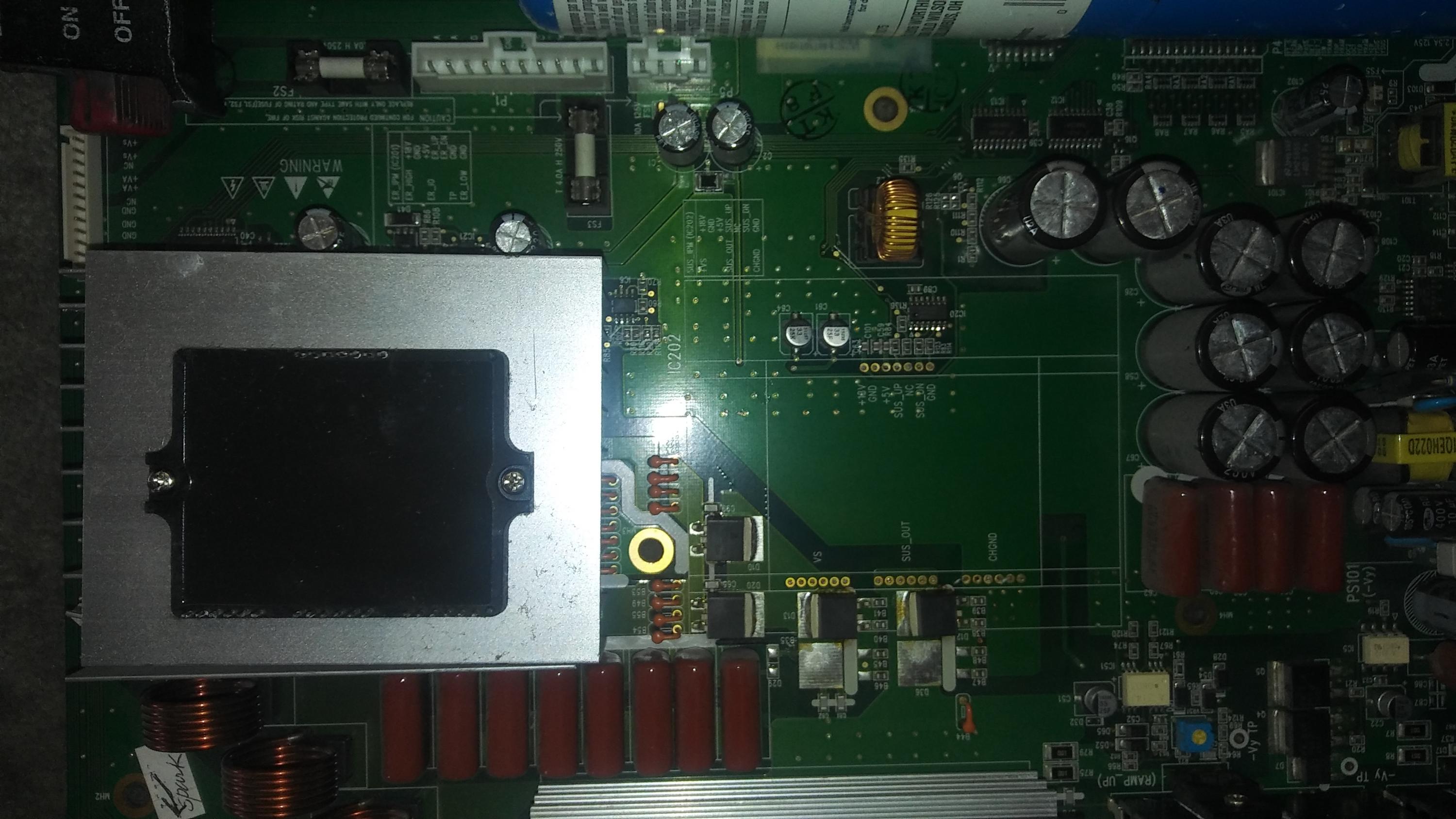

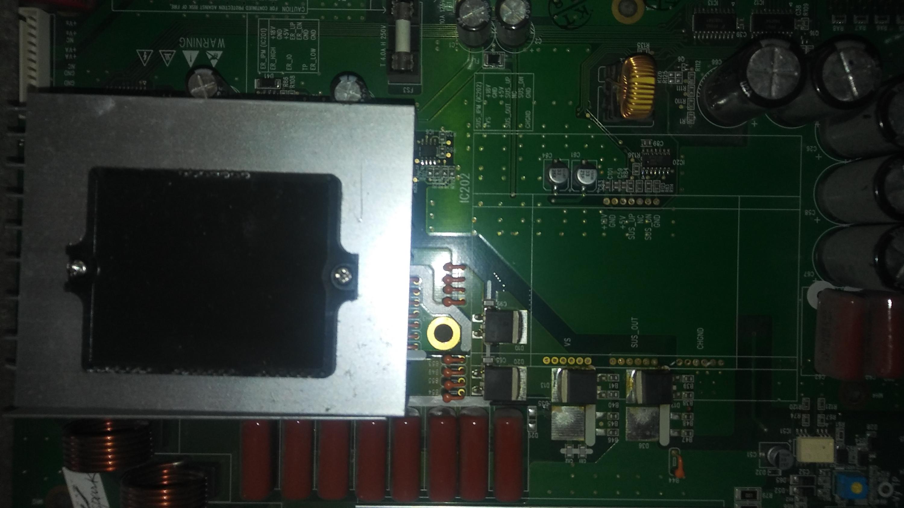

Y-sustain Board IPM is out in 10 seconds!
  • capwizard
    • Jun 2016
    • 1991

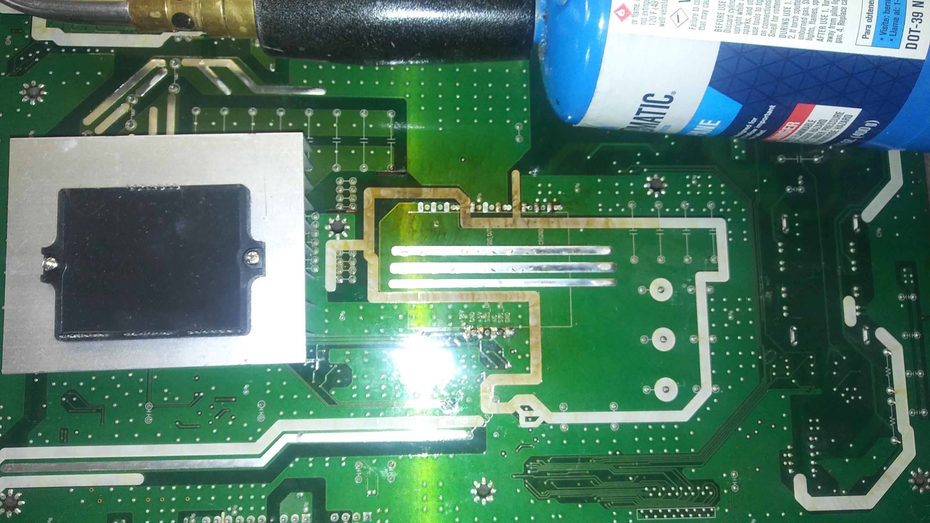

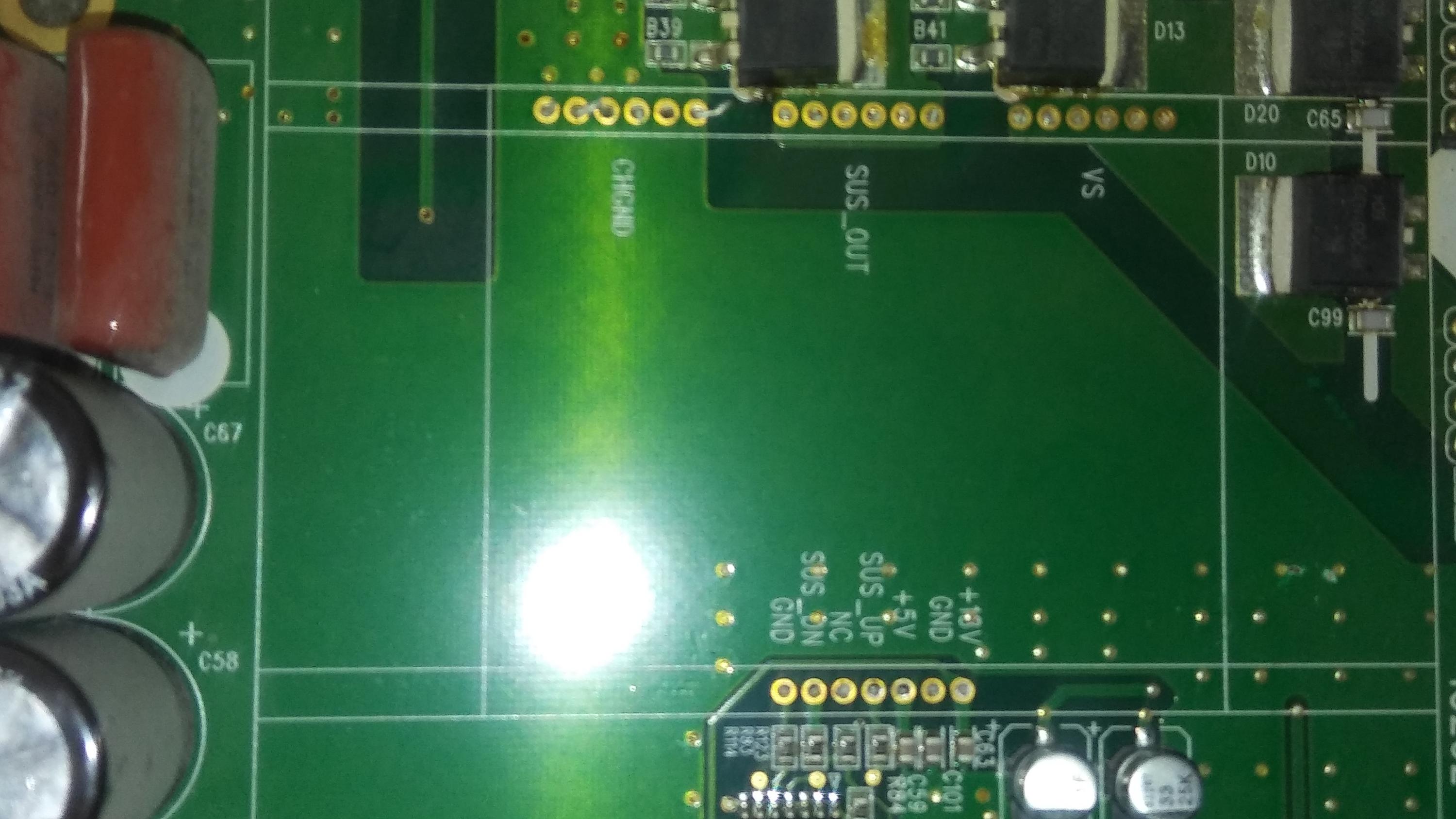

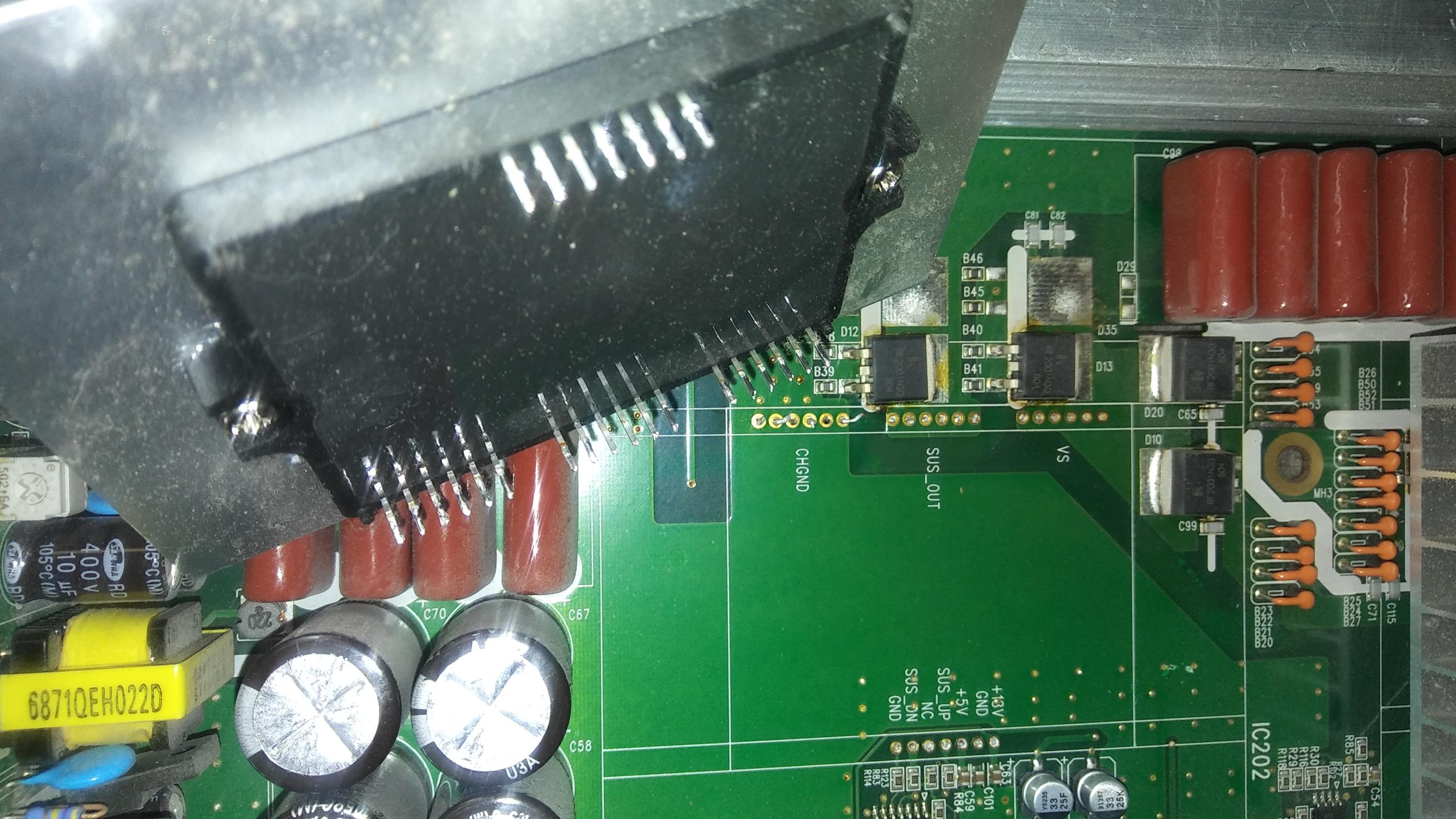

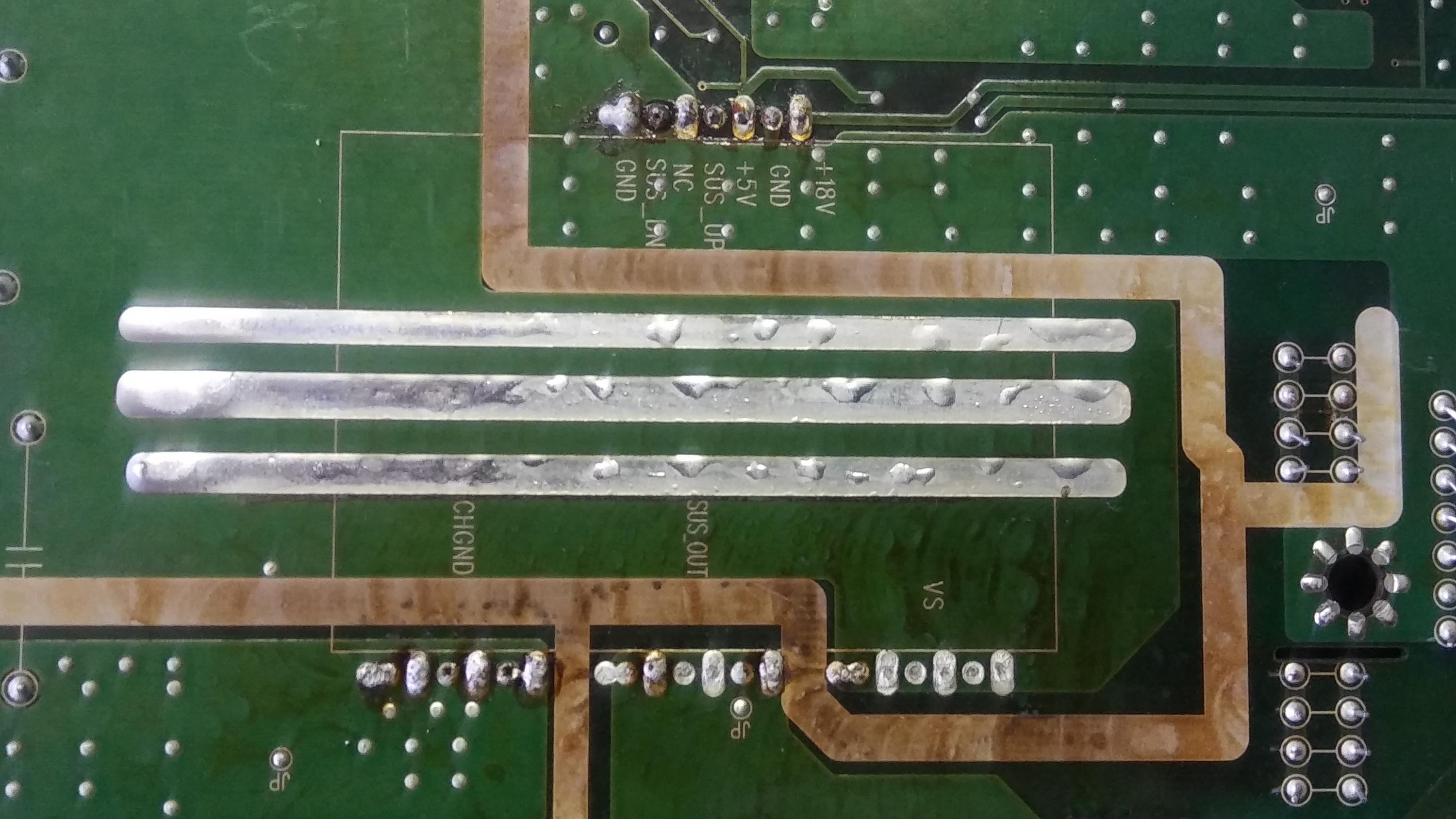

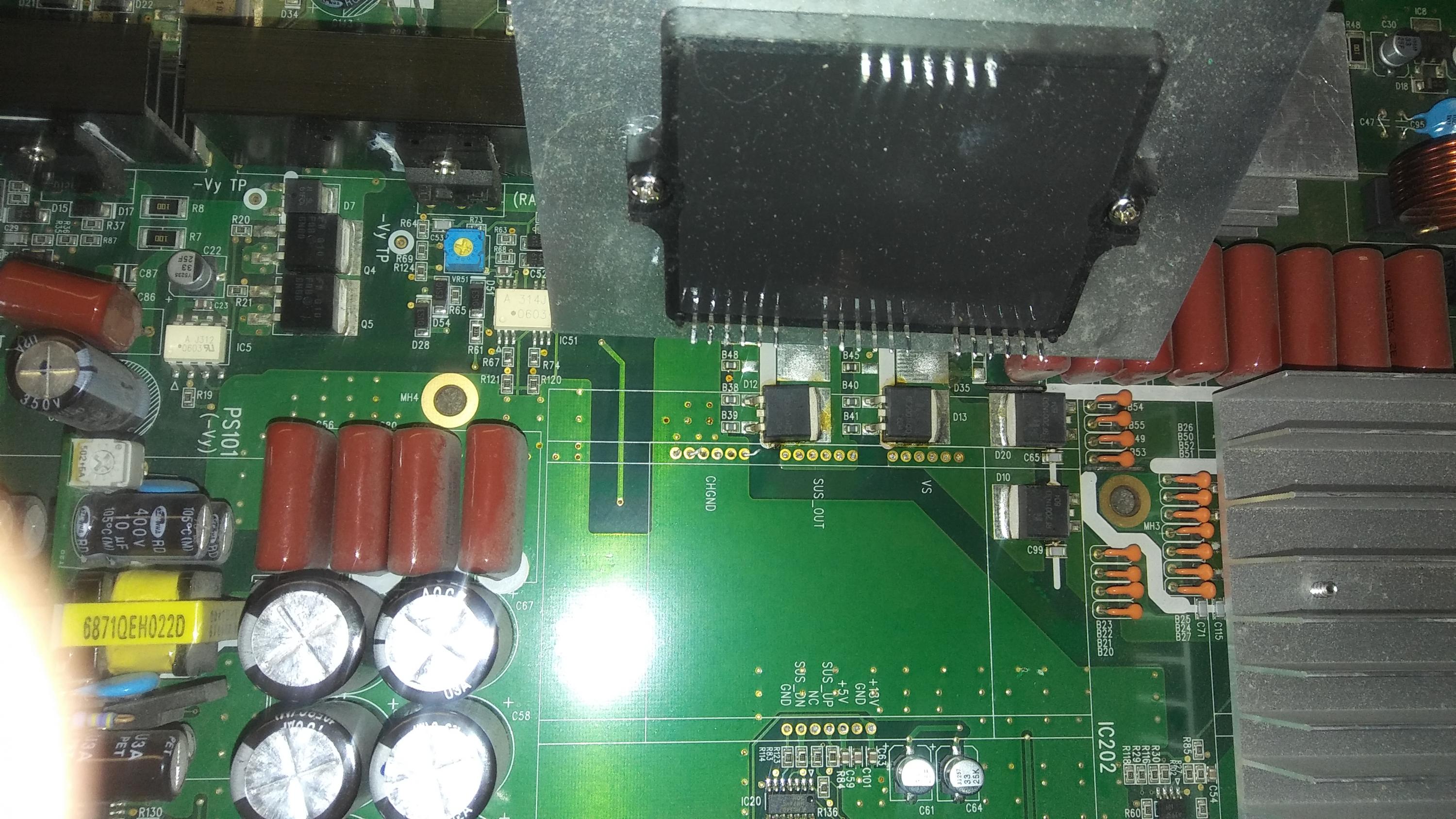

    Y-sustain Board IPM took out in 10 seconds with Propane Torch...................

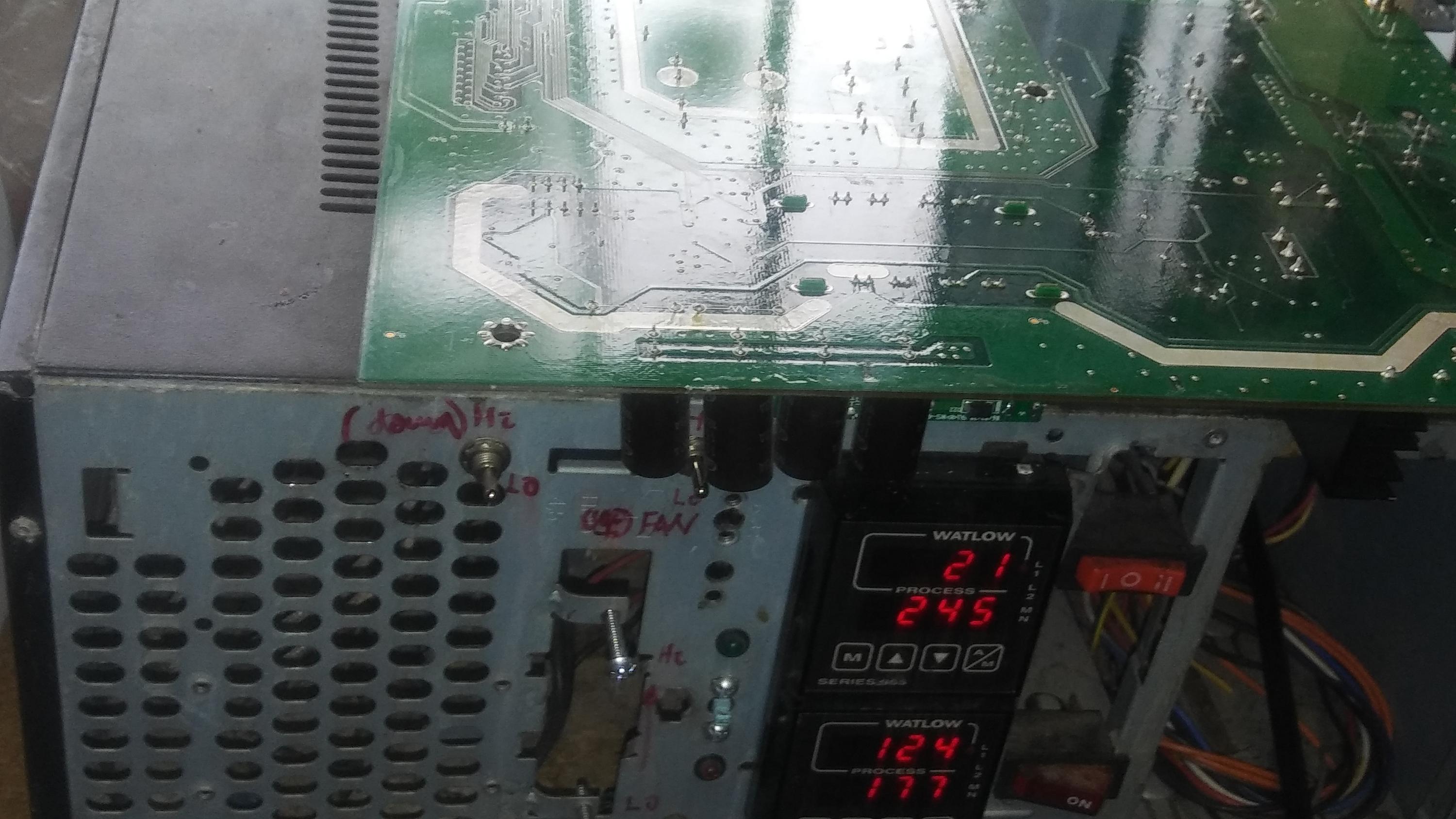

    Re: Y-sustain Board IPM is out in 10 seconds!
    Lol sorry to sound like a cock, but takes me a few seconds. Just use hotair and desolder gun off in literally minuets but good job
    • capwizard
      • Jun 2016
      • 1991
      First, I need to preheat the Y-sus board to 180'c.

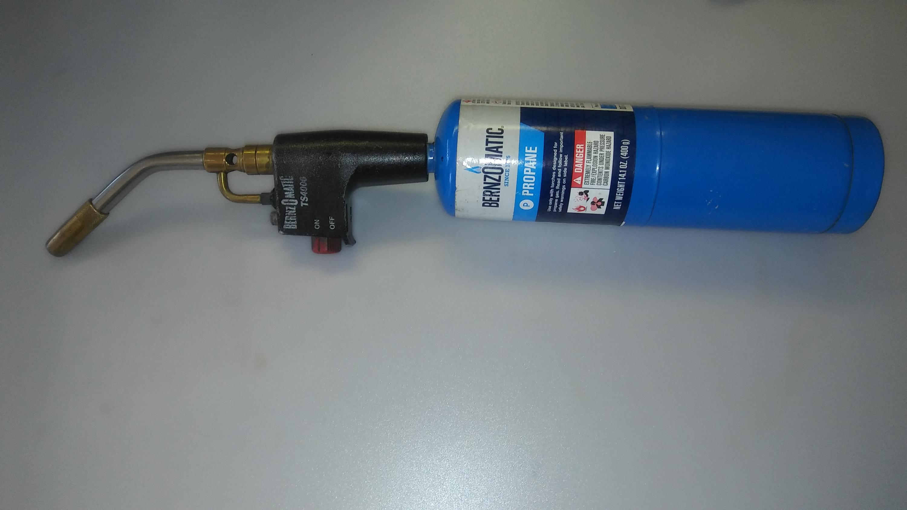

      PS: It is the Bernzomatic TS4000 Trigger Start Blow Torch.............
