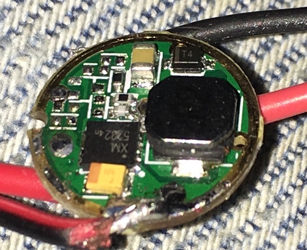

            You could use some Kent brand batteries that you can buy on EBay
            But you need to buy the charger for this type of lipo battery it is a 1.5 volt output voltage the run time is pretty good for there size
            One note on this battery I would NOT recommend this battery in a high current device and here is why it uses a buck converter board that is at the top of battery which is very small (yes I have taken this battery apart
            I would NOT recommend doing this when I did this the first time I hit board and the top of battery got real warm almost to point that it was to hot to touch I did this a second time and this time I was able to get the buck convert board in one piece and this one works
            [ I need the buck converter board for a mod on a MP3 player that uses one battery that not last very long on one battery I am going to make a monster battery pack for this player])
            I use these batteries in a volt meter and it works very well my son has use it in his Xbox remote controller
            OR
            These batteries can also bought on EBay as well
            Yes you could use Ni-Zn (BPI Brand) but the battery voltage when fully charge is 1.8 volts but the run time is very good but you have to buy the charger for this type battery
            I use these batteries in my Mag Light 3 cell battery flashlight that uses AA batteries
            But both of these batteries are price-e but to me they are worth the money but each has there place where they can be used

                        Re: Making a Rechargeable AA Battery Pack
                        https://metaefficient.com/rechargeab...ies-exist.html
                        "Lithium-ion batteries normally operate 3.7V per cell — but Kentli put circuitry inside the cells to reduce the voltage to 1.5 volts"
                        That is why you get 1.5V! I knew there is a catch to get the 1.5V from Lithium batt.
                          In post #6 I talked about taking one apart and the mishap on the first one I tried but second time I tried it I was able to use the buck converter board here is a picture of one
