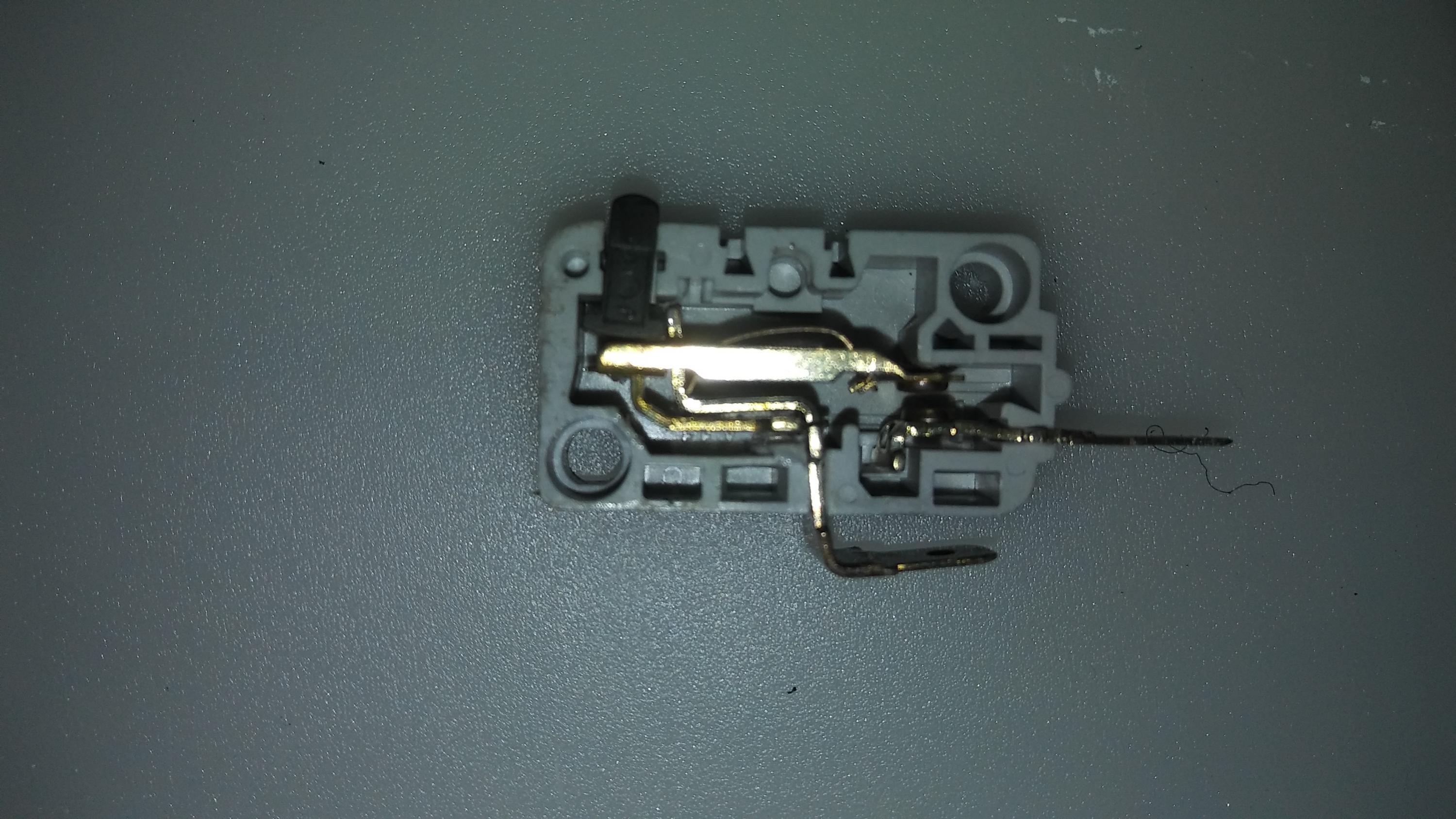

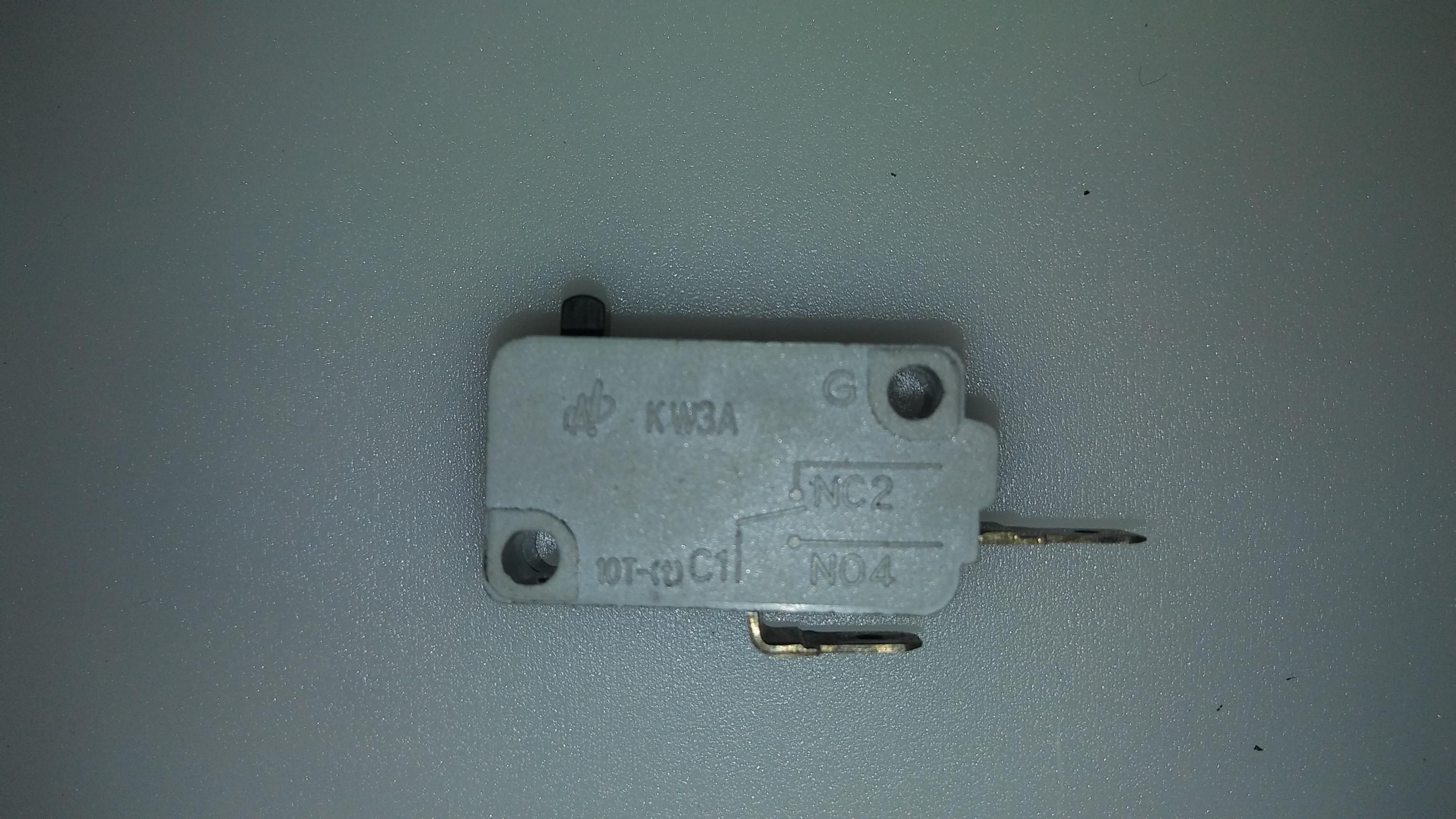

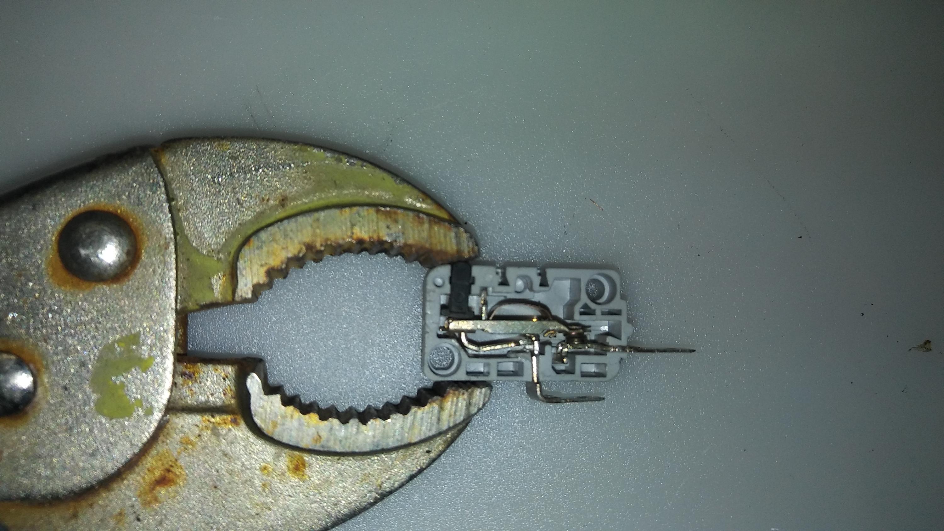

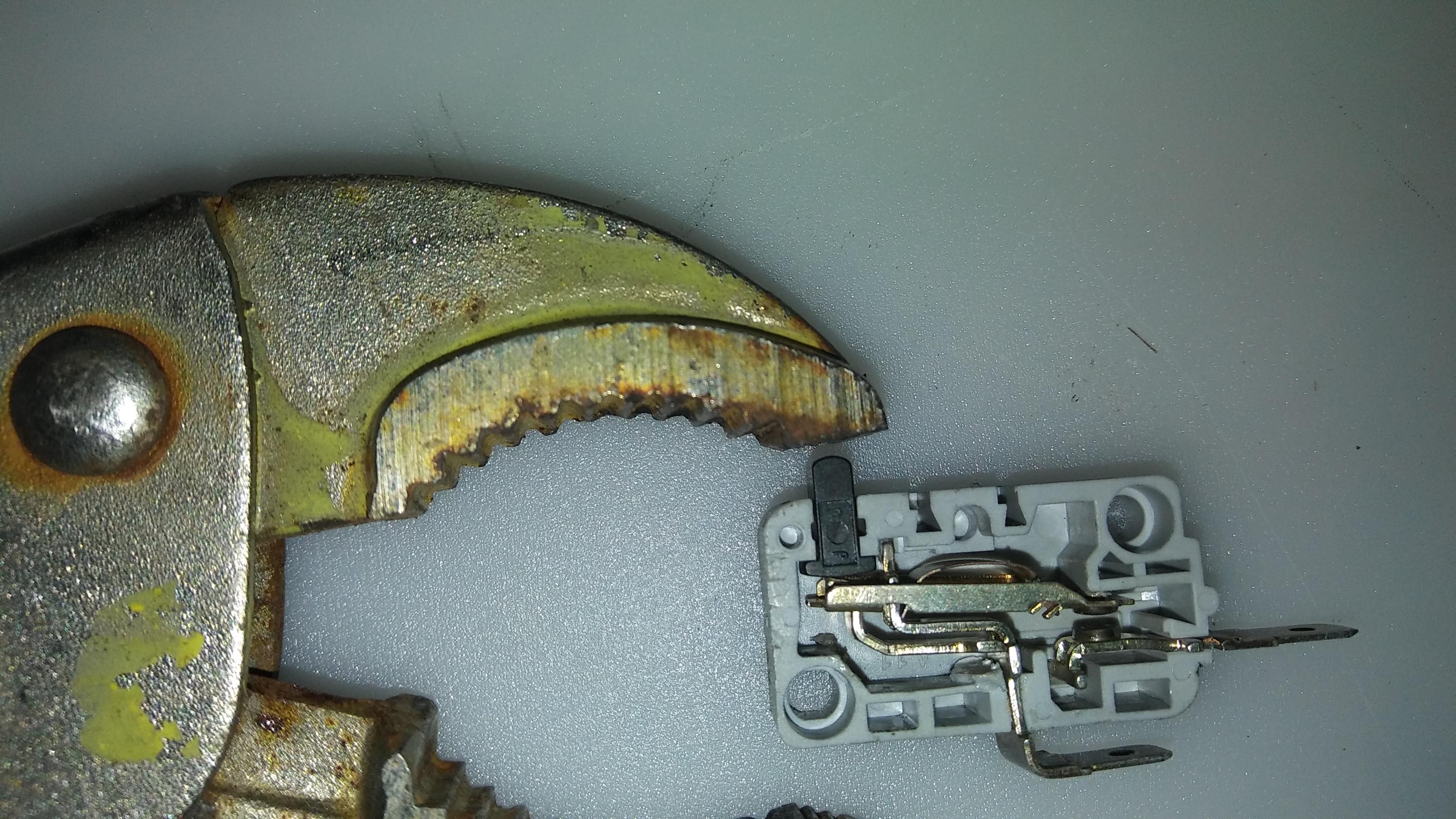

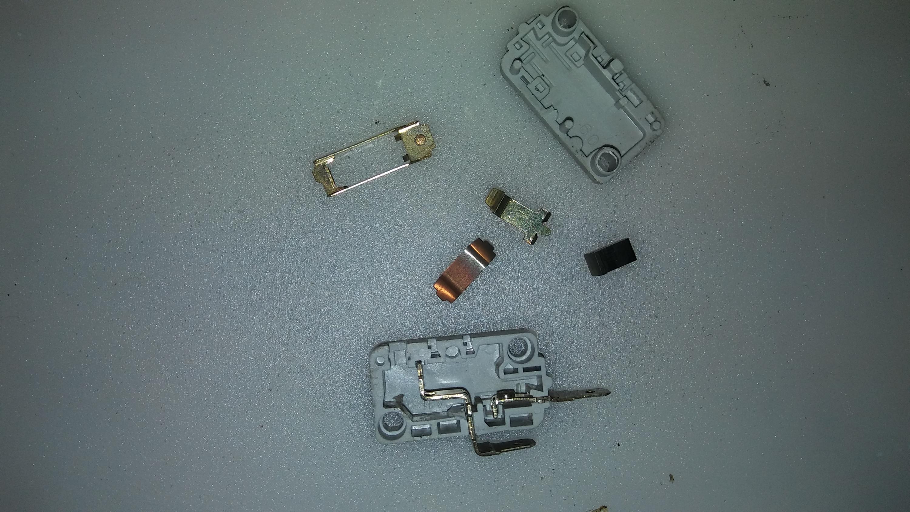

    Micro Switch Rebuilt.

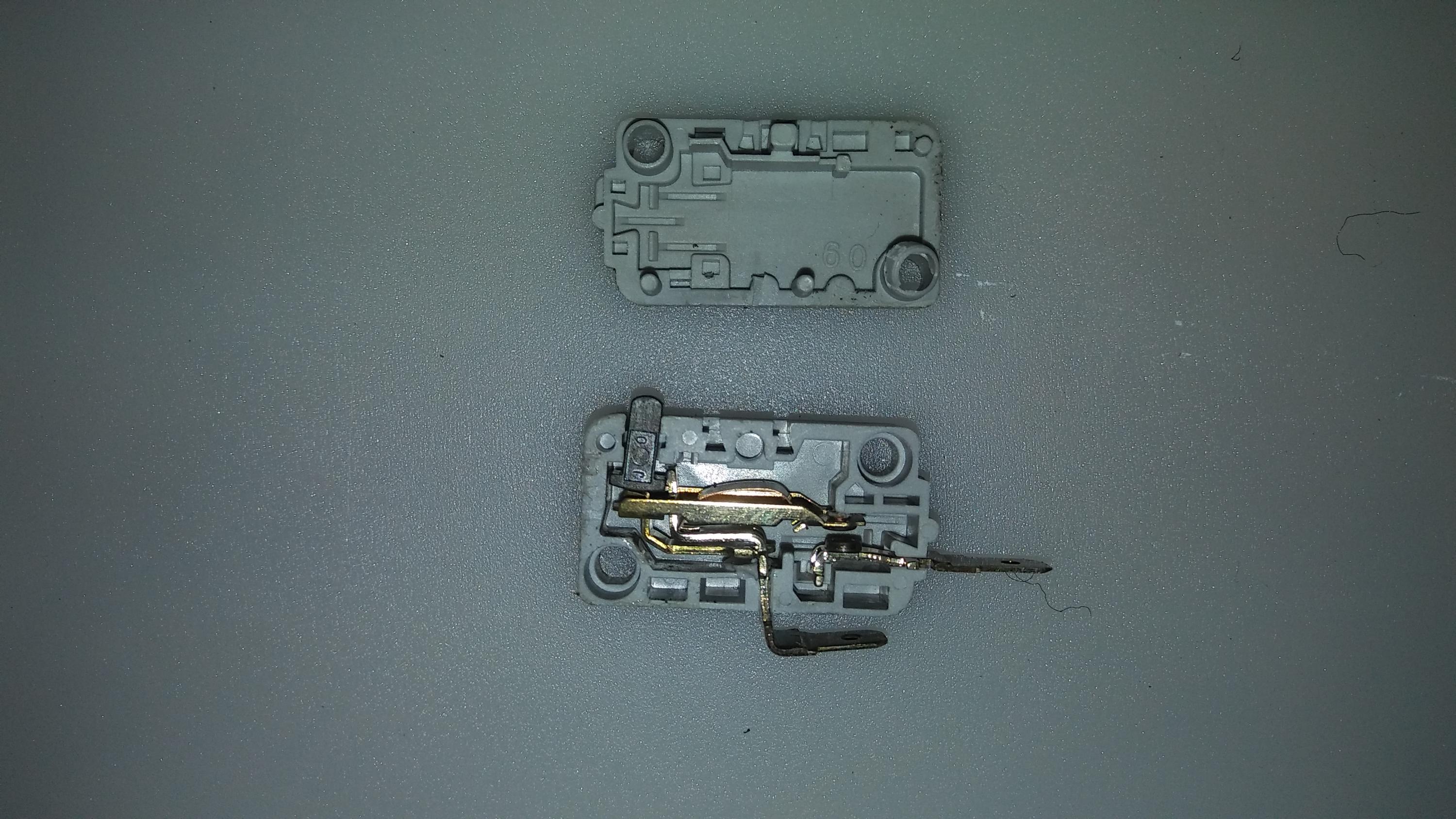

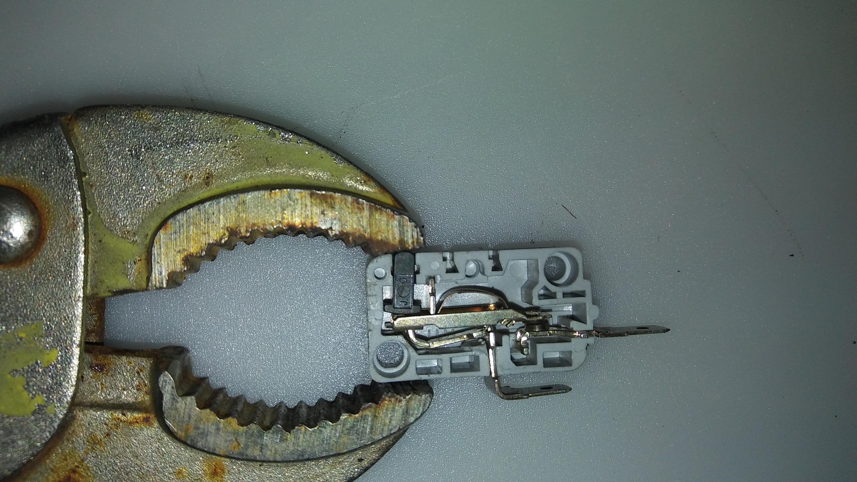

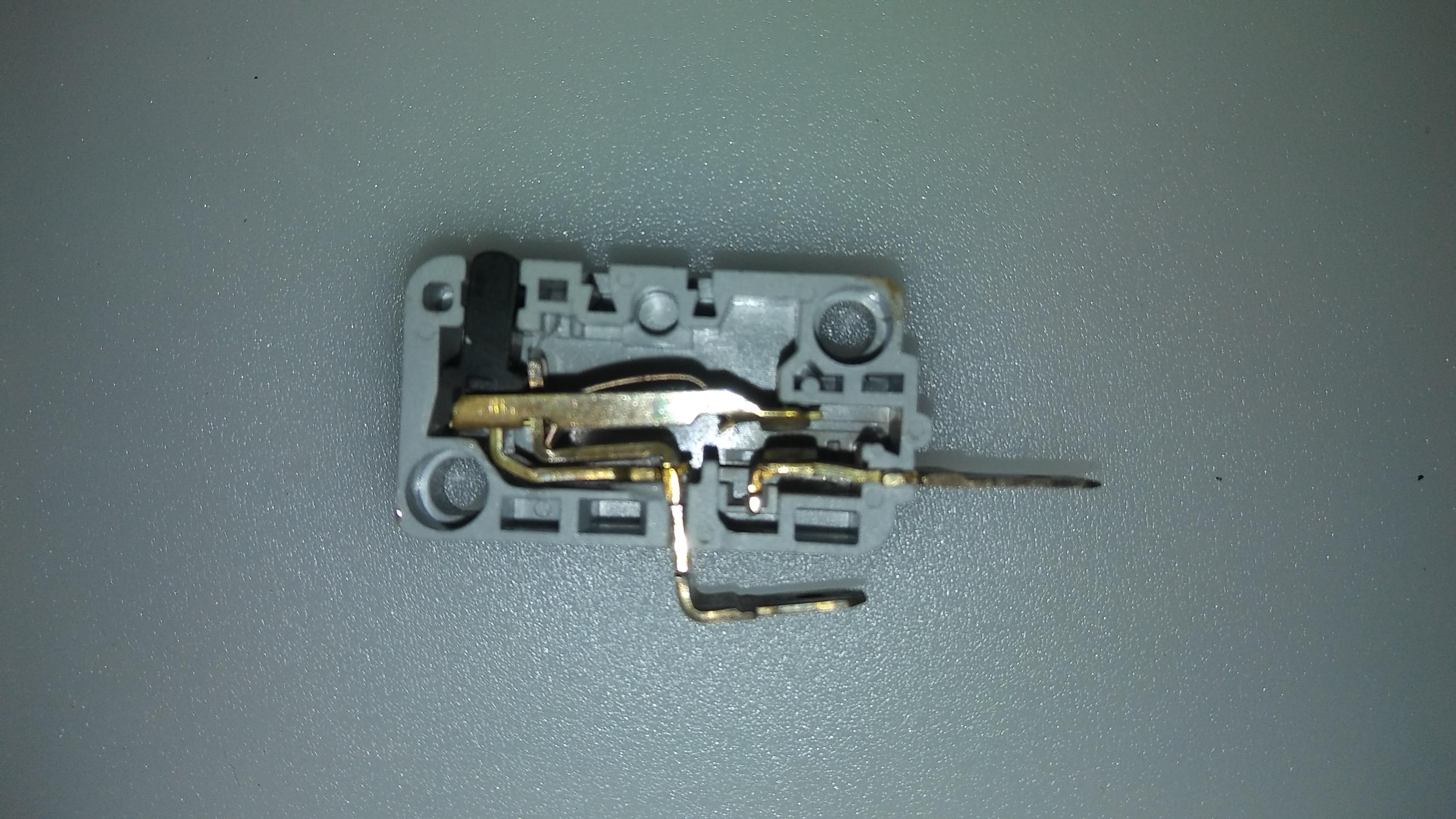

    Open micro switches rearrange the parts I fix two of them.
    PS: Look pic2,3 has pubic hairs? That's not mine! The color of my hair is ....If you dont believe that I can post the photo of mine!

    The contacts look very black, do not look good. Try running the rated current through the switch to find out what Vdrops you have on the contacts. Good switch will have contact resistance in low mOhms range.
    It looks like switch from microwave.

      Re: Micro Switch Rebuilt.

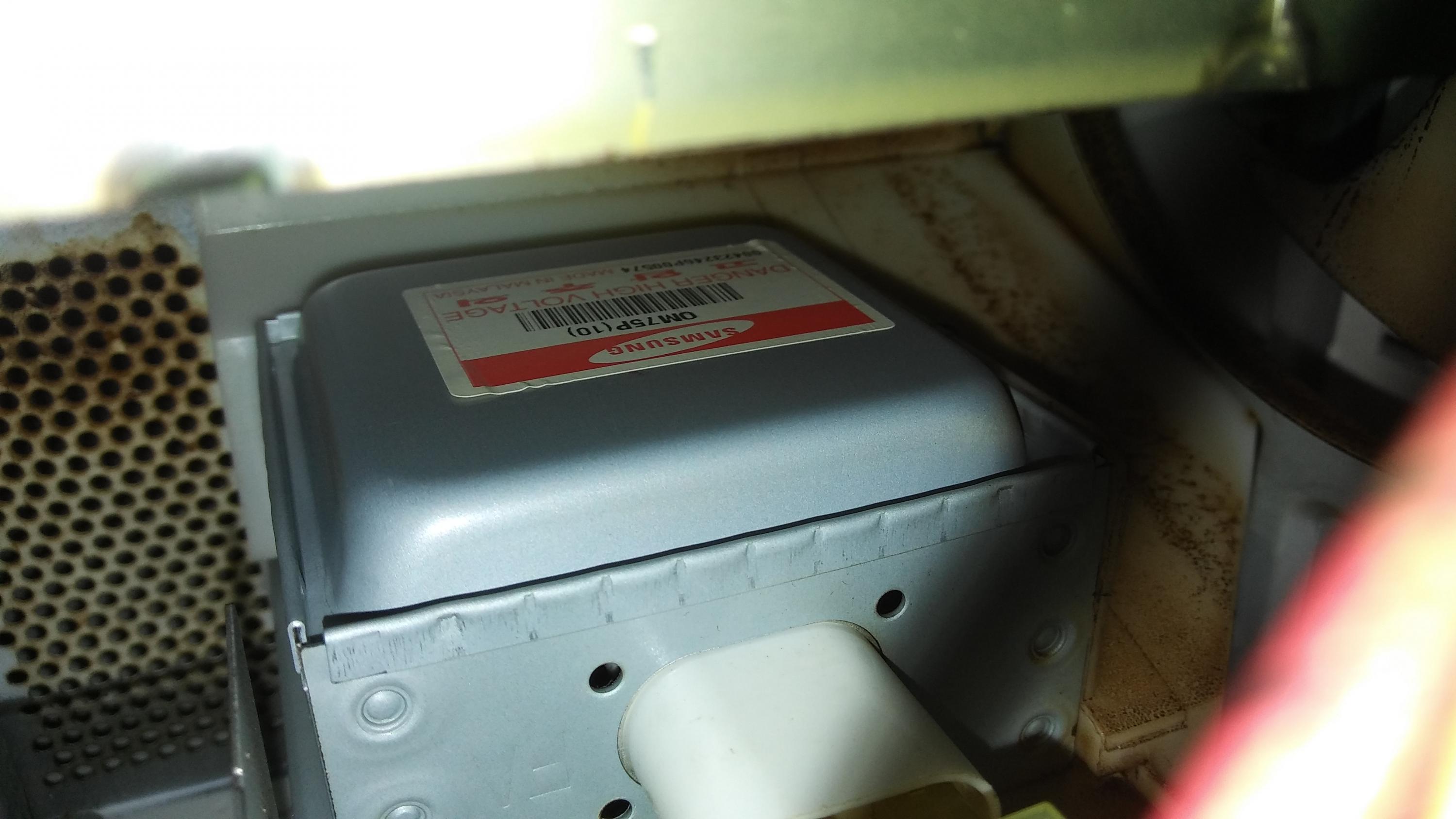

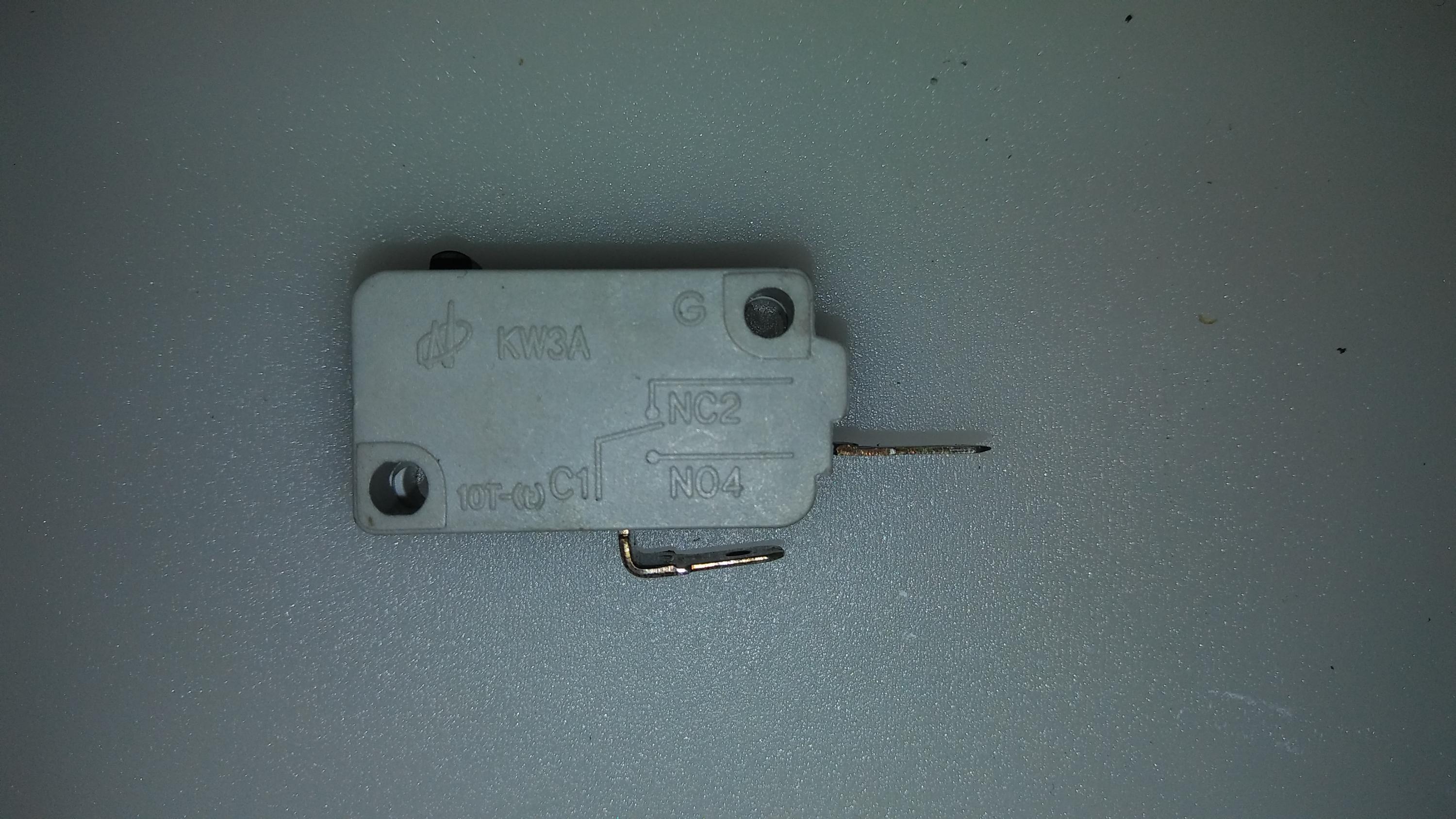

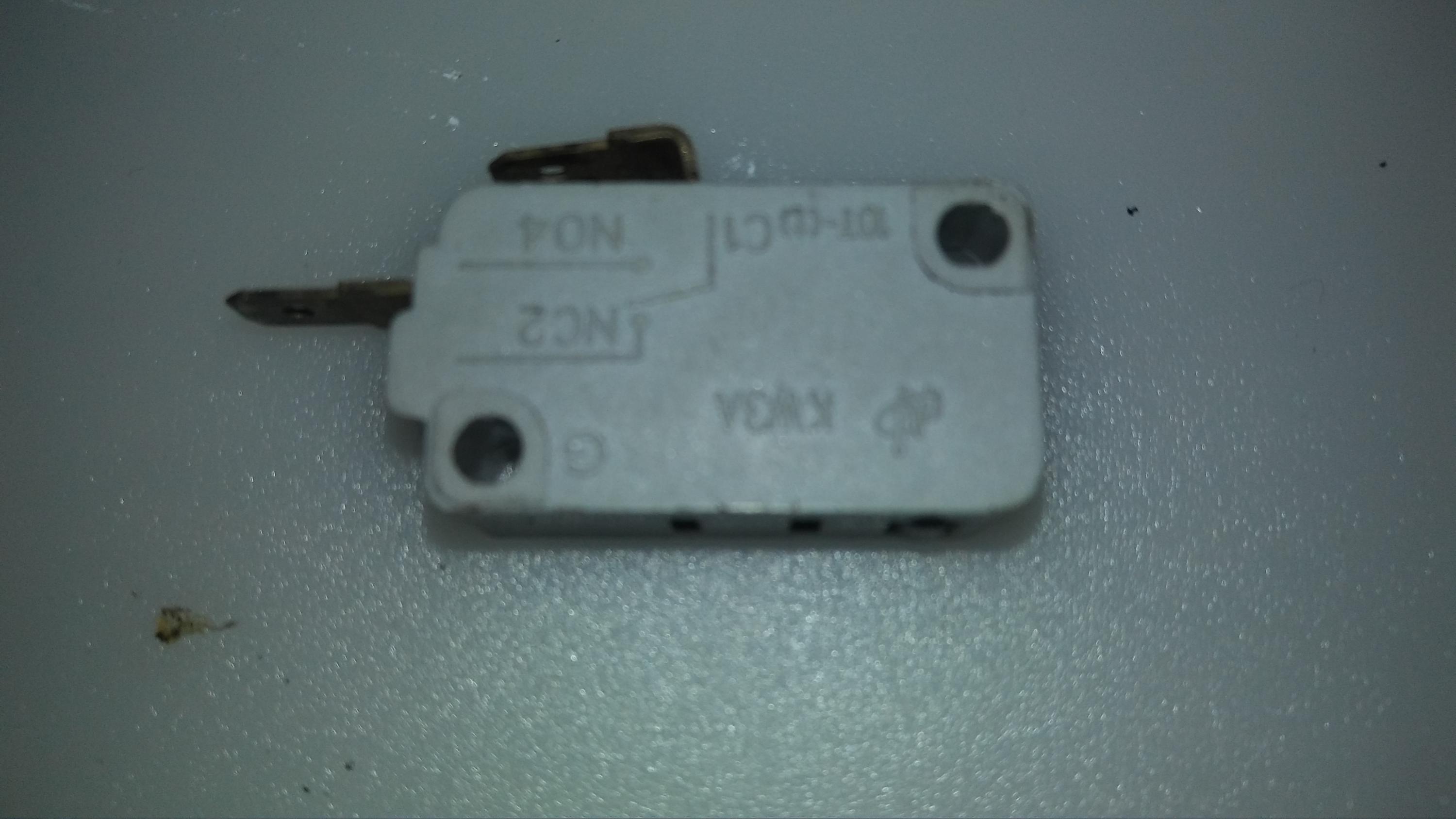

      Thank you, You're right again. Those damaged microwave's Micro Switches, I try to rebuilt are for poorman T12 iron.

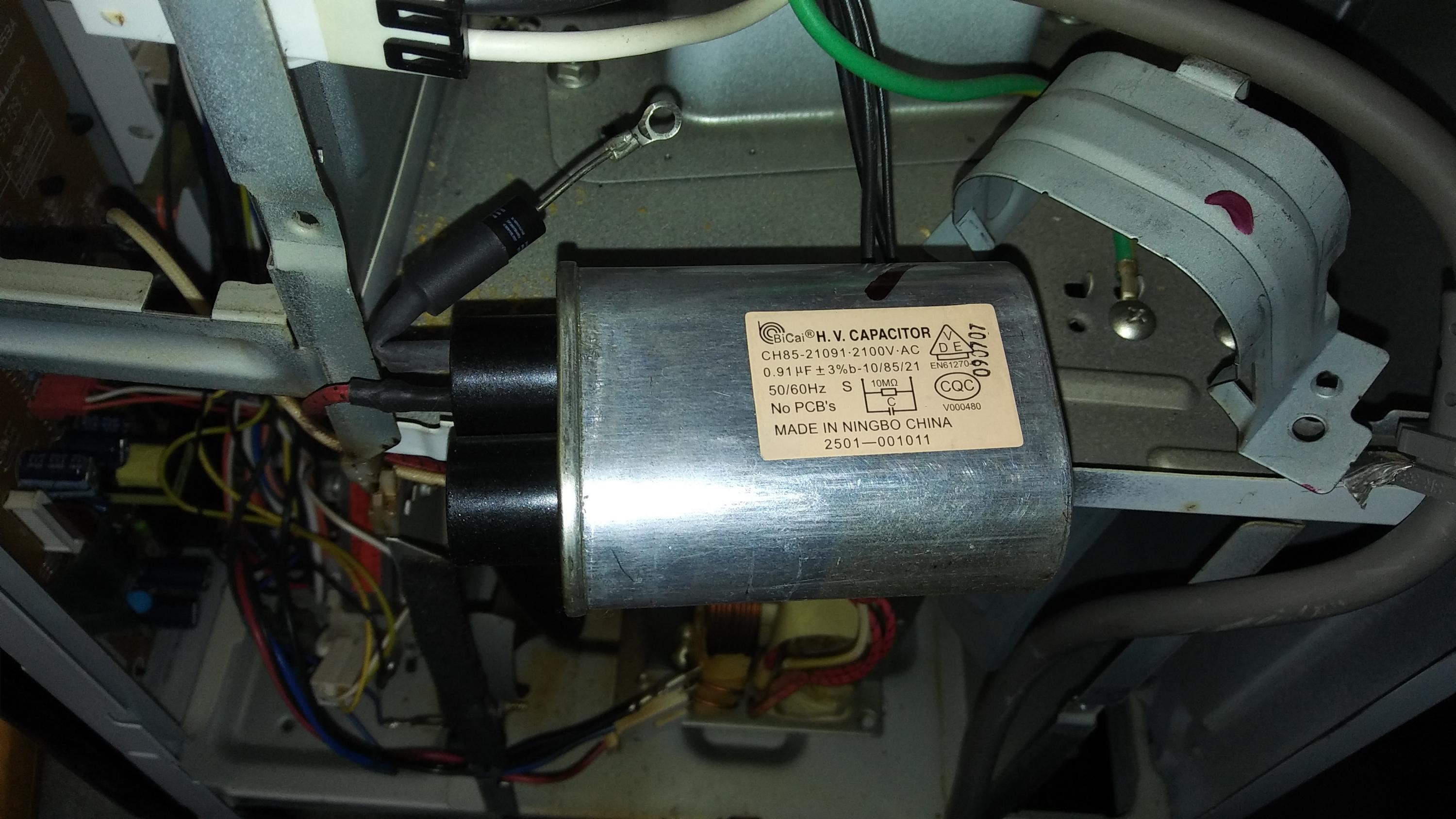

      PS: Those damaged microwave's Micro Switches are from Over-The-Range Microwave from GE, not the 0.91uf HV capacitor, not the Magnetron, not the HV diode, it is the Micro-switch, $ 80 - $180 Invoice.
