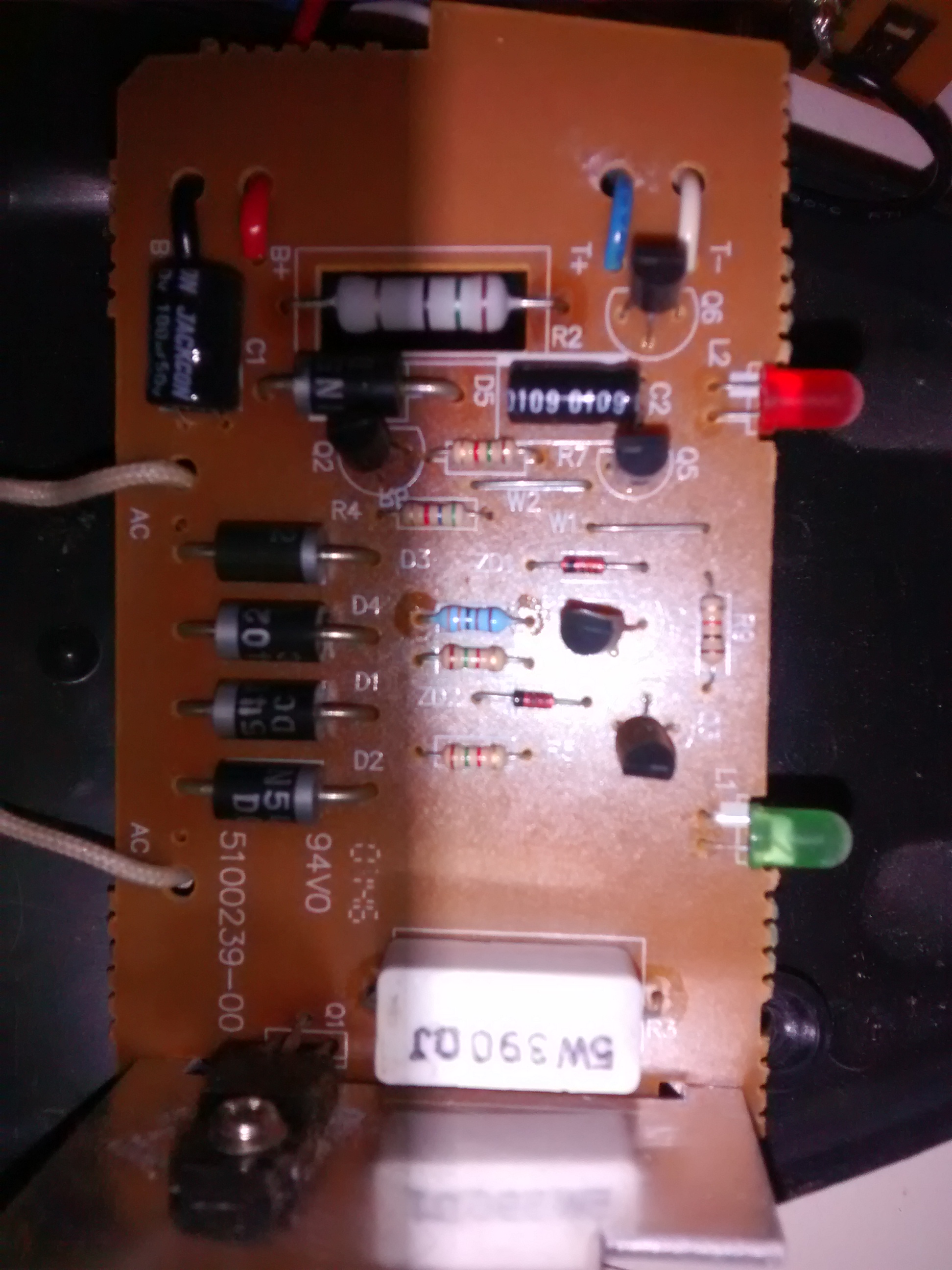

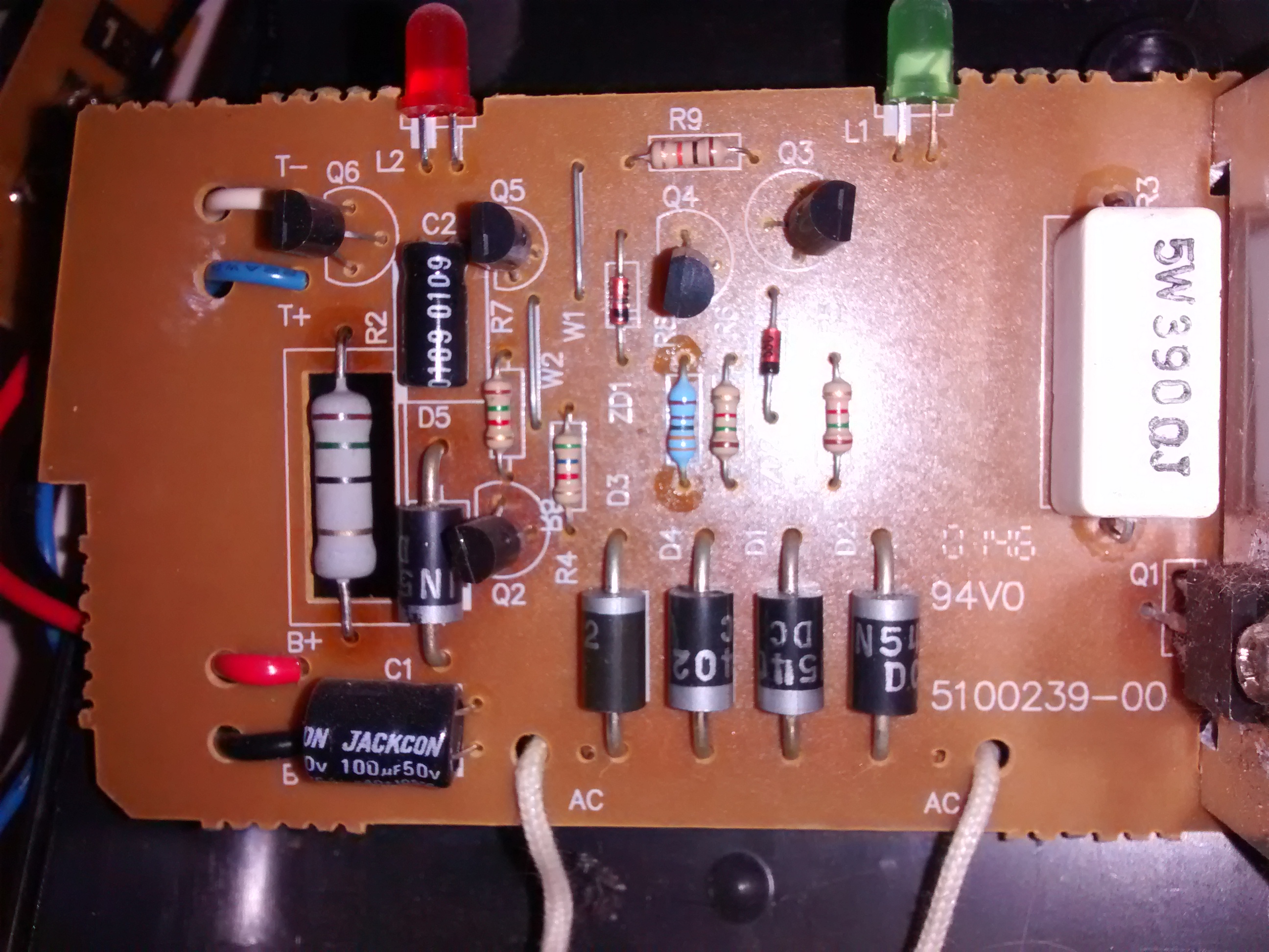

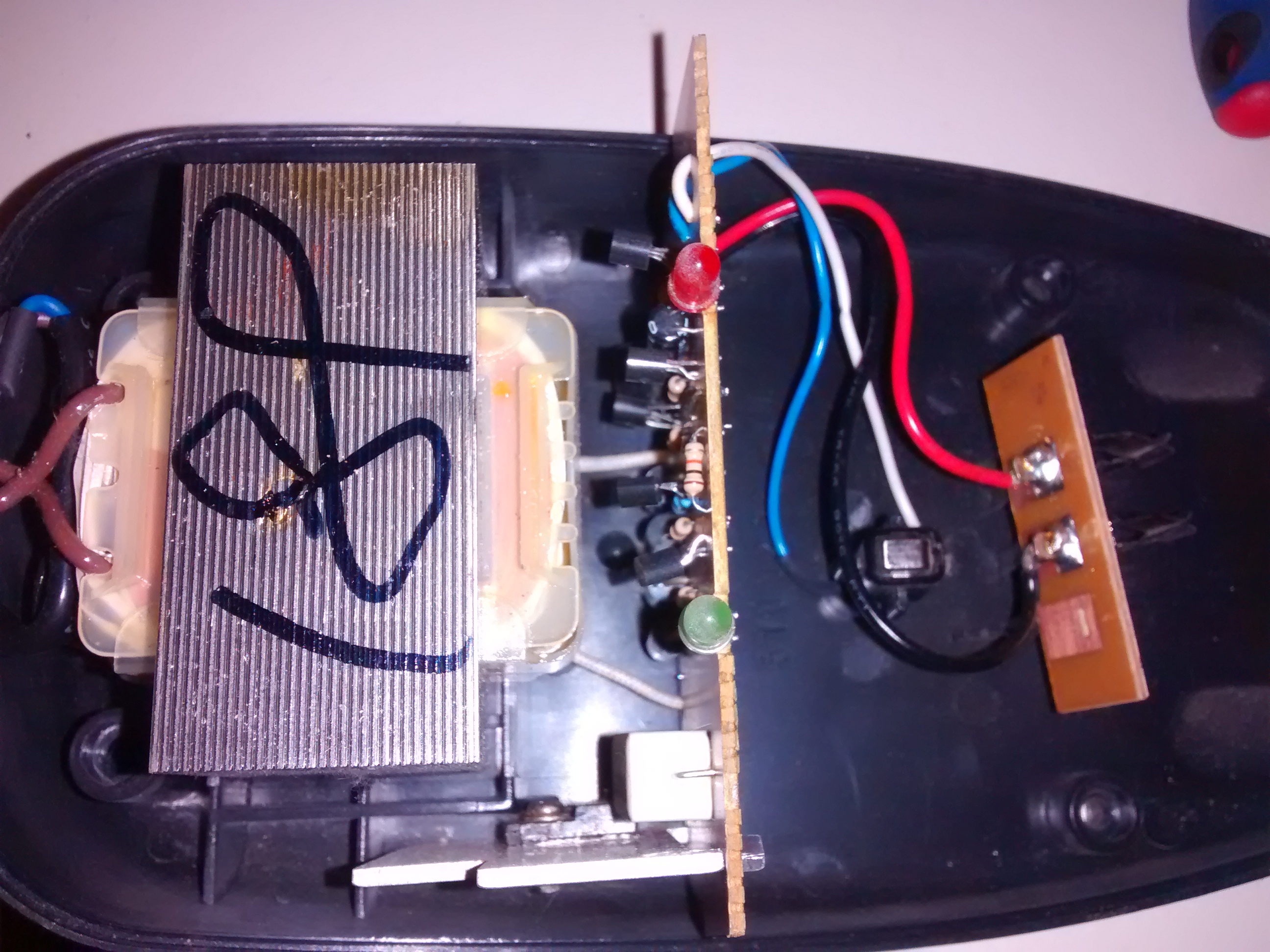

    Hi everyone.
    Just got another "faulty" device for pennies .
    This time it is a black & decker drill HP122
    After some tests I was able to pinpoint the "fault".
    Indeed the problem is that the battery charger is overheating, thus getting in protection mode and refusing to charge the battery after very short time.
    The battery worked fine for 20-30 minutes non-stop after just 20 minutes of charging from flat, which leads me to believe that it is still OK.
    Aaand back to the problem - the charger is this one https://www.partshopdirect.co.uk/bla...lights-t11441/
    5100235-04
    input 230V/240V~ 50hz 30W
    output 15V = 1A, 15VA
    red and black are the power leads for the battery
    white and blue are for the thermo sensor
    When powered without the battery it reads around 20V.
    After about 20 minutes of charging and then kept at -10C for another 10 minutes, the transformer is so hot that it cannot be touched. The radiator with the A1757 was significantly cooler.
    The D1-D5 big diodes are not shorted.
    The transistors also do not "beep" on the multimeter.
    The resistance on the high-voltage side of the transformer is 60Ohm ( measured on the end of the power cable ). On the low-voltage side - less than 1ohm ( measured on the pcb ).

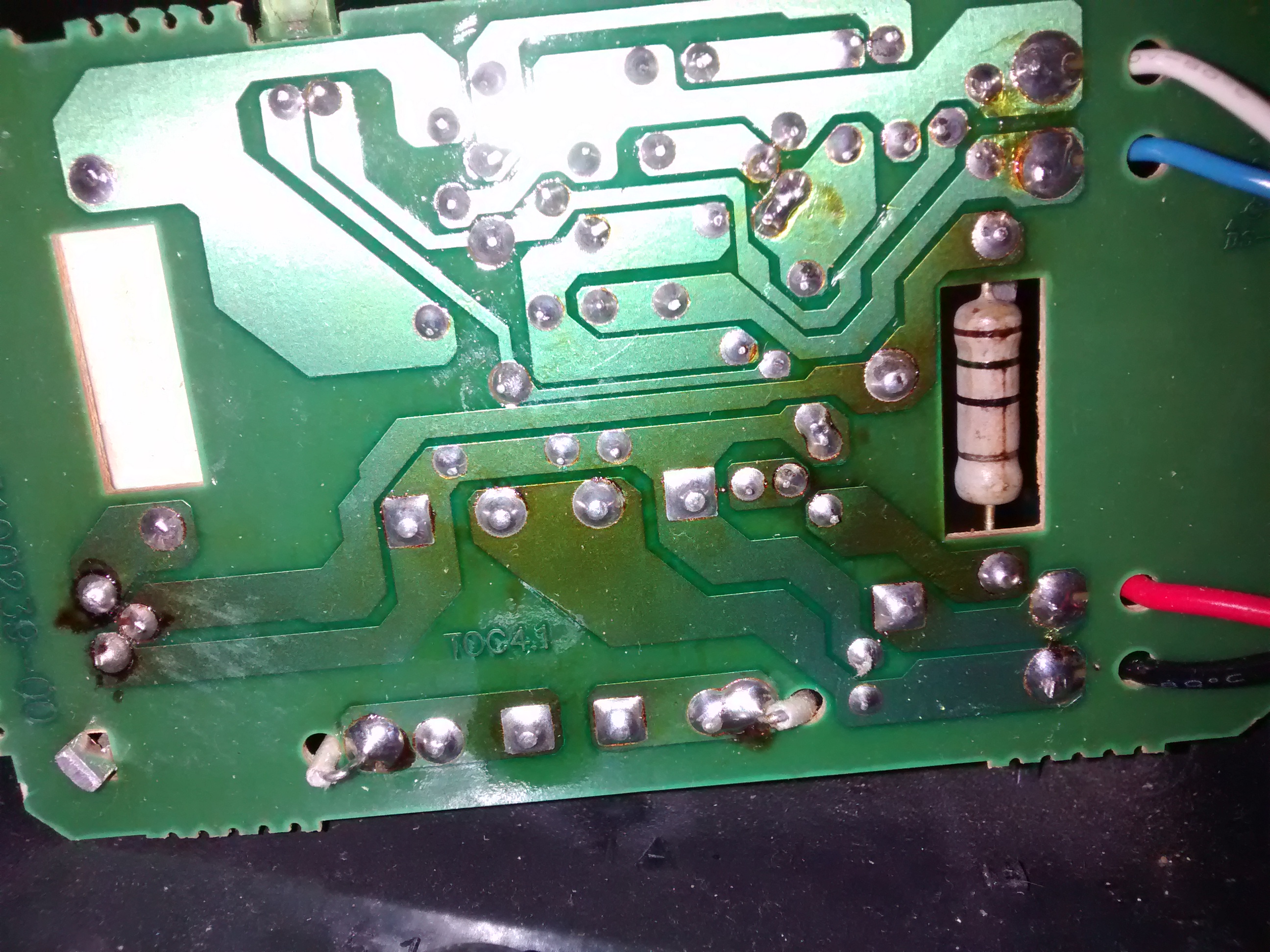

    No visual damage to the pcb or the components except for the heat discoloration on the bottom of the board.
    So any ideas what could be causing the overheating?

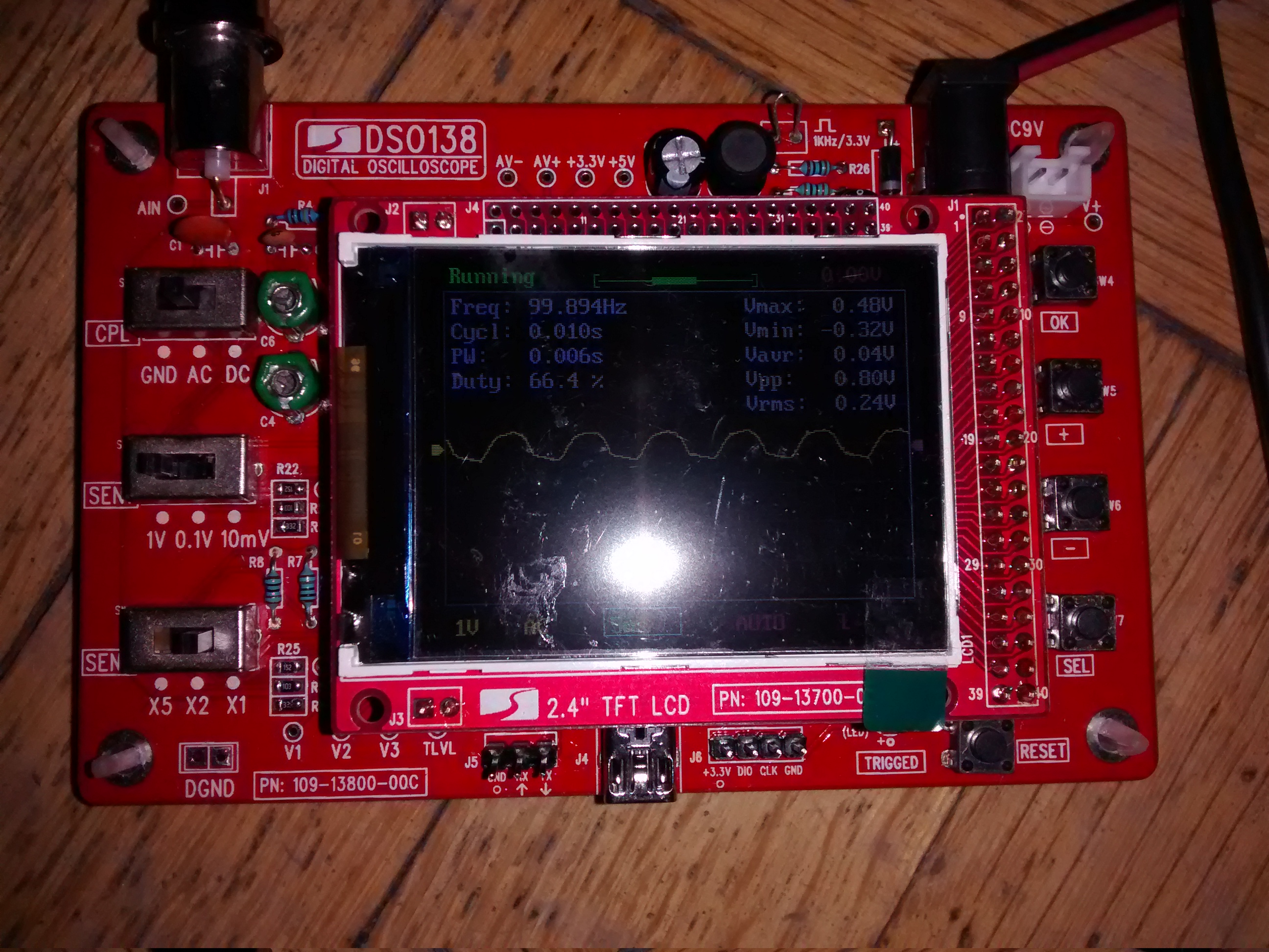

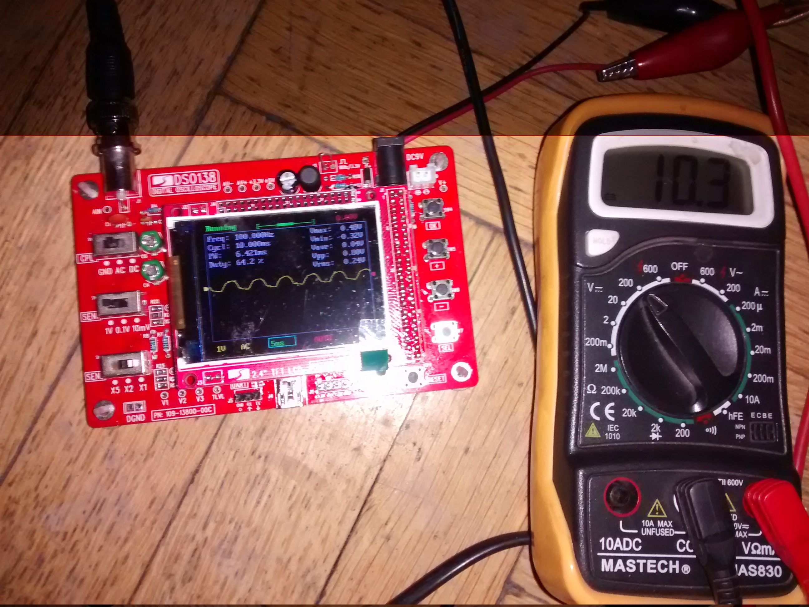

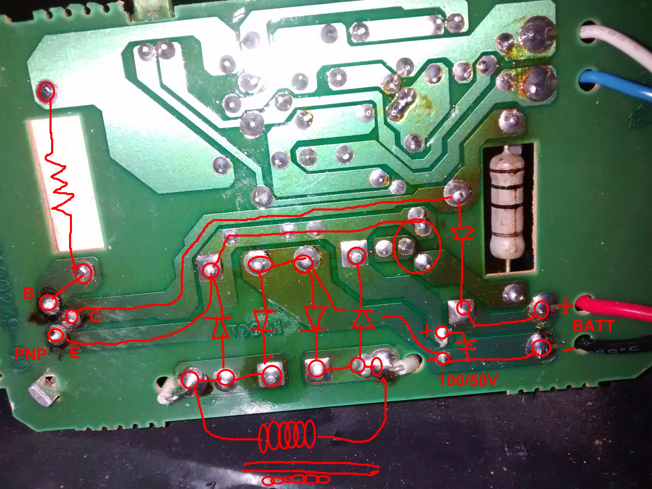

                      Just tested the charger with the battery on.
                      I'm not familiar with this kind of equipment so I do not know if this ripple is within the normal operational limits.

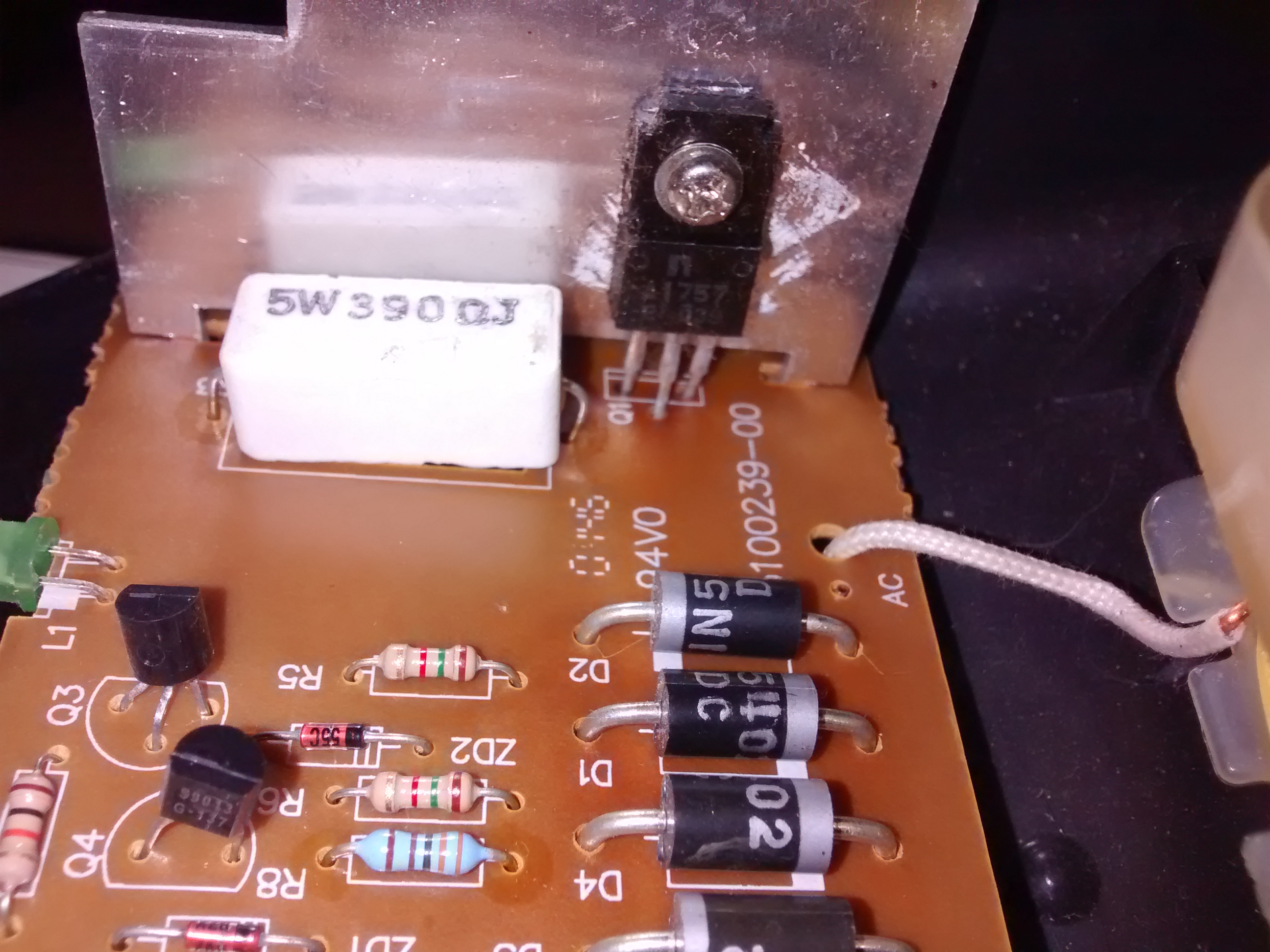

                      Also I noticed that it is not the transformer which is getting hot, but the A1757. After several minutes the transformer did not even get warm, while the radiator of the A1757 was very hot.
                        • 30979
                        Re: Overheating battery charger
                        that waveform, and frequency makes me think the output from the transformer is not being smoothed after the diodes.
                        and not all the diodes may be good either.
                        • madan1
                          • Nov 2016
                          • 682
                          • Bulgaria
                          Do not believe what this shows as freq. value. I'm not sure this cheap DIY oscilloscope calculates it properly. With different timeframe the frequency was ~50hz so I guess it lacks cpu power.
                          Anyway, the freq is N-times-power_network_freq ( 50hz ) and about 1V peak-to-peak. Is this something I should take care of or is normal for this kind of hardware?
                          Now when I'm reviewing the pcb, there only 10 elements on the power side ( the rest are for the thermal/control circuit I guess ) - 5 diodes, 2 transistors, 1 cap, 2 resistors .. so I just might replace them all .
                            • 30979
                            rectified mains would be 100Hz
                            *but* it should look like a series of humps without spaces between them.
                            which is why it may have 1 or 2 open-circuit diodes.
                            i would desolder & meter them all.
                            then do a recap - all 2 of them!
                              I would check the charging current to the batteries, as you can see that pass power Transisor provides the charging current to the batteries, more current more heat, when over temp is detected, the bias Base drive circuit for the transistor should turn off the power transistor, or when the batteries is fully charged.
                              What did you use for the scope ground?
                              The scope does show 100Hz.
                                So we have a verdict
                                I will replace the diodes and the caps. Most likely I will also replace and the A1757. Should I go all the way and replace the transistors?
                                edit:
                                I connected the oscilloscope to the battery terminals ( red and black wires )
                                I do not think the charging is interrupted due to high current. When the charger is cold it works for like 20 minutes, but after that it almost immediately goes to "green LED" mode when the battery is connected... so I guess it is related to the temperature.
                                by the way what determines/controls the output current?
                                ps. ok, got it - that transistor just switches on and off the current to the battery. I thought the circuit was smarter and constantly controlls ( increases/decreases ) the current according to the battery state, temp., etc.
