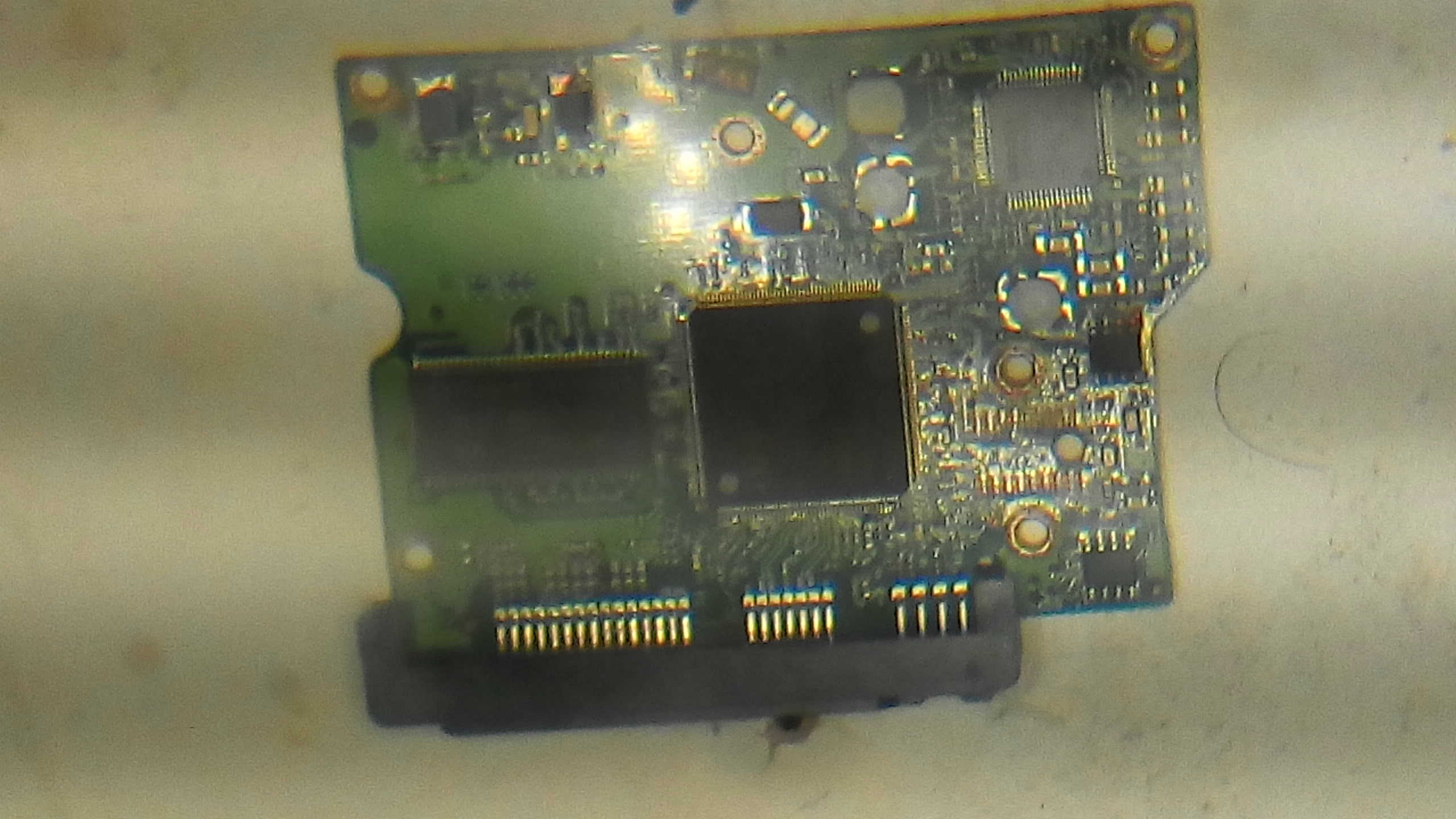

What component ?
  • eccerr0r
    Solder Sloth
    • Nov 2012
    • 8703
    Re: What component ?
    The failure of the shock sensor probably would not cause the drive to fail, or at least it shouldn't. From the fact that crystals should be pretty quiet when not struck, it should look like an open circuit (or a few Kohms). However it may be used to detect vibration of the disk and compensate for it...
    Piezoelectric crystals tend to be very reliable and I wouldn't suspect it broken unless physically destroyed.
        I can't find any electrolityc capacitors on 5V rails...so it will not be the faulty caps...
        but 2 TVS diodes are on 5V rails which was hit by 12V accidentally....
        Thanks for the link...
          You are not going to find lytics cap on these HD PCB. The TVS Diodes show 0 OHMS?
            TVS diodes are showing a value for forward and reverse test...on board..10K analog multimeter..
              [QUOTE=bianchi77;694427]Everyone,
              What component is that ?
              I see it near inductor on 320Gb HDD board from Seagate
              Is it blown capacitor or TVS diode ?
              Cheers[/QUOTE
              So I agree with eccerr0r this is shock sensor for the hard drive. It has a max rating of 10 V p-p from A to B. It has all the markings of a shock sensor and not the markings of the smc 2pin component. If this is still what you are talking about?

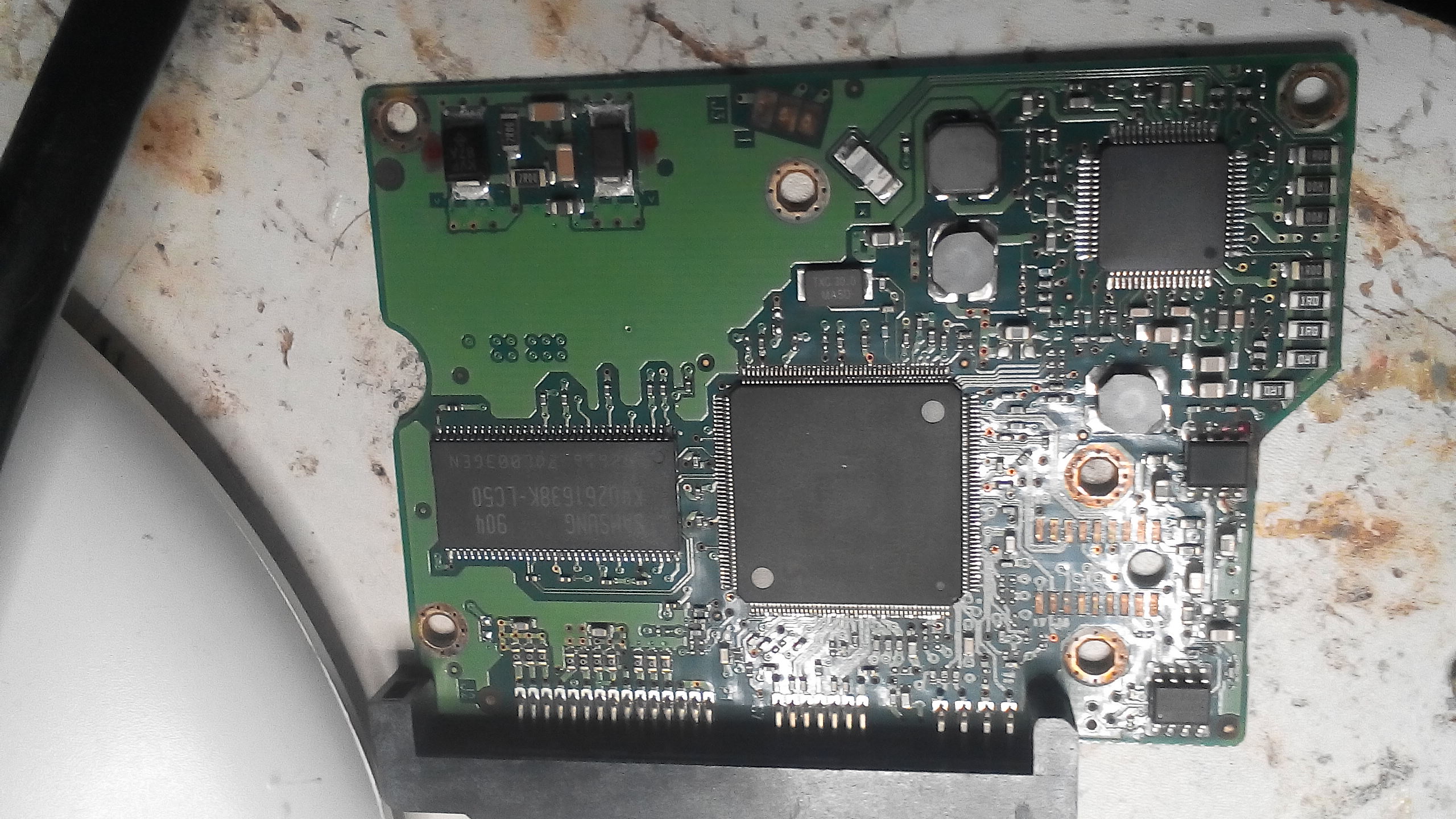

                    BTW, where is the pictures of the whole board?

                      #30
                      The whole board....not many major components on it...main CPU, RAM, motor controller...

                        #31
                        Will the CPU die, if there's a voltage spike ?
                        So it looks like the largest IC has traces that are broken on the top of the ic, there is eyelet holes that seem damaged. I can not read any numbers on the IC. It maybe the main CPU. It would also be nice to see the back of the board.

                            #33
                            Which one area are you talking about ? could you mark it ?

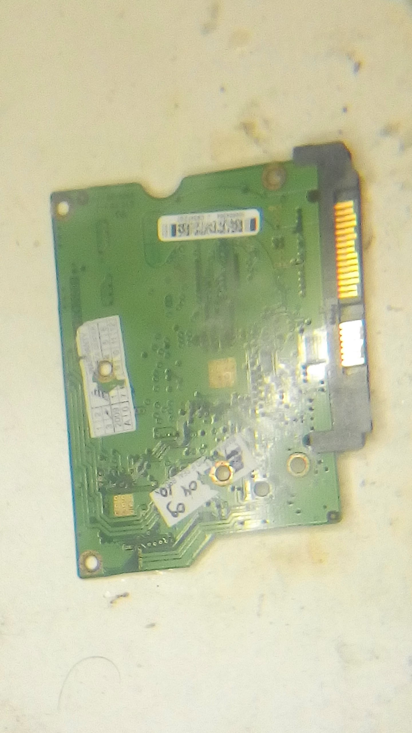

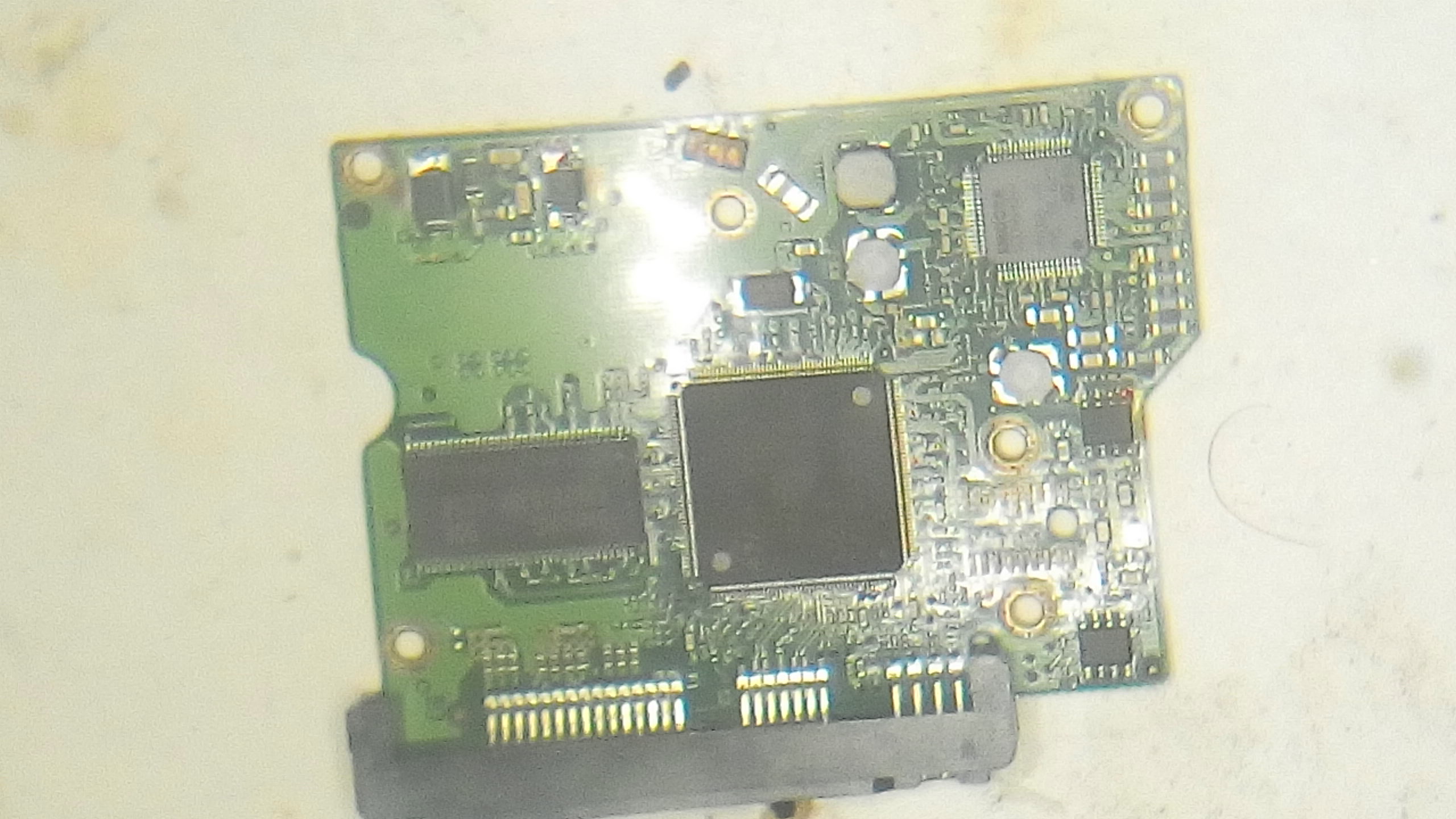

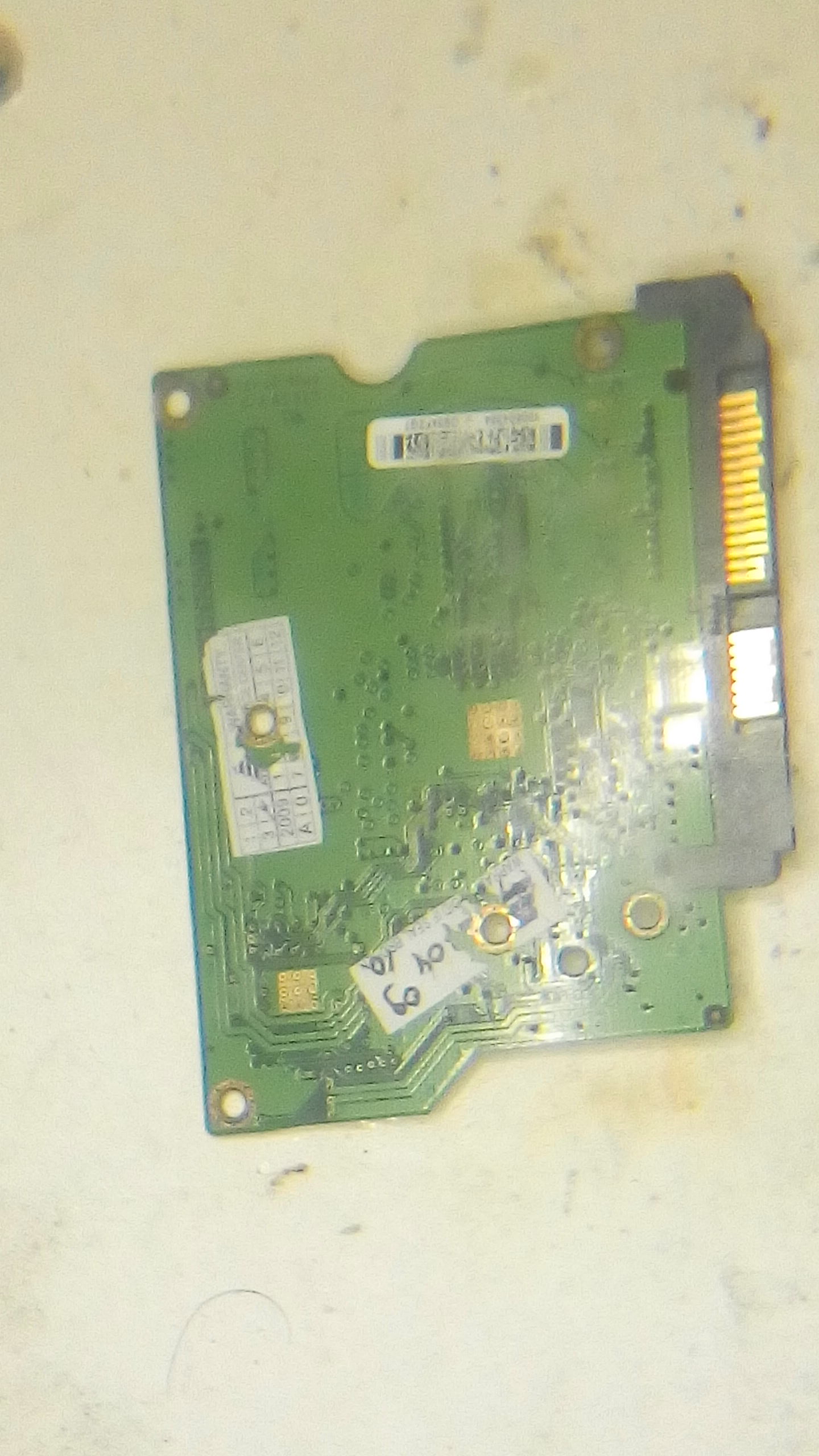

                                  Some photos :
