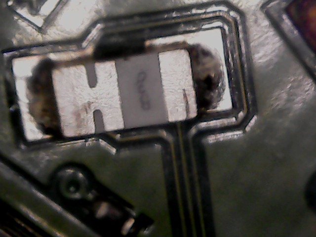

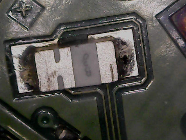

    What component ?
    Everyone,
    What component is that ?
    I see it near inductor on 320Gb HDD board from Seagate
    Is it blown capacitor or TVS diode ?
    Cheers
    • 31247
    Re: What component ?
    i suspect from the track layout etc that it's some type of resonator.
    it's not power related.
    • bianchi77
      • Jun 2016
      • 1121
      resonator on HDD...what's that for ? I can't see the name / label of the component ?? what's the type ?
      • bianchi77
        • Jun 2016
        • 1121
        some kind a crystal oscilator ??
          • 31247
          exactly, it's a timing reference probably - for one of the other chips.
          • bianchi77
            • Jun 2016
            • 1121
            so if it's broken because of voltage spike...could it be all my TVS are died and the zener as well ?....I tested in circuit with analog multimeter...all the TVS gave me a value on reverse and forward....
              • 31247
              you cant test them on the board, you wont know if it's the tvs or something else connected with it.
              • bianchi77
                • Jun 2016
                • 1121
                so I must unsolder those TVS and test it off board....similar character with diode ?
                    I tried finding datasheet for these components code :
                    ON 307 15A and FT 301 LE....looks like a diode but I'm not sure if it's transient voltage suppresor diode ??
                      • 31247
                      ON = ON-Semiconductor.
                      307 is a date code
                      15A = 15v TVS diode
                      • bianchi77
                        • Jun 2016
                        • 1121
                        and FT 301 LE ? so the code = 15A and the other one is LE ?
                        • bianchi77
                          • Jun 2016
                          • 1121
                          FT 301 LE = https://cdn.badcaps-static.com/pdfs/...a3083c9422.pdf, correct me if I'm wrong ?
                            • 31247
                            LE is a 12v tvs diode
                                How do you get the info ? thanks

                                  Thanks for the info, how do you know if it's faulty ?
                                    • 31247
                                    Turuta SMD Databook.
                                    search the forum for a torrent link.
