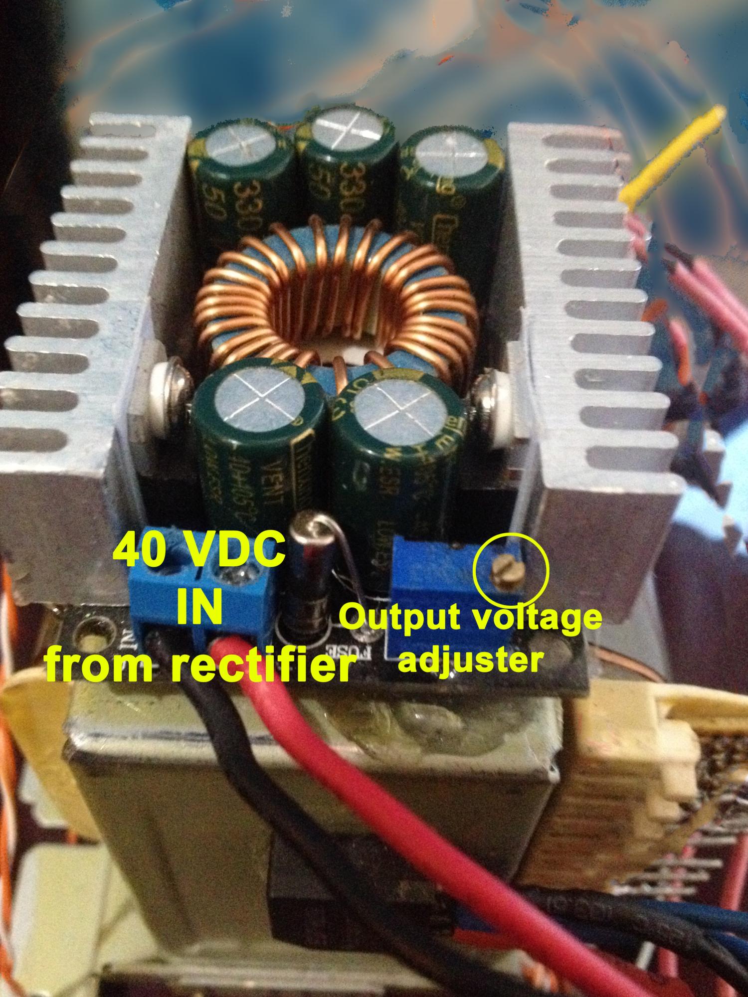

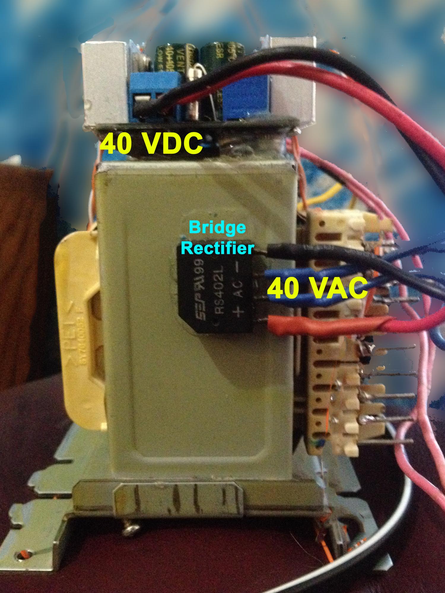

    I built a make-shift power supply that I use for a vaping box mod while I'm sitting at my desk so I don't have to worry about charging batteries etc. The way I did it was quite simple... I used a decent sized transformer (because this is a fairly high wattage application). So the voltage is stepped down to roughly 30 volts AC. From there, I feed a packaged bridge rectifier which then gives me roughly the same voltage DC. THEN, I connect the DC output of the rectifier to a gizmo that I bought from Amazon for $12 (rated at 15 amps at 24 volts DC), that allows me to step down DC anywhere from like 2 volts to something like 95% of the input voltage. So I step the voltage down to 6 Volts DC and feed that to my Vape mod.
    Question:
    When I put my Fluke in line with the 6 volts and check the current as I'm using the vape, I read 12.2 amps, which is 73.2 watts.
    THEN, I read the current on the AC side from the wall to the transformer (which is of course 120 volts AC) and the amperage being drawn from the wall is 1.8 amps while i'm running the vape, which comes out to 216 watts (yes, I did make sure the Fluke was dialed on AC not DC ).
    216 - 73.2 = 142.8 watts MISSING...
    ...to me, this means that I'm losing 142.8 watts in the transformer, the rectifier and the voltage step down device, but this is more than double the wattage that I need for the vape ... is it possible that these components are really that inefficient? Or is my math wrong somewhere?
    It's been many years since I took electronics, and I'm trying to understand what I'm seeing, so hopefully someone much more in the know than I am can help me make sense of this.

    OK, so do you have filter cap at the output of the bridge? Cap for 15A load will be large and it depends on what the acceptable AC ripple is.
    30AC feeding the bridge will have DCV output of about 40VDC, it sounds to me you do not have filter cap at the output of the bridge .
    Check the AC current feeding the bridge to see what you have.

            OK ... WOW ... I wasn't expecting this kind of interest ... I was really just trying to see if it was logical to get the results I was getting ... something like "yes, that makes sense" or "no, something isn't quite right" etc...
            As far as filter caps on the output, I'd have to say yes and no ... the "gizmo" that ultimately supplies the power to my vape is this:
            DROK® DC Car Power Supply Voltage Regulator Buck Converter 8A/100W
            And as soon as my iphone is charged up enough to power on, im going to take some pics and post them.
            On the output cap ... im powering a vape mod ... this make-shift power supply is literally connected to each end of two metal coils connected in parallel for a total of 1/2 an ohm. When I hit the button, 6 volts at 12 amps flows through the coils and makes them very hot which vaporizes my e-jiuce which I then inhale... lol ... thats all im doing... worrying about clean DC power in this application almost seems silly... right? Unless that capacitor would affect my readings?

              That SMPS needs good clean DC input for it to run properly, the small caps (2) on the input side is not going to be good enough when lots of current is drawn by the load. Right now the you are probably feeding the circuit with high ripple Voltage (with 120Hz frequency) due to not enough filter caps after the bridge which can easily destroy the board.
              What are the value and the Voltage rating of those caps on that SMPS board?

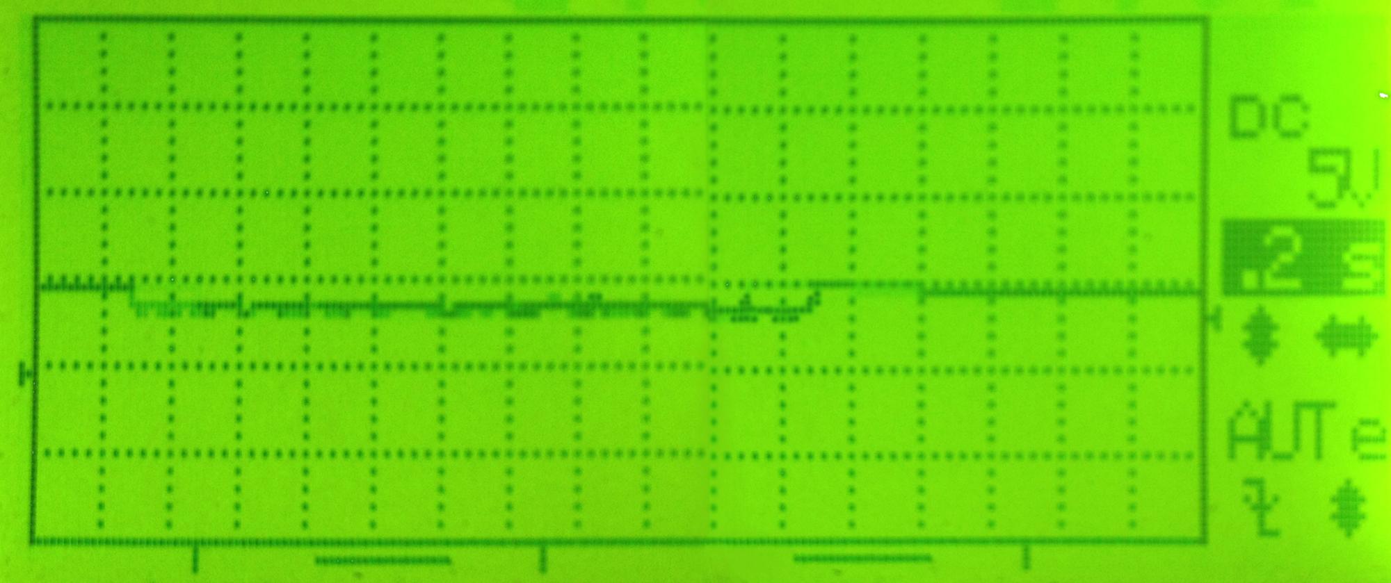

                            I just bought a little oscilloscope kit that I assembled the other day ... I'll take a look.

                            All 5 of the green caps are 330 micro farads at 50 volts.

                              Here is the scope image of the 6 volts coming off the power supply (had to paste two images together) ... the flat line is idle, and the little ripple you see is me taking a hit off of my vape mod. It looks fairly clean to me... but I admit being ignorant on how much ripple is acceptable and how much is not...
                              I could not get a read on the DC input as it is around 30 volts and this OScope wont go that high.

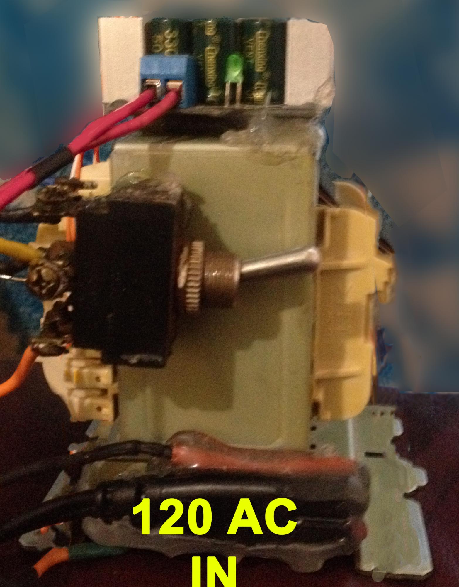

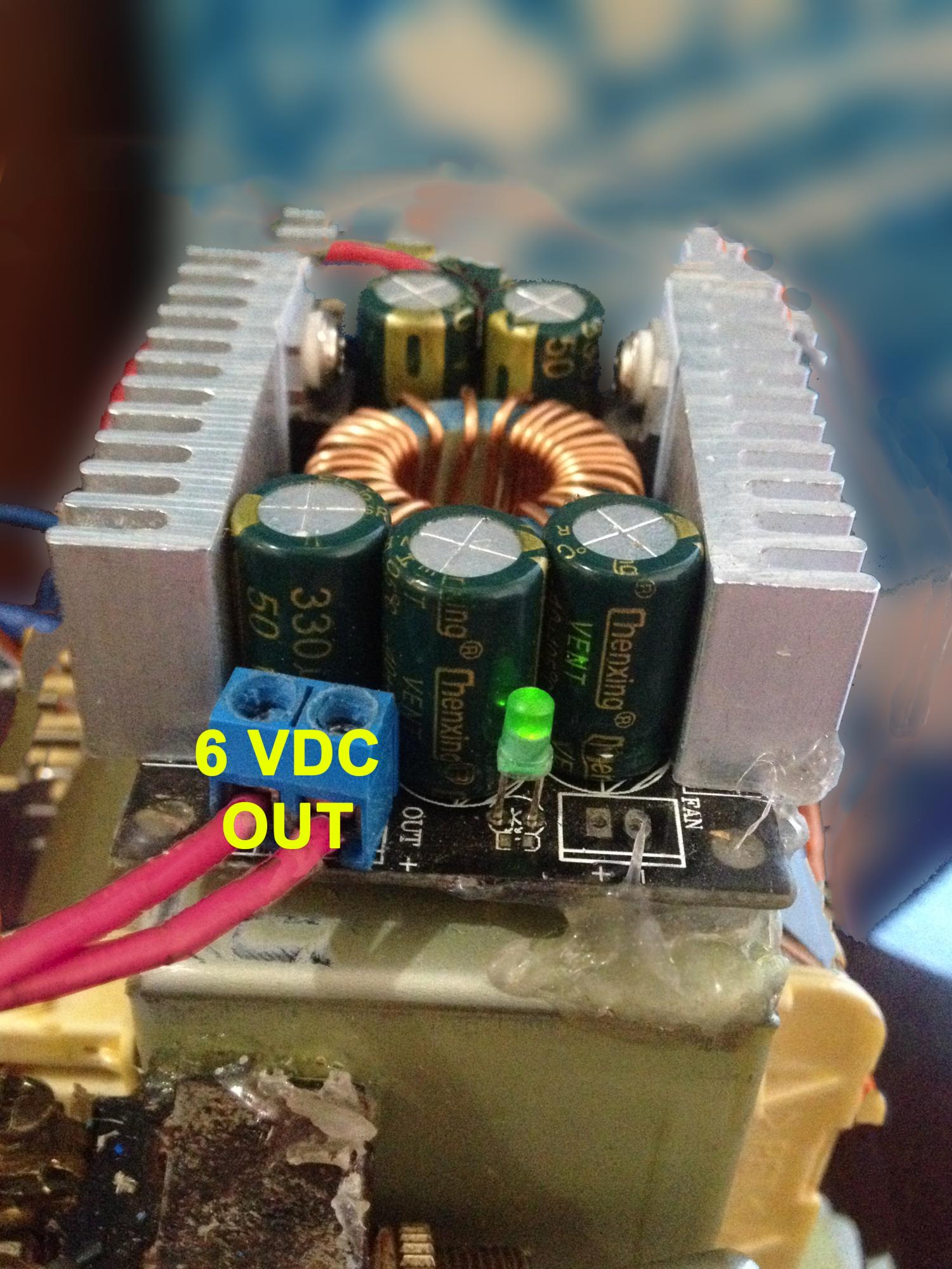

                                Here are images of the setup as requested...

                                  Transformer outputs AC voltage.
                                  The bridge rectifier converts AC voltage to DC voltage but without some capacitance, what you get is basically a series of pulses, all above 0v.
                                  The peak DC voltage that comes out of the rectifier is equal to 1.414 x Vac - 2 x Vdiode where Vac is the AC voltage and Vdiode is the voltage drop on one diode in the bridge rectifier (typically between 0.7v and 1.1v, according to the datasheet of your bridge rectifier it's 1.1v )
                                  Vdc peak = 1.414 x 40 - 2 x 1.1v = 54.2v ~
                                  So you won't get 40v DC out of the bridge rectifier, but rather a DC voltage with a peak of about 55 volts. Also, keep in mind that transformers when idle typically can output up to 10% more AC voltage, only under load their output goes down to the rated AC voltage.
                                  This is very important, because as you can see on that DC-DC converter board, at the input you have two capacitors rated only for 50v, which means if what you say it's true, eventually those capacitors will vent or blow up or go bad, because you're exceeding their maximum voltage rating by about 5v. At the very least, you would have to replace these with 63v rated capacitors.
                                  Now of course, 120 times a second you'll have pulses of DC voltage going all the way up to around 55v and then slowly going down. Depending on how much capacitance you put after the bridge rectifier, you raise the minimum DC voltage so that it will always stay above some threshold.

                                  btw. Your transformer is rated in VA and has an AC voltage at the output. So if your transformer says it's 40v AC and 25VA, that means the maximum AC current at the output is about 25 / 40 = 0.62A
                                  When this AC voltage is rectified using a classic bridge rectifier, the maximum DC current is not the same but rather smaller, and can be approximated using the formula I dc = ~ 0.62 x Iac , so for my numbers the peak AC current could be only 0.62 x 0.625 = 0.387A
                                  So going back to my examples above, you may very think you could use 1A or 0.8A in your calculations, but if the transformer can only provide ~ 0.39A then you're screwed, you'd have to raise the minimum voltage by using more capacitance.
                                  The 0.62 is a "magic constant" which works well for transformers in the 40-100va range, but is often a bit off for very small or much larger transformers.
                                  so first of all .. if your transformer really outputs 40v ac, then really really really those 50v rated capacitors at the input of your dc-dc converter should be changed to some rated for at least 63v.
                                  Alternatively, if your transformer has two secondary windings, you could connect those secondary windings in parallel for half the voltage but twice the current.

                                    You need to look at the output of the bridge Rectifier with full load, scope set to AC coupling.
                                    When you want to see AC RIPPLE riding on DC level, you set the scope to AC coupling.
