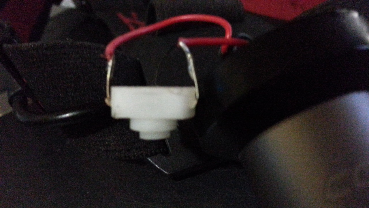

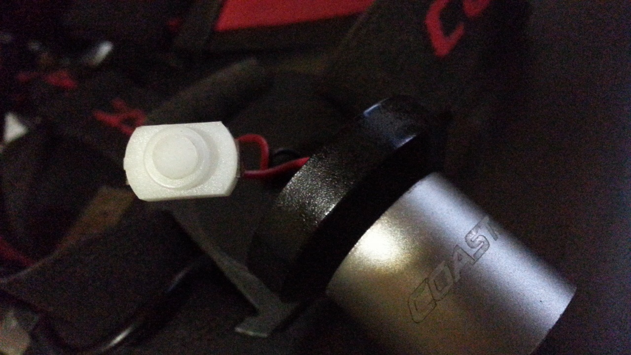

    I also have a switch I need. This has been my most handy light for a couple years. It measures around 7mm H x 8mm W x 11-12mm L and pics for looks.
    Stopped clicking on me.
    Please help. Thanks.
