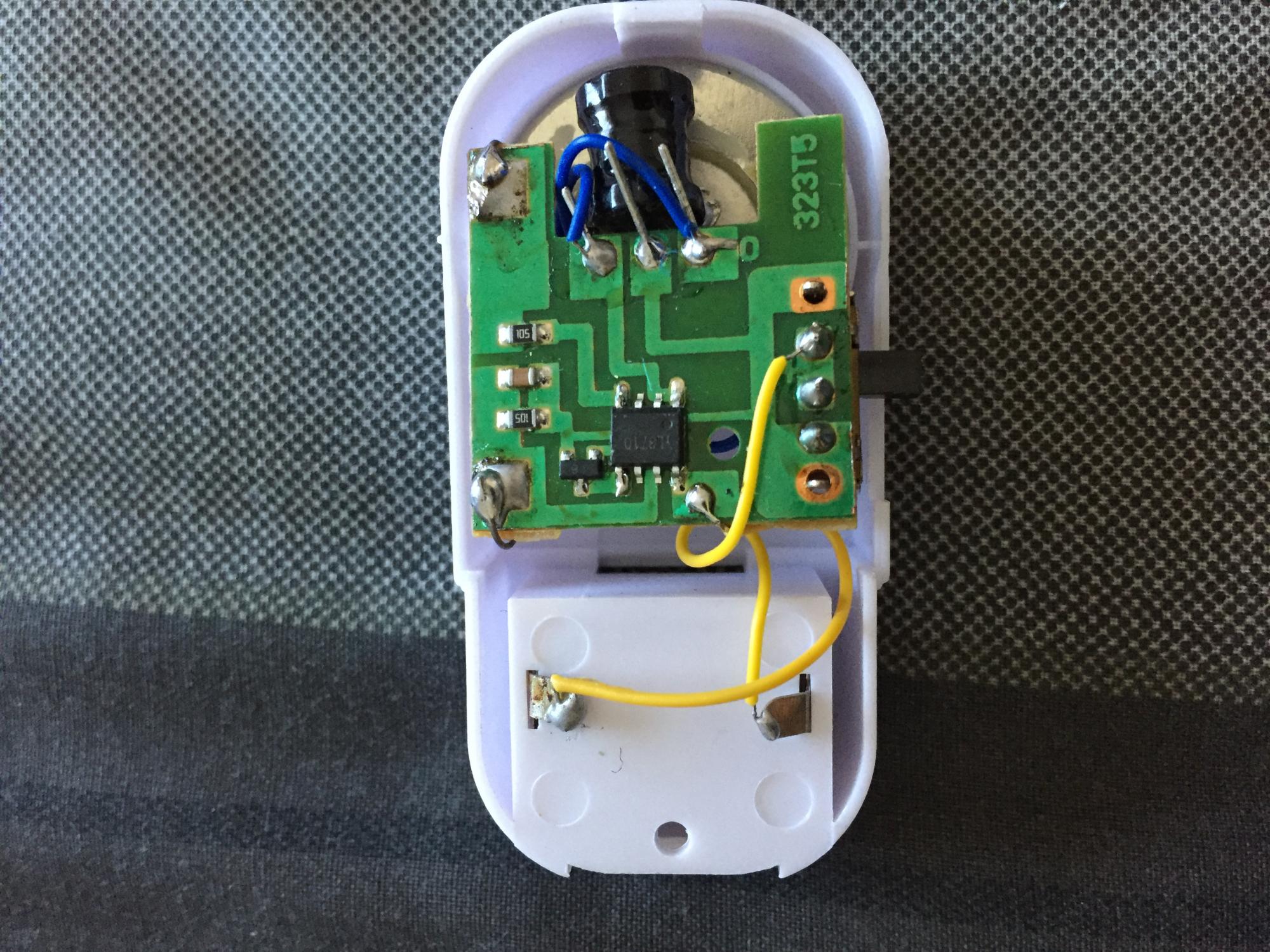

    Hi guys this alarm uses a reed switch to turn on a siren when a door or window is opened.
    I'm wondering how I could tweak it so even after the magnet lines back up (door / window closed) the alarm keeps sounding for a certain amount of time around 5-10 seconds.
    Here's the circuit I couldn't find anything on the ic used

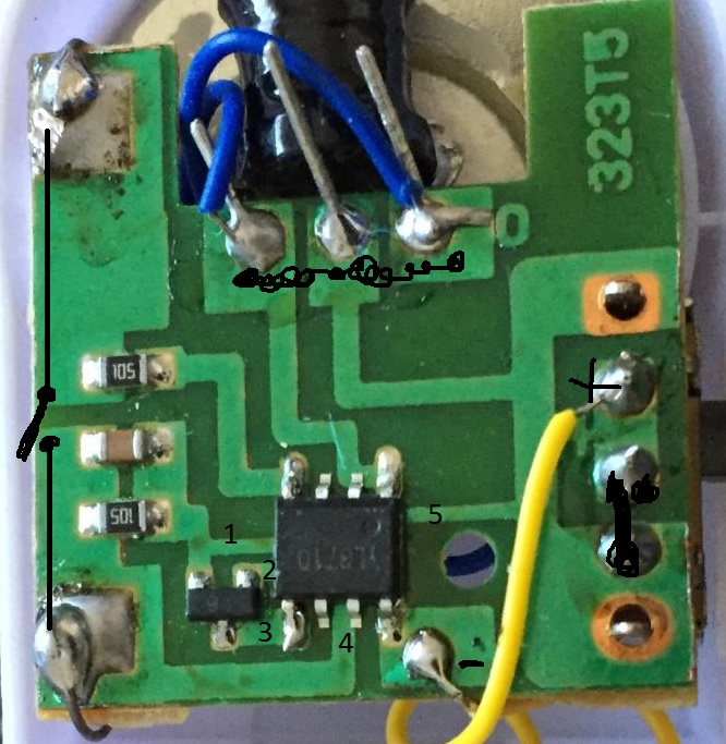

              Re: Dollar store window / door alarm - Hacking question
              sorry my bad.
              whats the number on the 8 pin chip.
              Also can you tell me what 1 2 4 5 in attachment are connected to.
                1 and 2 connect to one end of the power on toggle switch which the + of battery connects
                4 goes to one end of the reed switch (which is normally closed operation)
                5 seems to go to the other end of the power toggle switch
                Number on the 8 pin ic is YL3710
                  Pin 5 of the IC looks to be the Trigger pin. Check the DCV at pin 5 of the IC with ref to pin 8 of the IC to see if it goes HIGH when the alarm is triggered and LOW when alarm is not ON, or another way around.
                  That IC boosts the Battery Voltage to higher level for driving the Piezoelectric transducer.
                  https://www.badcaps.net/forum/attach...2&d=1473604683

                    + probe on pin 5 and - probe on pin 8 reads 0v when not triggered. Move magnet to trigger alarm the voltage jumps only to .70v
                    Probing + on pin 8 and - to ground/negative of battery reads battery voltage 4.8v when not triggered. When magnet moved and triggered on voltage slowly drops off pin 8
                      'Probing + on pin 8 and - to ground/negative of battery reads battery voltage 4.8v when not triggered. When magnet moved and triggered on voltage slowly drops off pin 8' Tahat does not make sense since in the picture is marked pin 8 with (-) the yellow wire is soldered to, so that (-) marked is NOT the negative of the batteries? Unless the picture from post 7 is marked wrong.
                      • caphair
                        • Nov 2011
                        • 1249
                        Oh oops that picture confused me I used the 5 mark as meaning it was the 5 pin of ic.
                        Ok so remeasuring: pin 5 goes high when alarm triggered. Low when not
                          So the pin 5 of the IC which is connected to the middle pin of the Transistor it goes high when the alarm is triggered, how high?
                          • caphair
                            • Nov 2011
                            • 1249
                            Went high to battery voltage 4.8v

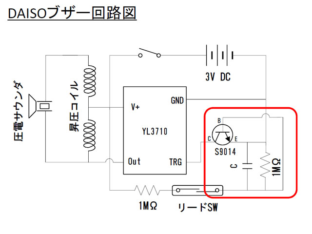

                                NECRO ALERT!
                                There are two 1M resistors, one has a capacitor connected in parallel. Call the one in parallel with capacitor R1 and the other one R2.
                                The two options are:
                                1. Increase R2 to a higher resistance.
                                2. Add a resistor in parallel to R2.
                                Adding a resistor in parallel to R2 is easier but will reduce battery life. A resistor lower than 470K resistor will probably make the alarm never shut off.
                                Likewise increasing R1 past about 4.7M ohms and the alarm will never shut off.
                                Personally though I'd like hacking things like this, but this I'd not hack to do what you want to do, very dicey to get it to behave the way you want it to behave. I'd start over from scratch and make the whole thing anew.

                                    You can do that too, but you need to make sure you use very low leakage capacitors. The main reason for not suggesting it is because I don't know what's the current capacitance.
                                      YL3710 Schematic.
                                      • eccerr0r
                                        Solder Sloth
                                        • Nov 2012
                                        • 8703
                                        Actually I think you may need to put in a bigger capacitor there after all. I've never bought one of those units so I don't know what is behavior is like, but likely it's close to instant on/off implying that capacitor to being in the single digit nanofarads or lower. Adding several hundred nF to 1 uF of capacitance will keep the alarm on longer and would also take longer to shut off, of which you would decrease the resistance of R2 to speed up shutoff (and increase power consumption.)
                                        Again a low leakage capacitor is mandatory, most electrolytics will fail.
