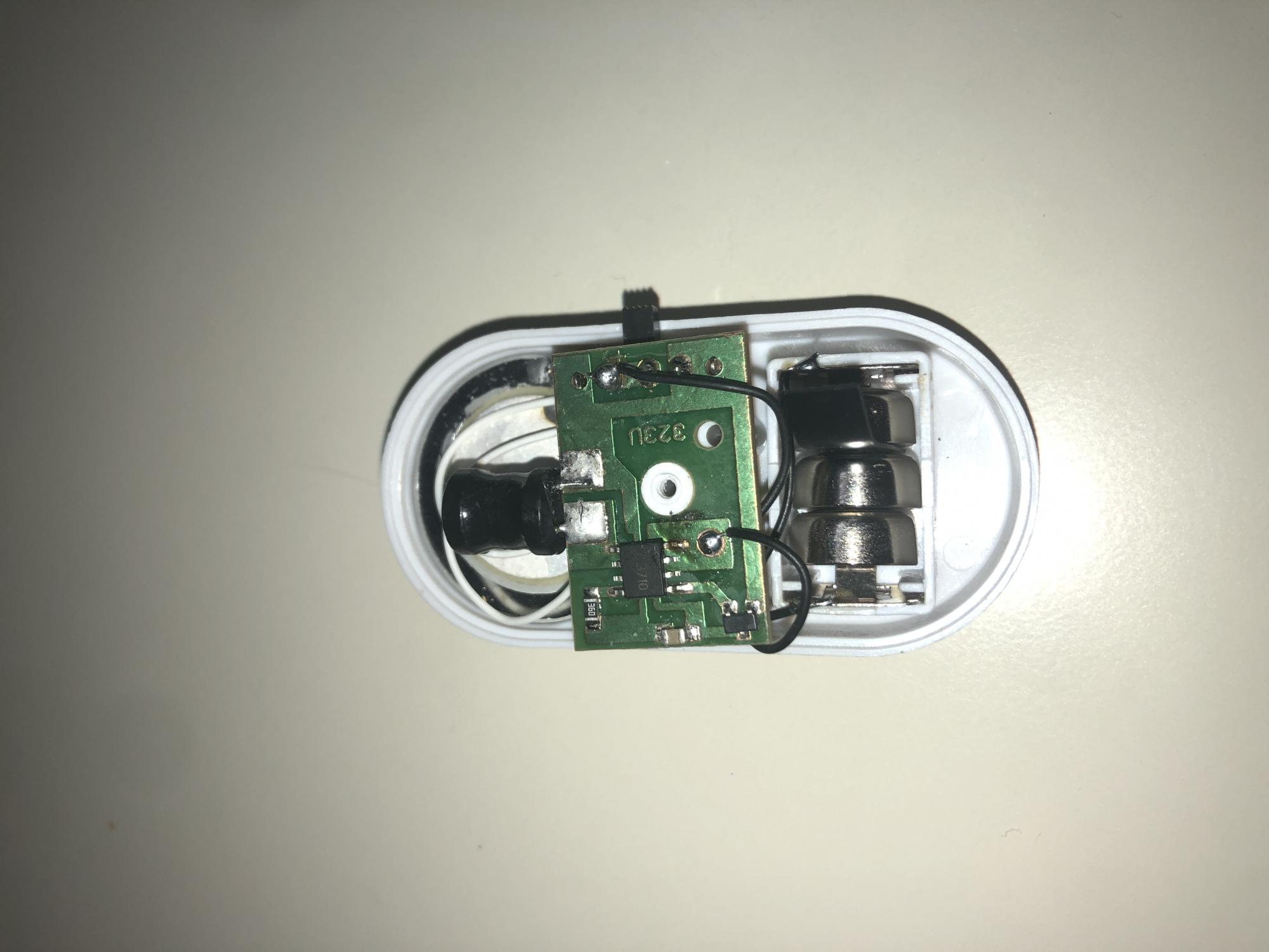

          Back from the dead. ��
          I picked up one of these alarms today and immediately took it apart. Looks like they’ve changed the circuit. They no longer use a reed switch and have replaced it with a HM6207 Hall Sensor in the bottom right corner. Only component on the backside of the board is the power switch.

            Cool. Could these be more easily altered to keep beeping after the door closes?

              Doesn't appear so, but if you want to add more components like a 555 or a 4049/4069 and suffer more power loss either version could be modded...

                Note that the circuit is a redesign of the input to incorporate a delay when the magnet is brought back to the switch.
                Btw the input redesign needs to be ... redesigned ... for the hall effect version, though it shouldn't be way too different. The circuit is for the reed switch version. Not having detailed data spec sheet of the YL3710 makes a bit difficult to predict behavior, alas keeping the same type of circuitry helps...
                Another possible redesign to incorporate a delay is to completely do away with the transistor and put a capacitor across the reed switch, and reference the reed switch to GND. Again without detailed spec sheets the behavior is very unpredictable... I suspect they put the transistor there the begin with to deal with noise but ... as said, the spec sheet of the YL3710 lacks the information needed ...
