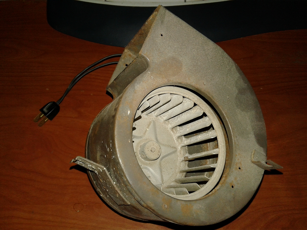

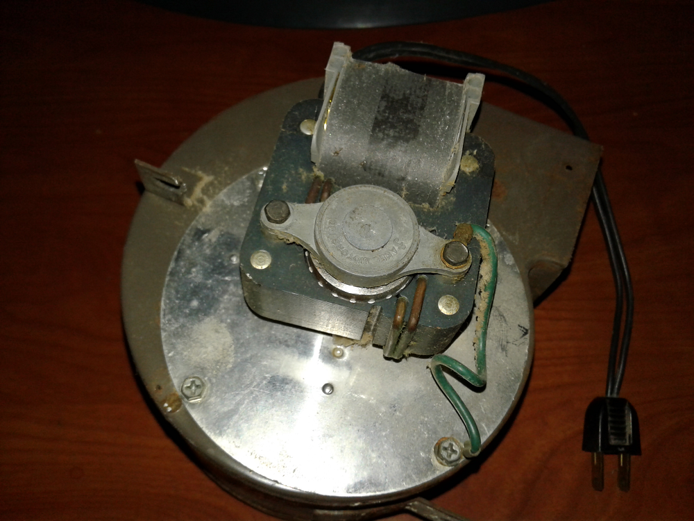

    I want to "go" on a project that has been rolling around in my head for years. I did 4 years in the Marines and have basic electronics knowledge and radio fundamentals. Have not touched my electronics training since I left almost 20 years ago.

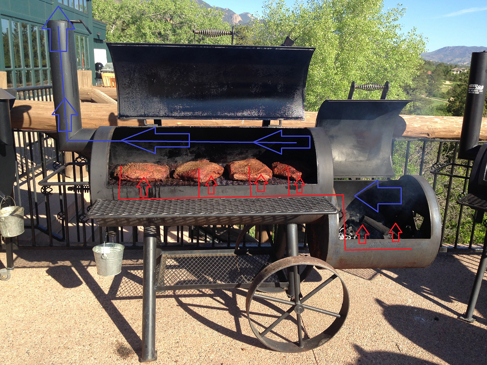

    The idea is a temperature regulated and controlled wood smoke barbeque. The basic design is what's called a "Texas Two-Stage" where you have one metal container for the burning wood and a second metal container affixed next to it for the meat. The smoke "flows" from the side where the firebox is through and across the meat and then vents out on the other side.
    It's all about the brisquet.
    In Texas, we do an apron steak, aka a "brisquet" which is a huge, 20 lb. slab of fatty and collagen-laced meat. The collagen makes the meat very, very tough to the point that it's inedible. To cook it you need to keep the meat at 225 deg. F. for about 10 hours. Some say 12. Personal preference comes into play here, but the primary reason for the extended cooking time is that it takes that long and that low of a temperature to break-down that collagen into fat, and so at the end of the cooking process you have a very tender slab of meat that is very moist due in part to the collagen breaking down into fat. (It's also very fatty to start with.)
    The best way to do brisket is with wood, either oak, or mesquite or a combination of both. You can use any sweetwood like hickory, but in texas it's either oak or mesquite or both.
    So the problem is maintaining a constant 225 deg. temperature in the cooking area using highly volatile wood. It's a constant, all day long affair of fiddling with air intake, and exhaust and not opening the lid of the meat, etc... You have to "fiddle" with it, constantly. And the temp falls to below 200, extending cooking time, or the temp soars to above 300 deg, which scorches the meat and degrades flavor, and it dries it out and sometimes there are fires due to the excess fat dripping off and catching on fire.
    The solution, my solution, is to build a barbeque that has an electric fan, like one of those small squirrel cage fans you have in your bathroom's ceiling mounted "fart fan". The fan forces air into the firebox based on the temperature of the cooking chamber. In general, when the temp is low, more air gets forced into the firebox, and when the temp is high less air is forced. There might be some kind of a one-way "flapper" vent thing like what you have outside the house for your dryer, so that if the fan stops the flapper drops down and closes off the firebox so that no air gets into the firebox at all, which will cool a too-hot fire quickly and get things back to normal temps.
    So I anticipate a lot of experimentation in terms of cubic feet per minute. Too much and you are blowing ash from the firebox all over the meat, so there will be a "hard" limit on CFM, therefore motor rpm, which will be a specific voltage (AC). So somewhere between "off" and "x" VAC are my parameters.
    One thing I wonder if the fan should be either full-on or off, maybe high, medium, low, off, or totally analog.
    Another benefit I imagine it will have, in addition to more consistent temperature and so therefore shorter cooking times, is that the wood will burn more efficiently, since the "highs" of the highs and lows consume more of the wood than is needed.
    So that's the general idea. What I'm looking for, for my first prototype, is a basic electronic circuit, a temperature sensor and a fan.

                              Not true. In the two-stage smoker, I load the wood into the fire chamber, get it hot and as long as it does a long, low burn, that will last long enough to finish the entire brisket. When temperature fluctuates wildly and the wood burns too hot, it consumes more of the wood than is necessary to maintain the magic 225 deg. temperature. I've been reading-up on this idea of using forced air to control smoker temperature and others are doing it, and one of the secondary benefits being reported is that it requires less wood as it is being used more efficiently.
                              Originally posted by Longbow
                              If you are trying to increase the heat by blowing air below the coals (similar to a blacksmith forge) then you will need something other than a fan blowing air across the top of the burning wood. The air speed/volume problem is complicated because you must construct tables of your actual empirical test results. The data will tell you how fast the fan has to be running to raise or lower the temperature, and how fast the correction takes place.
                              The more exacting the temperature needs to be, the more complex are the requirements of the temperature control AND the heat source parts of the equation. It is not a trivial problem, unless you can live with a simple thermal limit switch controlling power to the fan. Taking into account the time and cost associated with the project, you would come out ahead by paying someone to stand next to the smoker and make manual adjustments as necessary.
                              Yes, all these things exist and are easily available but the cost is prohibitive for the home experimenter. The part that is missing from your system is that there is no reliable regulated heat source. The controller needs to control something. And whatever that something is, must actually affect the temperature in a reliable and predictable way. Turning off a heating element will cause its temperature to drop. Restricting air to a closed firebox will also cause the temperature to drop, but it will take a long time. How long? What will the controller control?
                              I think you are making WAY more out of this than is realistic. Have you ever ran a wood smoke barbeque? It's like this. You walk outside and look at the temperature gauge. If it's lower than 215, you open either the air intake at the firebox or the exhaust/chimney on the cooking side. Go inside and watch some more TV. Come back outside and see what the temp is doing. If it's good, leave it alone. If it's too cold still, open either intake, exhaust or both. If it's too hot, restrict either the intake or the exhaust. Go back inside to watch TV. Come back out 15 minutes later and check temperature. Eventually you find a "groove" and it will work for an hour or two or three, and then "something changes" and you have to find new settings.
                              In a forced air setup, you either don't need an exhaust and can just force the air in and let it seep out the cracks & gaps of the cooking area (under the lid), or you could get fancy and to some kind of one-way gate thing that's spring loaded, so that when air is getting forced in, exhaust (smoke) is getting forced out. Either way, going from a passive system where you need to massage both the intake and the exhaust at the same time, to an active, forced-air system reduces your variables of "things I have to fiddle with" from TWO to ONE. Either the air is being forced in, or it's not. That's it. Binary, on/off.
                              It's possible that there is a magic fan speed where the fan's output (in terms of CFM) is "perfect". High enough to get the wood going, but low enough so it's not blowing ash all over the food. This is what I was trying to allude to earlier. The first thing to do is establish boundaries. How much voltage to produce how much fan speed to generate how many cubic feet of air flow.
                              Sure, there will be testing. But having real time monitoring so that the instant the cooking chamber temp drops below 215 the fan kicks on, while I sit inside and watch TV. And, when the temp reaches 240, the fan shuts off, and when the fan is off there is ZERO air flow. In terms of your question, how long does it take to "cool down" the cooking chamber if airflow is restricted completely, it's less than 15 minutes. Maybe 5 minutes. So now there's a sort of "duty cycle", where it's on for a period of time, then off for 5 minutes, then on, then off, etc...
                              It's possible that there could be a more analog relationship between the fan and the cooking chamber, so that at 215 degrees the fan moving "5" Cubic feet of air per minute and at 240, that drops down to "1" Cubic feet of air per minute, with a straight 1:1 relationship between all those points somehow programed in, using an expensive controller that, as you say, makes the whole project cost ineffective, but then what do you gain from that? The meat doesn't care if it's maintained at exactly 225 for 9 hours, or if the temp varied between 215 and 240 during that time. We're not making refined uranium or some space-age plastic. Or crystals grown in zero-G (or whatever science-y thing a person might think of). It's MEAT. Yum YUM! You could probably get away with 300 degrees for 7 hours. The tolerances aren't that exacting. You can't do 200 degrees though. The meat would never cook. I think 215 is the very lowest temp you can allow in the cooking chamber. 225 seems to be the consensus but then you have to consider that when running one of these wood burning smokers, you are fluctuating wildly between 175 and 400 sometimes. It's crazy. Especially if you get a grease fire. And that's ANOTHER reason why this is better. I had a grease fire in my propane barbeque just last week. A particularly fatty brisket decided that it didn't WANT to slow cook at 225 so it decided to set itself on fire and I only caught it because I could smell it from the other side of the yard in the garage.
                              "Somethings burning..."
                              Almost ruined 20 dollars worth of meat. A grease fire in a forced-air smoker would cause the whole thing to shut-down and choke-off the fire before it got started. I think I'm going to call this a "forced air smoker", btw. It has a catchy ring to it.
                              I just don't see it being all that complicated. This is a HVAC thermostat operating between 215 and 240 degrees, instead of 55 to 100 degrees.
