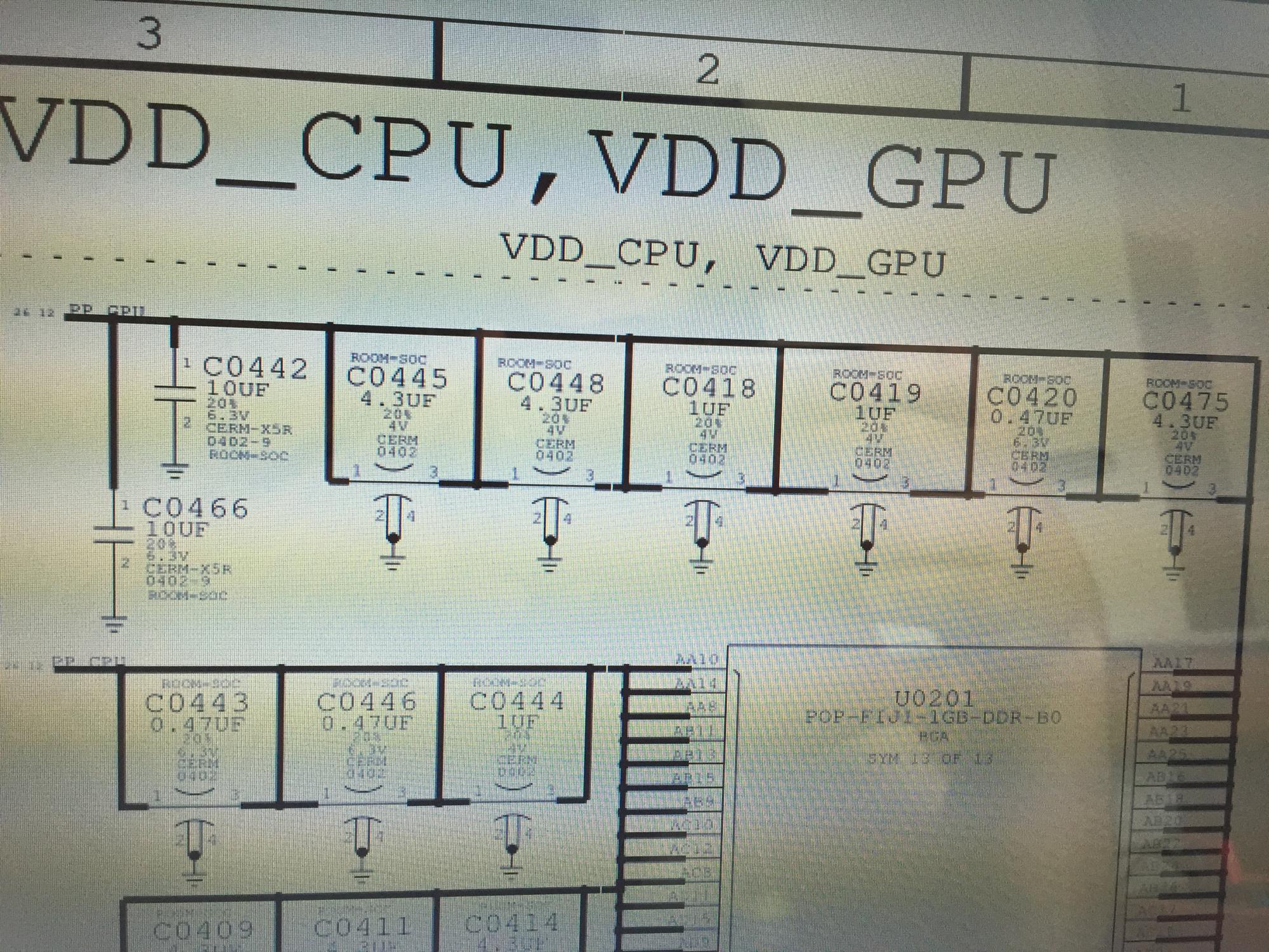

    Are the first two caps connected differently than the rest in this row or is it merely a space savor for the schematic to draw the rest like that?
    Or are the rest tied in together in parallel? Just looks weird to me

    the first 2 are caps, the others are filters.

      As in filter caps? I'm trying to locate a short on one of the caps on that rail

        it's a ceramic cap with 4 pins - 2 of them are ground.
        are they nec/tokin prodalizers?

          Why 4 pins? Can you explain difference between regular caps? I'm not sure what type they are. Don't think I've run across them before. They're super tiny on an iPhone board

            you can get caps that are like a ceramic block with a signal connection on each end connected together across the cap, and earth connections on the sides.
            they are used for filtering signals usually.

              I see. That GPU line supposed to have at least 1v on it but it's missing tried running a jumper from CPU line which is 1v to cap c0466 but still phone doesn't boot.

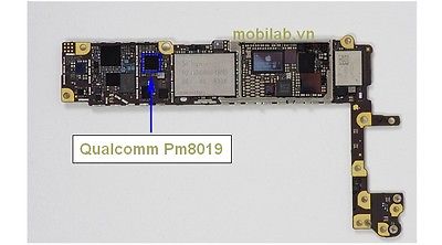

                U0201 POP-FIJI-1GB-DDR-B0 is A 1gb RAM inside CPU. 1v on the cap c0466 which is Data line voltage, u need to use oscilloscope to see the waveform.
                Power Supply IC PM8019 Chip for iPhone 6 which is the one u need to trouble shooting.

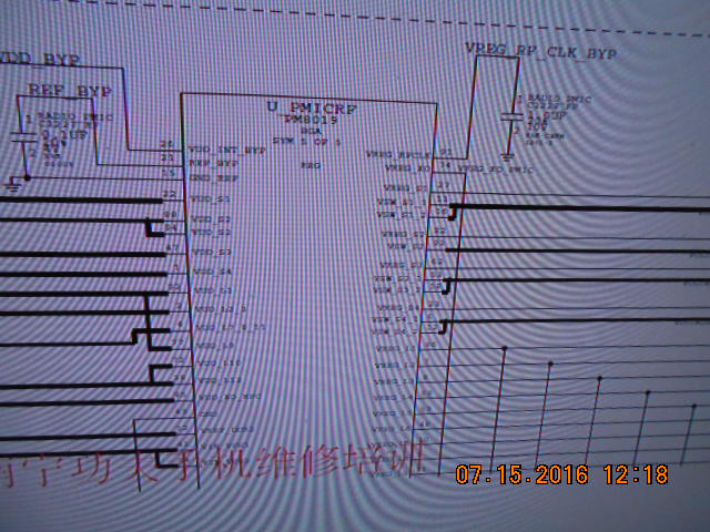

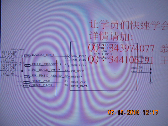

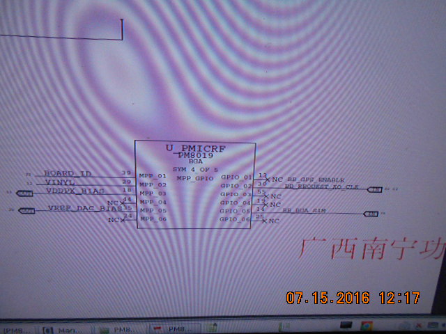

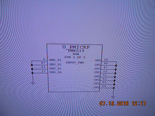

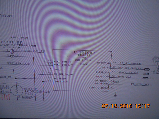

                    In the circuit diagram Power Supply IC PM8019 Chip use 5 sections of circuit diagram to explain the function of this chip.
                    Sorry! about the picture,I cant upload modified PDF file,so I did as you took picture over monitor. .
                    pic1 is all the system diagrams all put together.
                    In the circuit diagram use SYM 1,2,3,4,5 of 5 to show it.
                    in your posted fist picture, show A 1gb RAM inside CPU U0201 on SYM 15 of 15 mean last page. So the U0201 has 15 system diagrams.

                      Are you saying I can only see the 1v with an oscilloscope or it should be there visible with a voltmeter?
                      low resistance voltmeter will drop the signal and 1v mean peak to peak voltage. so you can't do this ( running a jumper from CPU line).
                      Also schematic says vcc main should be 4.6v but I only measure 4.2v. Wonder if pmu chip partly shorted causing that
                      If there has a short, at somewhere in the circuits will drop to 0v.

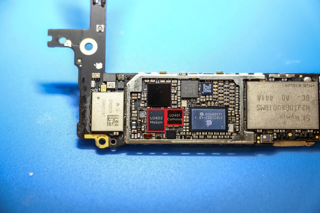

                                    So how could I figure out which chips are not working in this case?

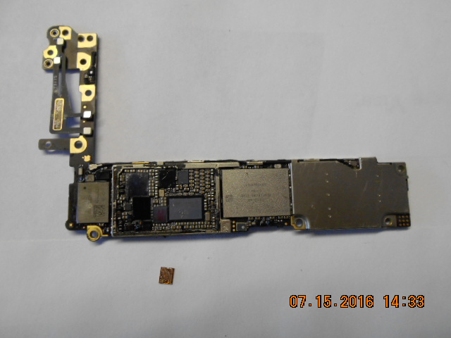

                                      Re: Capacitors in schematic question
                                      Its hard.
                                      Yesterday, Ive changed touch ic on iphone6. I bought both of them U4201 and U4202 and try in the air. some people use finger to push down and find the problem. But this one is an easy common problem than yours.

                                        Doesn't the iPhone 6 have one power management chip responsible for all other chips voltage input?
