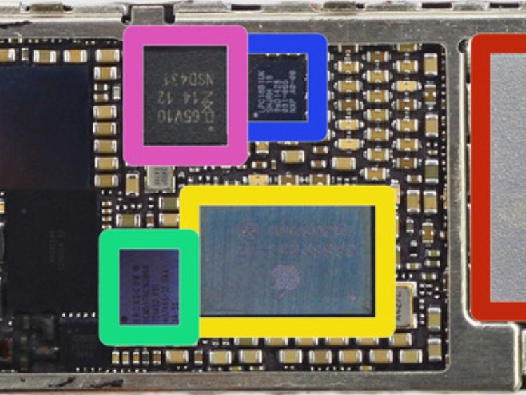

    iPhone 6 no power - Hot power ic
    Have a water damaged iPhone 6 that's been cleaned of all corrosion, however upon applying power the power management ic gets really hot and I measure 100mv to ground on all the surrounding smd caps
    I'm wondering if there's an easy way to determine if the ic itself is shorted or one of the smd caps?
    It's so tightly knit that simply unsoldering wouldn't be easy and the ic is BGA
    The power ic is highlighted in yellow

    Re: iPhone 6 no power - Hot power ic
    Possibly water under the bga chips shorting it out. Maybe try a reflow see if it helps ?
      Hmm it gets so hot I'd imagine any water under there would be dry
        dont iphones have underfill-resin on the bga's like nokia first started?
        • caphair
          • Nov 2011
          • 1249
          Yes they do, would that prevent any water getting under there? Isn't underfill used to hold components in place during soldering?

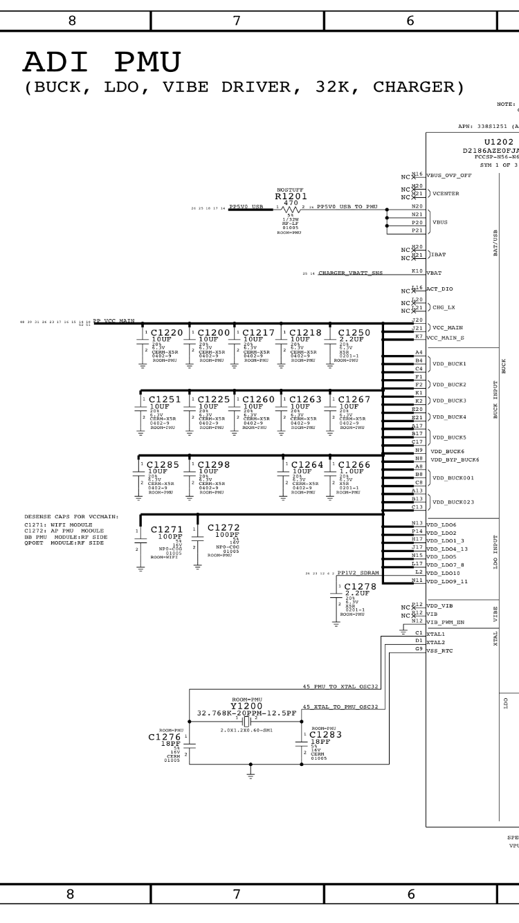

            Here's the section of the power management ic I'm looking at. Most those caps measure shorted and trying to figure out which one it is or the chip.
            However the diagram is a bit confusing, are all those caps tied to the buck section?
              All the buck regulators appear to share a common supply. The fact that the chip is hot while its supply is low (100mV) would confirm that it is the chip itself rather than a capacitor that is responsible for the overload.
                Thank you for that, wasn't sure how to determine exactly if it was the ic itself
                  Do you know the difference between vcc_main and vcc_main_s in that diagram?
                  Also what would the "desense" caps be?
