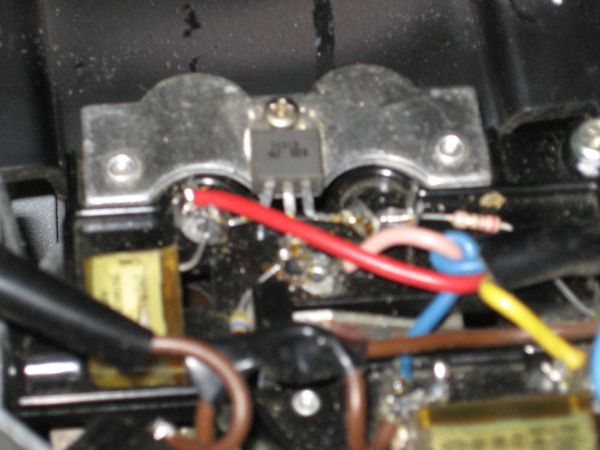

            Hello, The mixer (Kenwood Chef A901P) does still work but it's stuck on maximum speed and I have read that the traic can do this.
            I think due to the triac failing has caused the capacitors to fail.
            The caps I have been given have no safety markings, which as you said can't be a good thing. Would these cap be ok Link?
            They are class x2 and approved but will it matter that they are 275vac not 250vac?
            From what I can see the mixer does not appear to be very complicated electrical wise (2 caps, 2 resistors and a triac)
            so I can see one reason why people still want them because they don't heavily rely on electrical components.
            Thankyou

                      Re: Capacitor
                      Those caps are probably for reducing the dT/dV or in plain words to slow down the transient produced by the off or on switching (assuming the capacitor & resistor is in parallel with the triac).
                      A relay would arc and a triac would go short if voltage rises too fast. This kind of circuit is commonly called a snubber or RC snubber.
                      The fast rule is 1Ohm/V and 0,1uF/A. It is recommended to use some UL or similar approved metal paper capacitor either from X1, X2 or Y1, Y2 class.
                      The safety class is determined if there is an fuse before the capacitor and if it does connect to ground / safety ground or only from neutral to hot.
                      For an snubber i would say an X1 or x2 should be sufficient, as long as there is an fuse anywhere.
                      Generally, the value of the capacitor is not critical, but if the capacitor is increased to far, there is the possibility that the motor coil and the capacitor will act like an oscillating circuit, which is not particular good.
                      But if you can`t manage to get some 0.15uF capacitors or 150nF ones i would try the 0.22uF ones.

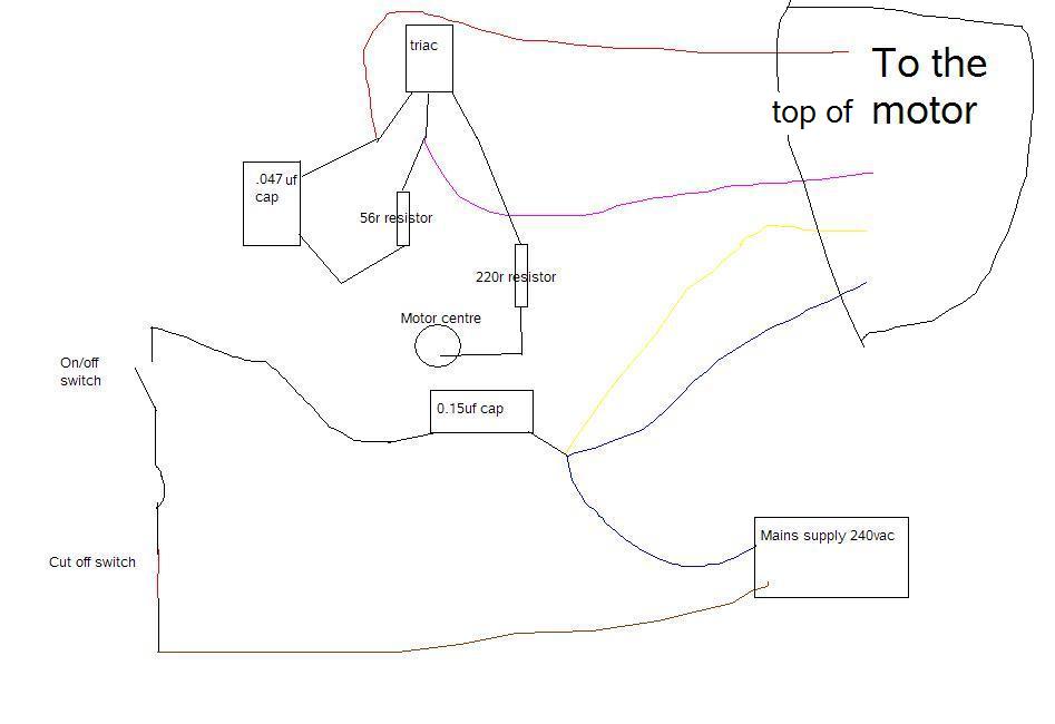

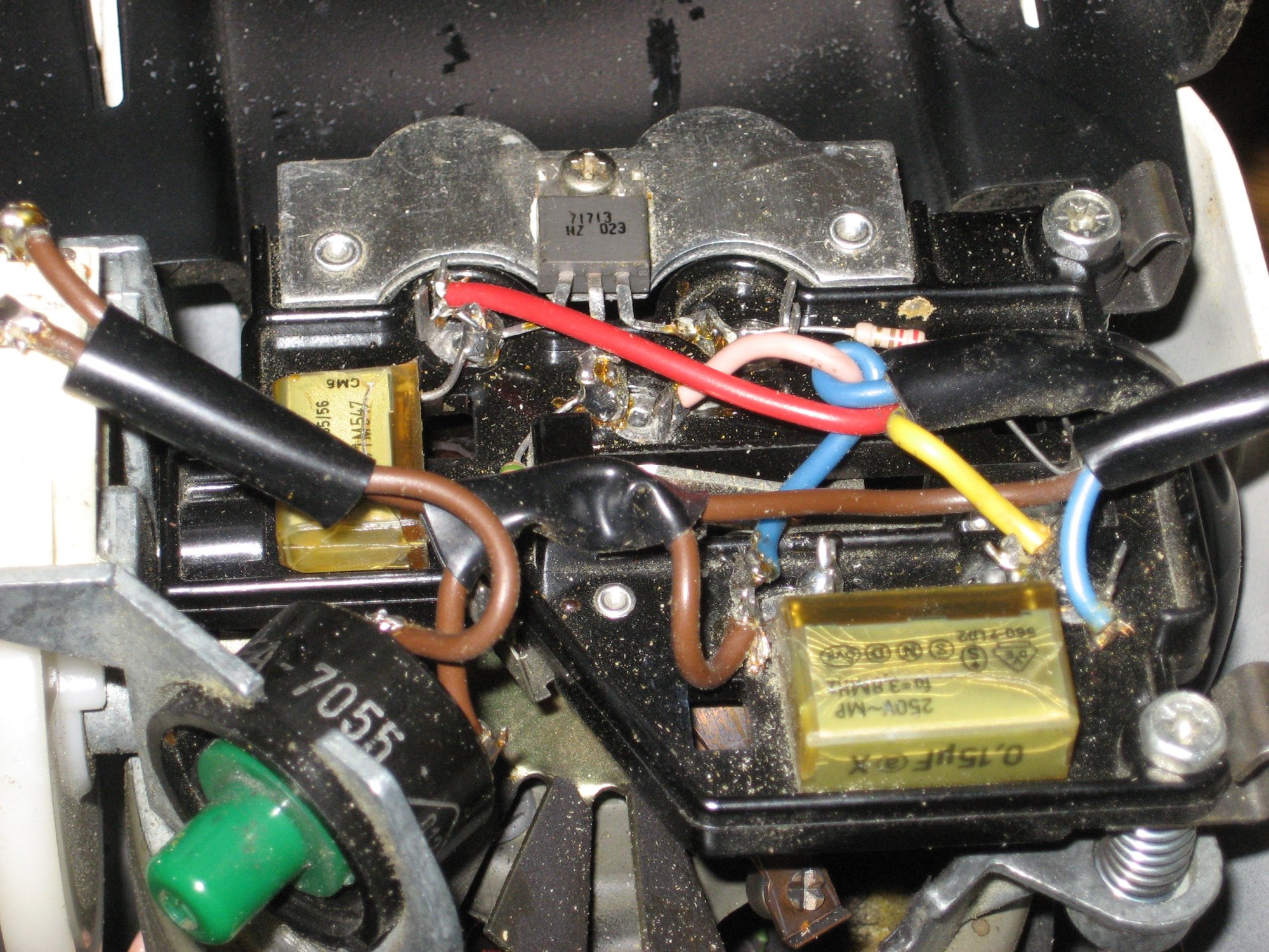

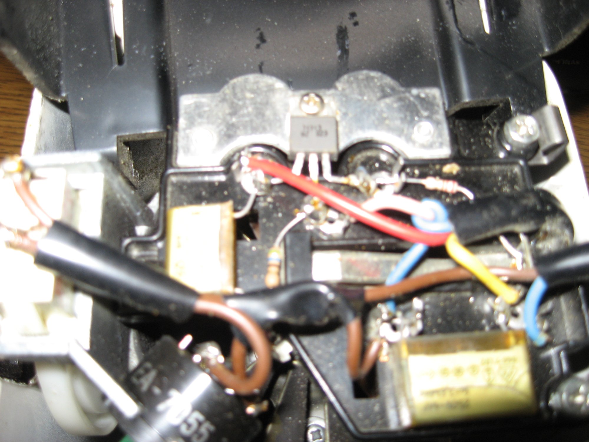

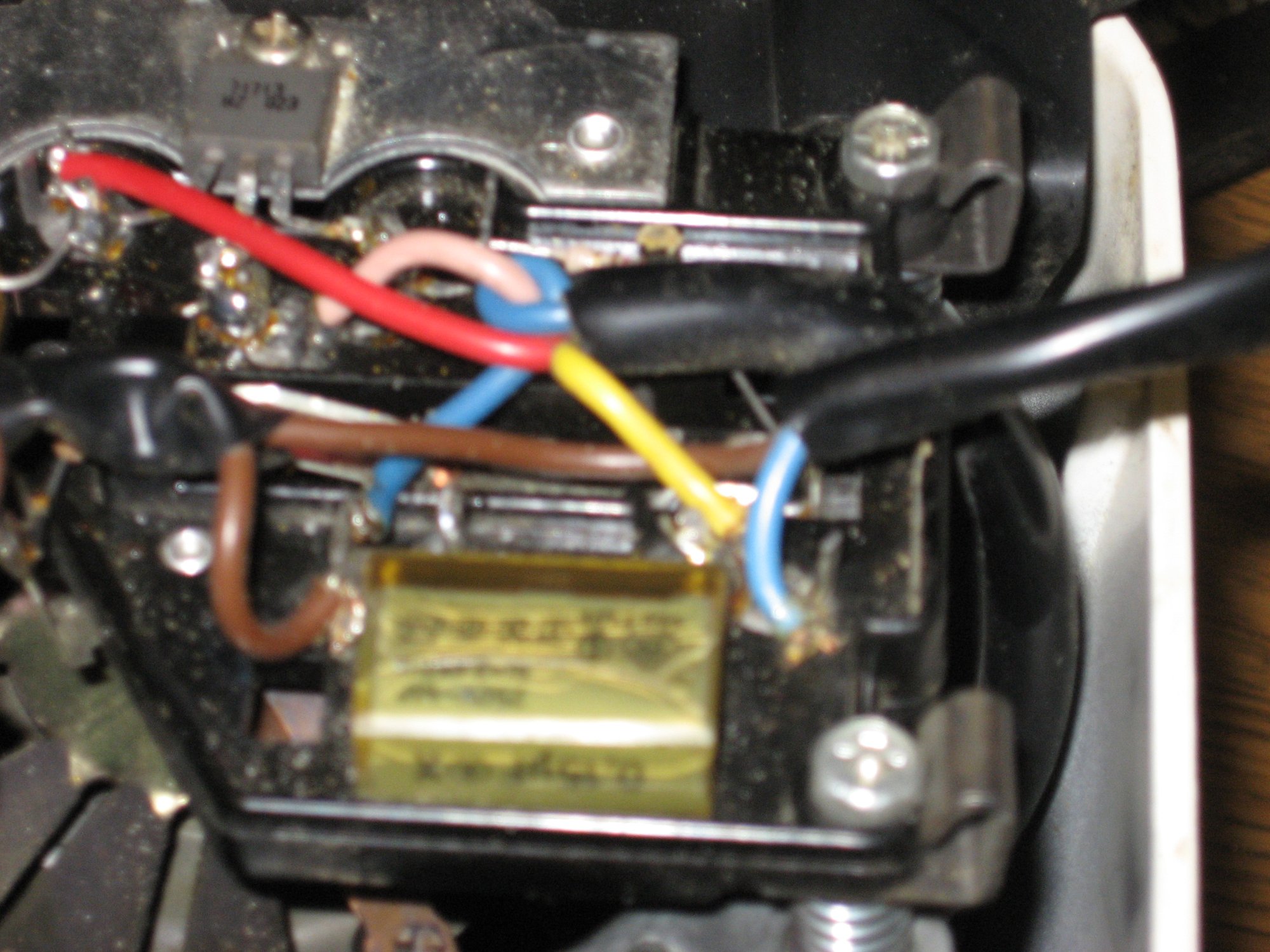

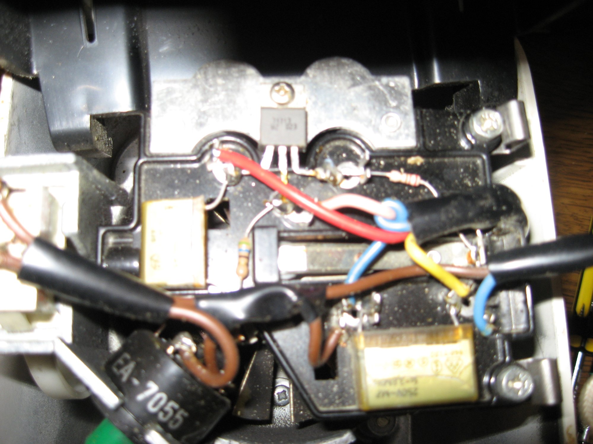

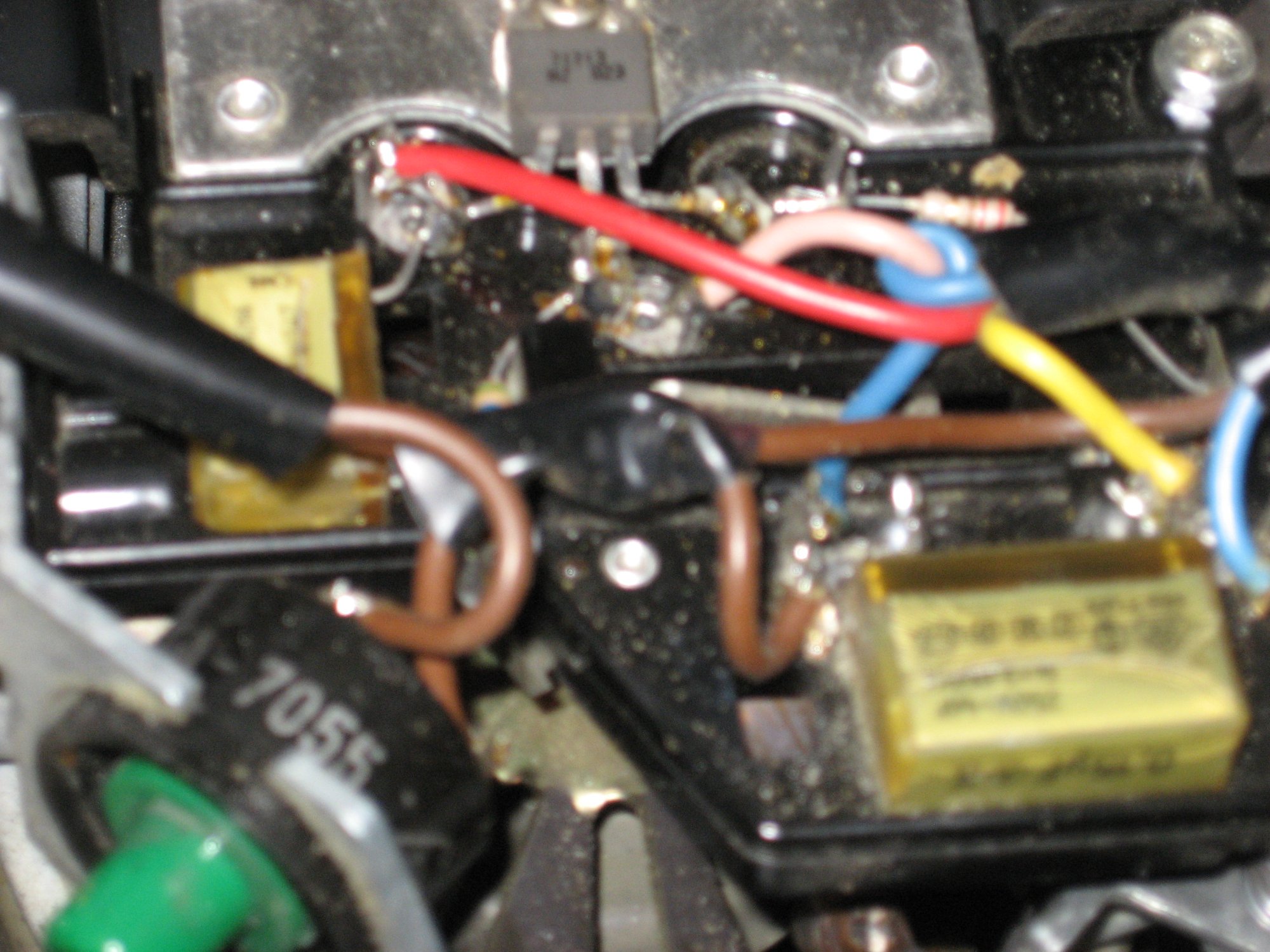

                        Hello, Starfury1 The mixer could be about 25 years old. I have read most of the posts you have linked to. That's when I discovered it was a common fault that could be fix very easily.
                        I will be replacing the two resistors as well. The 220ohm is way out of spec and the 56ohm is fine but I am going to replace it anyway.
                        I was thinking about changing the brushes as well.
                        There's nothing to worry about the different controllers. Since you can get a new controller on a pcb. I think it could be for a newer motor.
                        I will try and take a picture and post it sometime tomorrow, which might help to identify what the caps are being used for and if the tolerance value is important.

                          Age was probably its demise, so that possibly rules out a secondary fault which was more my concern.
                          (although suppose its still possible the triac is gone)
                          Since its using a triac, which is probably chopping up the mains sine for speed control
                          EDIT seems one maybe for timing trigger point but not sure
                          My guess is that the caps are purely there to shut up EMI/RF crap
                          true thought, values are chosen for specific reasons and thats why you shouldn't stray from them unless you know what the effect of this will be
                          I dont fix these things
                          and triac theory is way rusty with me
                          (apart from the fact its more or less a bilateral switch that you can set the voltage trip point on at various levels in the waveform)
                          I dont know the circuit either, it seems to be crudely simple and that perhaps account for its reliability.

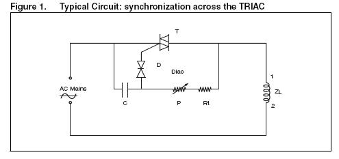

                          Looking at a PDF on Triac Control
                          that cap maybe being use to set the "trigger point"
                          (this could possibly explain the use of closer tolerance capacitors)
                          If so, then by using a larger cap you will change the trigger point
                          (Also note the use of a DIAC with the TRIAC)
                          http://www.play-hookey.com/semicondu...iac_triac.html
                          http://www.hobbyprojects.com/thyrist..._and_diac.html
                          No mention of a Diac being used in that controller?
                          (have to look into this ...like I said I have forgotten....these you do tend to find used with triacs.
                          They are open circuit till their trigger voltage is hit then go short circuit
                          using the term "'open short" loosely here.
                          (high resistance, low resistance would be better)
                          there are some pdf's and other interesting stuff of this link
                          http://www.educypedia.be/electronics...ronicsdiac.htm
                          if you can just draw a diagram of what connects to what for reference.
                          sometimes with photos its hard to see what connect to what if its skyhooked
                          but either would be of help to me as I don't know.
                          I did a bit of googling but didn't find anyone had posted a photo or a diagram
                          At this point I'll leave it
                          The links should help understand better how the thing works.
                          but I know it doesn't really answer your questions
                          Cheers

                            This might explain it a bit better
                            http://www.allaboutcircuits.com/vol_3/chpt_7/6.html

                              I don´t think that the caps are there for setting the trigger point, but sure w/o circuit it is all guesswork.
                              Trigger point is either set with a resistor voltage divider or an diac or with both.
                              • starfury1
                                • May 2006
                                • 1256
                                Re: Capacitor
                                in one of the forum links its stated for EMI surpression for both of them caps that is
                                (but No mention of diac use)
                                from the ST doc PDF link
                                Triggering with synchronization on the TRIAC voltage
                                The triggering circuit with synchronization across the TRIAC (See Figure 1 and Figure 2)
                                turns on the component at an angle β after the current drops to zero, such that
                                β = ω · Tr.
                                Time Tr is defined by the time constant (P + Rt)C.
                                ω = 2 · π · f with f = mains frequency.
                                Figure 1. Typical Circuit: synchronization across the TRIAC
                                Also if you look at the last link (separate post above) it shows a pot and cap and says;
                                "A simple lamp dimmer circuit is shown here, complete with the phase-shifting resistor-capacitor network necessary for after-peak firing."
                                thats why I thought possibly for triggering

                                  Sure in this circuit the capacitor is a snubber, to protect the Triac against high voltage spikes from the load switching. From another point of view it sure does reduce EMI too, but i assume that it is not necessarily needed for this task.
                                  It does nothing else there and the circuit would work even without the capacitor.
                                  But the triac may fail earlier, due to high voltage spikes and too fas voltage rise.
                                  But i referred to the circuit in question, e.g. the original circuit from the particular mixer.
                                  I certainly know, how a simple triac circuit should look like, but how should we know that it is the same circuit in the mixer?
                                  There are plenty of circuits and far more then one way how an triac circuit could be designed.

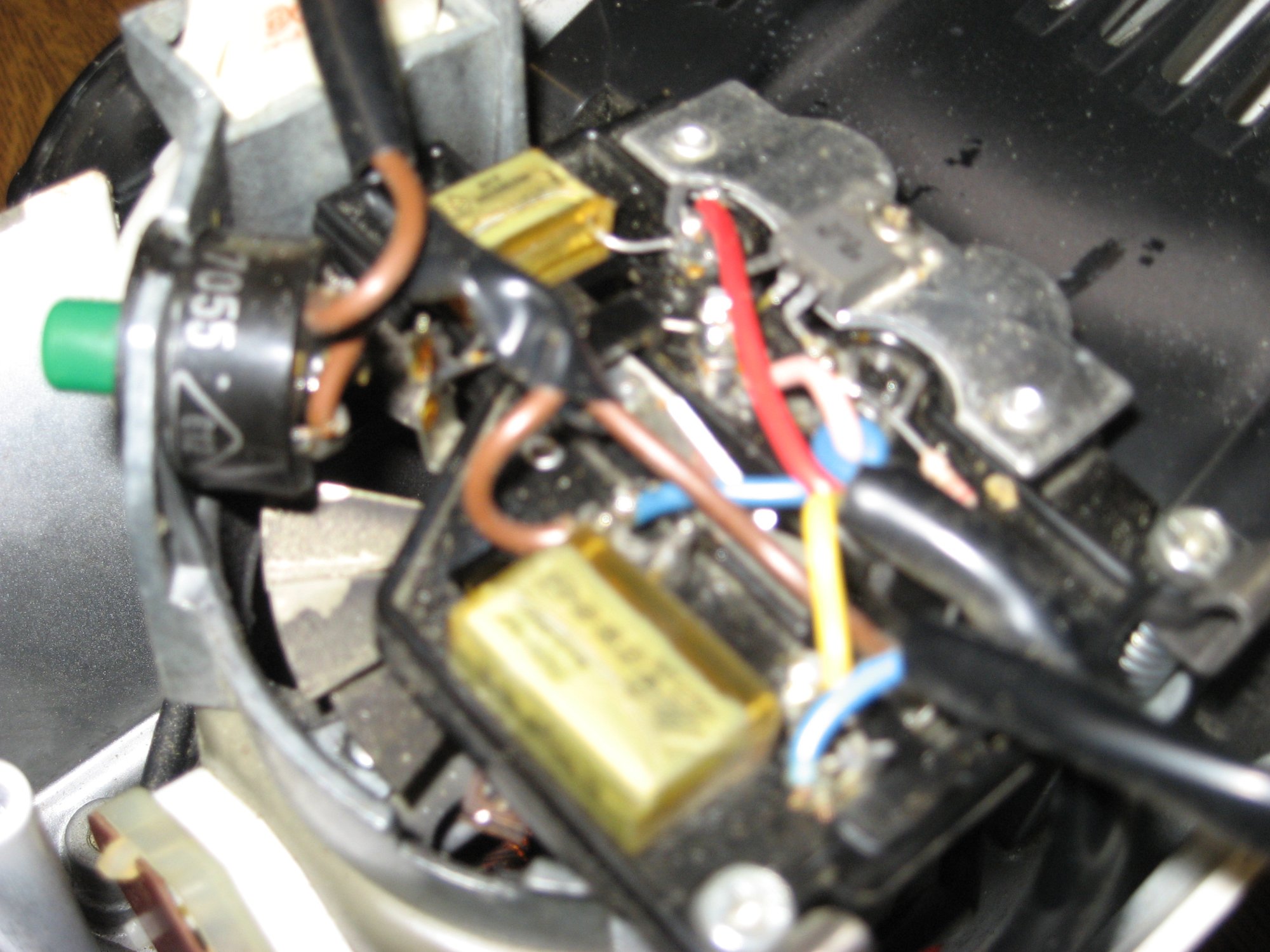

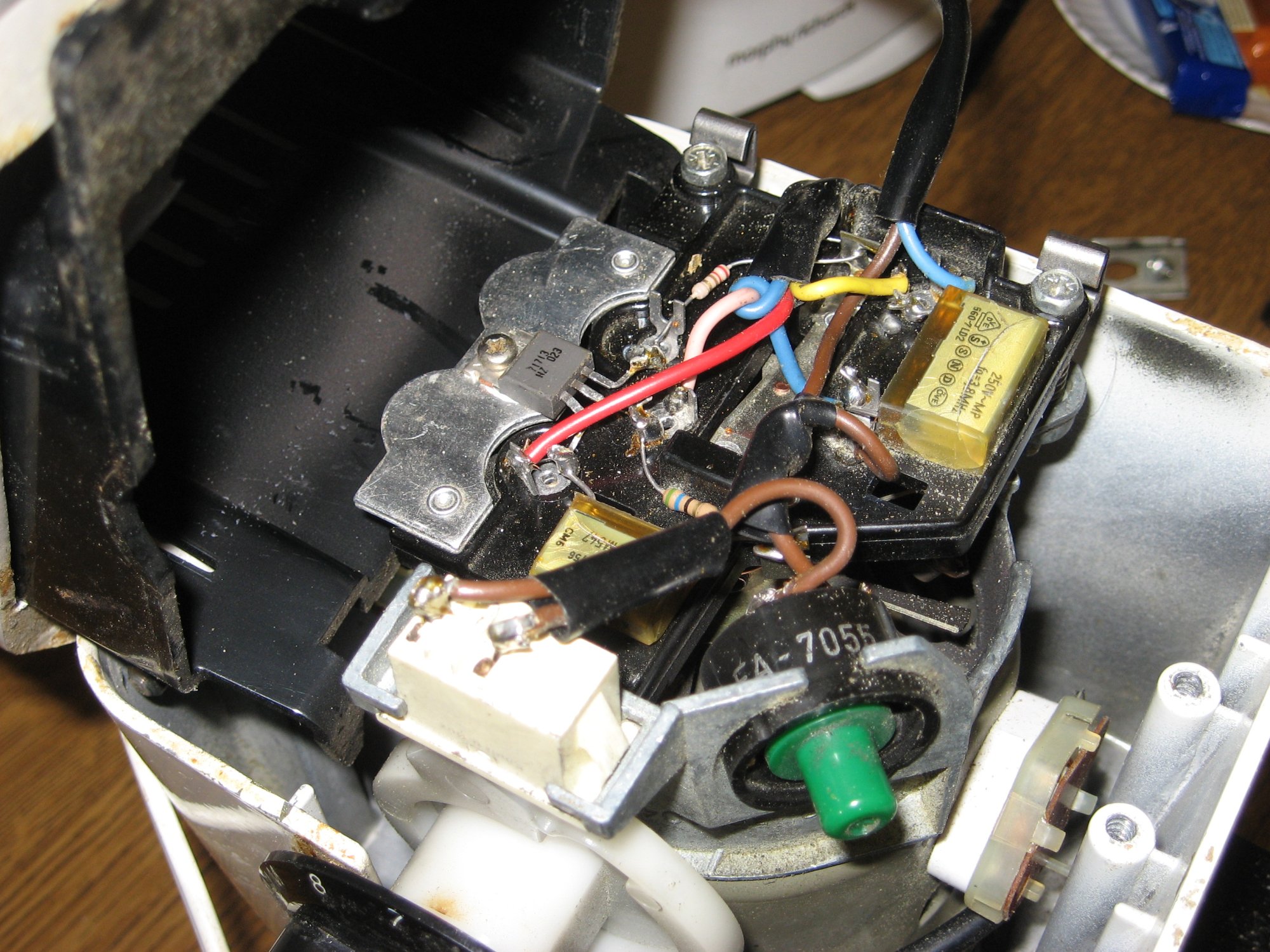

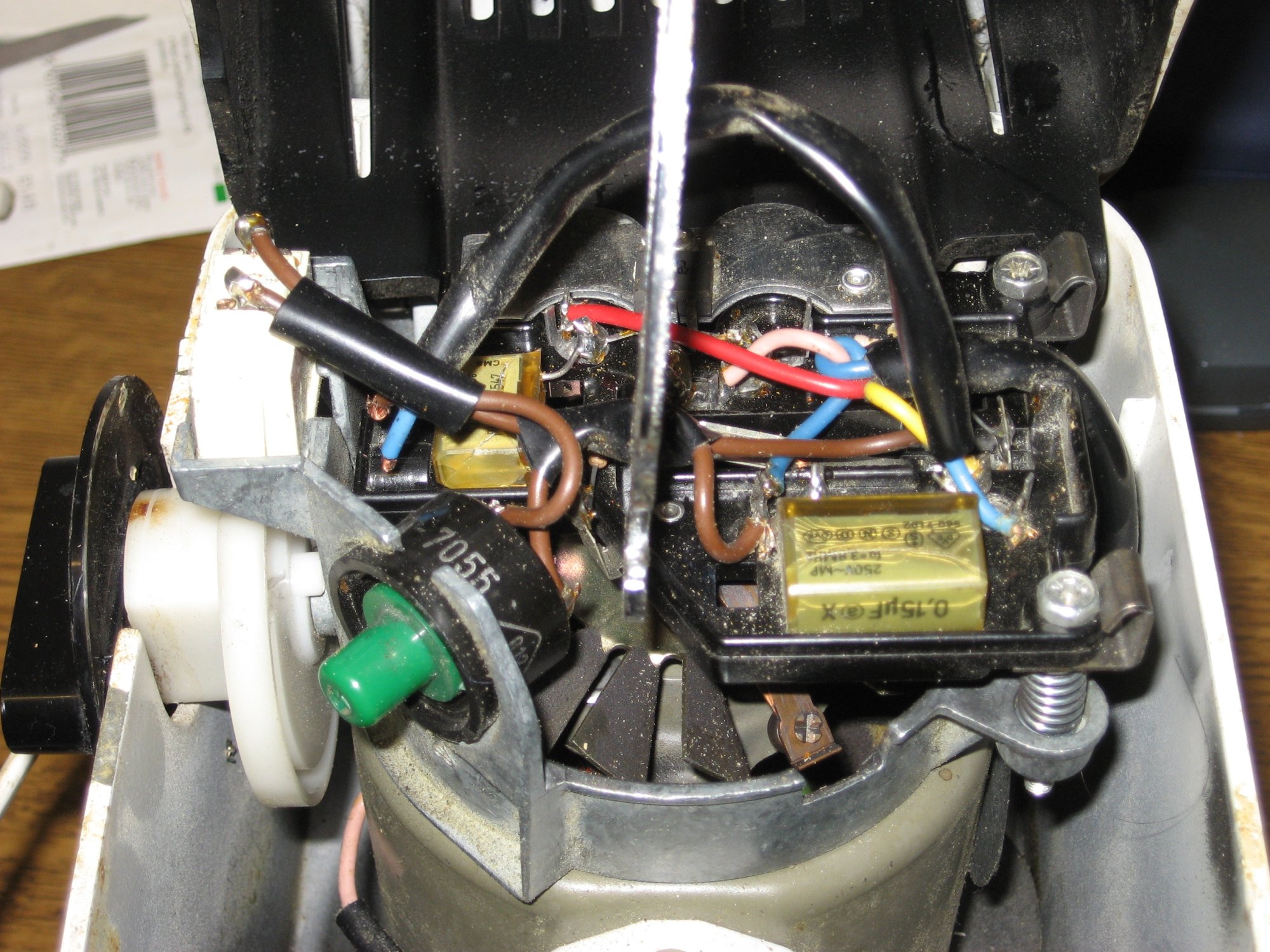

                                      Hello, Sorry I forgot to mention I am fitting a new triac since testing it, it appears that has been taken out too. The guy I got the wrong caps off did say the traic could take out the caps. Thanks for the links I will have a good read of them.
                                      Here are some photos of the circuit. I thought also I would draw a circuit diagram.
                                      Thankyou
                                      djrock
                                      • severach
                                        • Aug 2007
                                        • 1055
                                        Re: Capacitor
                                        Your schematic is missing the blue wire from the motor to the 0.15uf cap. I was having trouble tracing power through the motor. The 3rd stripe on the 56r resistor looks brown to me which would make it a 560ohm resistor. The lower junction of resistor 56r and 0.47uf cap looks like it goes to more than nothing. I see a large contact down near the cooling blades that might be connected and has no obvious purpose and its height may be set by the spring loaded adjustment screws. The other contact is labeled "motor centre."
                                        That tells me there's a speed control somewhere. I see the black dial but I don't see how it connects.
                                        That motor has 6 contacts which seems like a lot to me. Seems like there might be something important besides a motor beyond that bundle of 4 wires.
