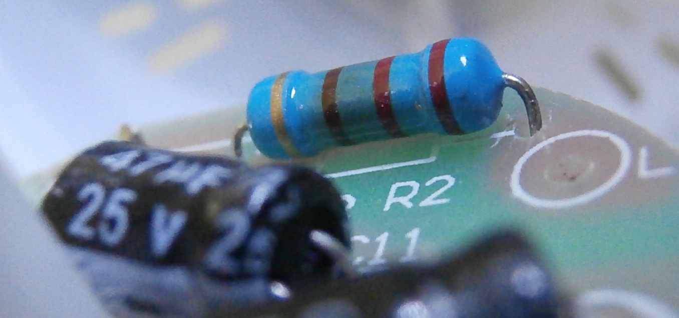

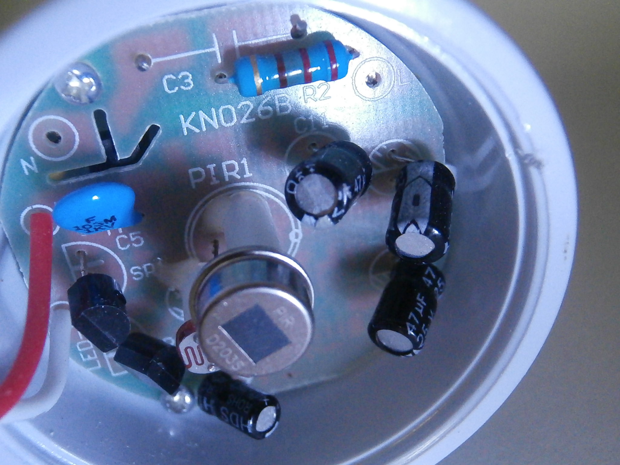

    I have had this in use for 21 months, its probably been on for only 2 minutes every night for the 21 months.
    Now it wont work properly, the LED'S just flicker when the light is tripped by the PIR.
    It's only a cheap thing to replace but i don't like chucking things out if i can fix them
    The caps look ok to me. The resistor looks a bit scorched in the middle.

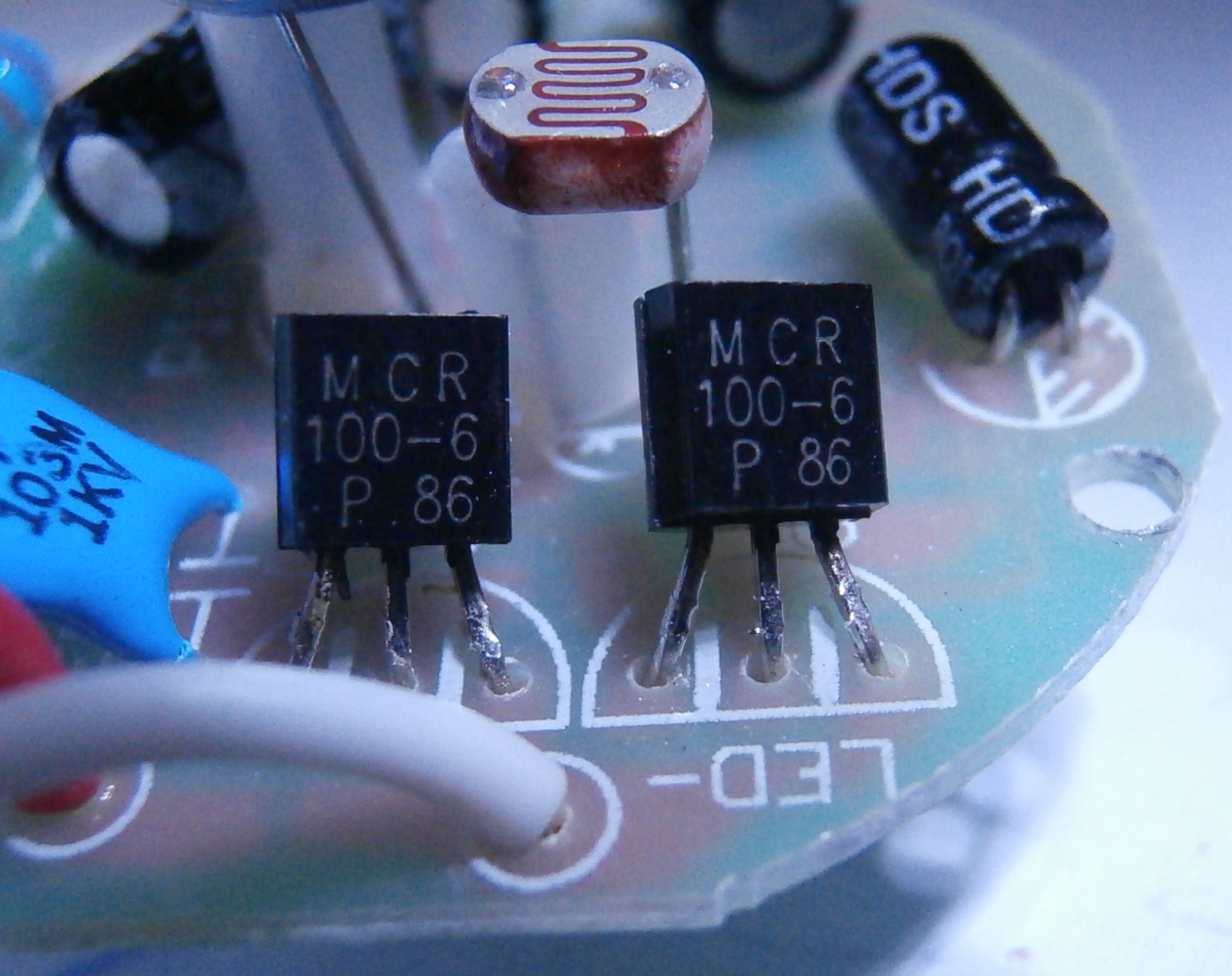

    Do the LED'S flickering on and off point to the two rectifiers being the main suspects ?
    • 31246
    Re: B22 PIR Motion Sensor LED Light Bulb
    recap it, you cant tell if small ones are bad wihout an esr meter.

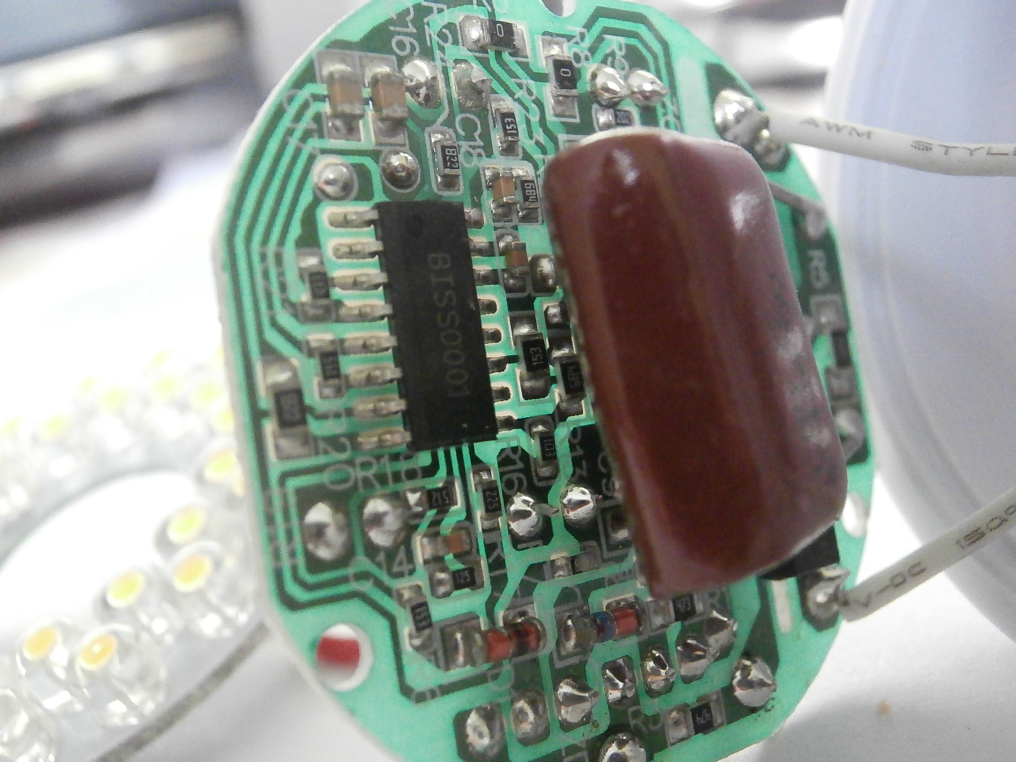

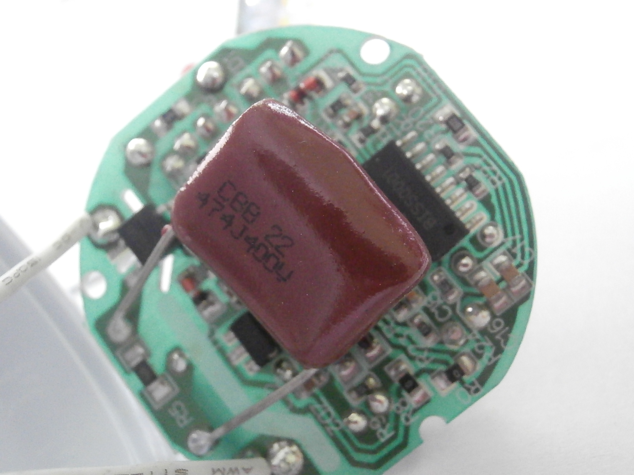

      I would confirm that the supply to the BISS0001 IC is stable. I would also trace out the circuit around the two MCR100-6 SCRs and the string(s) of LEDs. There is an application circuit in the BISS0001 datasheet.
