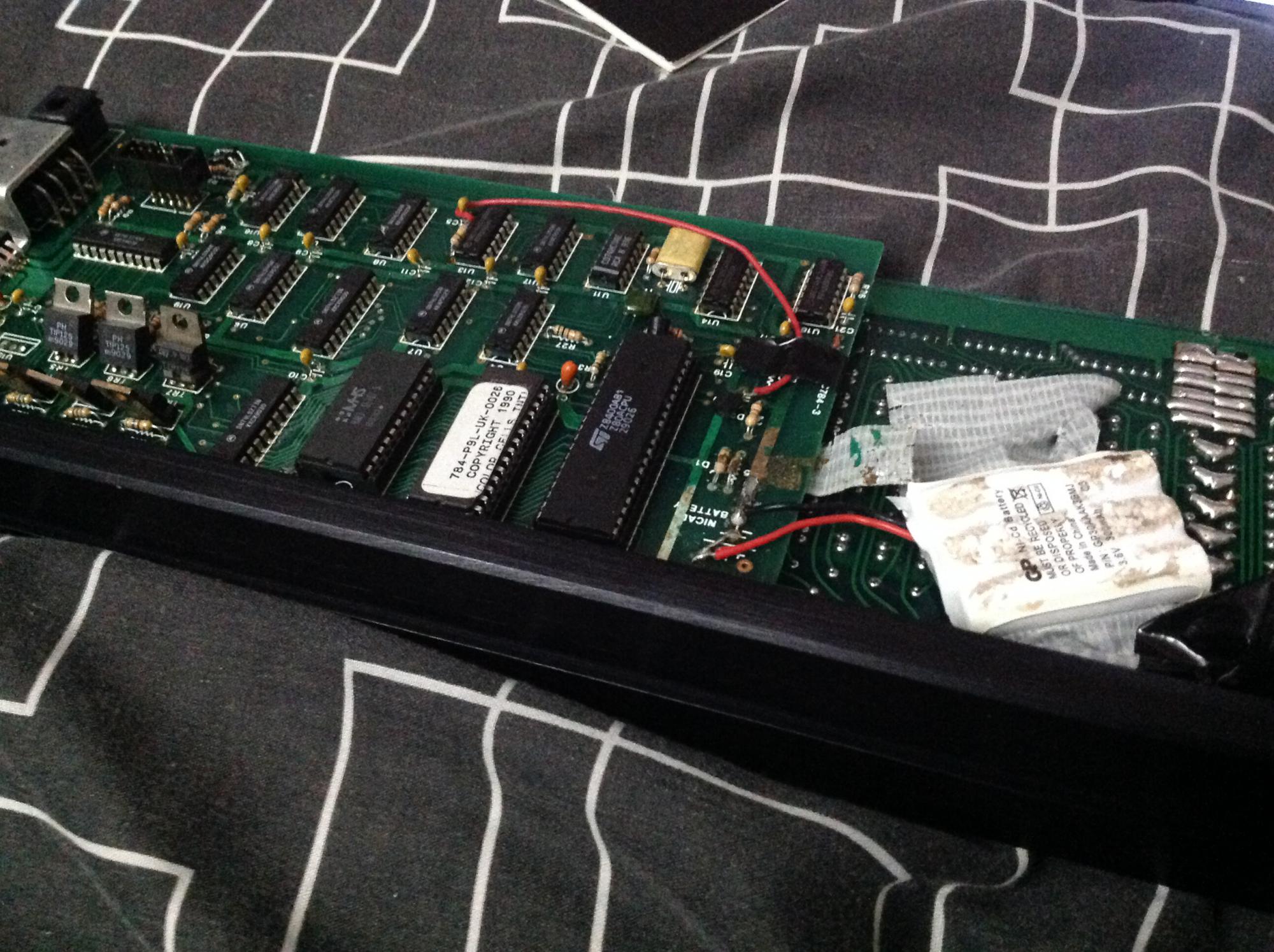

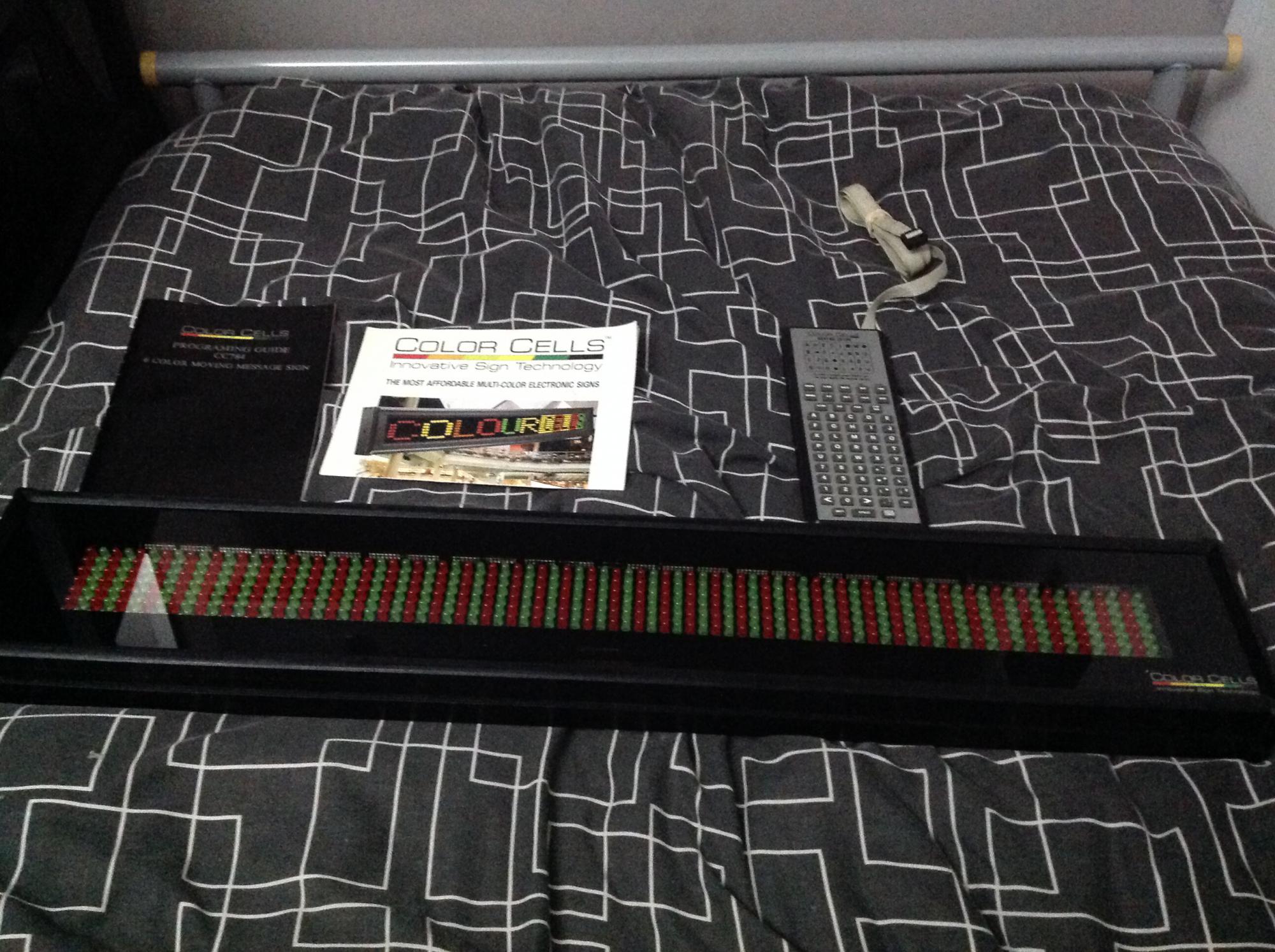

    Recently im looking into building my own Led sign board. Wanted to get familiar with them before launching into a project, so picked this up off ebay for £20 delivered ! The guy selling it was down the road from me This unit is the Colour Cells CC784 Programmable Led Signboard, a very interesting one to. Its based off a shift register design with MC1413P Ics to select the Leds made in about 1989 so quite old. Comes with a remote which has letters on that you can type and programme for the display.
    This unit however needs some minor repair, the unit when powered off the memory seems to corrupt and forgets what has been written to the display and acts like its from factory. I have not yet opened it to diagnose but will have a look soon looks like it has a memory battery so probably just needs changing. I will also be restoring and replacing every Led in it with brand new ones to help the reliably of the unit.

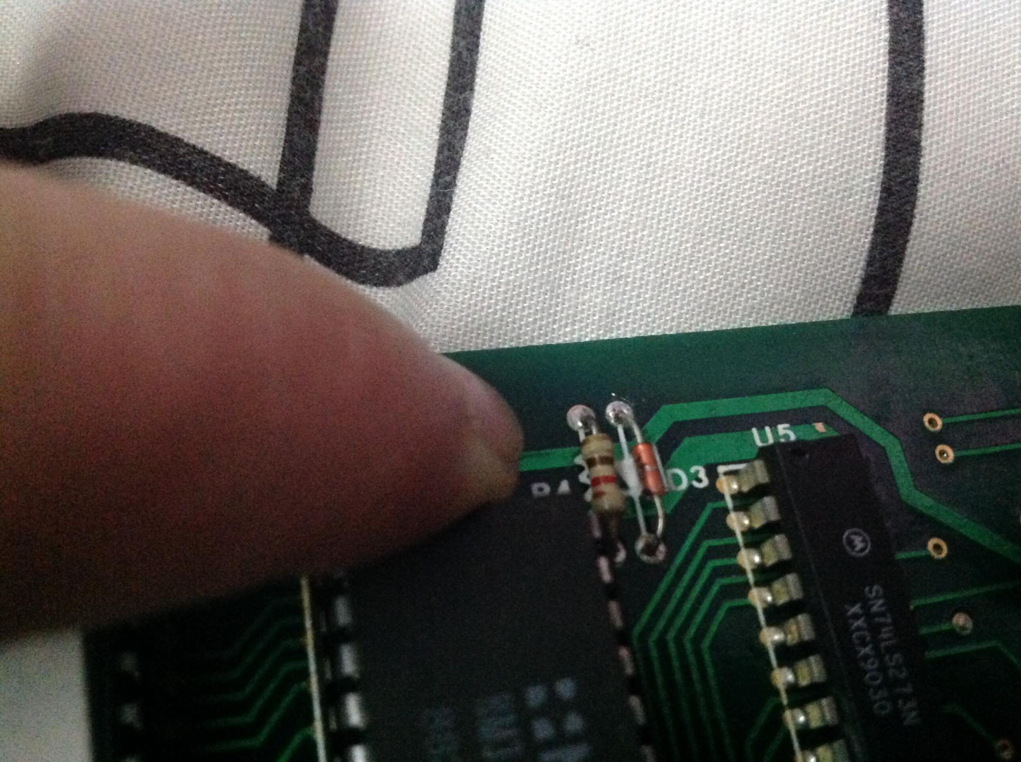

        Lol have a look at this bodge repair job didnt even bother to replace the corroded diode and resistor

                  What battery is used buddy you got a part number ? So far I know its a 3.7v 300mha but not too sure.
                    • 31044
                    Re: Color Cells CC784 Repair & Restoration Log
                    3cell pile of shit - dont worry about it.
                    you need to clean the corrosion by throwing vinegar all over it,
                    then remove the charge resistor in parallel with the diode from the battery and fit a cr2032 coincell holder.
                    lithium coincells are more reliable.
                    oh - i dont think i need to say what i needed to fix in them!
                    if they are real bad, you have to lift and replace chipsockets!

                        Nice one, so remove the resistor and diode, then install a cr2032 socket and battery guessing that the diode and resistor that charge the previous battery? Also removed them chips before and the sockets are corroded so got to clean them as well as the pins on the Ic's.

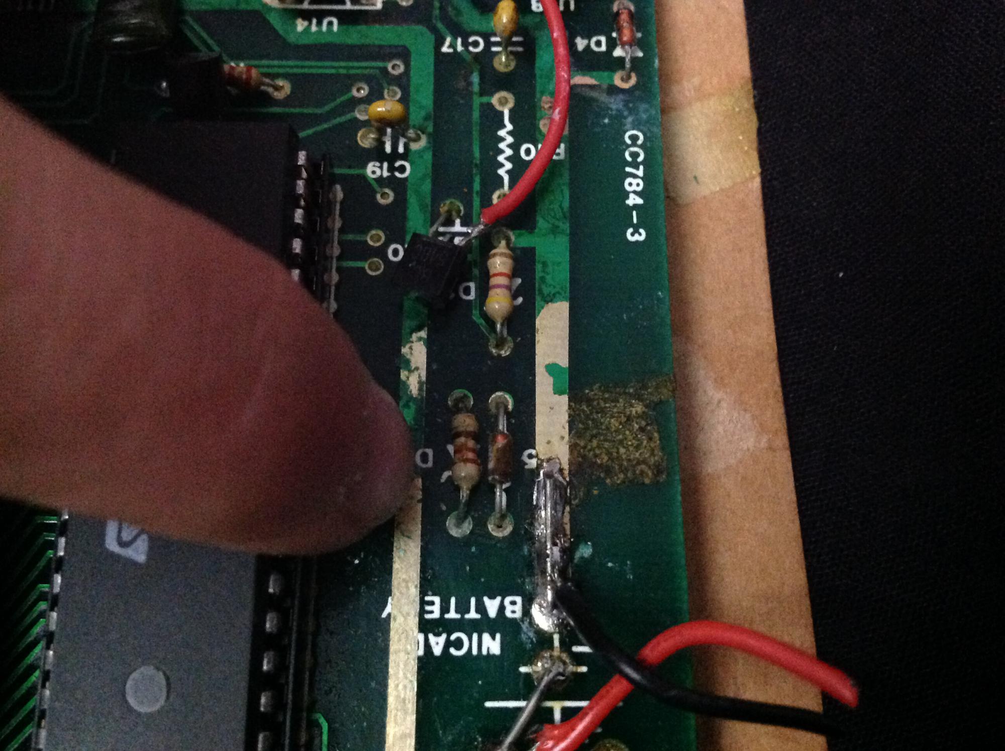

                          Just to be sure, is this the diode and resistor you mean ?
                            • 31044
                            the diode and resistor are inline with the battery,
                            the diode stops the battery getting hit with 5v when it's running,
                            the resistor bleeds some power across the diode to charge the battery.
                            you must have the diode inline with the battery to prevent it getting destroyed by 5v,
                            but you remove the resistor to prevent it being recharged.
                            diode should be a schottky to minimise the voltdrop btw, the battery will be 3v and the ram is rated down to 2v from what i remember.
                              • 31044
                              lol your foto shows they put the diode and resistor in each others places!
                              they should lead to the battery + terminal
                              • ReeceyBurger123
                                Never Give Up !
                                • May 2014
                                • 7325
                                • Britain
                                I see the ones you mean now, the resistor is at the top here and the diode is at the bottom. So remove the resistor when adding the CR2032 socket ?
