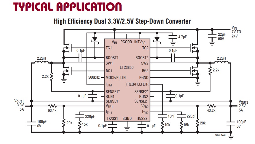

    I need to repair a device that uses a dual synchronous
    step-down switching regulator controller LTC3850.
    Datasheet is here
    Let's suppose it uses the typical application design according to the attached picture.
    How would you start to find out the faulty part if there is no
    Vout1, nor Vout2? The input voltage Vin is correct.
    Thank you for you ideas.

    check for shorted fets, capacitors etc, then try another chip.

      Thanks for the reply. How would you suggest checking shorted FETs?
      Desolder them and use a digital multimeter or use a scope in a circuit vith voltage?

        multimeter should be able to check while they are still on the board.

          The fact that neither half is working is suspicious. It is less likely that all of the FETs are shorted and more likely that something in common, like the 22uF cap, or the chip itself, is bad.
          I tend to start with the scope on a circuit like this. Pick a side. Is there anything at INTVcc (should be about 5V)? Are the TGx and BGx signals oscillating? If so, do you see anything at SWx (even once or a few times after powerup)? Are SENSEx+ and - doing anything (even once, or a few times after powerup)?

            So do you have the actual board so you can find out if all the control signals are present, I.E RUNx?
